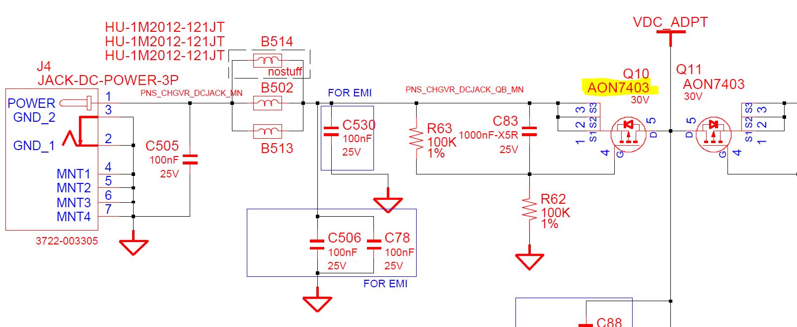

    Hi there.
    I'm wrapping my head around this Samsung that keeps killing Q10 (the first FET in the 19V power line) after a few minutes at least 15 (this last time I was not close to it when it went down).
    I've seen some youtube videos where they just short this FET, but I don't like this kind of approach: if the FET is there it is for some reason that I may or may not even understand.
    As I didn't find the same exact model FET to replace, I've scavenged other boards for FETs with similar values, but they keep failing.
    There must be something down the line that is killing the FET after a while.
    Note that the FET doesn't get burned, it just stops working and sometimes it even work for a few seconds and stops after.
    Does any of you that are experienced in this things can point me to the reason of the FET being killed?
    Cheers.

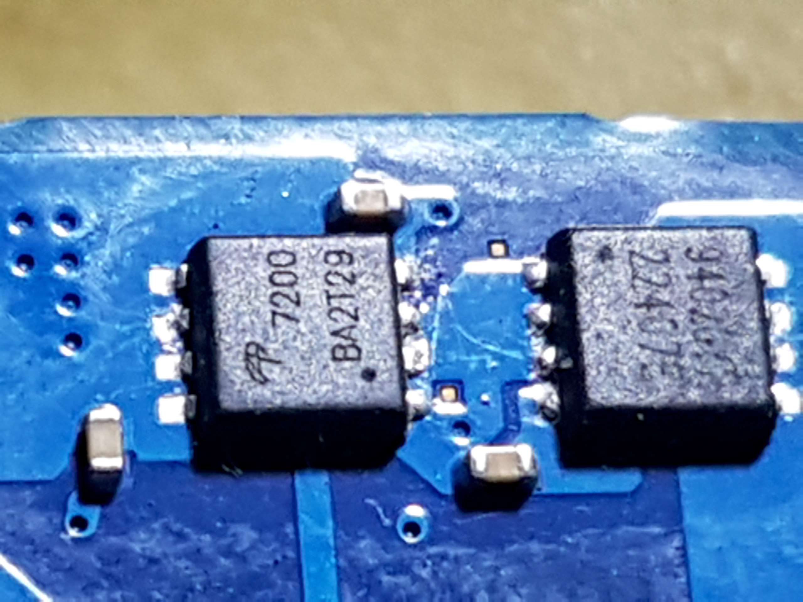

          - I've replaced it again and while working it was drawing up to about 1.5A with the battery out and up to about 2.7A with the battery in (charging).
          - Stops working: they do no short, after what I consider failing they sometimes allow the notebook to turn on, but mostly the greed led turn on and off again. It is worse with the battery in (at least discharged like it is now).
          - I've tried a few FETs that I didn't give much attention to the Amps because I knew that this notebook is low end/power.
          The original FET was a 7200, the first replacement was B20N03, the one after I don't remember, and the last one was a different package type that I manage to install for tests is a 7170.
          With this last one I hooked the notebook to my bench power supply and it was working for hours (and charged the battery) and I left over night and today it don't work anymore.
          The strange thing is that the schematic seems to indicate different references for the FETs: the one that I replaced was originally a 7200, but the schematic says it is a 7403 that is even a different type of FET...
          Please see the attached pictures.
          Any Ideas?
          Cheers.

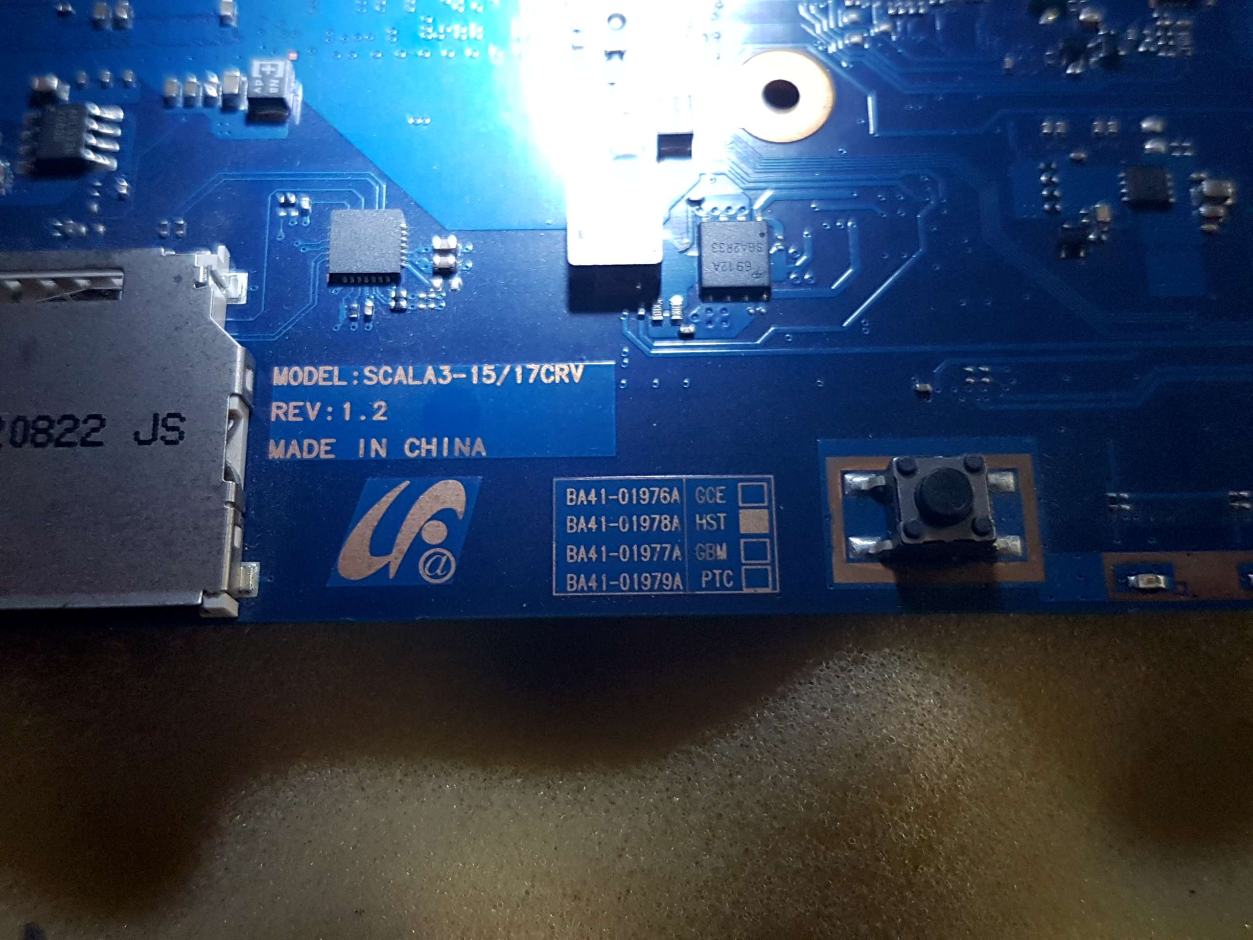

              Re: NP300e5c Killing input FET after some time.
              Hi.
              The Board P/N is BA41-01978A (second Picture of my last post).
                  I can't find the schematics for this board so maybe you got a different one.
                  25V to ground is indeed perfectly fine for N-Channel MOSFET.
                  0V means the charger IC stopped generating the gate signal. The charger IC is what controls the gate of the DC-in MOSFETs. So if voltage is straight up 0, it can be an issue around the charging circuit in general.
                  First you have to identify what kind of charger IC you have on the board.

                    The schematic I have is the one that I'm attaching and I downloaded it from this forum. Based on the P/N BA41-#####A written on it, it matches BA41-01978A written on the board itself.
                    Anyway, if this FET is controlled by the charger IC, it doesn't match with the schematic that has a simple passive circuit for this FET's gate (considering it could be a bit different for a N-Channel FET present in this board).

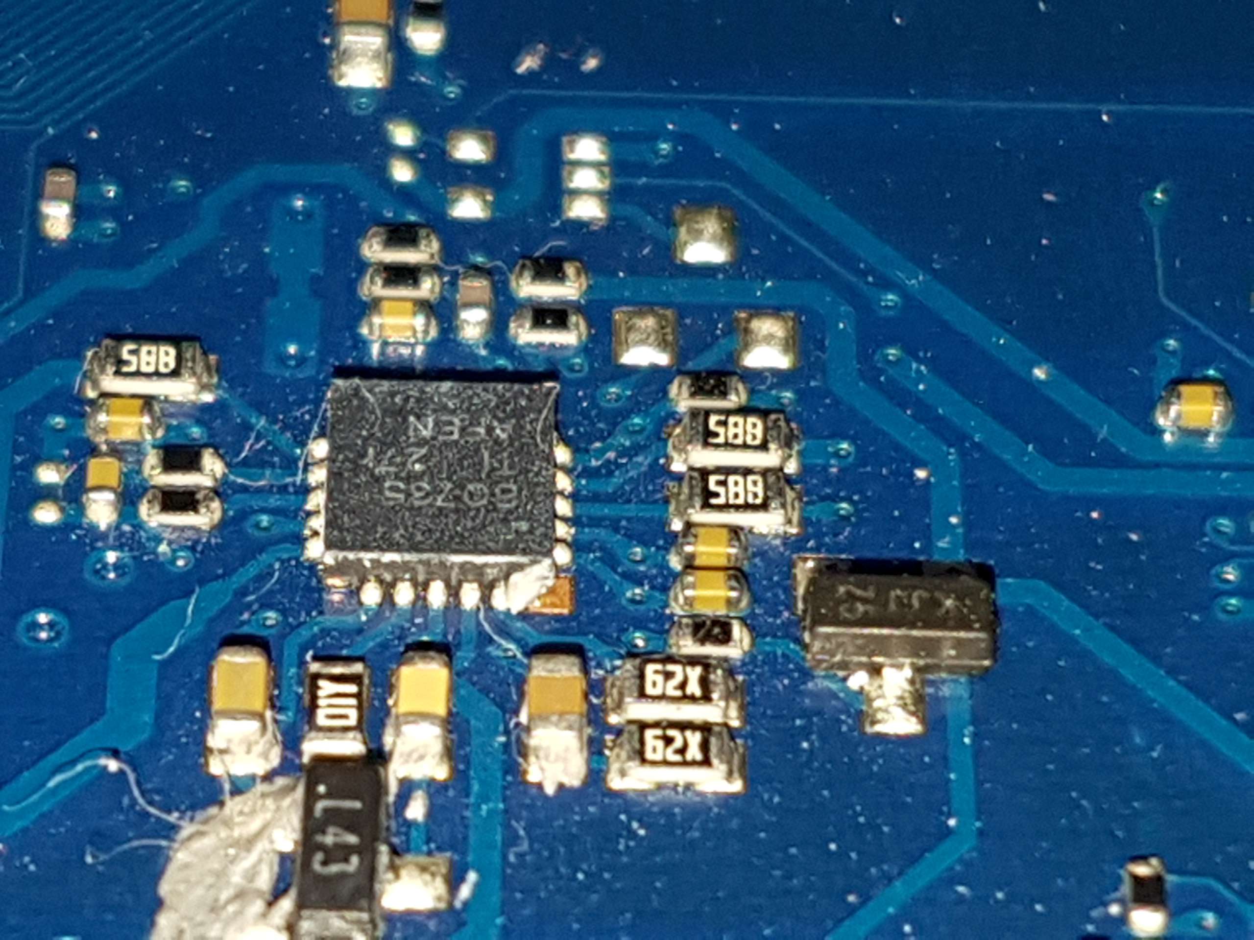

                    I'm also attaching pictures of the power/charging circuitry.

                      Schematics is for an AMD platform called Petronas-15, I think your board is an Intel platform called Scala3-15.
                      Your charging circuit is different. You have a bq24735 charger IC. The gate of the MOSFET is driven by the ACDRV pin of this charging IC. It has an internal charge pump to get the gate voltage 6V higher than source voltage, so about 25V.
                      If the MOSFETs are not shorted drain to source it's unlikely they are the culprit. Not that they don't have other failure mode, but it would be very unusual in this circuit, especially multiple times. Maybe heat is doing something.

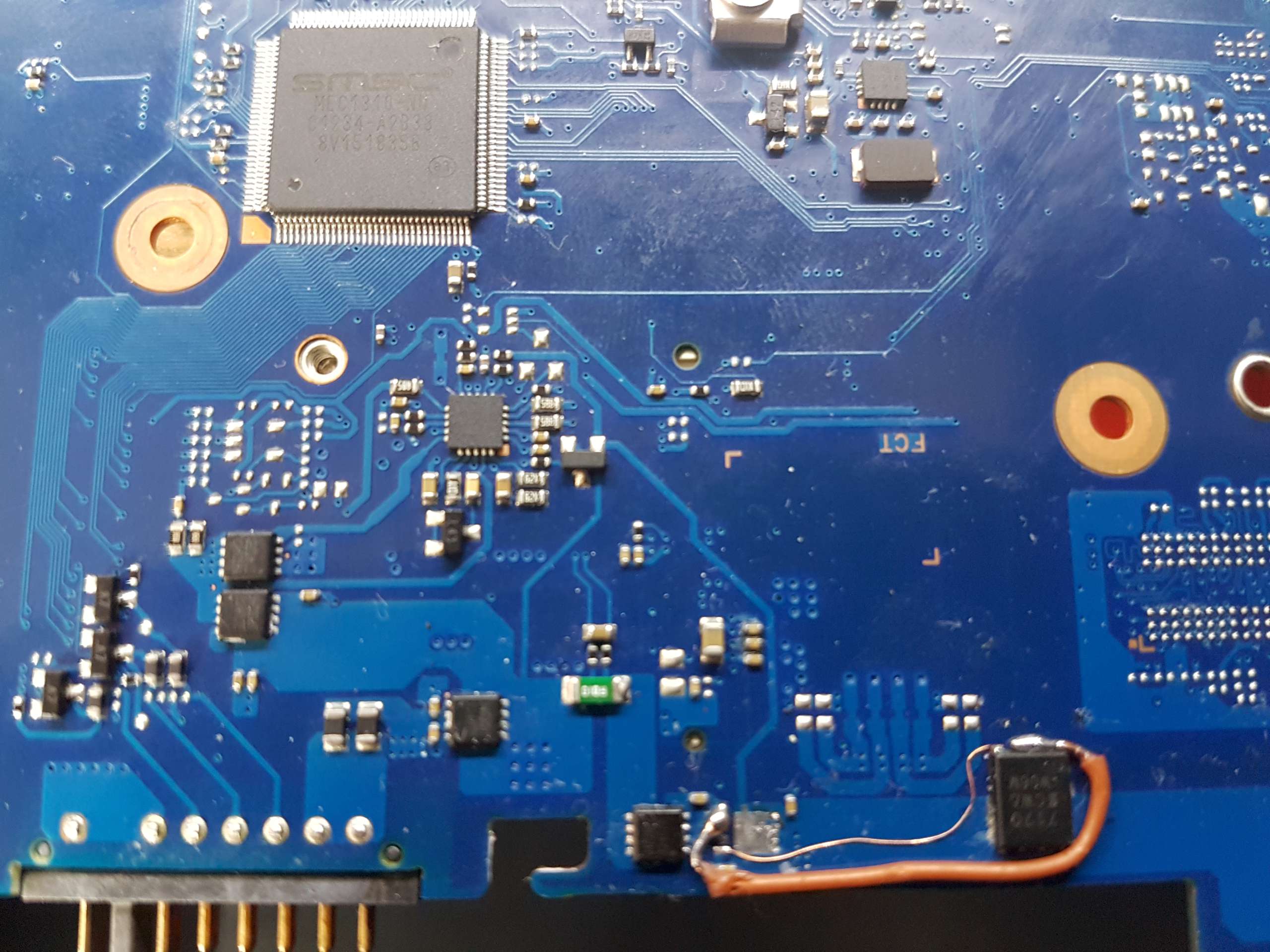

                                  Hi.
                                  With the correct schematic I was able to diagnose a bit more.
                                  The two resistors (marked in the picture I'm attaching) compose a voltage divider to sense then input DC in. What I noticed was the the bigger (in ohms) resistor resistance was floating, normally going down in resistance along with the temperature going down.
                                  If this resistor resistance goes down causes the voltage to go up and what I believe happens is that the IC detects that the input voltage is climbing and shuts down the FET.
                                  I don't know if I'm 100% correct, but I replaced the resistor with one of similar value and the notebook has been working flawlessly since then.
                                  Thank you for your help.
                                  Cheers.
                                    ic needs to have voltage from resistor divider to ACDET pin in some level/around 2.7V/ if it is more or lover than this level, it shuts down fets./see datasheet/
                                    on battery work normal
