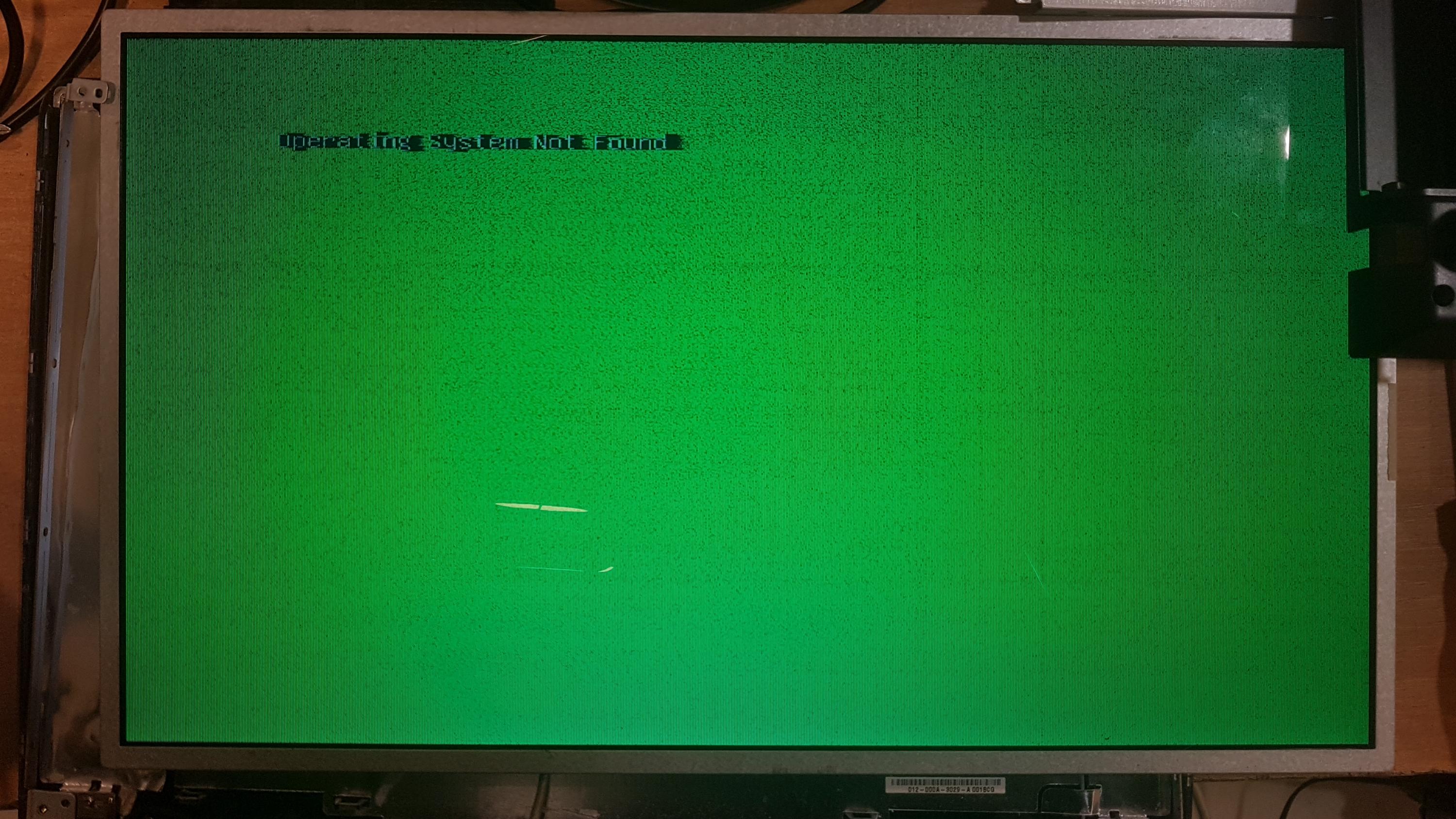

    Hi!
    What caused the pictured problem? Screen, cable, vga chip surely not. I have more laptops with this syndrome. One time i replaced the lcd cable socket on HP CQ56 motherboard. No luck. The colors varies per display, some display is only black with backlight.

    Re: Sony, HP, Tosi screen problem
    What do you get on external monitor?
    could be bad TCON on the lcd itself.
      Hi!
      Currently on Vaio RGB and hdmi ok. LCD and cable is ok for sure.
        Originally posted by Prosatanosz
        Hi!
        That means faulty laptop LCD, because it has light and shows color, it highly could be tcon, it could be swapped with new one.
          LCD is ok, tested on other laptop, and other lcds show same problems in Vaio

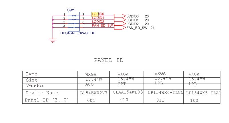

            • 20695
            Some of the older vaios have a small 4 way dipswitch on the motherboard that needs changing switch positions if you install another compatible LCD screen. Check the schematic . Flashing the EDID eeprom can also help in a few cases.
            EDIT: picture is from an MBX-202 M790 schematic. The switch has 4 positions, 0-3 for each different lcd. The 1`s and 0`s are binary,reading from right to left .
                Thx SMDFlea, but this is not the case.
                  • 20695
                  What model number is the vaio .
                    Pcg-71211m
                      • 20695
                      Pcg-71211m
                      Is the motherboard an MBX-224 M960 .Here`s a schematic, if its the right one ,check page 35 for the panel ID switch .
