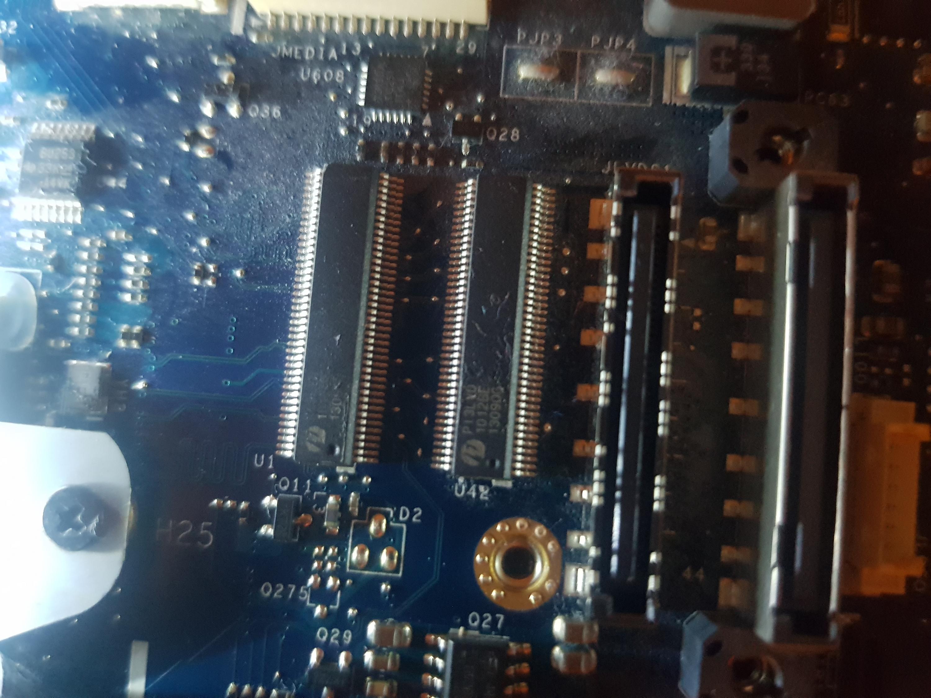

    Thats the suggestion at the last post in that forum,although he never posted again to say if replacing those IC`s fixed the problem or not . You know its not the cable or screen.
    Edit: http://*******/viewtopic.php?f=41&t=38172&p=456225
    1 million procent its not the cable, screen,videocard,processor....all of those i replaced and i still had the same problem. I ordered today the chip from china so i have too wait at least 3weeks i think

      If i desolder the component from a other laptop wil it work you think?
        • 20643
        Re: Alienware m17x r4 snowy screen..
        If you have a donor board ,yes its worth a try .
          Its from a acer motherboard is complete dead... its not a alienware.
            • 20643
            If the IC part number is the same its ok .
            • MJ-meo-dmt
              • May 2016
              • 186
              • South Africa
              What is the code on that board? Alienware is dell pretty much. LA-xxxx?
              This sounds like the LVDS translator/Controller/converter IC... not sure on the exact desc or name.... Do you have a Schematic?
              EDIT: I think this schematic is the right one, attached below.
              EDIT2: #_# ah I see that is indeed the chip(page28) mentioned from the other forum... anyways if you have another like that swap it should work just fine.
                I had a similar problem on an Asus laptop. But the customer did not give me time to fix it properly. Finally, I discovered that if uninstall Both the ATI and Intel Graphics drivers, the snow will disappears. So the customer was glad of this quick fix.
                there is a Graphics option in Bios. change it from switchable to something else. It may be fixed this way.
                Then, you can try replacing the LVDS multiplexer IC. It can be desoldered from any mainboard. I hope it is not faulty.

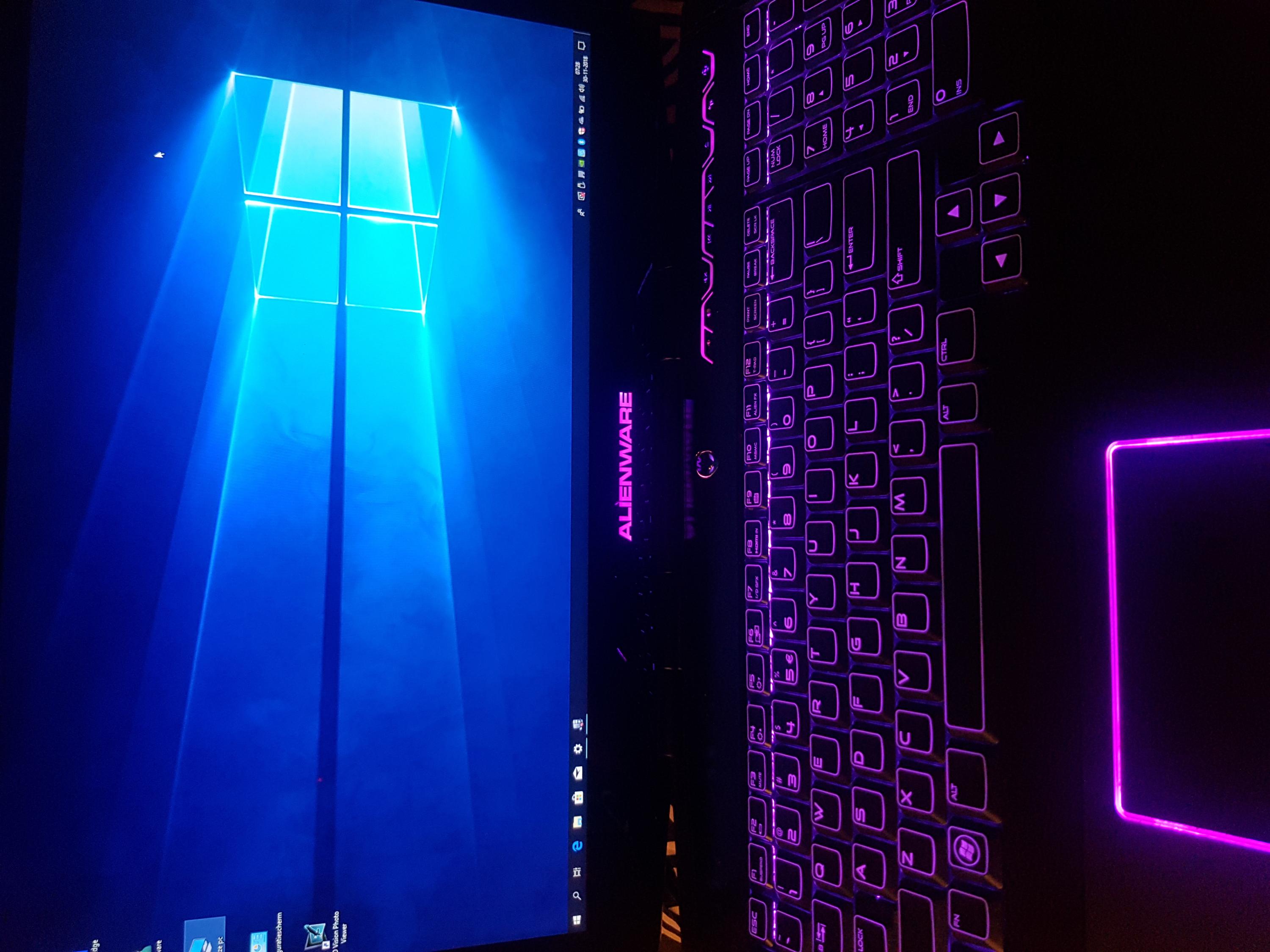

                  Its fixxedddd it was indeed the chip😁😁..... there where 2 of those chips. I replaced the one near the connector.
                  Thank you very much😁

                    #29
                    It was this ic PI3LVD1012BE its running fine now
