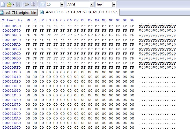

    hi, got this laptop one month ago with a freezing problem. it has only one bga for nb sb and cpu. its cpu is n2840.
    i ordered stencil for reballing the chip from goldenchipset, but when i melted the 0.35mm bals, when lifting the stencil some pad ripped off and other balls didnt melt on bga. i looked and investigate the situation and found that balls holes on stencil were not the right dimention. i asked gc and they would send me a new stencil, but as far some pads were ripped off i got a refurbished bga too with already leaded balls on it.
    when bga arrived, i soldered properly, but got a white screen.
    i gived then another reflow and now this time i have black screen.
    what could be the cause ?
    i removed bios, its a winbond 25q64fv, but when i put on my programmer it tell me chip is different.... and im not able to program it.
    now i will put some other bios with a dump i got from internet and ggive it a try, but would like to know if someone got already in the same situation and why white screen and then after a reflow black screen ?
    edit: tried 2 bios dump ive found on internet, but with that bioses pc wont even start.

    What bios programmer do you have. The dumps you got ,did they have a clean ME area .

        here is a dump of original bios even if it told me chip mismatch. my programmer is a sofi sp8-a and it read well similar bioses.
        u think bga is soldered bad or bga is defective ?
        original = my bios
        the other 2 1 is without me i think and one with, but both dont make notebook start.
        other is tool to save bios from windows...

            The 25q64fv is in the sofi supported bios list.Do you have the latest software
              • 21899
              Re: acer es1-711 problem..... white screen and now black screen

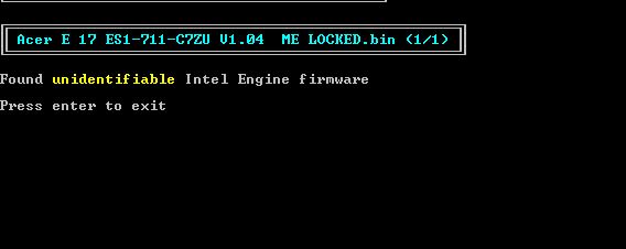

              Your original bios has a ME area , the other bios (Acer E 17 ES1-711-C7ZU V1.04 ME LOCKED.bin) doesn`t

                i have programmed a 25q64fv without problem, just this acer bios give me problem...
                and as i sayd original make pc start with black screen, while the other bioses make pc like dead

                      The EC file is the 4MB one , the bios is 8MB . For what its worth i`ve added clean ME firmware to your original bios, and added ME firmware to the other (locked) bios. Flash the original cleaned bios first and try it. If you try the other bios,flash the EC bios as well ,back it up first if you do .

                          today i treied both original bios with me removed and the bios found on internet with me added. none of them make notebook light to come up, like notebook is totally dead.

                            Try flashing your original bios back or the one with clean ME at post #11 . What part number is the motherboard,including rev number.
