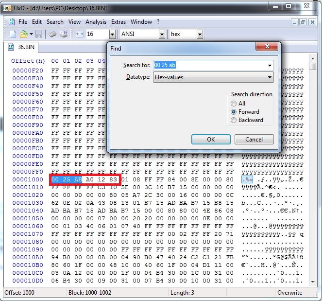

    i want to change mac address by hex editor i search for 00-25-AB-A0-12-83
    but icould not find mac ... can u help me ?

          Re: change mac address by hex editor
          its on 2 places
          0x1000
          0x2000
          i think you need to change both
          also look at small eproms around nic (lan, eth) chip
          it might load mac from tehre and copy it to main bios
          see pic
            i will try ... thanks bro
