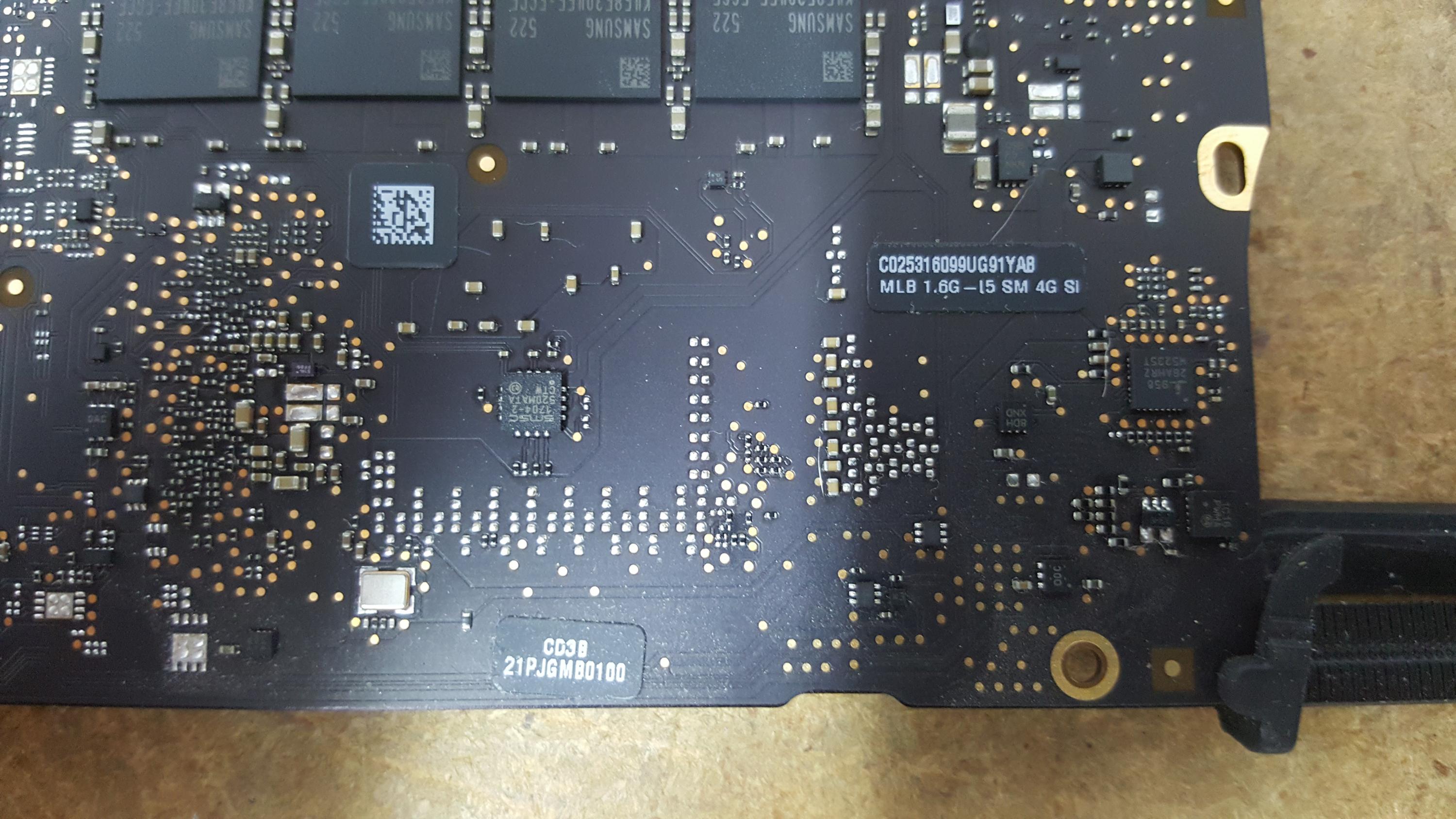

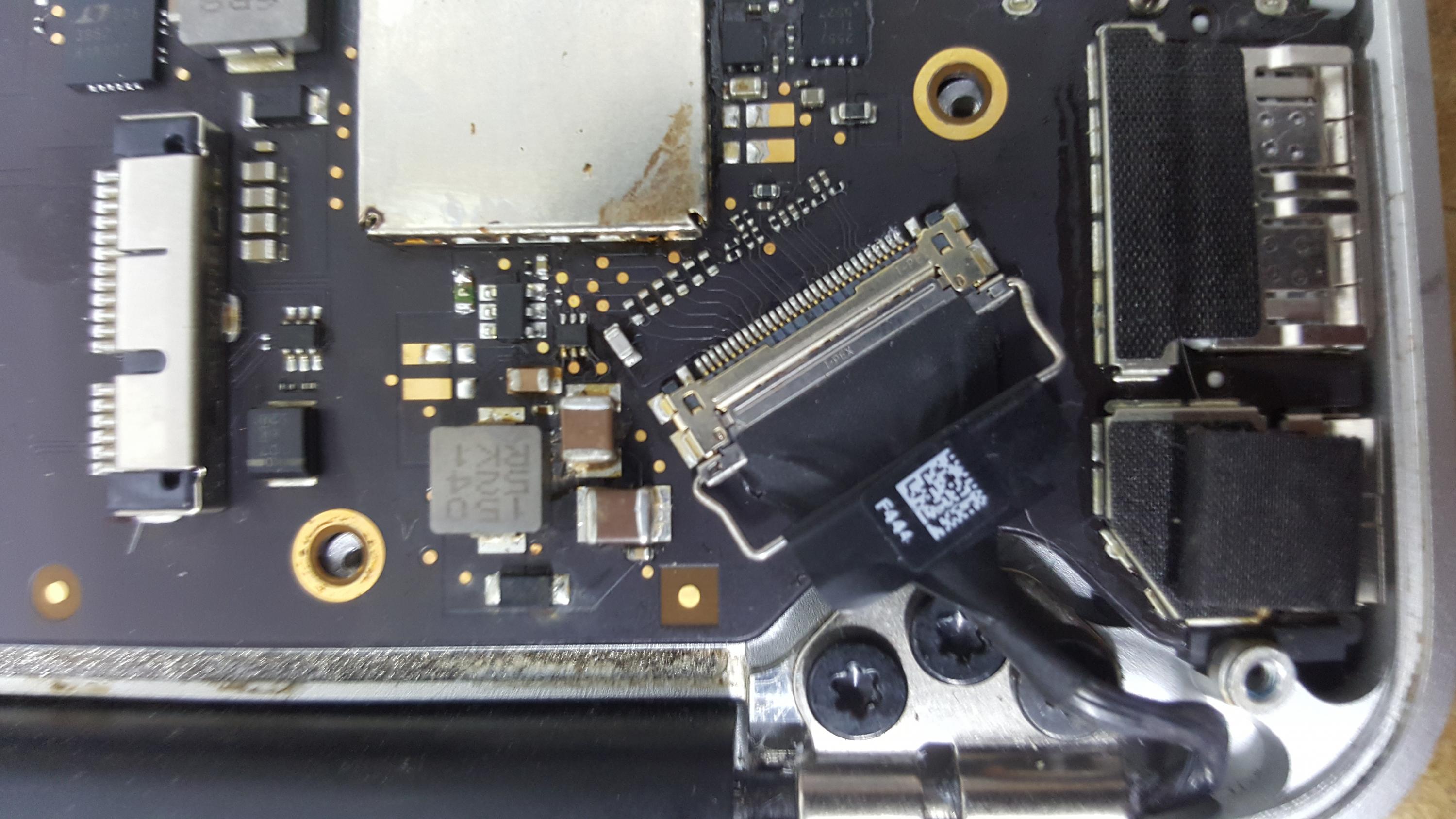

    Backlight not functioning. Fuse was blown, replaced and still no backlight.
    Does anyone have the board viewer for this one? I have the pdf schematics but I don't see the LVDS connector anywhere and I have no clue where these SMDs are on the board. IIRC the last 3 or so pins are for the backlight, they are at 0V.

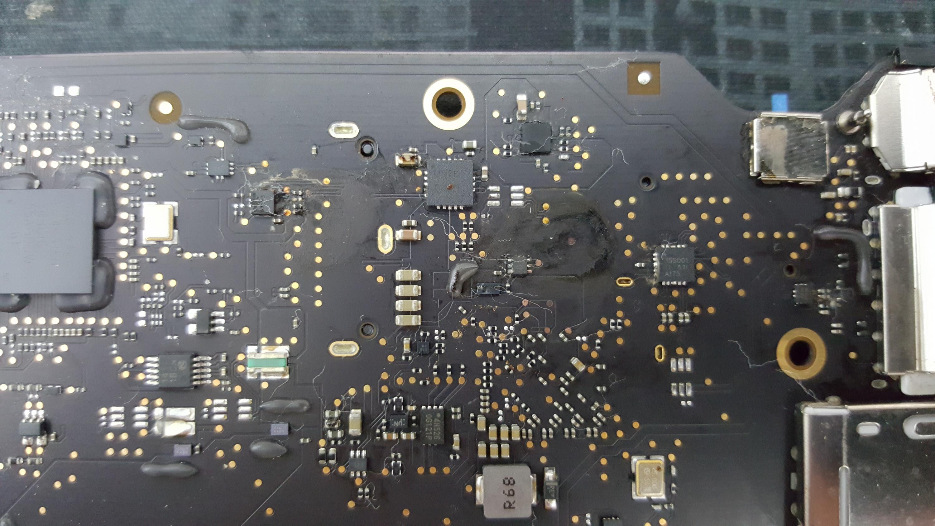

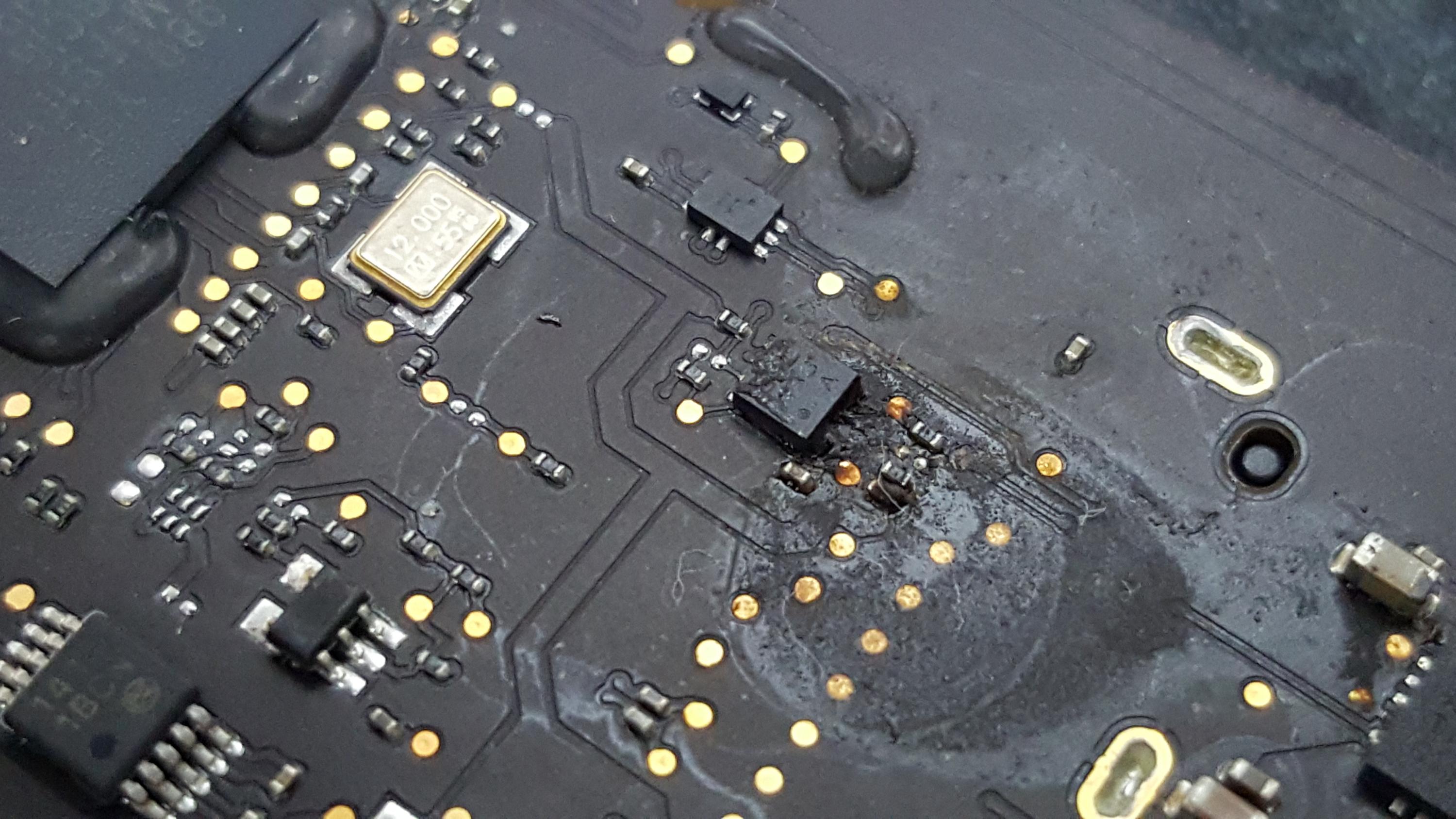

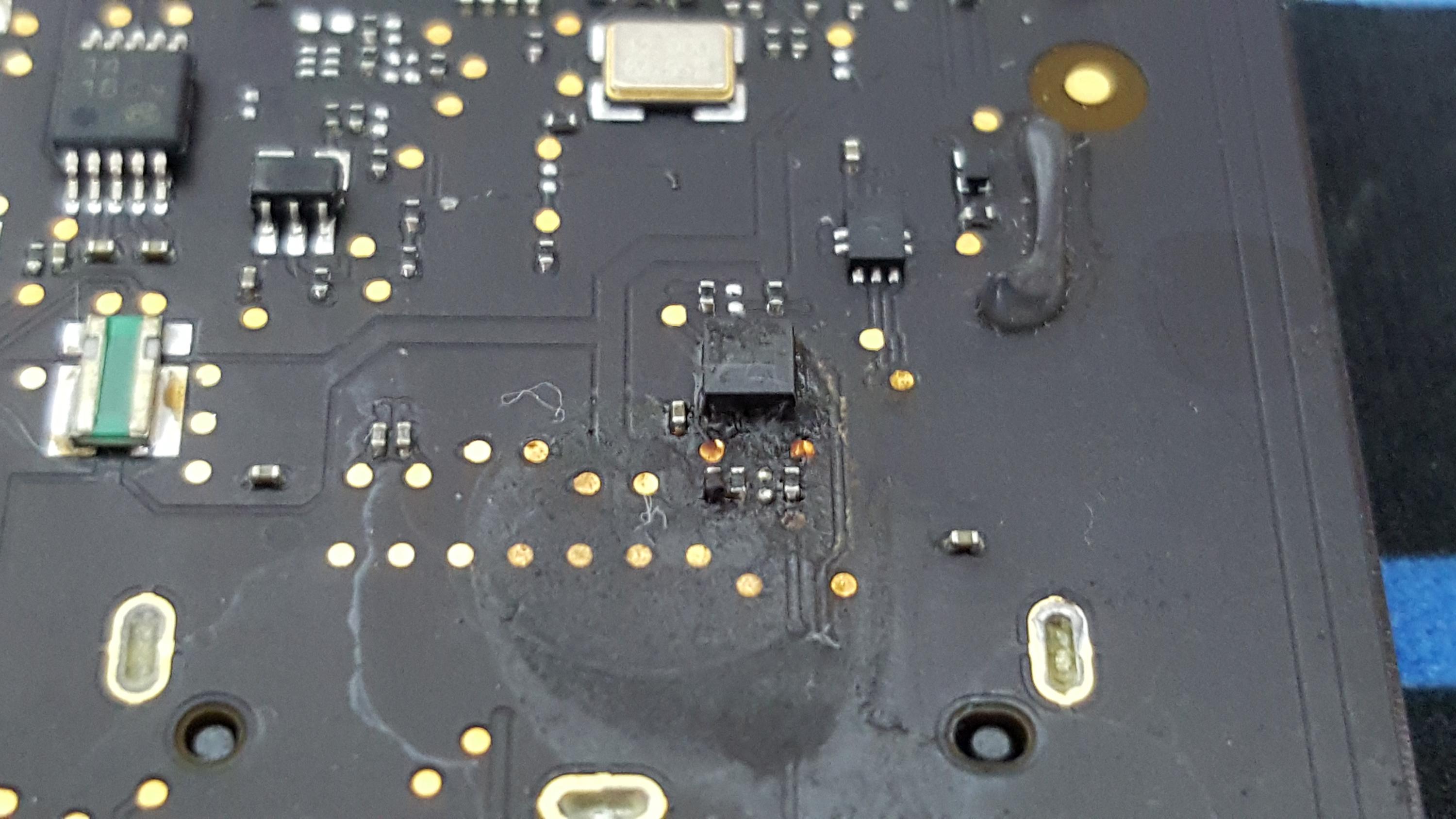

    It looks like it was liquid damaged. Look at pics of the backside of board with the buildup. I cleaned up that chip a little more and can see the pins again but it still looks nasty.

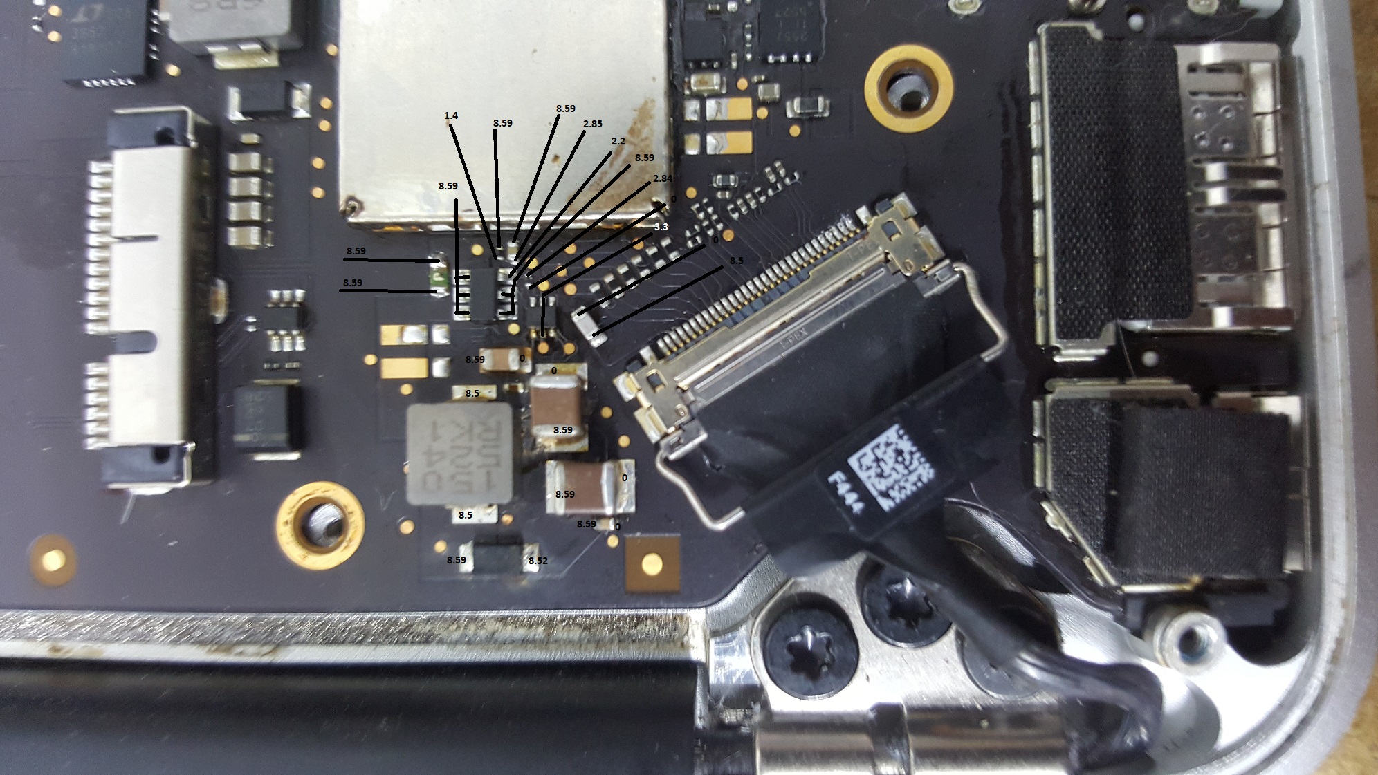

    I took some voltage measurements on the top side of the board (last pic), not even sure if that's all for the BL circuit or not.

        There appears to be a problem in/around U7701. PPBUS_G3H is supposed to be 8.6V, and it is. But U7701 is supposed to cycle an internal FET to generate a higher voltage on the inductor L7701, which then passes through the diode D7701. You are reading 8.6V the whole way through.
        Make sure the inputs to U7701 look good. (e.g. the EN pin is high, there's voltage on FB and SW_x pins, etc). If it all looks good, then U7701 is probably bad.

            Re: Macbook Air A1466 820-00165-A Backlight
            Thanks all for the responses.
            I did recheck the fuse and it is good.
            BKL_EN is 2.86 . This appears not correct. 8.59V*100K/(100k+200k) = 5.72v. If I calculated the voltage divider properly. Vout=Vin*R2/(R1+R2) for voltage divider? Should I pull the resistors and check them out of circuit? Incircuit r1 was 70K. R2 I could get a slow build up to 170K and if I removed a probe and checked again it would show 600K.
            PPVIN_S0SW_LCDBKLT is 8.59
            PPVOUT_SW_LCDBKLT_FB is 8.54. I cant find XW7220 but it looks like the test pad is in the right place and that's where I tested.
