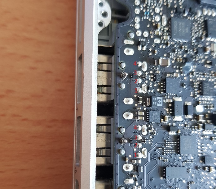

    Hi, I've got a MacBook Pro 13' Early 2011 board 820-2565-A.
    The 2x USB ports have 5V power and power my flash drive and USB hard drive (LED's light up/hard drive spins) but they do not get recognized by the OS nor in boot options by holding "Options" key on boot with a confirmed working USB install of Mac OS X.
    I have done a full wipe/reinstall of MacOS X (via online recovery reinstall) and done SMC and other resets but the problem still remains, USB devices get power but are not recognized in OS nor boot options.
    I have attached the schematics and board view.

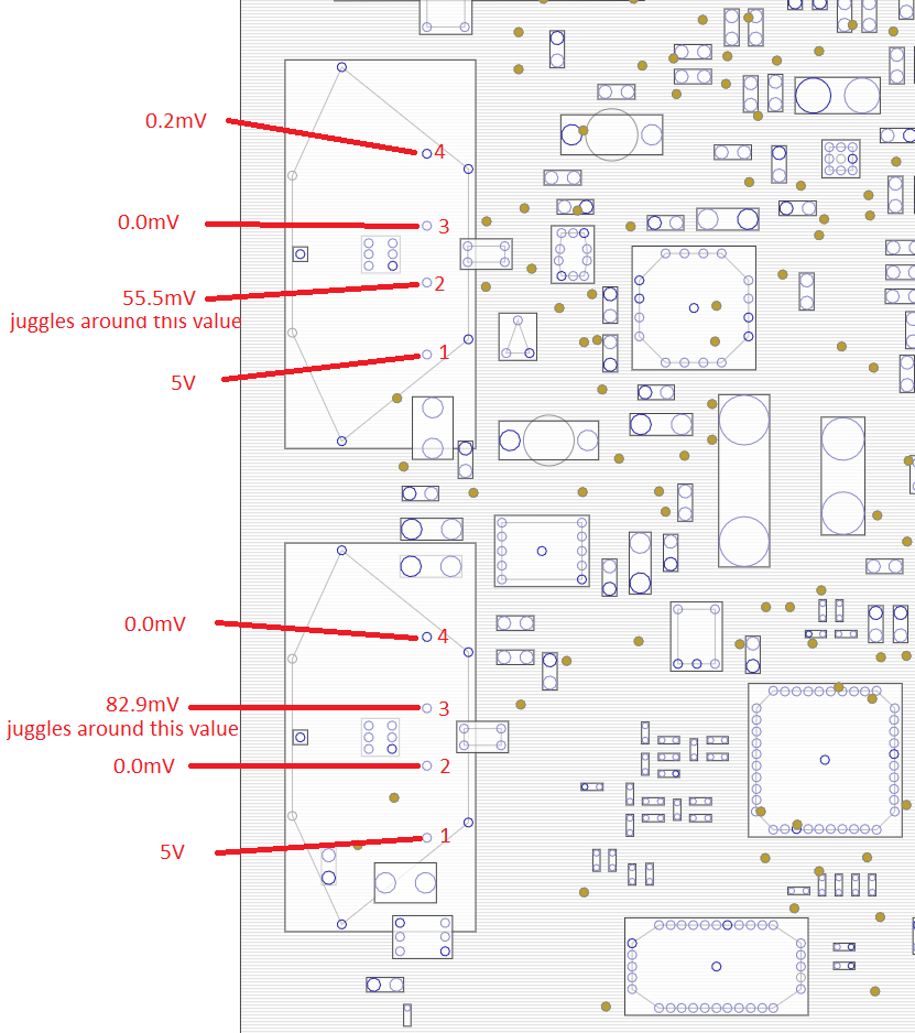

                Here are the measurements from the USB port pins. I'm not sure they look right?

                          measure resistance to GND on pin 2 and 3 of both the two USB ports when the power is disconnected.
                            It started around 10.00m ohms and went up to 40.00m ohms then went O.L, it then starts dropping when I remove the multimeter probs

                              Re: MacBook Pro USB slots unrecognizable
                              The resistance values seem fine. Now, turn the laptop on and connect a USB mouse to each one of the two USB ports and measure voltage on pin 2 and 3 of them.
                                3. 0.0mV
                                2. 4.87V
                                3. 1.8mV
                                2. Juggles between 3.178V and 3.180V
