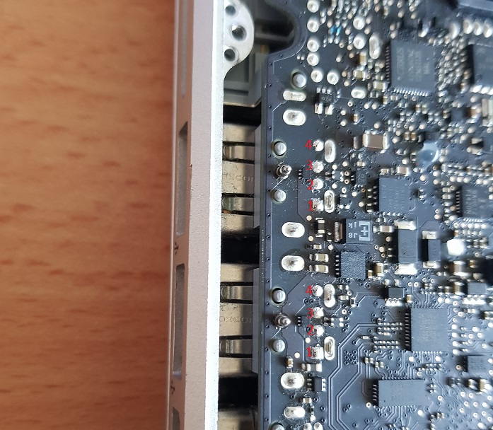

      Here are the good voltages from the board with working USB ports:
      With USB mouse connected:
      4. 0.0mV
      3. 7.1mV without mouse moving
      2. 3.075V
      1. 5.04V
      4. 0.0mV
      3. 13.1mV without mouse moving
      2. 3.060V
      1. 5.04V
      Without USB mouse connected:
      4. 0.0mV
      3. 0.3mV
      2. 0.3mV
      1. 5.04V
      4. 0.0mV
      3. 0.3mV
      2. 0.3mV
      1. 5.04V

        Here are the bad voltages from the board I am fixing:
        4. 0.0mV
        3. 1.0mV
        2. 4.88V
        1. 5.00V (This voltage drops to 4.95V with USB hard drive connected)
        4. 0.0mV
        3. 2.9mV
        2. 3.184V
        4. 0.0mV
        3. 0.9mV
        2. 40.0mV was around here and kept slowy rising
        1. 5.00V
        4. 0.1mV
        3. 70.0mV was around here and kept slowy rising but kept going up and down about 0.5mV and still rising
        2. 1.1mV
        1. 5.00V

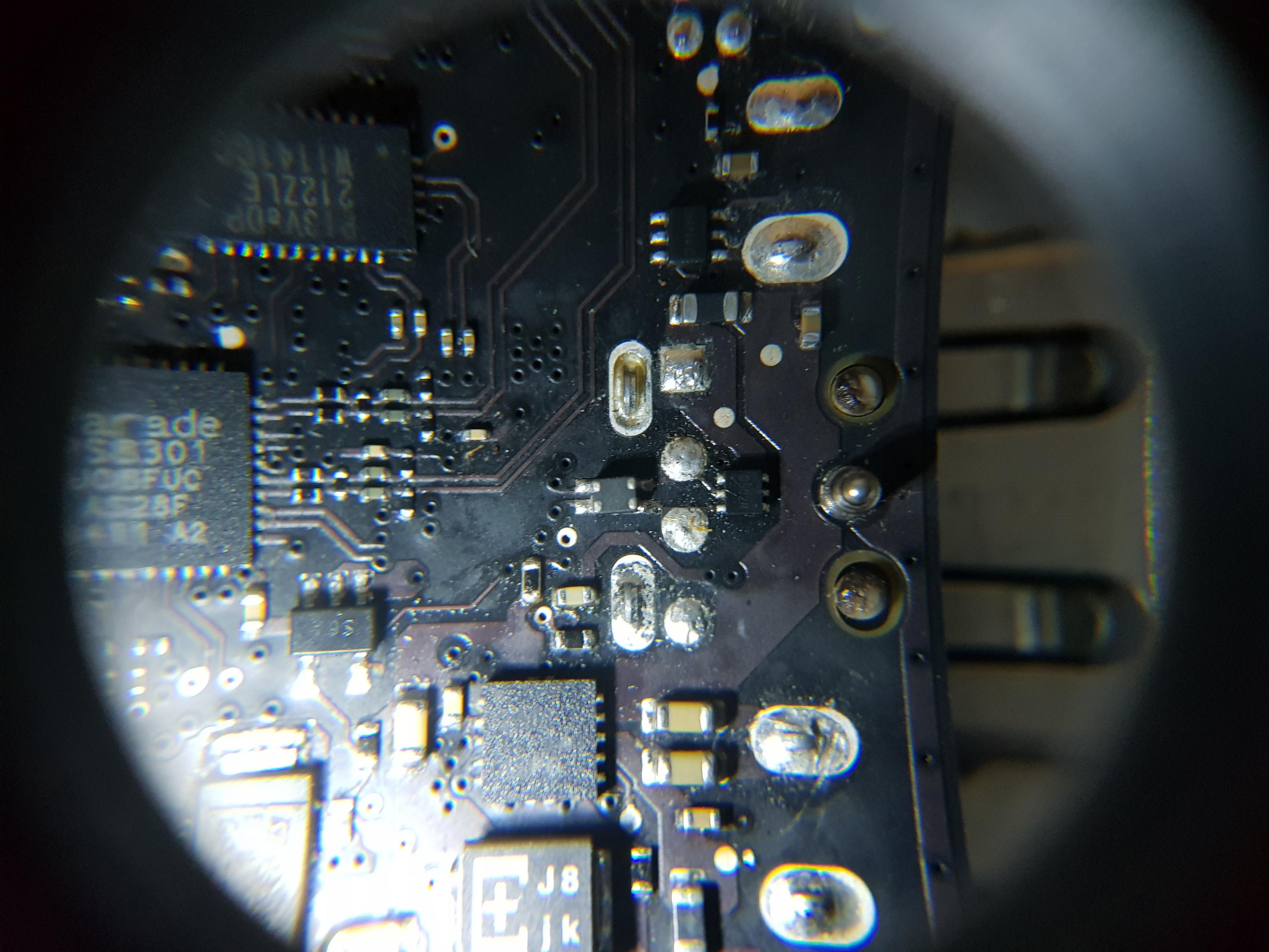

                  The filters L4600 and L4610 don't look right. The same voltage should pass through all pins. The working board has 0.3mV on all pins of L4600 and L4610.

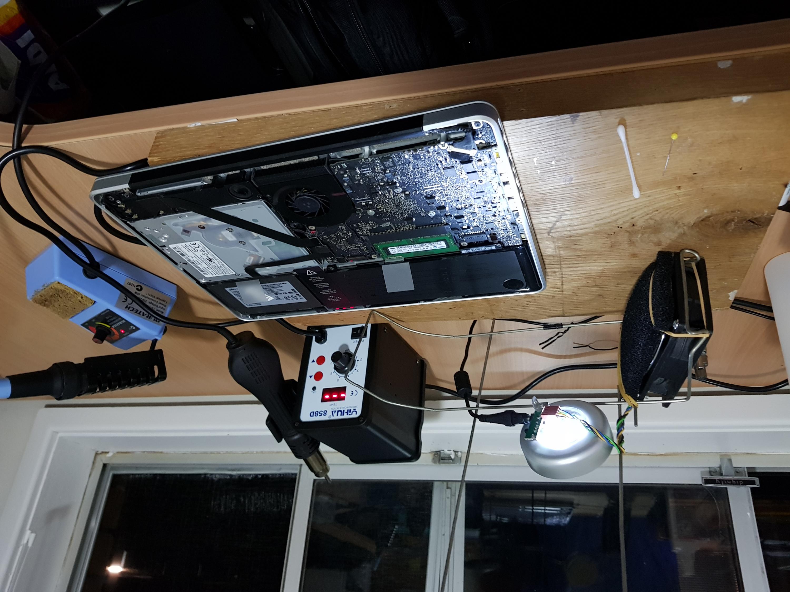

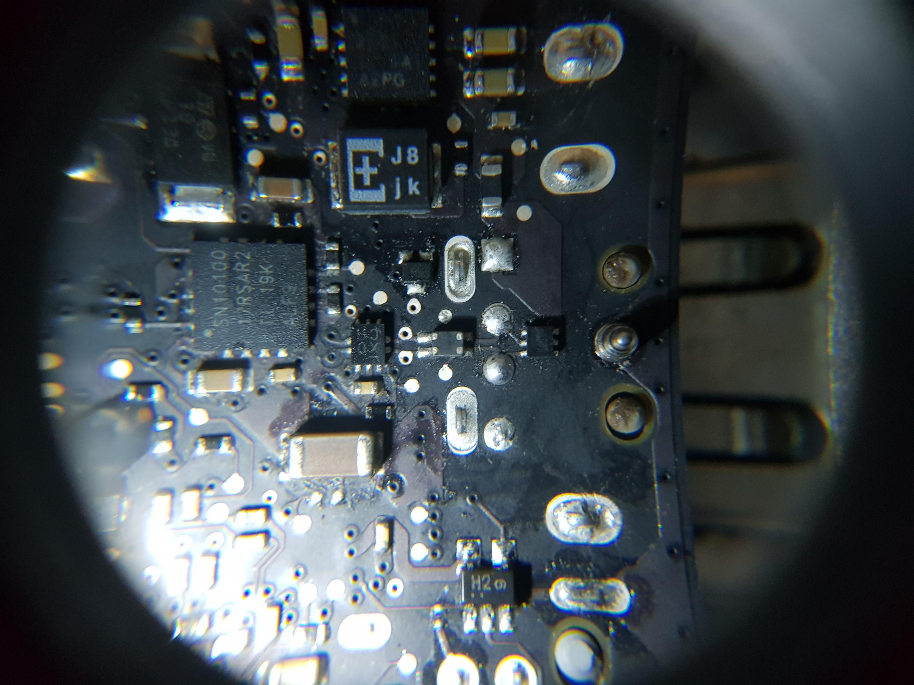

                          Success!! My YIHUA 858D arrived yesterday and I've replaced L4600 and L4610 from a dead donor board successfully
                          Both USB ports are now working, thank you Caspian for the tech help once again and DjBigman for referring me to Loius Rossman as his videos were a big help
                          Don't know why the third picture is uploading upside down.

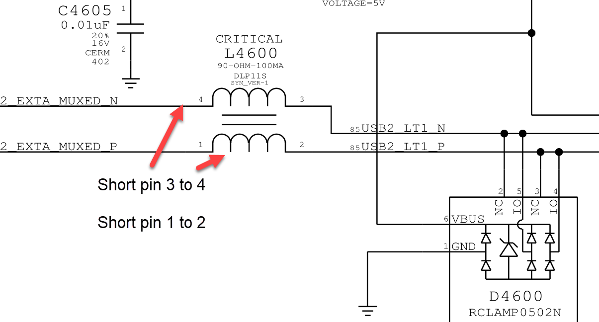

                            Hi, I don't have a donor board to replace L4600. Does anyone know what kind of part this is and where can I purchase this part?
                            • mon2
                              • Dec 2019
                              • 13995
                              #34
                              Re: MacBook Pro USB slots unrecognizable
                              L4600 is an EMI filter that is common to use to filter out noise on USB D+/D- lines.
                              We use them in our product designs all the time. The footprints do vary.
                              They are technically not required so you can, for now, remove this 4 pad SMD part and bridge then as straight through. Often you can apply a solder blob in series to allow for the D+ to bridge to the downstream D+ and then D- to D-.
                              Be sure to NOT short D+ to D-.
                              Then you can test again to see if the USB port is working.
                              The part listed in the schematic is from Murata but is very common to source from other vendors.
                              Murata DLP11S EMI filter:
                              DLP11SA900HL2L (believe this one should work fine)
                              https://www.arrow.com/en/products/dl...-manufacturing
                              hope this helps.
