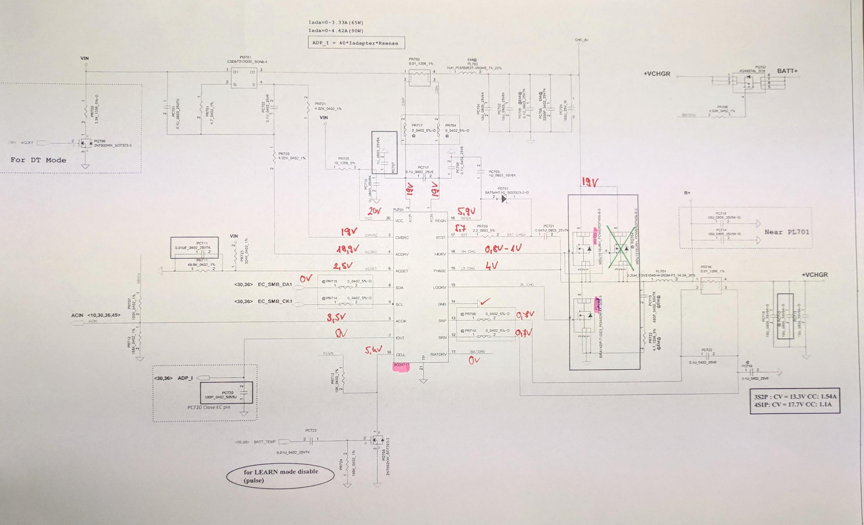

I have a Dell inspiron 15R-5537
MB num:LA-9982P
If the battery is inside, works fine. When i plug the adapter it show short circuit.
I looked power circuit and found a bad capacitor. So i remove it and check again the problem is solved. Try turn on with dc adapter but not work.
The problem is PQ703 does not open. I took it off and it was good and same PQ705. The PQ704 is not on the motherboard.
Measure some voltage (In adapter mode), but i think everything ok.
I changed: BQ24717
Any ideas?
Link to schematic - https://www.badcaps.net/forum/showthread.php?t=122412
