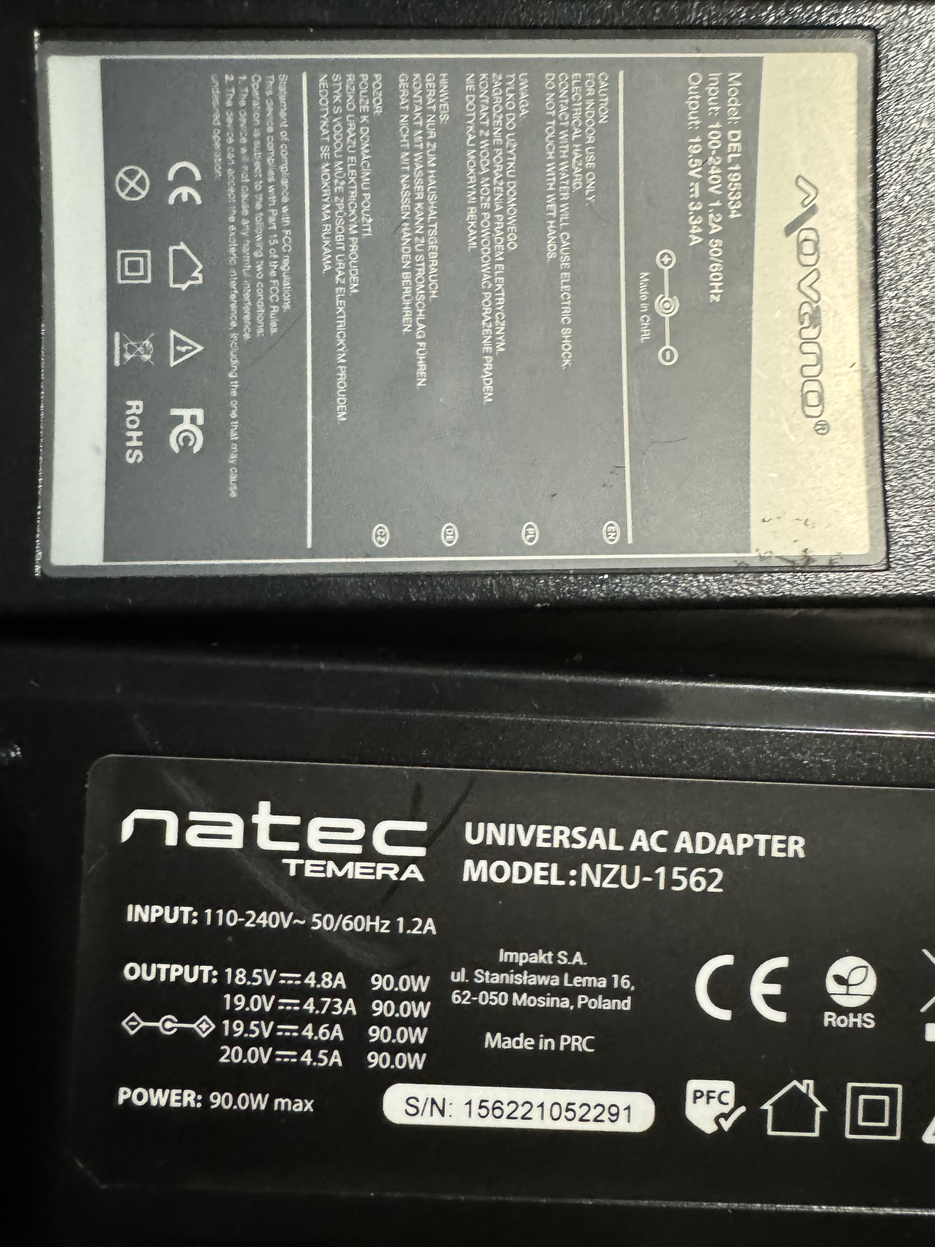

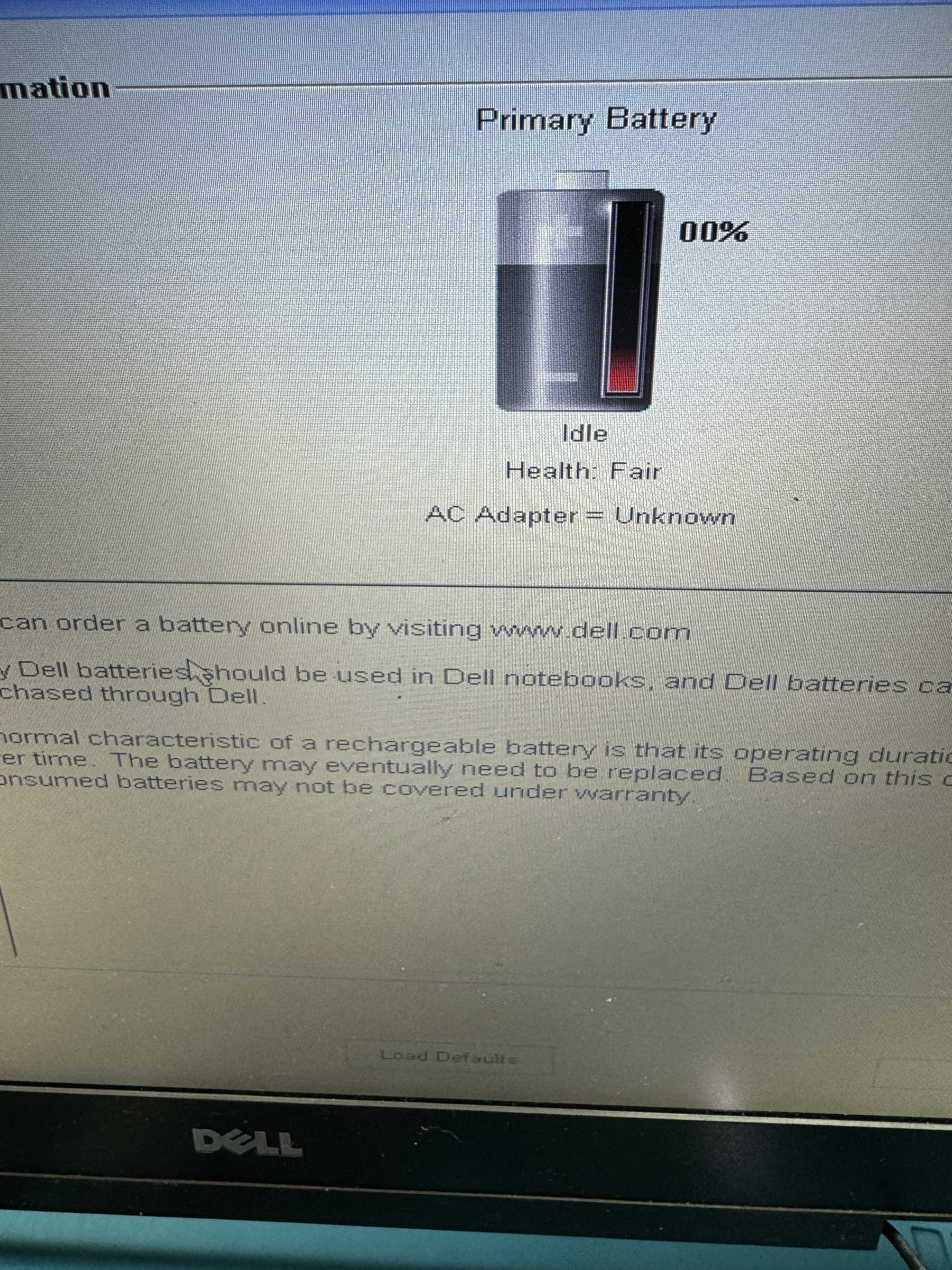

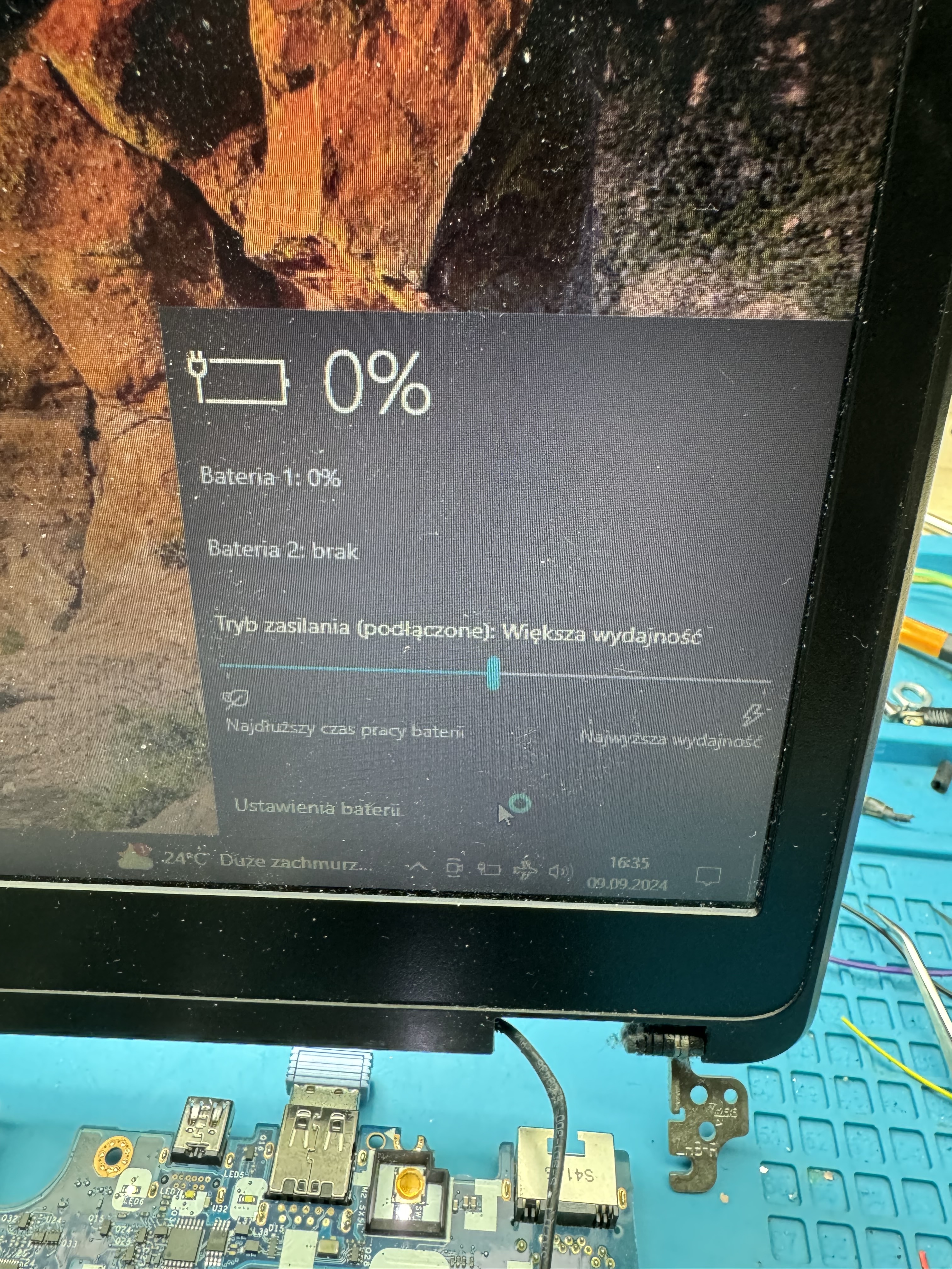

    Hi, i have problem with dell E7440, battery is not charging. Idk all story. Original Dell Adapter broken up (its not give 19V) i guess first ac adapter broken up and it broken charging circuit in laptop. Laptop has clone battery (Green Cell)
    Laptop works on clone adapter, and its not charging battery. Like on photo. I checked mosfets near battery plug. They are not shorted. But on PQ809 and PQ810 are low on diode mode (both 0.25V) I desoldered them and check on bench and they are good both 0.5V on diode mode. I checked only drain - source way. So its board circuit it should be higher, i guess.

    What are the details of the power adapter as reported by the BIOS? Do the specs match what is required for this exact laptop? If the power specs are lower (wattage) than expected, then the laptop will be throttled and the battery will not be charged.
