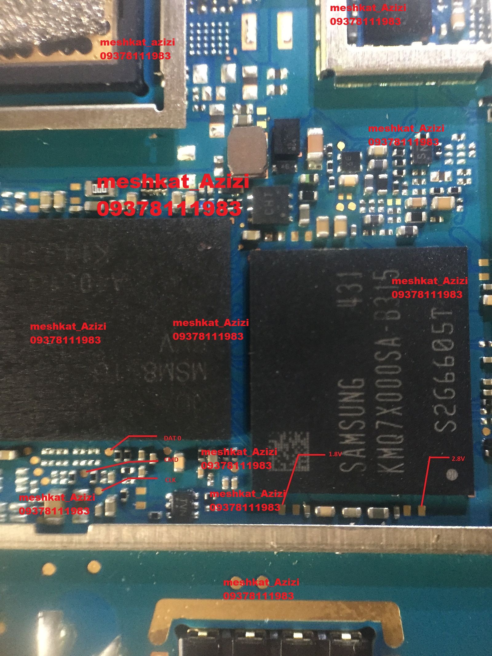

    So I need to dump the flash from an HTC Desire 510 cell phone. I did something similar with a 3DS a while back. I used a MicroSD to SD adapter, tore it apart, soldered some wires onto it, put it back together, and then soldered the wires to the 3DS.
    I've attached a picture of the MicroSD pinout.
    My memory is a bit messed up, so I'm having some trouble remembering stuff and wanted to make sure I'm doing this right. For the phone, I believe I know where CMD, CLK, DAT0, 1.8V and 2.8V are located. With the 3DS, I remember there being more DAT#'s.
    In the picture, do I just hook 4 (VDD) to the voltage source (1.8V or 2.8V), then pin 7 to DAT0, pin 5 to CLK, and pin 3 to CMD?
    There's a tin cover over all the chips that I have to unsolder later today, then I can post pictures. I found the pin outs of the eMMC stuff using the internet.
    I think the card reader in my computer provides the power to the eMMC on the phone. I think this voltage is 2.7V, so I should be able to hook pin 4 right up to the 2.8V point on the phone and be good, right?
    Here's a pic I found on the net of the pinouts for the eMMC for the Desire 510. Like I said, later, I'll take my own pictures and verify it's the same and everything.

    sd cards are 3.3v - dont blow your flash up
    why do you need to dump it?
    fastboot can dump the partitions over usb.

        This adapter I used worked with the 3DS without me needing to modify anything. It's an MicroSD-to-SD adapter.
        The phone has a PIN that we're trying to recover. If I used a resistor to drop it down to 2.8V, we should be good though, right?
        I could just plug the adapter into my card reader and use DD to dump it, right? I cannot remember how I did it with the 3DS. I remember soldering stuff, but I don't remember if there were special drivers or modules that I needed to install or what. I can't remember if I did it in Windows or Linux. It was a while ago.

          I don't think that will work. This is a BGA type chip. I have the pinouts for the eMMC stuff, I don't see why I just can't do it the way I did with the 3DS. Essentially, the same thing, right?

            That picture of the PCB isn't the right one. This has a Hynix BGA type flash chip in it. The phone on the back says:
            Code:
             HTC0PCV1   FCC ID: NM80PCV100
            0PCV100 5VDC == 1A
            I'll start searching for the eMMC pinouts for the 0PCV100.

              the ebay unit is a level translator, you use it between your reader & the chip.
              can you boot into fastboot?
              (volume down + power)

                We can reset the phone. We just cannot physically get into the phone. I have it torn apart right now, but I believe we'd be able to get into fast mode. Why, is there away to recover the pin or dump the flash without resetting the phone using fastboot?
                The flash is a Sk Hynix h26m31001hpr, if that helps.
                From what I've been reading, the programming voltage for this chip is 3.3VDC. So perhaps if I find the pinouts, it'd work? A Sk Hynix model number decoder lists it as an MMC.
