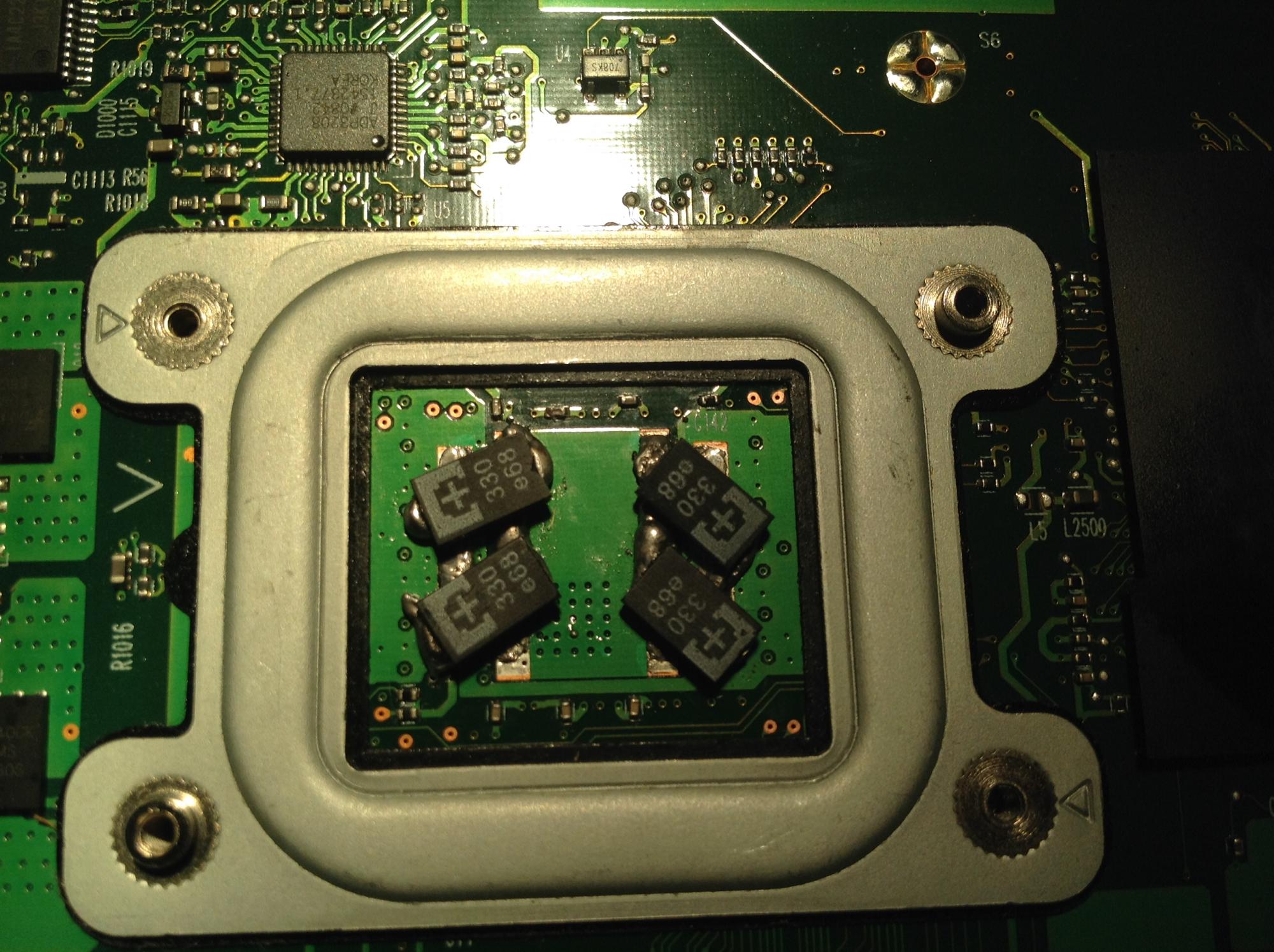

    Can you put a Clear image of that capacitor installation. and check the voltage at that capacitor.

      Photo taken of new capacitors . Have attached image .hopefully shows up .
      How would I test that voltage , I have a basic multimeter but where and how should I test ?
      As mentioned Laptop seems to power on ok just blank screen ? Would that be the capacitors or something else ?

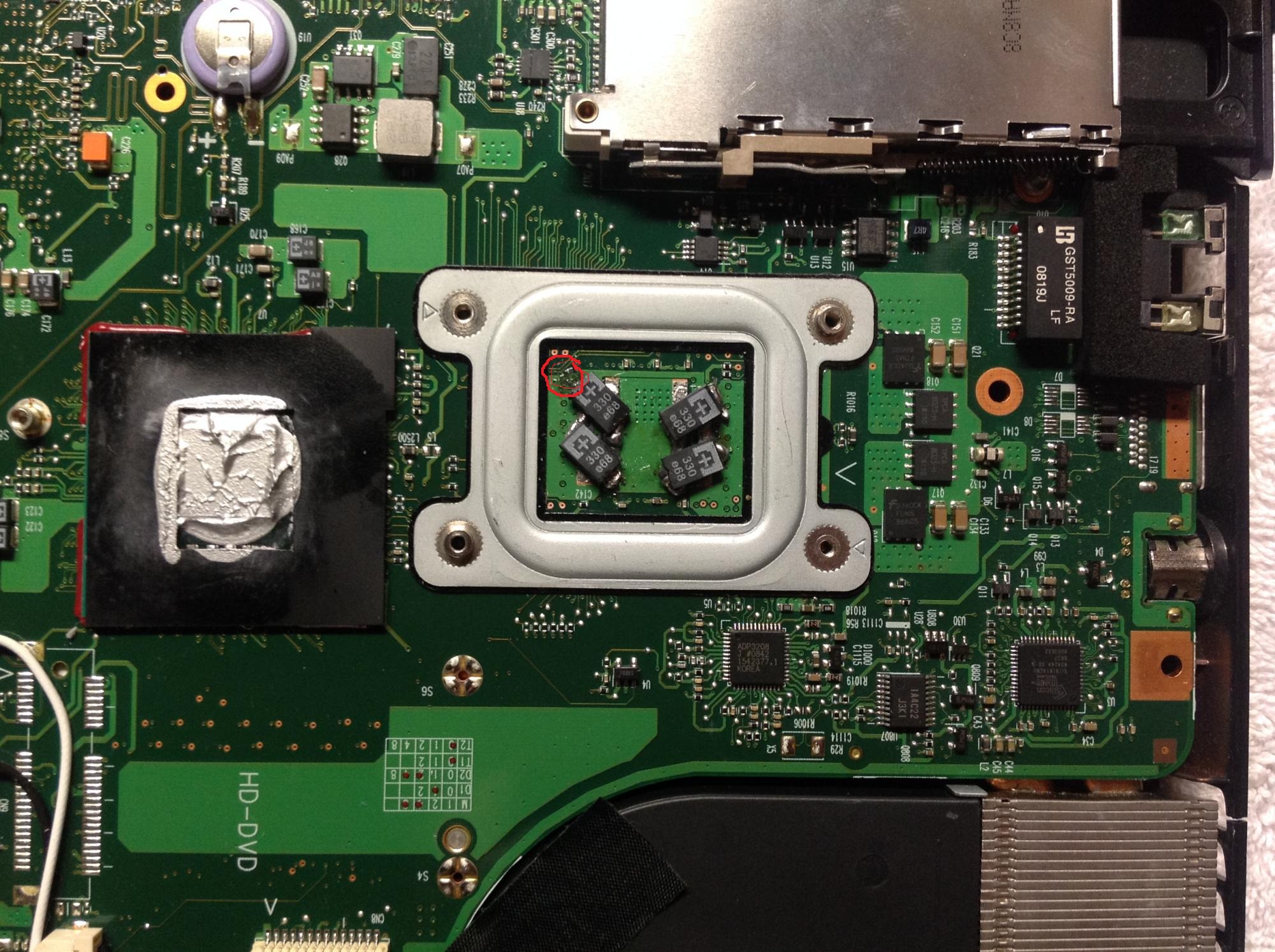

                        those capacitors dont look correct to me . are they correct size ?

                            Capacitors are brand new came in sealed plastic - from eBay from Portugal reputable seller . For that correct purpose so as far as I know correct size.
                            I have remover CPU (if that's square thing many pins on it) twice now but will try again , has no bent pins but very loose fit , when took out was very easy and to replace basically dropped in then twisted plastic screw half turn to lock in.
                            just cleaned area - where is PCB line to check ? - I removed old capacitor as per YouTube video and was very gentle and careful don't think I damaged surrounding area - soldering was fairly quick so don't think got to hot or anything , but don't know .
                            Closer photo attached .
                            Thanks again for help Mark

                              Try to unsolder the small battery (pink color-this is the RTC battery mentioned above),
                              leave the board ~1 minute without voltage and try again. Also measure its voltage please when you have it out.
