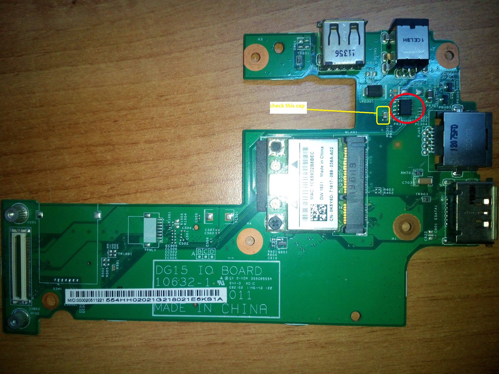

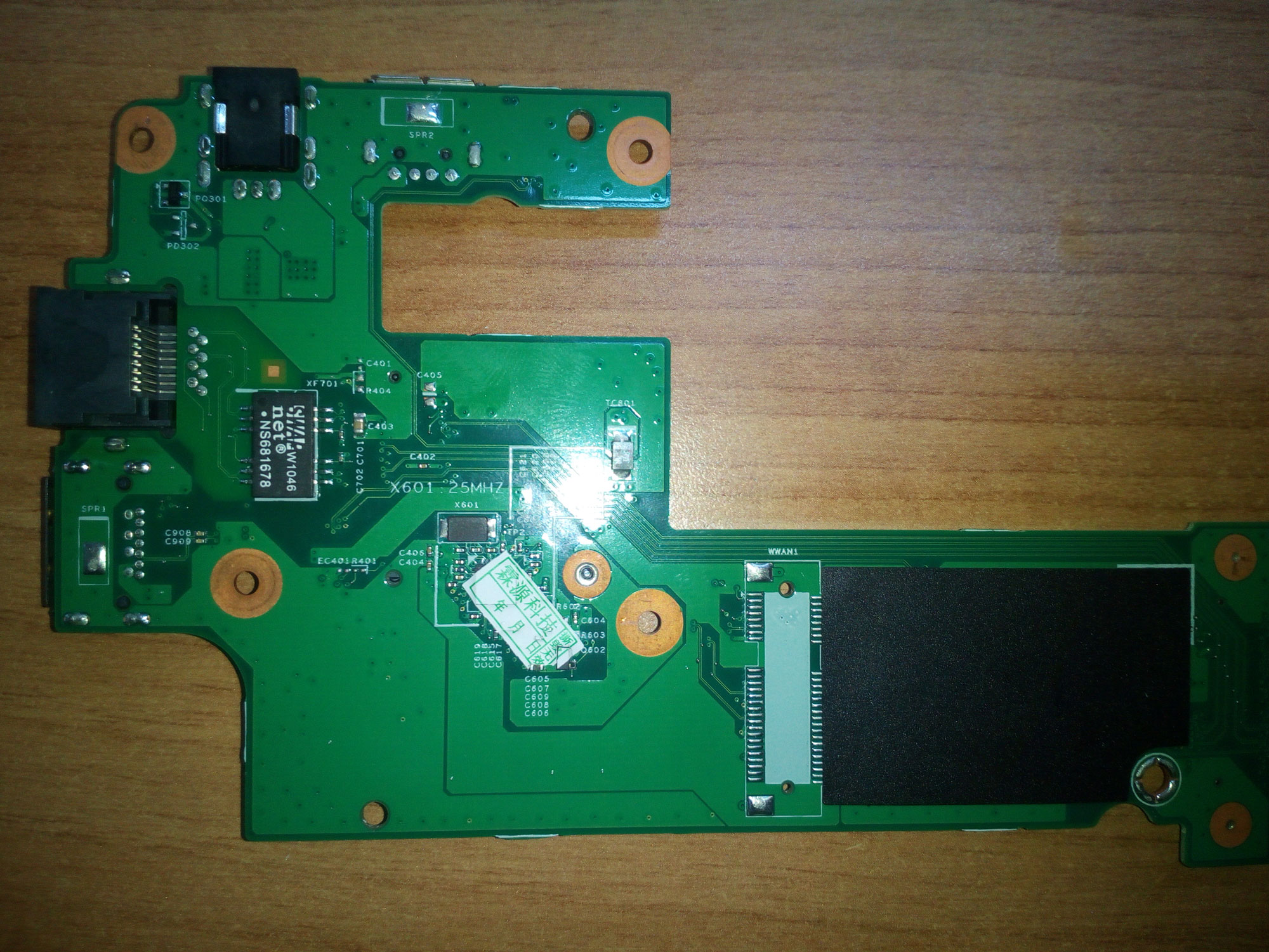

Dell 15R short circuit in io board
  • rippergr
    • May 2014
    • 345
    • Ελλάδα
    Dell 15R short circuit in io board
    Hello all,
    I have a Dell 15R laptop which when I give it 19,5V in DG15 io board it short circuit.
    I use a bench power supply and giving 19,5V it heat the mosfet PU301(mosfet in red circle in pictures). When I measure it with multimeter it seems ok.
    If I give it less power (4v) in 1,2,3,4 pin I have ~2,5V .
    In PD301,PC301 and PR310 I have the voltage that I give with power supply
    I can't understand if the problem is that mosfet or another component.
  • dellxps15
    • Feb 2014
    • 1588
    • italy
    Re: Dell 15R short circuit in io board
    does it give short with multimeter? if u remove mosfet wich pins are shorted?
    • polytek
      • Dec 2013
      • 496
      • TUNISIA
      Re: Dell 15R short circuit in io board
      check the ceramic cap
      • peste
        • Dec 2016
        • 12600
        • ROMANIA
        Re: Dell 15R short circuit in io board
        check without wifi card
        • rippergr
          • May 2014
          • 345
          • Ελλάδα
          Re: Dell 15R short circuit in io board
          Originally posted by peste
          check without wifi card
          I already tried it this way and it's the same.
          • rippergr
            • May 2014
            • 345
            • Ελλάδα
            Re: Dell 15R short circuit in io board
            Originally posted by dellxps15
            does it give short with multimeter? if u remove mosfet wich pins are shorted?
            Pins 5-8 are short with ground 1-4 are not.
            I haven't removed it from board I check the mosfet on circuit without power.
            • rippergr
              • May 2014
              • 345
              • Ελλάδα
              Re: Dell 15R short circuit in io board
              Originally posted by polytek
              check the ceramic cap
              This cap when I give 3V-4V it measures the same as the voltage I input.
              How can I check it?
              • dellxps15
                • Feb 2014
                • 1588
                • italy
                Re: Dell 15R short circuit in io board
                remove pu301 and put 5 volt on pin 5. check if pc303 pc304 pc305 pc306 get hot and wich one.... just put 5 volt and see if any of them get hot, but however remove voltage after max 10-15 seconds; quickyer u check if any of them get hot better it is.
                if none of them get hot, that voltage go to the connector. check big connector that goes to mainboard if pins 50,52,54,56,58 are ok
                ps: from the picture try just to remove pc306 and check if still shorted. for me problem is this one (pc306 the one a bit bigger caps respect the other 3 smaller).
                if this not solve short read up
                Last edited by dellxps15; 01-18-2017, 12:36 PM.
                • rippergr
                  • May 2014
                  • 345
                  • Ελλάδα
                  Re: Dell 15R short circuit in io board
                  Originally posted by dellxps15
                  remove pu301 and put 5 volt on pin 5. check if pc303 pc304 pc305 pc306 get hot and wich one.... just put 5 volt and see if any of them get hot, but however remove voltage after max 10-15 seconds; quickyer u check if any of them get hot better it is.
                  if none of them get hot, that voltage go to the connector. check big connector that goes to mainboard if pins 50,52,54,56,58 are ok
                  ps: from the picture try just to remove pc306 and check if still shorted. for me problem is this one (pc306 the one a bit bigger caps respect the other 3 smaller).
                  if this not solve short read up
                  I removed PC306 and the short is gone. I have 19,5V in pin 5-8 but only 3,5V to pins 1-4 is this normal?
                  • rippergr
                    • May 2014
                    • 345
                    • Ελλάδα
                    Re: Dell 15R short circuit in io board
                    UPDATE:
                    I tried to start the laptop without this capacitor and it starts fine.
                    Do I have to replace this capacitor or I can leave it without?
                    • dellxps15
                      • Feb 2014
                      • 1588
                      • italy
                      Re: Dell 15R short circuit in io board
                      replace it. check value of pr310 (240k) and pr3011 (47k)
                      • rippergr
                        • May 2014
                        • 345
                        • Ελλάδα
                        Re: Dell 15R short circuit in io board
                        Originally posted by dellxps15
                        replace it. check value of pr310 (240k) and pr3011 (47k)
                        Thanks for your help. Laptop has power and everythink is ok.
                        • m1ch43lzm
                          by m1ch43lzm
                          05-12-2025, 08:37 PM
                        • playit
                          laptop 19v short circuit dell vostro 1400 motherboard ,need help in repair .
                          by playit
                          the comon problem they say , the charger will shut off power once plugged to laptop , i dont have battery, its long gone ago , i use it for backup with adapter and vga port to external monitor(yes no screen lcd) in case my desktop needs fix . one thing for sure i could say the clr resistor - r010 beeps ,short at both sides , the checked all the coils , the 3 coils together gives all of them beeps short along with their respective capacitors . i dont have voltage ampere injection dc machine as in videos i have seen they see where its getting hot and they remove the short and replace components...
                          02-25-2025, 08:15 AM
                        • duwane
                          MacBook Air A2337 - 820-02016 - Stuck at 5v - Varying current draw - Board had short
                          by duwane
                          Hi All.
                          I have an 820-02016 board (A2337 M1) that has come in for data recovery. Reported as liquid damage, but no visible evidence of any liquid damage.
                          Board was initially stuck at 5v, and current only spiking occasionally to around 400mA and cycling.
                          After initial troubleshooting, found that C7800 (which feeds the power rail PP5V_BSTLQ_VOUT_SPMU) was dead short to ground.
                          Replaced C7800 and short gone. Board still stuck at 5v. Current draw behaviour changed. It now spikes up for a second to around 100mA to 130mA, then drops down to...
                          10-17-2023, 07:48 PM
                        • Guest
                          A noob needs help for Apple Macbook Air M1 2020 A2337 - logic board short circuit
                          by Guest
                          Hello all!
                          Recently I've got a broken Macbook Air M1 2020 A2337 of eBay with a broken screen and not turning on issue.
                          After some tinkering I've found C5201 capacitor to be blown. This is where I hit a wall since I am a total noob in this area and have no idea what else to look for. C5201 is on one line with 3 more capacitors which visually seem ok, but beep on continuity mode and also both sides of all capacitors beep when tested with ground from the board. This to me sounds like a short, but I am not able to find what component is before the capacitors to test it....
                          09-26-2024, 03:31 AM
