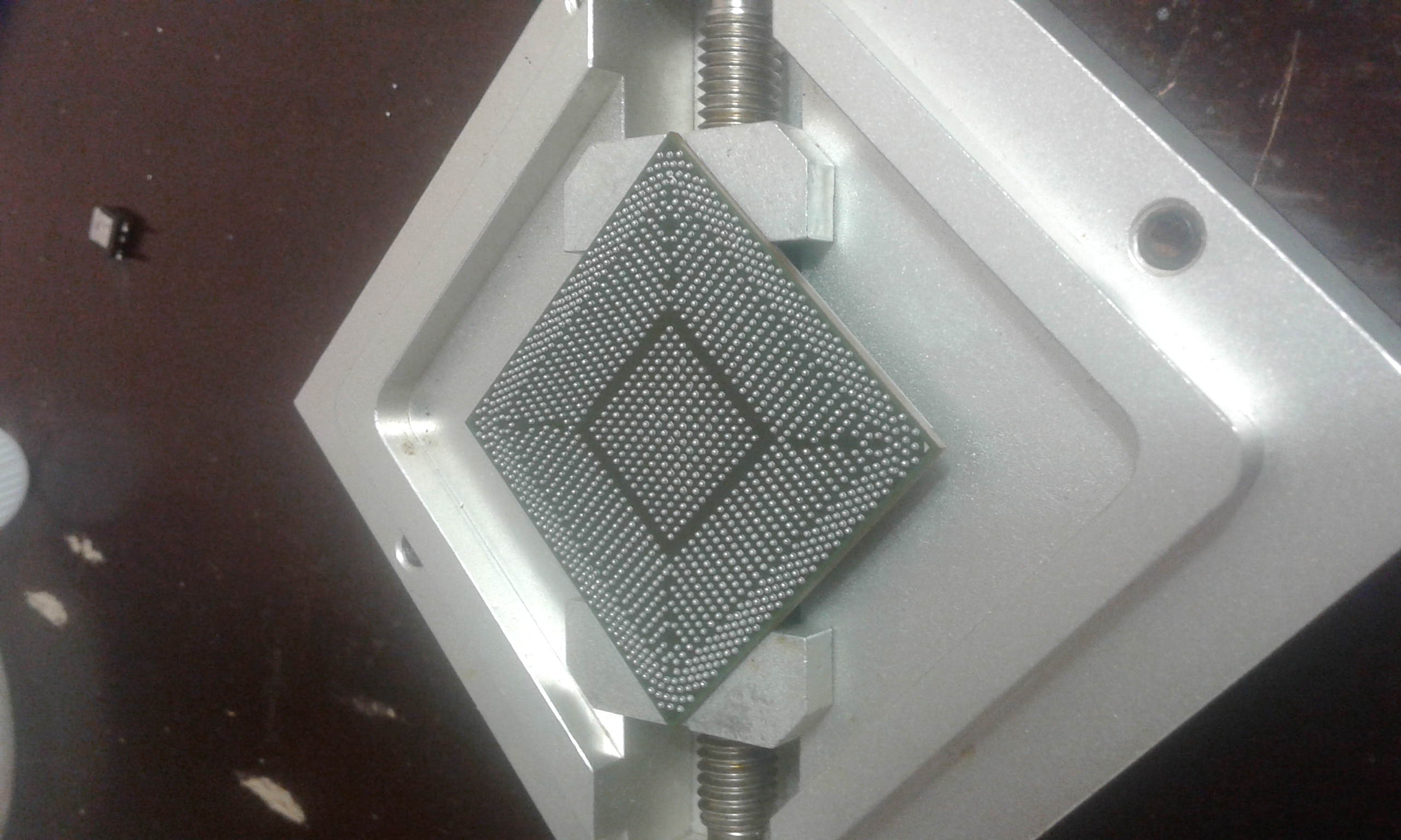

    helo ppl
    lately ive been away a bit, but for a reason

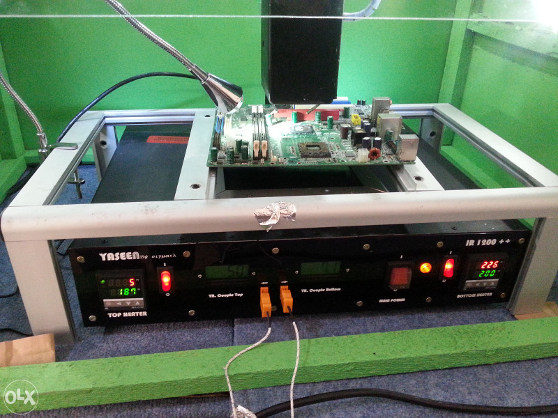

    ive got myself reballing station yaseen ir 1200++
    its goood but im bad so i ask you to be my teachers
    so far i managed to take chips off with ease (had to play a bit with temps but eventually i got it right)
    learned to put balls back with use of stencils, so far so good... it took a little bit of practice but i managed it (98-99% balls in place, rest added by hand)
    problem i face is when i need to put chip back...
    how can i be sure that chip is back right and all balls are in place and soldered well?
    when i start to heat chip it easily sits down like i saw in videos on youtube, but laptop wont strat, fan spins, no image... so i heat it up a bit and heat in more then before, nudge it a bit to be sure that all balls melted but after that still no image on screen
    so any tips here? also, is there a way to test if vga or chipset worth reballing or is it even working...? what are max temps and how to know did i killed the chip?
    tnx in advance
    also any other tip would be great sin you have much more experience then me

                first of all, thank you for your kind answers and tips
                i perfected reflow process on my hot air gun and homemade preheater so most board lasts for 6 months or more (not that damn RS880, it fails hard) but i find it harder to use reballing machine cos of powerful heaters
                first few chips popped right up, but those boards ware dead anyways
                pads intact, epoxy is easy to clean when i heat it a bit, so no problem there
                botom heater is ceramic, 2kw 5-6cm away from board, upper heater is IC
                how far do i keep it form chip? usualy i put it 5-6cm from chip... is that good?
                i did not know that about new chips, tnx, it will save me a lot of money
                TNX a lot ppl for helping a newbie
