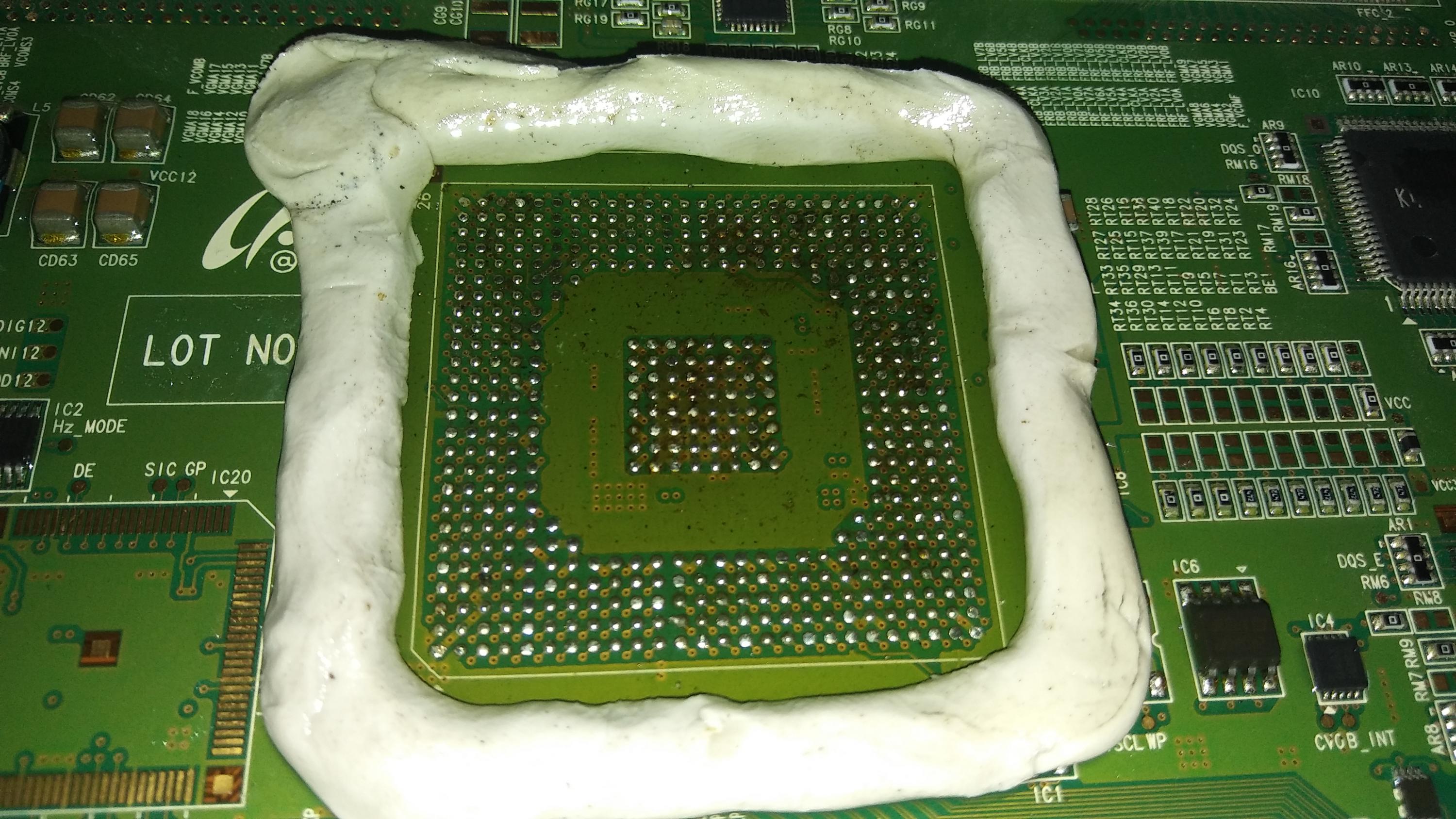

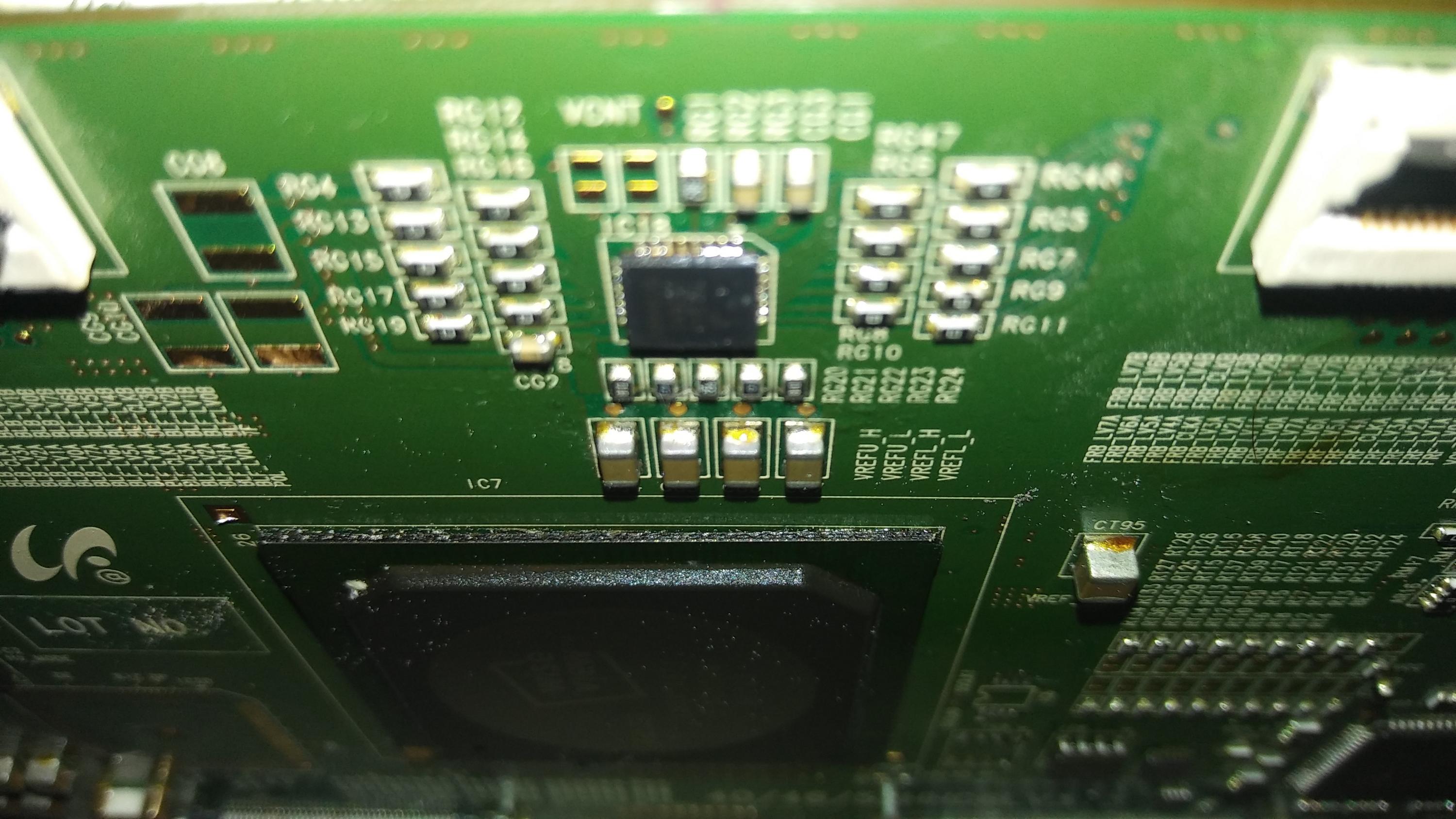

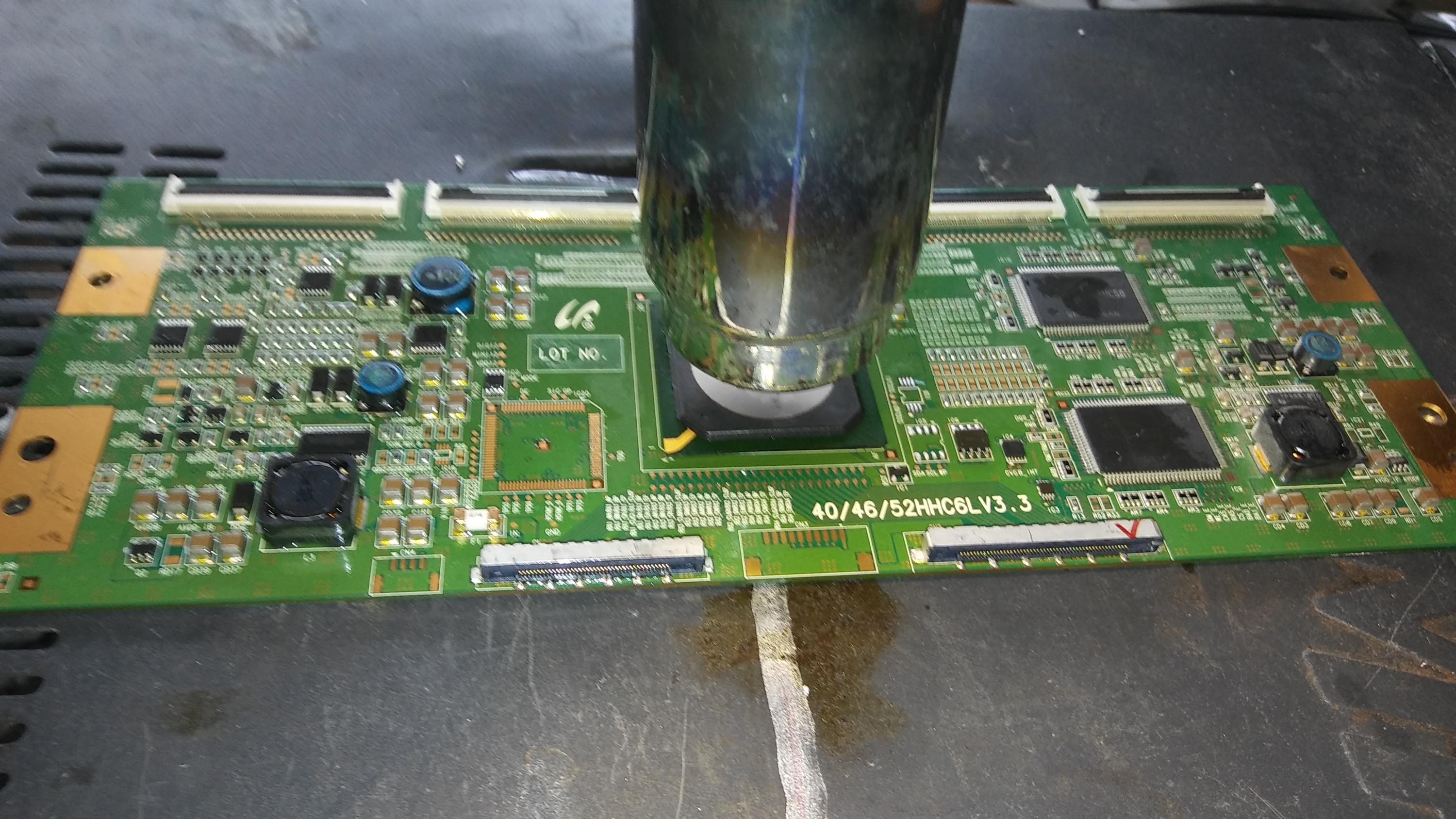

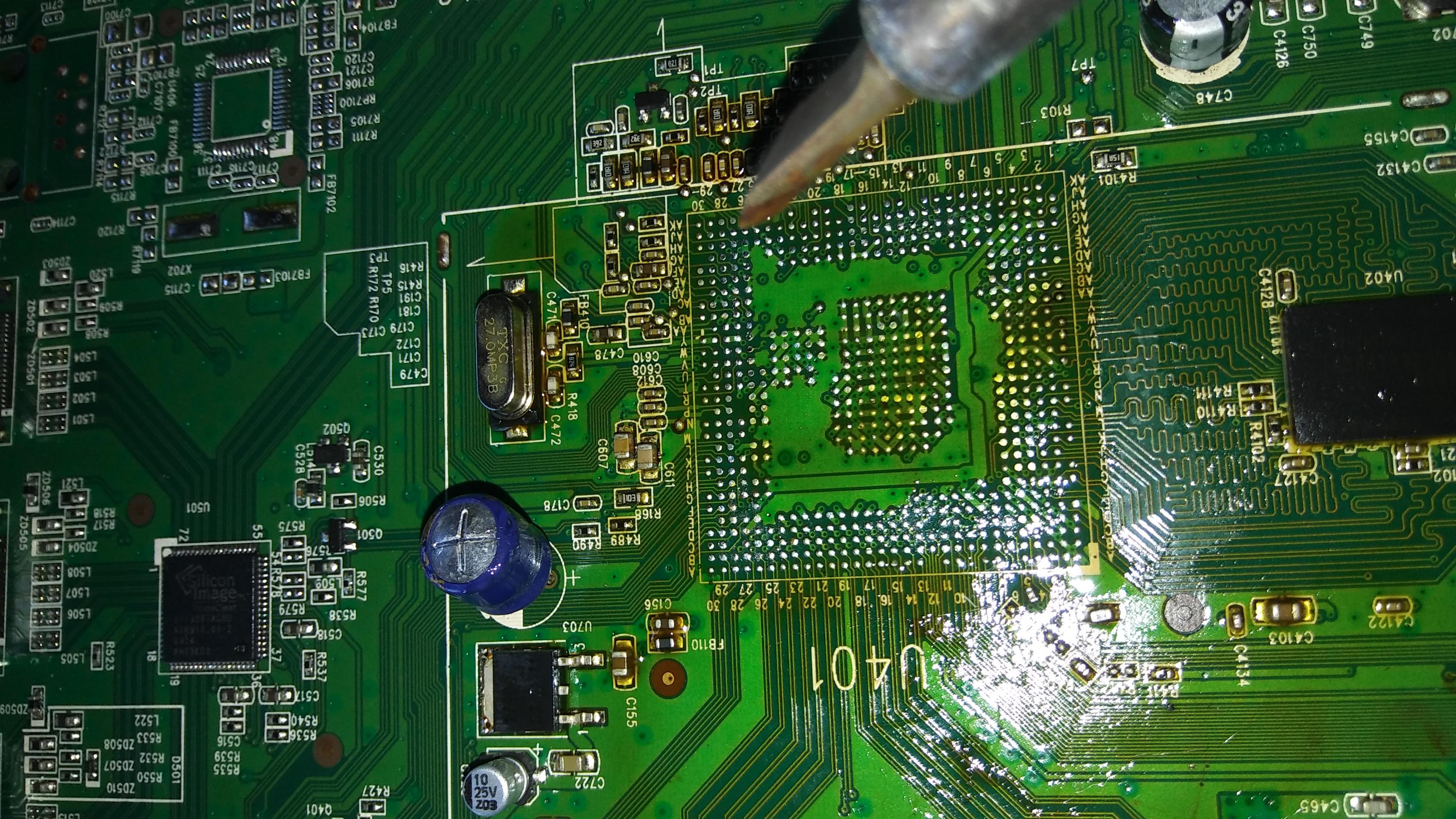

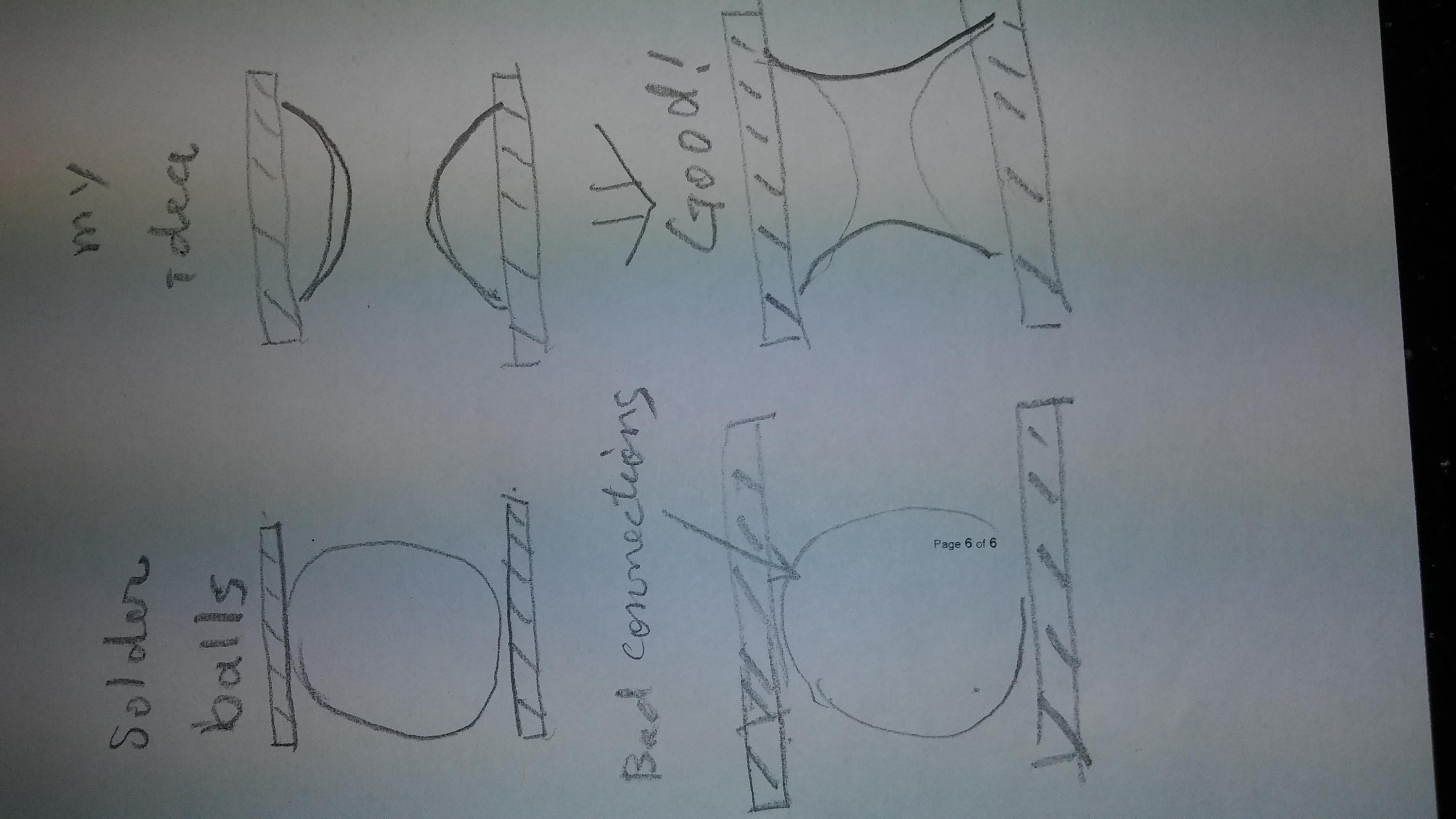

    I try to do BGA reballing without the balls?
    I was inspired by the fact that I saw some people didn't use balls (use solder paste)when they were repairing the cell phone.
    Is it possible? We don't even use stencil and solding paste? Solder the bag righr to PCB?
    Because I hate to do this....at picture 4
    Pictures 3 is A homemade COMPAQ BGA reballing machine.

    My idea is if we can have both PC Board and BGA chip Implanted nipple (Breast augmentation) like pic1
    but... how can i do it?
    put BGA chip under silicone oil then work hot solder iron with solder on it. Using surface tension to form a semi-spherical ball. i called....BGA Breast Implant.
    but.... how about PCB? We need to built a dam or levee on it with plumper's putty then work hot solder iron with solder on it to form a semi-spherical ball. i called ....PCB Breast Implant.

          Re: BGA reballing without balls?
          Without the balls the pressure from the heatsink will squeeze the solder flat resulting in possible shorts.

            We have half the ball on BGA chip and the other half ball on PCB. Should not be short-circuited and the hotter the PC-Board the better contacts.
              What you are trying to do will not be stable enough to work longterm. Balls on balls will teeter under the slightest vertical pressure causing stress to make them want to slide sideways. You should rethink this idea.

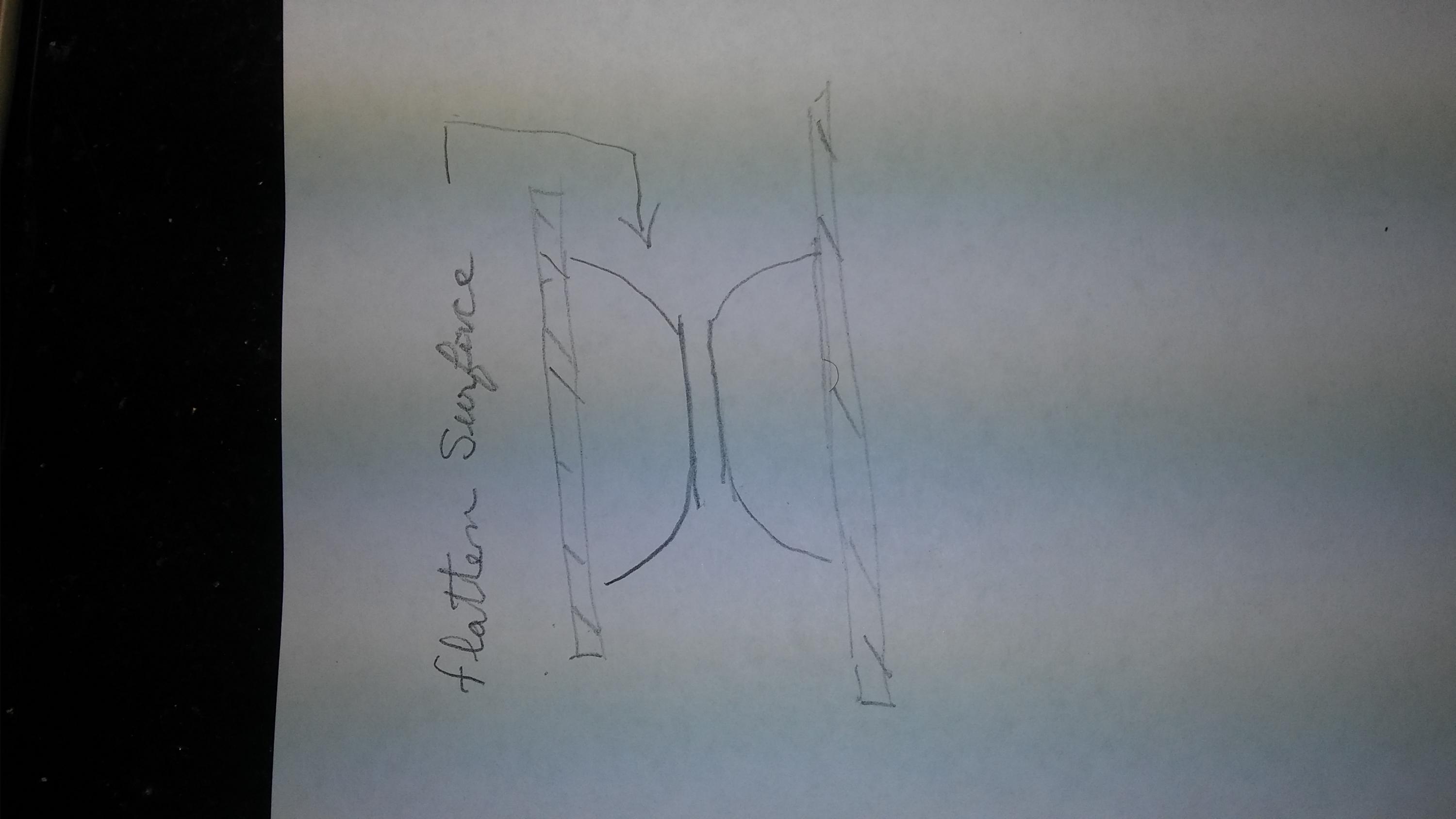

              • capwizard
                • Jun 2016
                • 1991
                Thanks for your suggestions
                Then we can improve to flatten quilt a Semi-Spherical Surface by heat treatment or grinding to flattening spherical top surface. pic1
                But I have a question, what is this shape? i mean name of this flattening spherical ball? bowl shape ....Super Bowl shape..!

                    • Sparkey55
                      • Jan 2010
                      • 1523
                      The shape of DISASTER TO COME.

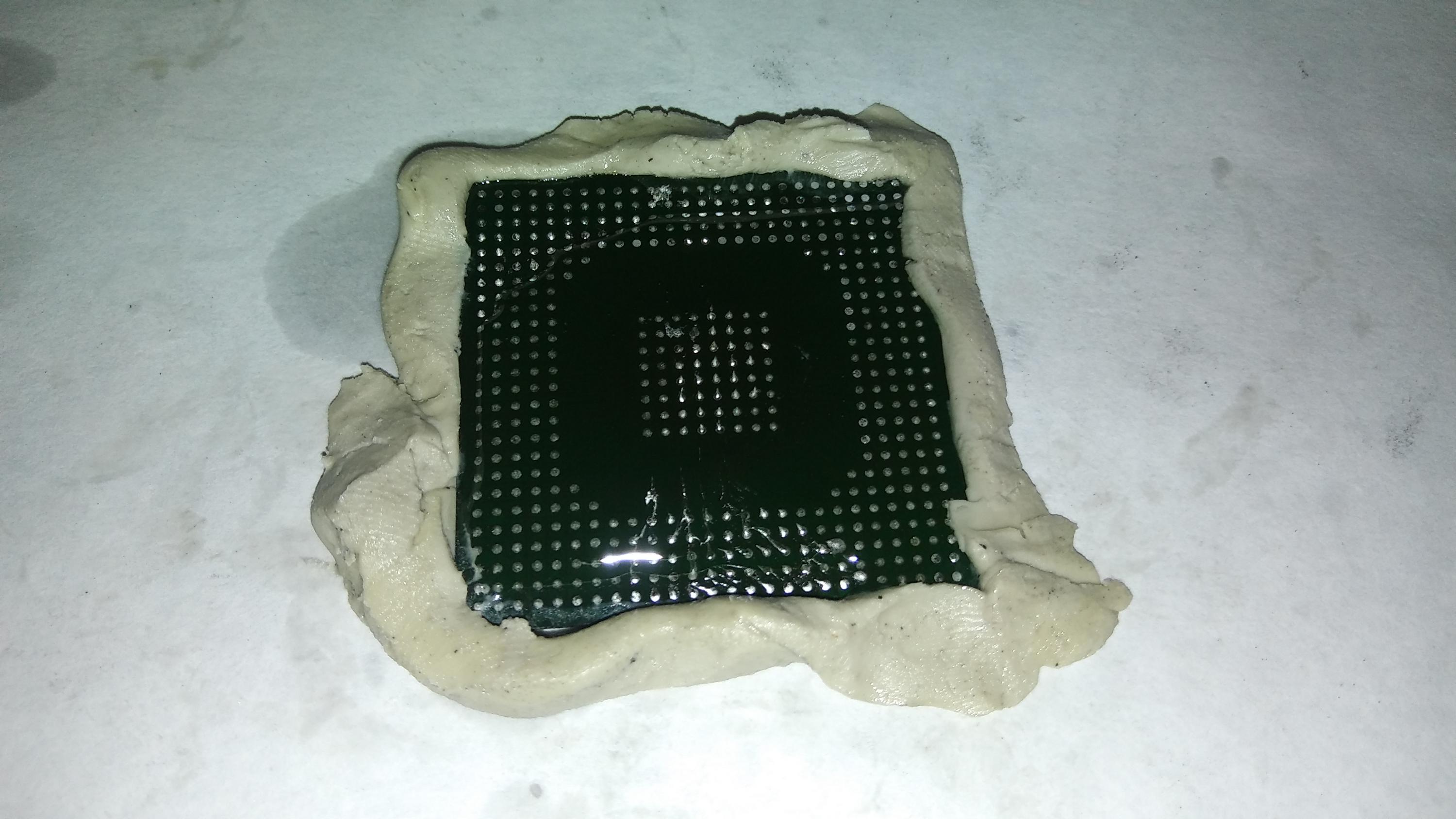

                          • capwizard
                            • Jun 2016
                            • 1991

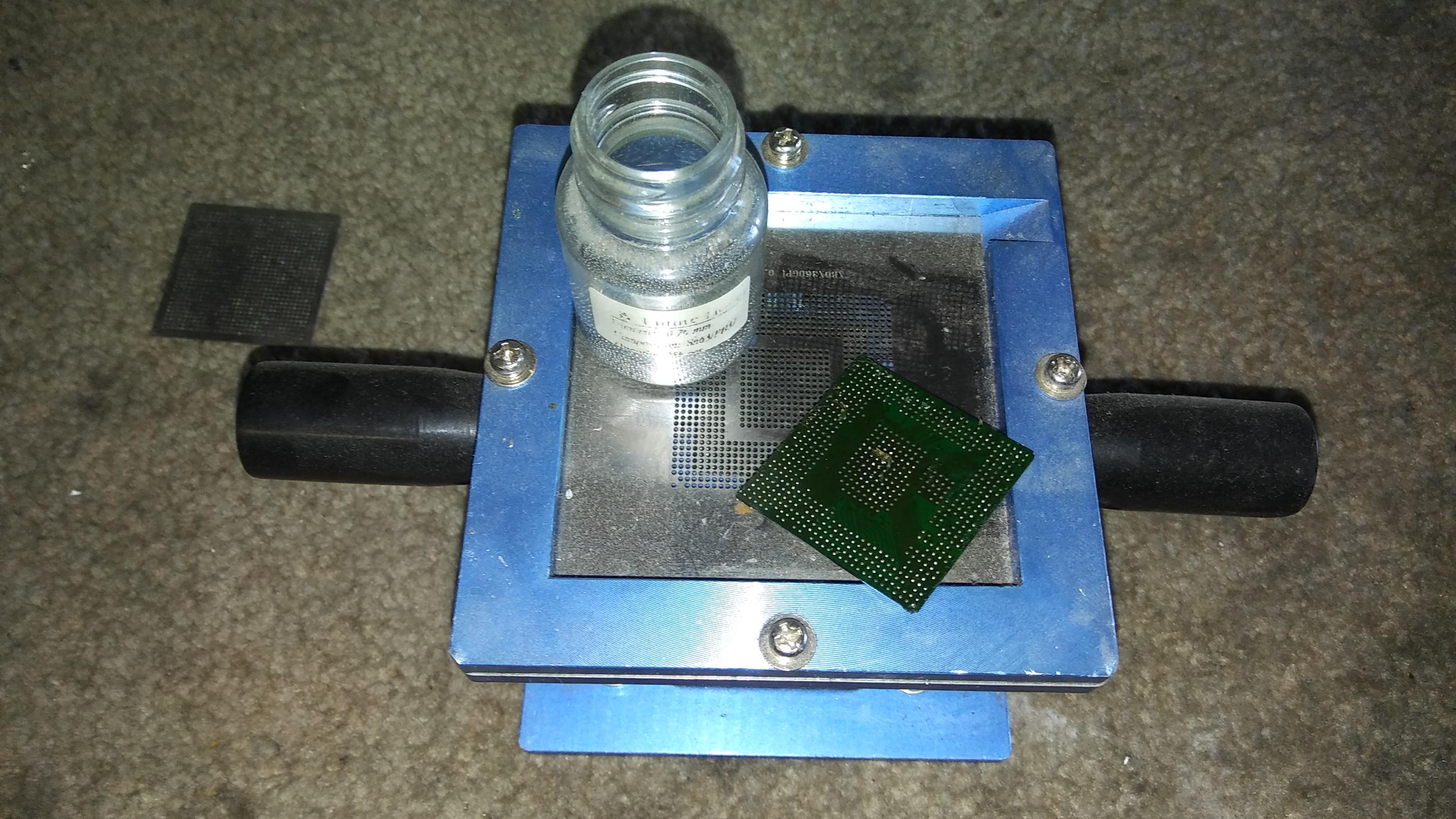

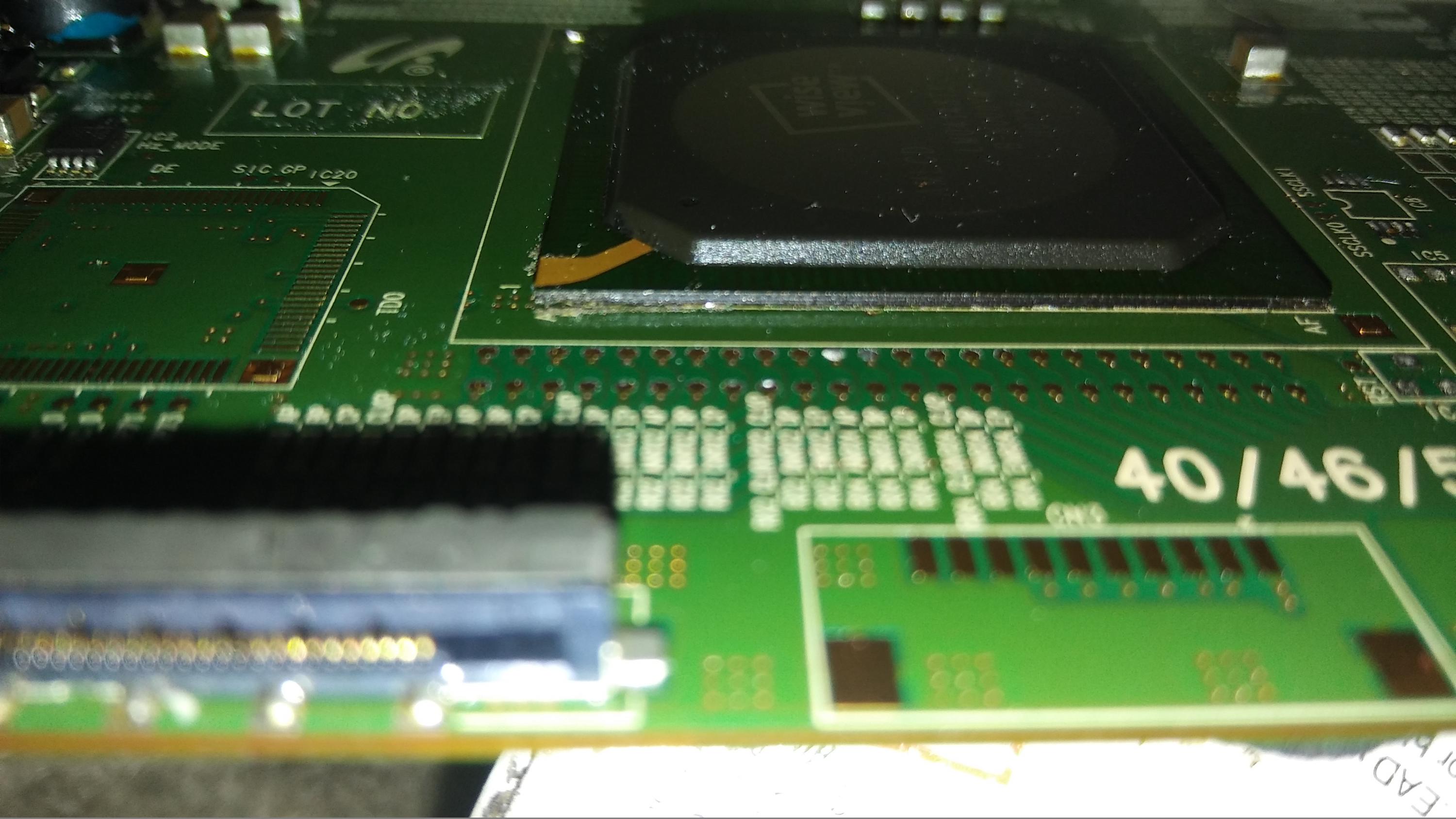

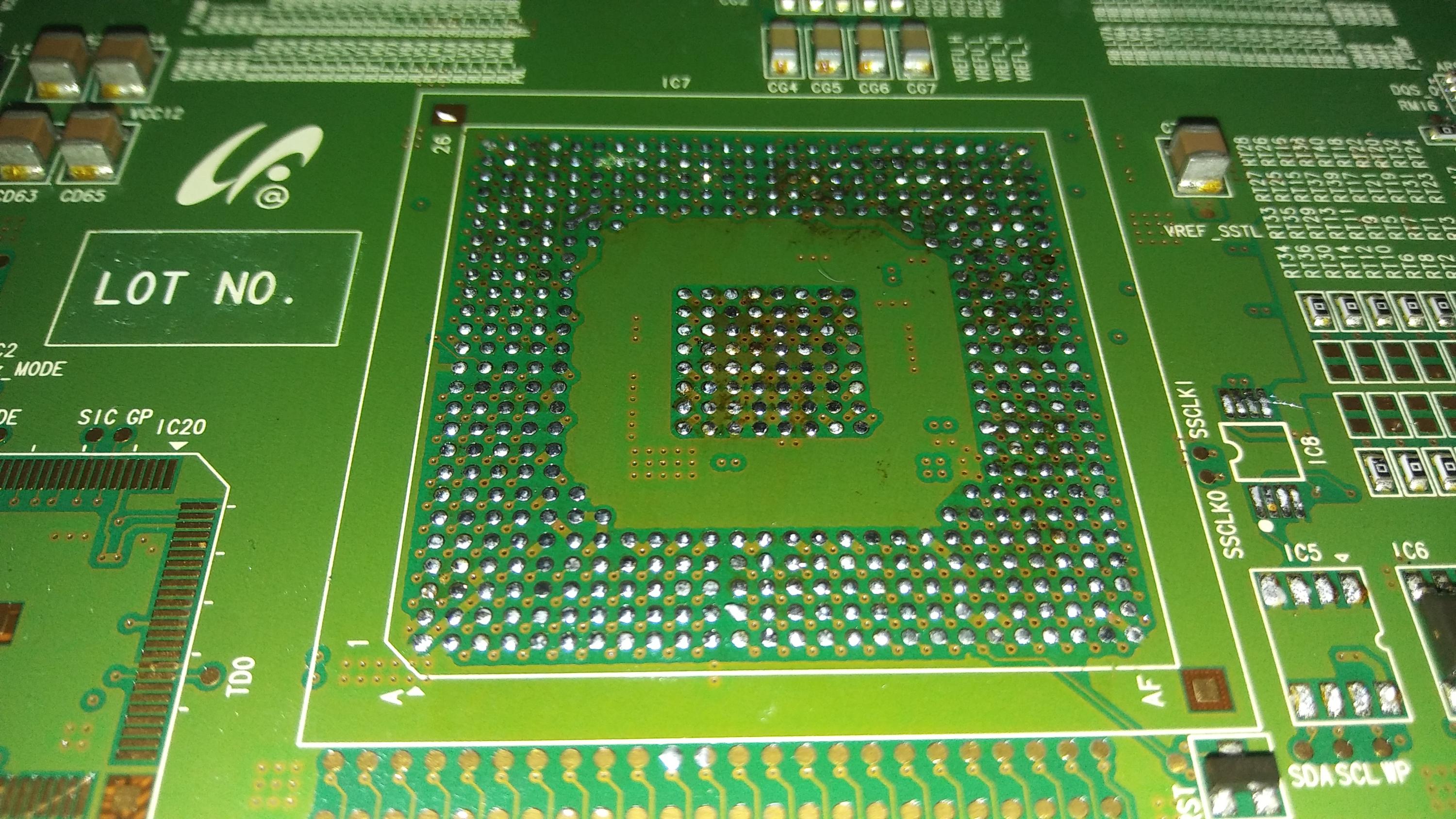

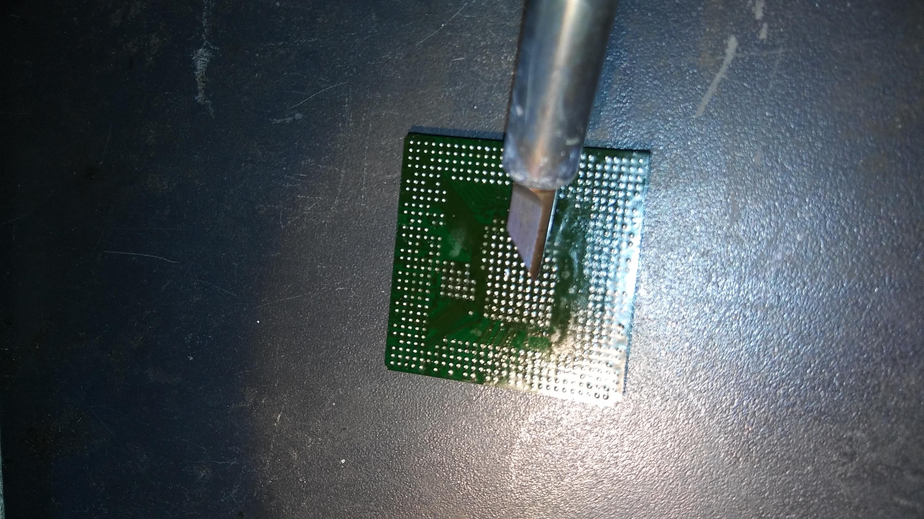

                            I must admit that I was told by Sparkey55. Breast transplant is a big failure.
                            I used vegetable oil instead of silicone oil but breasts does not growing up even under the oil. so this is a failure. But I will improve it. while heating up BGA chip to 230F and adding ordinary solder to form breasts.
                            I brushed some solder paste on it and started BGA soldering. IC chip and PCB did Soldered together. This time I used this board is a junk tcon. Next time I will move PCB from working TV set to do the experiment.
                            pic 2 has vegetable oil inside the levee.
                            pic 8 IC chip and PCB did Soldered together with no gap.

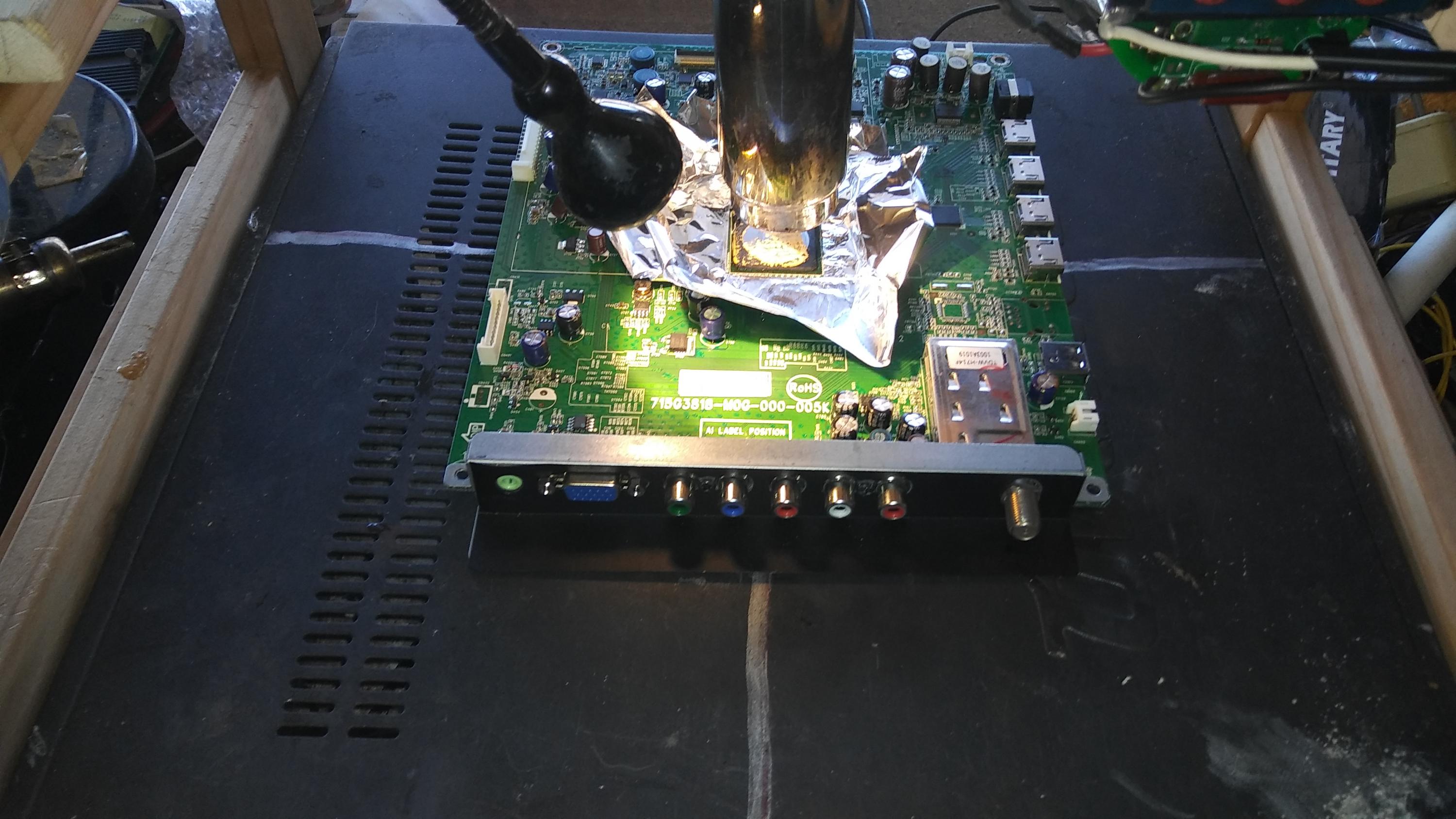

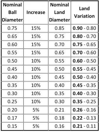

                                    2. BGA solder balls have different sizes. pic 1
                                    PCB Feature Sizes For Standard BGAs
                                    Ball Pitch Via Diameter Trace Size
                                    0.8mm pitch 18 mil 4-5 mil
                                    0.65mm pitch 16 mil* 12 mil 4 mil* 4 mil
                                    0.5mm pitch 10 mil 3 mil
                                    0.4mm pitch 10-8 mil 3 mil
                                    3. BGA solder balls are high price. 1kg = $300
                                    4. BGA solder balls must be used with BGA stencils and holders.
                                    5. BGA solder balls are not easy to manage, run all over the place.
                                    6. The BGA chip center part is not easy to solder with appropriate temperature.
                                    i hate BGA solder balls!
