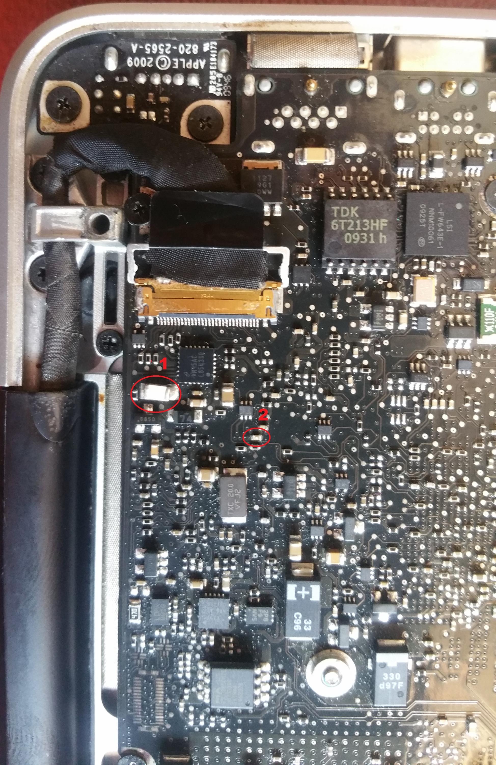

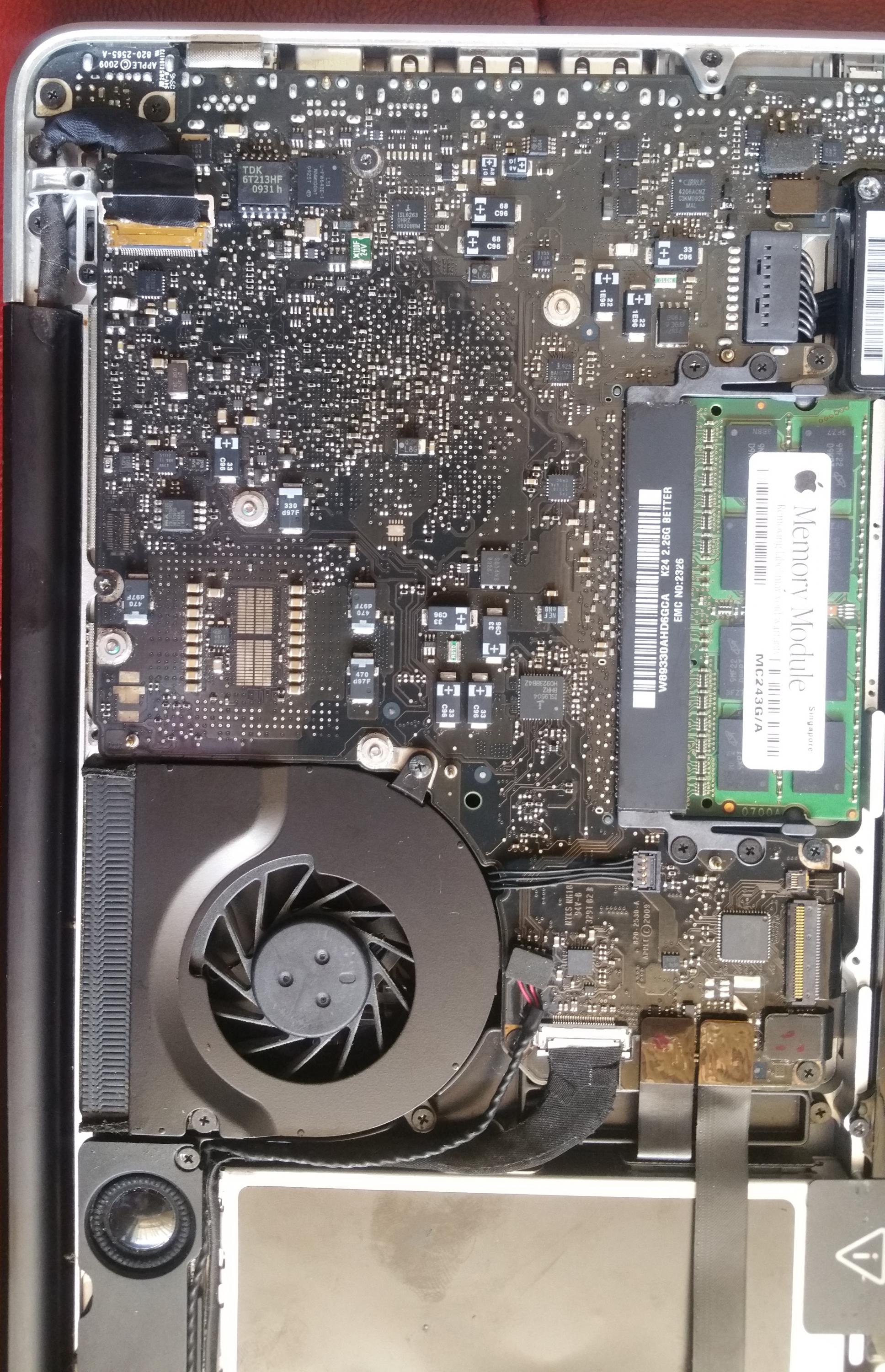

    This mac turn on ok, but the screen was completely white.
    fuse 1 defective (see image), after replace the fuse 1, screen without backlight but can see image in the dark
    the fuse 2 defective now.
    Any help?

    There should be a backlight enable FET that you should be able to check.
      Re: MacBook A1278 2009
      1 is not a fuse if i remember good....
      2 is backlight fuse.
      if fuse 2 is blown... check if one side has 12.5 volt. if yes...... remove all sort of power and check if side 2 has short. if no short replace 2A fast blow 24-32volt 0402 fuse and backlight should be back ok.
      backlight ic is the one near lvds connector and up that component u called " fuse 1"

        Thank dellxps15 and keeney123, I will try today
          According to schematic, 1 is a Cap. 200Pf 5% 100V CERM 1206.
          (it is on the backlight circuit).
            I leave 1 open and replace fuse 2, it is working now.
              Good for you. I have not a looked at the schematic. Perhaps Cap 1 is for transient spikes or it allow the circuit to discharges?
