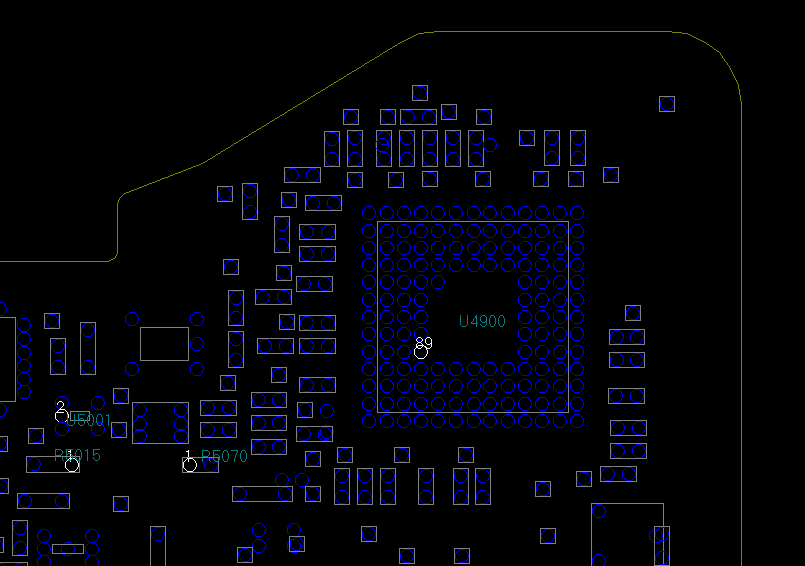

          Re: MacBook Pro 2.66Ghz mid2009 MB 820-2523-b to repair
          Originally posted by dellxps15 View Post
          check boardview pressing N and look for smc_onoff_l
          u should have one spot in the other side of the board, hear hdd cable keyboard cable, speaker cable..... that zone. and yes they are 2 bigger pads near smc chip u4900. if magsafe has green light try shorting that 2 point with a tweezer. let us know if macbook start.
          Hi, can u please tell me more precise where it's those two pads ?
          I think this is somewhere around here, cercle in white are SMC_ONOFF_L circuit.
              u have normal voltage on macbook as they are g3hot voltage 12.5 volt, g3hot 3.42 volt and 3.3 always volt.
              after these voltage are present macbook should start after pressing power botton.
              When you talk about pressing N and look for smc_onoff_L are you telling him to push down on the N key and hold it down at the same time the unit is turned on while a meter is connected with the "positive probe/red" on smc_onoff_L and the "negative probe/black" is connected to ground and look for a voltage change?

                  press N on boardview means open boardview.exe and load .brd. then press N key to imput data for search and press OK for searching.
                  if macbook start that way:
                  1st put back heatsink with thermal paste.
                  second look on boardview (keyboard connector) without keyboard plugged in and look for smc_onoff_l pin (should be number 5) and short it with ground. macbook start too ?
                  when doind that bypass, check again coils volt voltage.

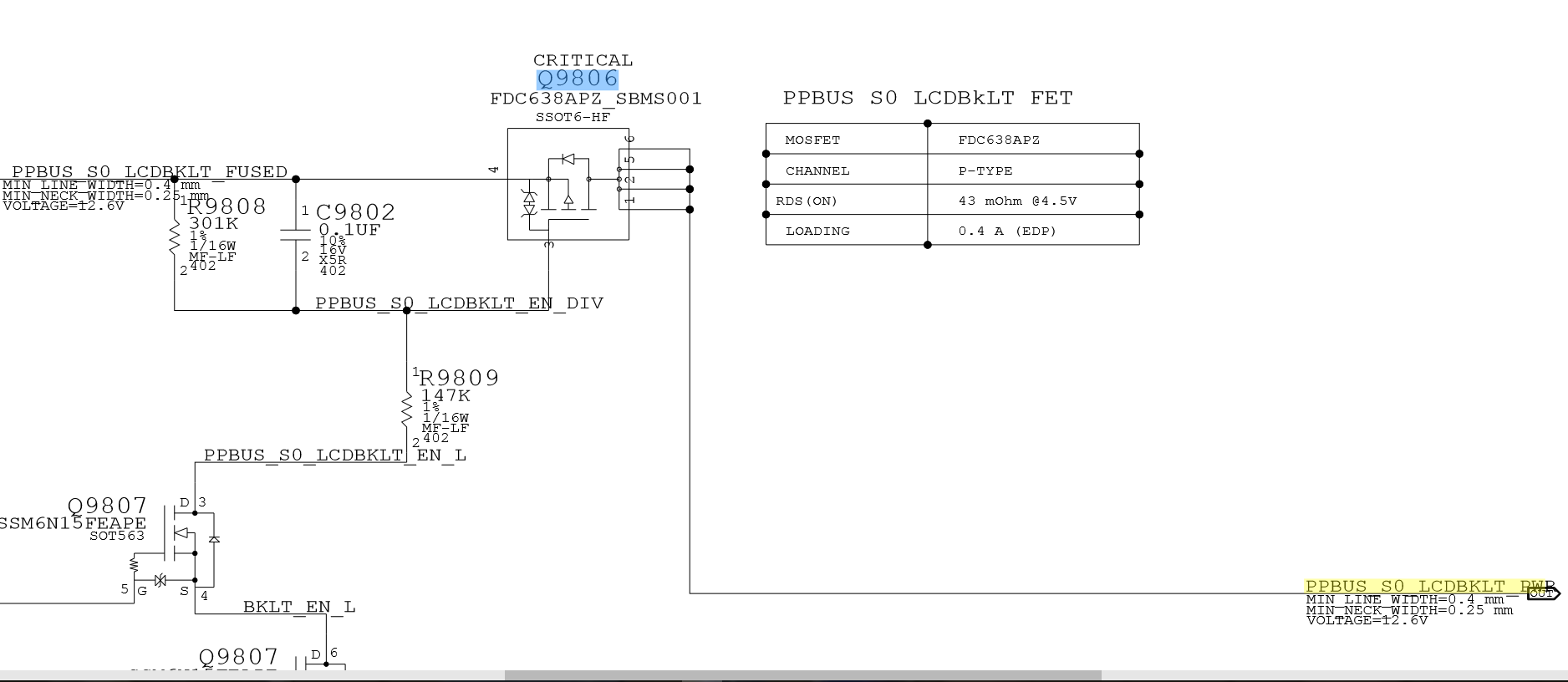

                    PPBUS_S0_LCDBKLT_FUSED: 12.6V Probe:1157 Pin:1 part:...
                    PPBUS_S0_LCDBKLT_PWR: 0.00V on probe: 1158 pin:1 part:...
                    SO i suggest Q9806 is the culprit..
                    Thank for your help !

                      That would be dependent also on backlight enable. PPBUS_SO_LCDBKLT__EN_L if this is also setting at 12.6 volts it means it is not turning on so Q9806 will not turn on. What is Probe 1158 and 1157?
                        #31
                        edit: f9800 should be ok.
                        check r9809 if 147k and voltage both side.
                        report q9807 voltage pin 2-3-4-5

                              R9731 & R9701 have 0.00 volt on each side. (running or not)
                              Q9807 have 8.71V on Pin3 and 0.00V on other pin. (0.02V on pin6 when logicboard running)
                              R9809 have 9.69V on Pin1 & 8.70V on Pin2. (running or not running)
                              Can you tell me how can i take measure for 147k and what is it please ?
                              thanks.

                                At first look it would seem the circuit is working as there is voltage drops through the circuit. I will have to look up the specifications to make sure 2.91 volts will turn on Q9806. Q9806 may be bad but something on it's output could had damage it. With the unit off you might want to put your negative/black probe on the output of Q9806 and the positive probe on gnd. and set your meter to it's lowest Ohm scale and see what you measure. You are reversing the probes from how you would read a voltage reading because you do not want to measure through the protection diode built in to Q9806.
                                147K just means the 147,000 OHM resistor which is label R9809 If you look just below the R9809 you will find the 147K
                                So what I can tell from the data sheet Q9806 should be on. I would still Ohm out its output, but I believe this P-channel FET needs to be replaced. I have attached its data sheet. You may also want to wait til dellxps15 confirms this.

                                  voltage on r8793 ? eg_bkl_en is external gpu backlight enabler that goes to u9600 graphix muxer (analog to digital converter?)

                                    So do you think Q9806 bad? I am on a computer, right now, where I can get to the schematics.
                                      #38
                                      q9806 should be ok.......
                                      i dont understand... u need schematic ?

                                        I was on a computer that did not have the schematic and the link to the schematic would not work. I am now on a computer with the schematic.
                                        Q9806 has a 12.6 volt reading on the source. It has a 9.69V reading on the gate. There is a -2.91 drop from gate to source. Threshold for turn on is -0.8 volts gate to source. The drain has 0 volts on it. If you follow the drain output it will go to a voltage divider of a 300K ohm to 100K ohm before enable and IC. One side of the 100K Ohm resister is tied to ground. This ground will be felt on the drain of Q9806 to complete the circuit from source to drain of Q9806. Q9806 should be turned on with the-2.91 volts and the 12.6 volts should be on the drain. The junction of the 301K ohm and the 100K ohm should measure 3.15 volts. The junction of the resistors is on page 85 section B6. 301K ohm resistor is R9731?

                                          ur right but why q9807 pin5 is 0volt ?
