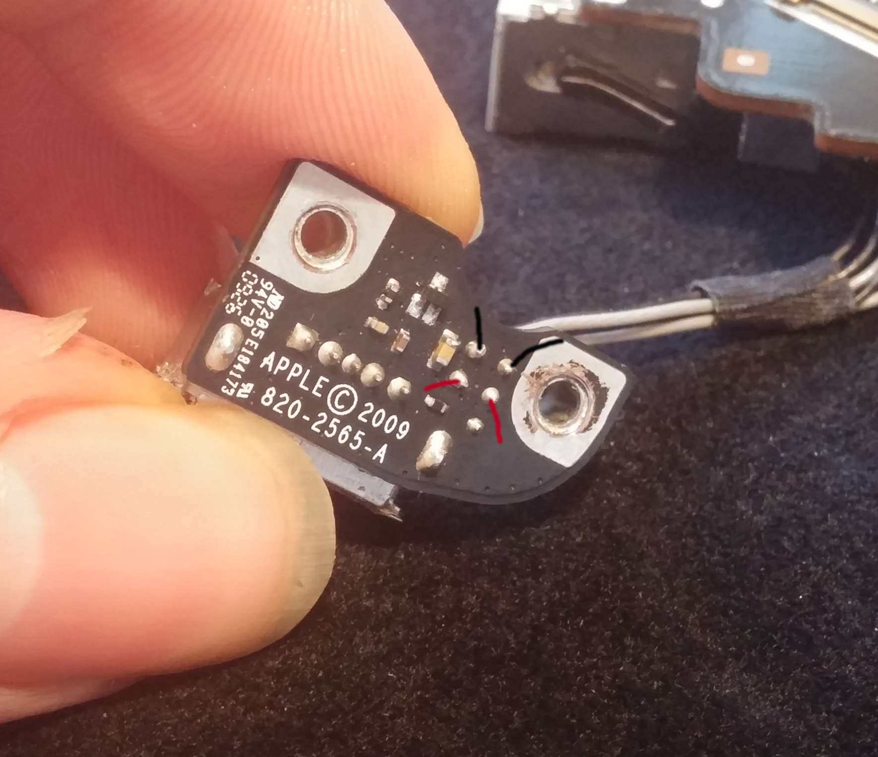

    Hi to all.
    The motherboard starts when i press the power button, and then restart itself after 10sec. After the MB restart itself: -When the magsafe connected the fan are spinning normaly, -When only battery connected, fan are spinning at the maximum (It rises gradually).
    The magsafe look good, have green light and orange light when battery plugged.
    So i would check PP3V42_G3H signal, but i really don't know how to do this safe and i'm a little bit scarryed.
    Here is the schem and diagram: https://1fichier.com/?9u8rkczfe6
    Can someone tell me what i must do to check PP3V42_G3H signal ?
    Thx !

      Ok so.. If i'm in the good way by testing like i do, there is a list of test à i have done:
      check magsafe (only) connected:
      PPBUS_G3H: 12.61V on Probe: 1444 Pin: 1 (SMD.)
      PP3V42_G3H: 3.44V on Probe: 860 Pin: 1 (SMD.)
      P3V42G3H_FB: 1.25V on Probe: 1540 Pin: 1 (SMD.)
      PP3V3_S5: 3.34V on Probe: 1102 Pin: 1 (SMD.)
      PP1V2R1V05_S5: 1.06V on Probe: 929 Pin: 1 (SMD.)
      PM_SLP_S3_L: 0.00V on Probe: 1162 Pin: 1 (SMD.)
      PM_SLP_S4_L: 0.00V on Probe: 1528 Pin: 1 (SMD.)
      PP3V3_S0_DPILIM: 0.25V and gradually down to 0V
      So at this point i think there should be a problem on PM_SLP_S3_L and PM_SLP_S4_L. Perhaps U9480 is fucked up ?
      What do you think ?

                                        u have normal voltage on macbook as they are g3hot voltage 12.5 volt, g3hot 3.42 volt and 3.3 always volt.
                                        after these voltage are present macbook should start after pressing power botton.
                                        check boardview pressing N and look for smc_onoff_l
                                        u should have one spot in the other side of the board, hear hdd cable keyboard cable, speaker cable..... that zone. and yes they are 2 bigger pads near smc chip u4900. if magsafe has green light try shorting that 2 point with a tweezer. let us know if macbook start.
