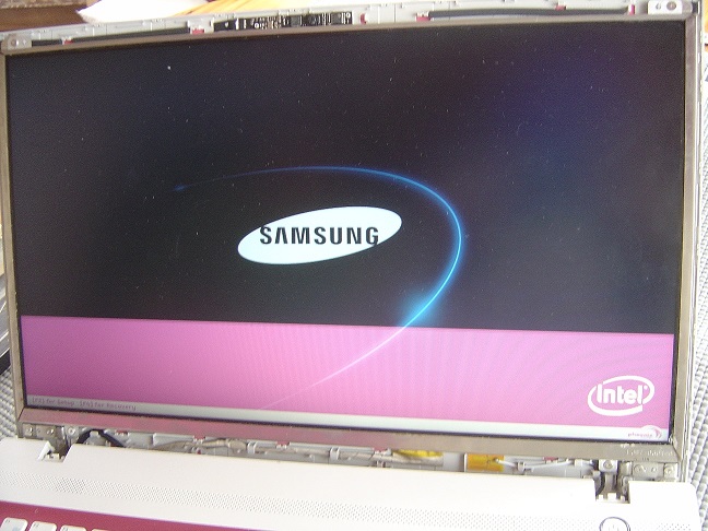

    I'm looking at one of these for a colleague at work, attached a photo of what the panel displays. The bottom quarter or so shows a pink hue.
    I'm wondering if this is strictly a panel issue, not something to do with the motherboard/GPU ?
    And what might have caused this, IYO? And is it fixable as is?

    Is that the original display?
    I've seen this before as a mismatch between the screen and the laptop.
    e.g. an Asus display in a Dell laptop..

      It does look like a bad panel, but check out the cable first, give it a wiggle and reseat both ends.

        I forgot about this thread.
        After a bit more dismantling, I found some sticky residue in the bottom right corner of the screen, it looked like there had been a spill of a sugary drink into it.
        A new screen sorted it out.
