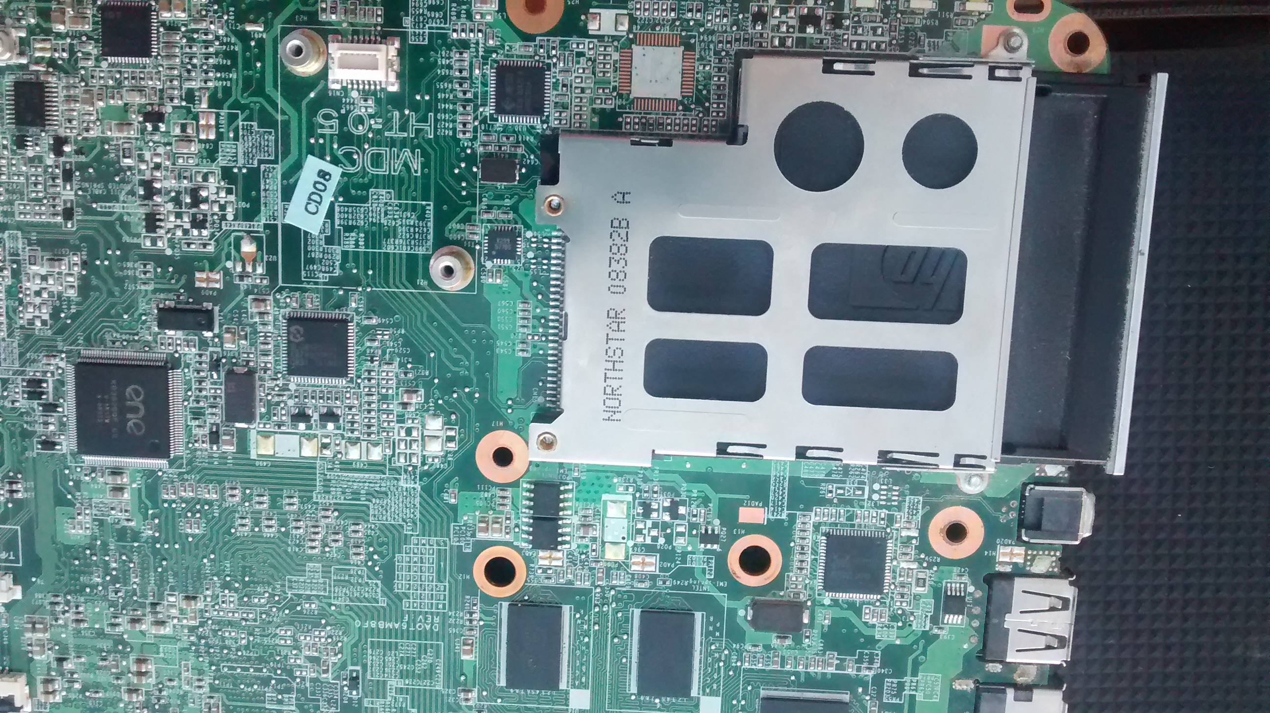

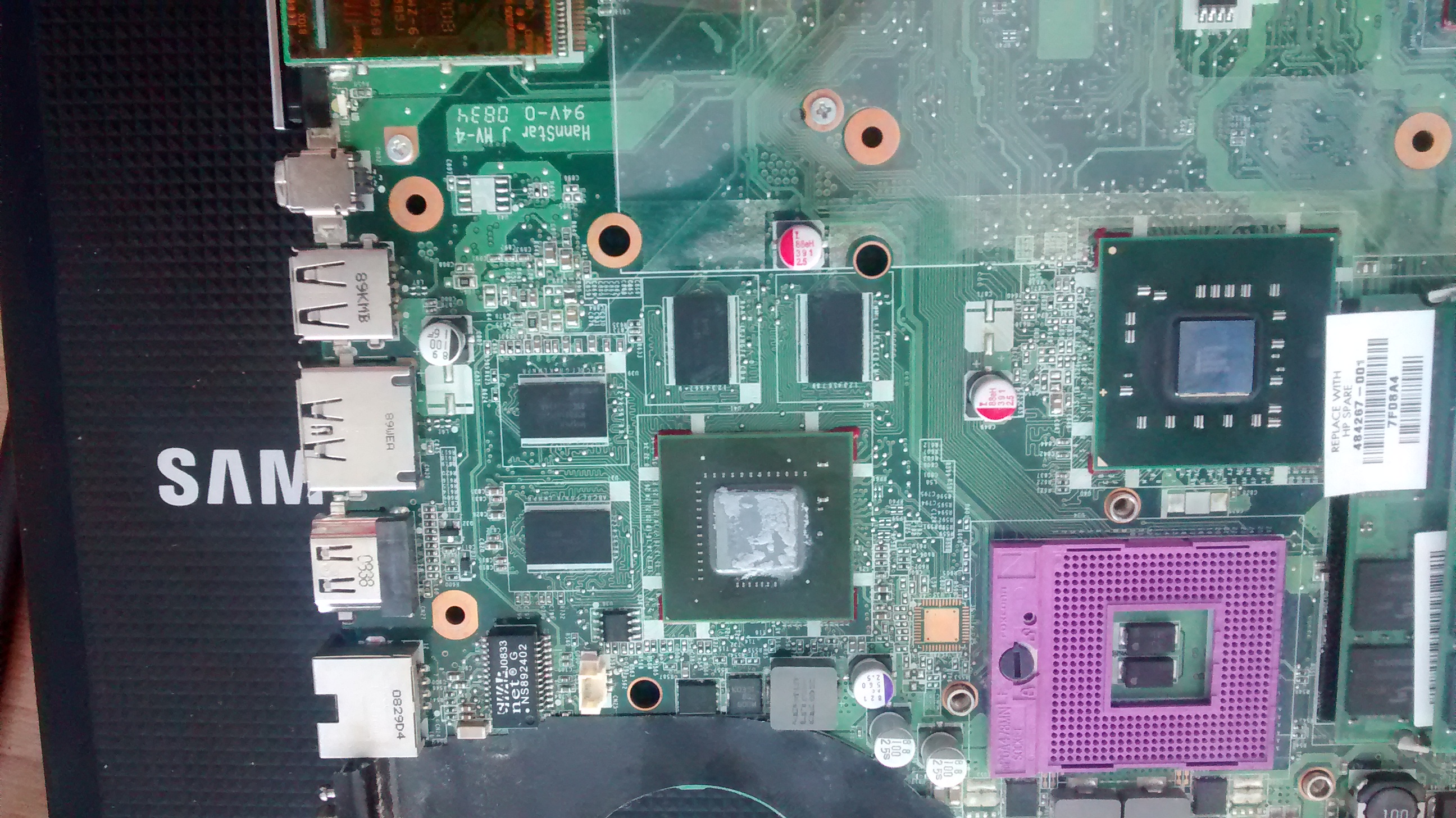

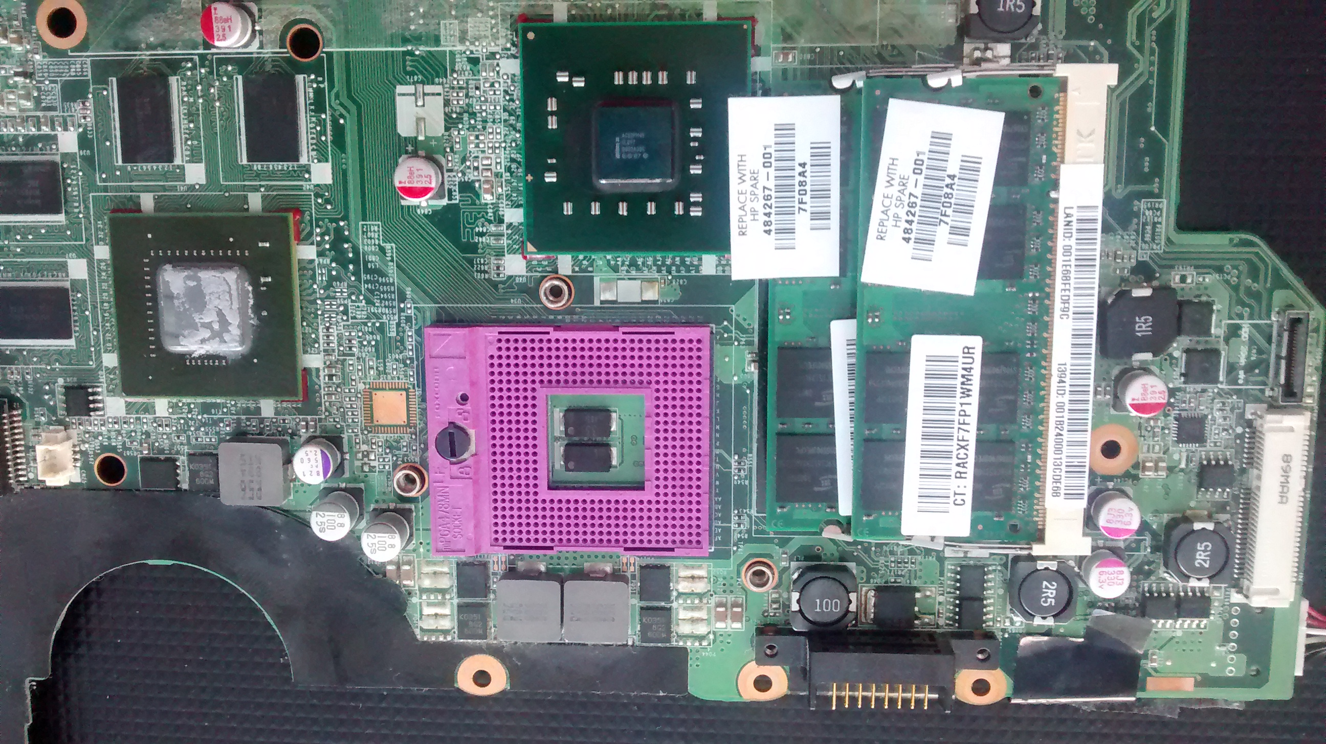

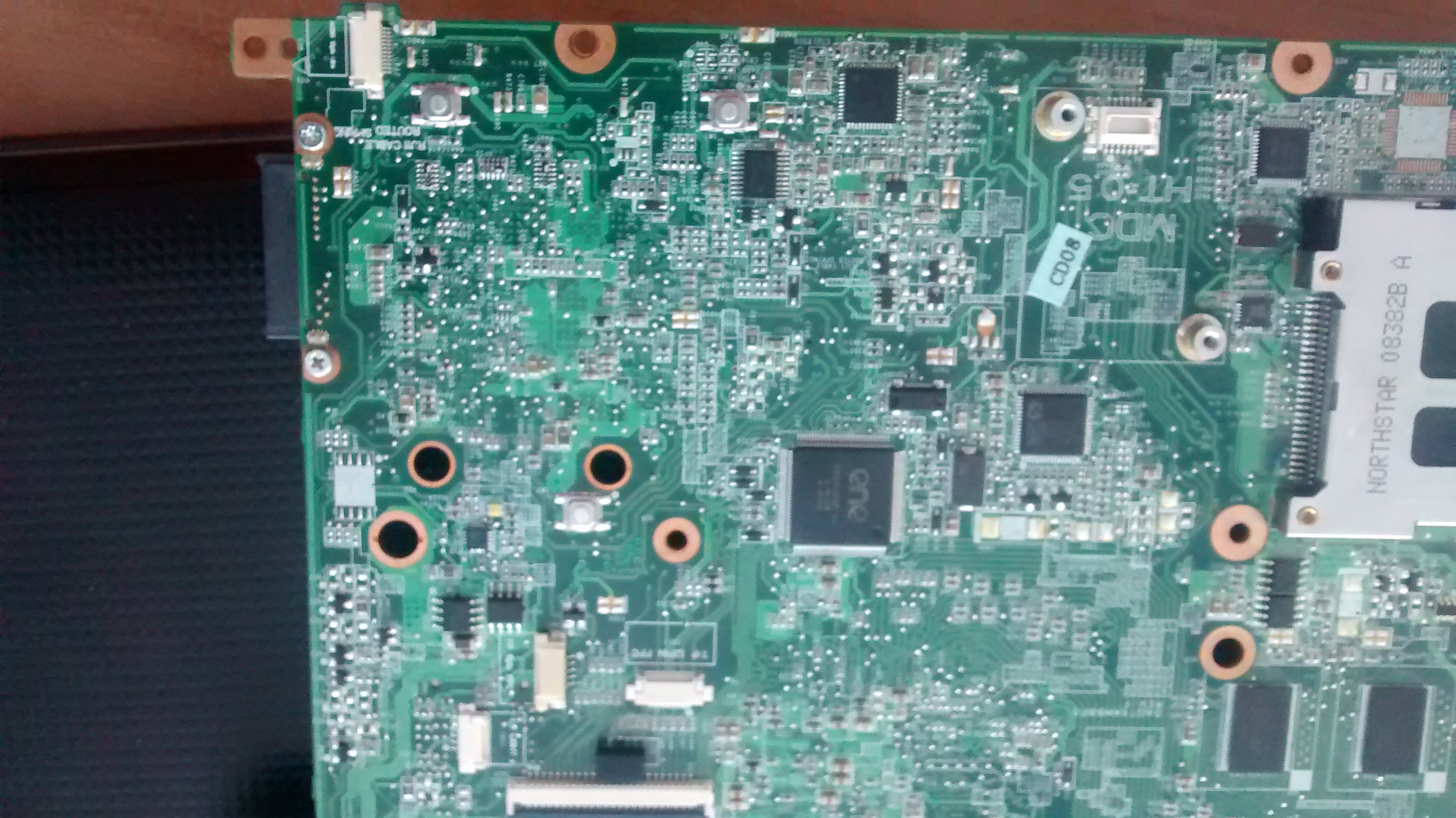

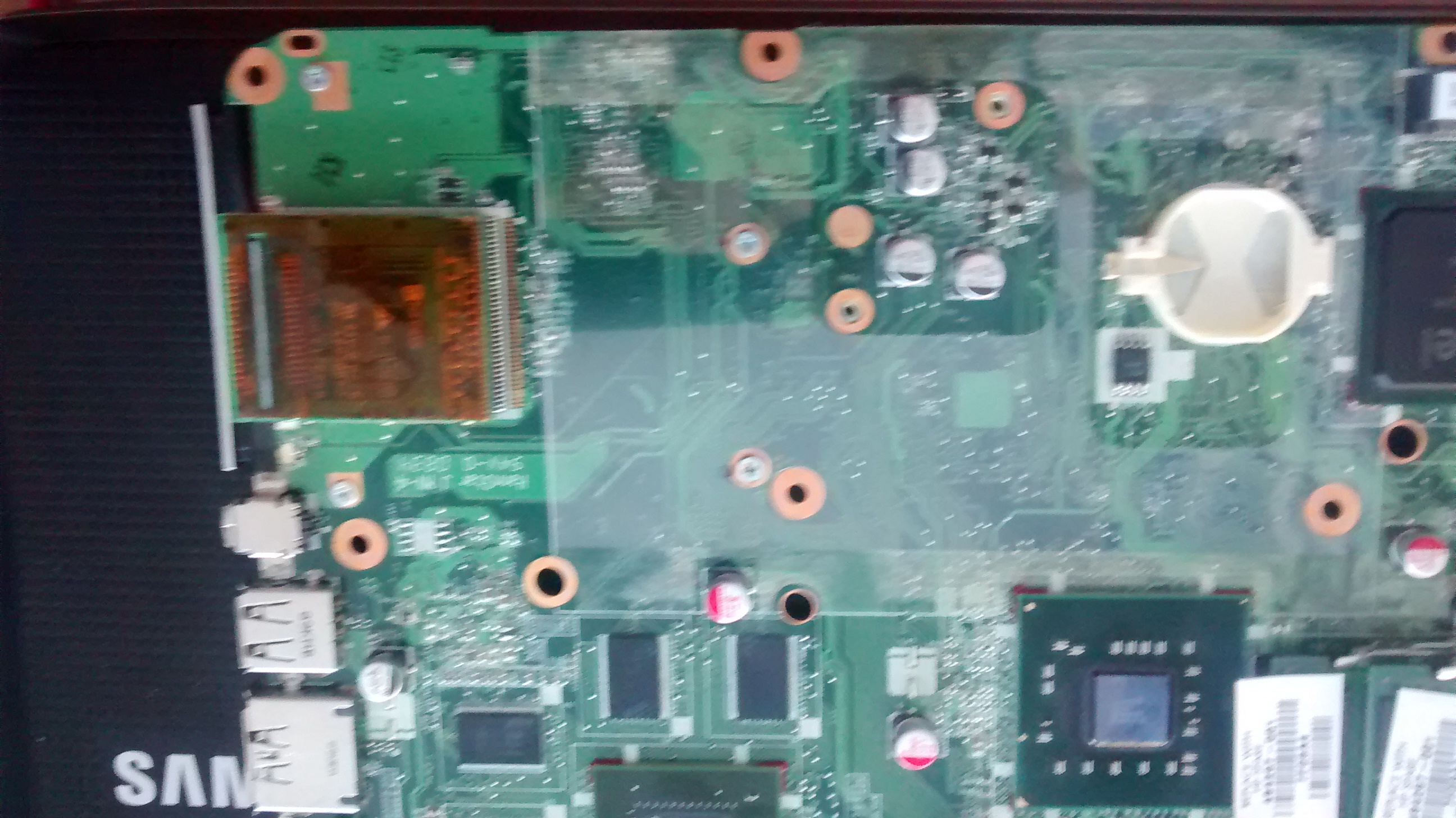

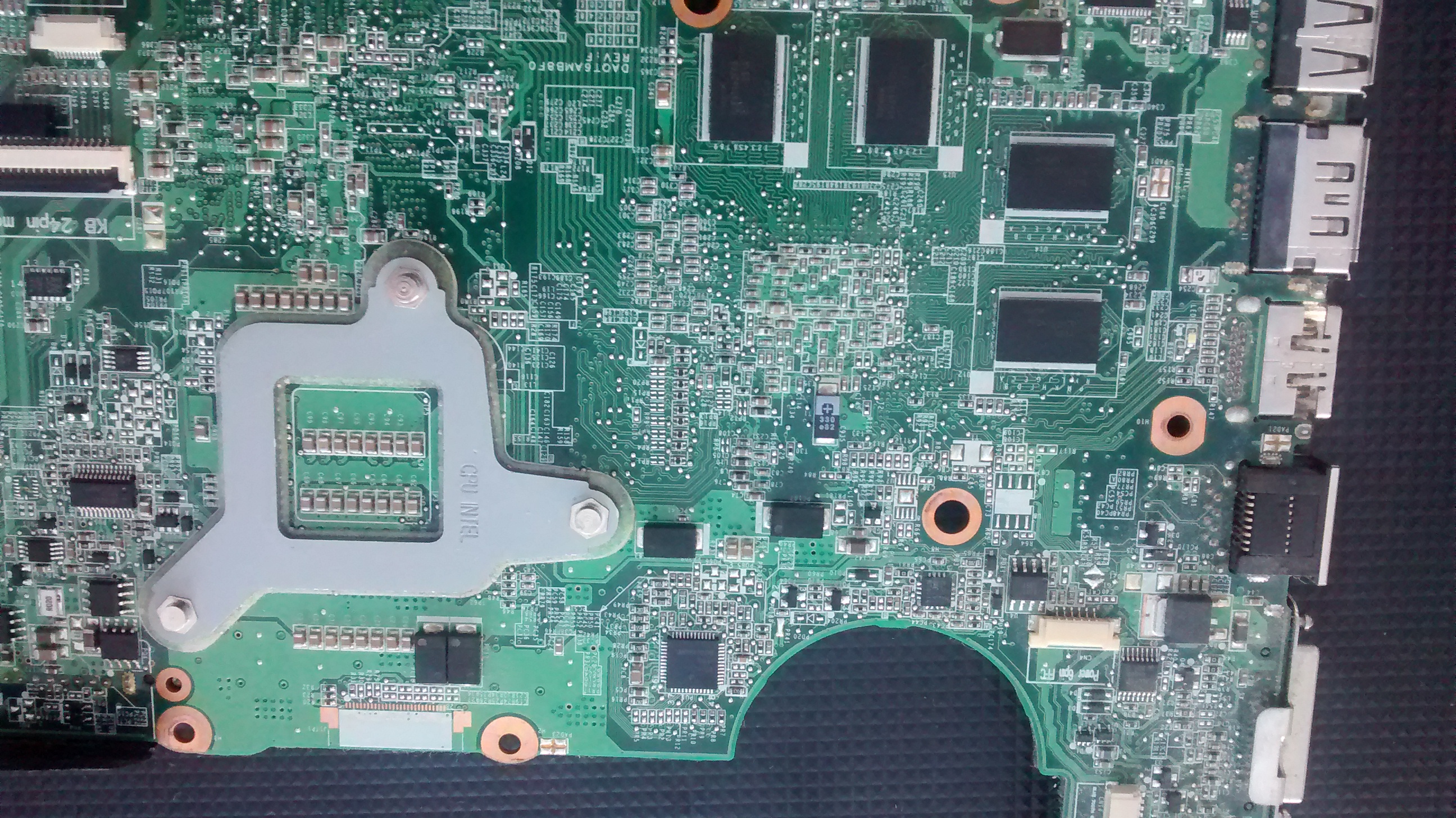

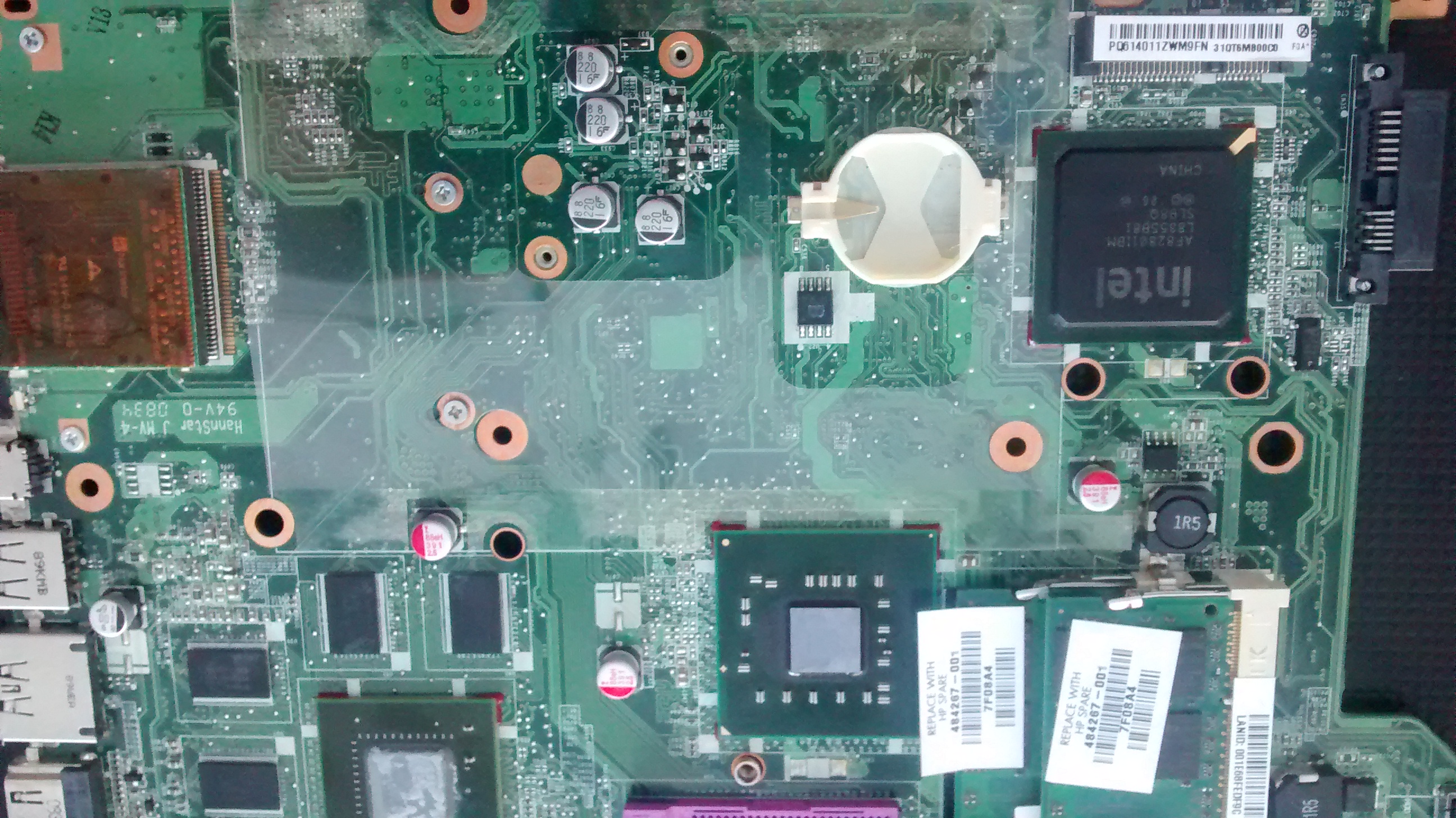

    Hello all
    I have a dv5-1020ev (mb hannstar j mv-4 94v-0 0834) which when I press the power button the lightning bolt flashes 3 times.
    I change the dc adaptor and if I remove the battery it doesnt flash at all.
    I have 19V in the mb in the end of the dc jack.
    In coils near memory and cpu I have 5V and 3V.
    in power ic (isl6237)I have 19V in pin 6 , 5V in VCC pin3, 5V in out1 pin 10,
    I couldnt find schematics for this motherboard although I have 4 schematics for dv5 notebooks none of them is correct.

    Flash bios first.

      Other mobo nmbr is DAOT6AMB8F0 = Quanta

        Re: DV5-1020ev lightning icon flash 3 times
        I already flashed bios.
        Yes the other numbr is DAQT6AMB8F0 rev:f
            change memory,, if not help heat up NB
              3 flash is memory error. try with only one slot.
                I already changed memory but the problem is that it doesnt power on at all. And without the battery it doesnt even light the lighnting bolt led.
                I think its somewhere near the power ic and it can get power from ac adaptor and cant charge the battery
                  Can it be something that has to do with giving power 1,8V to ram ?
                  What should I measure to check that?
                    Can someone give me schemtics for this motherboard?
                    I've search the internet but I couldn't find the correct schematic
                      Try this
                        Thanks atsio. I will start searching with those schematics.
                        It's not the exact but most of components are match.
