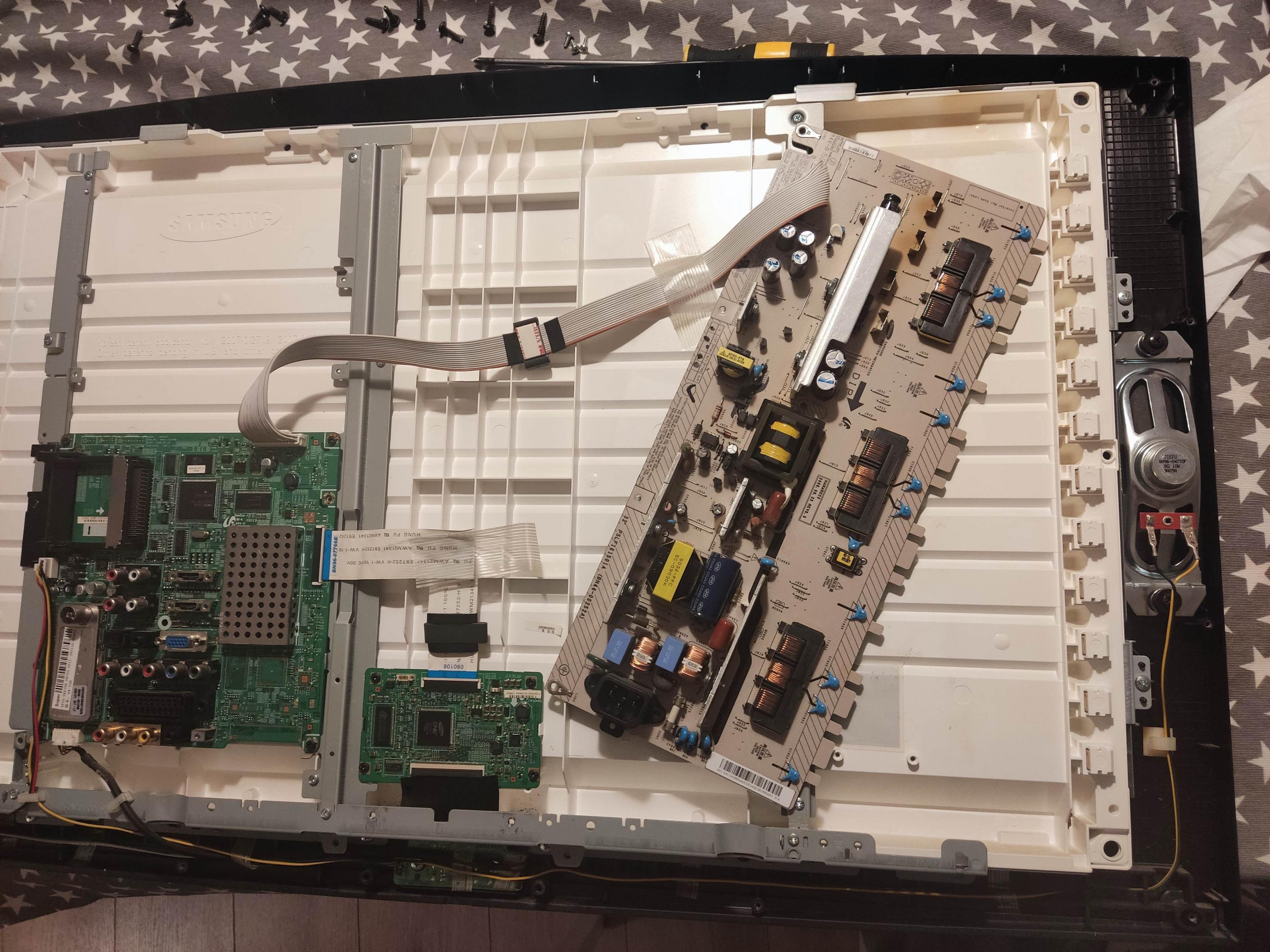

          Ok I opened this TV today. What an old set inside!! (2008 I believe)

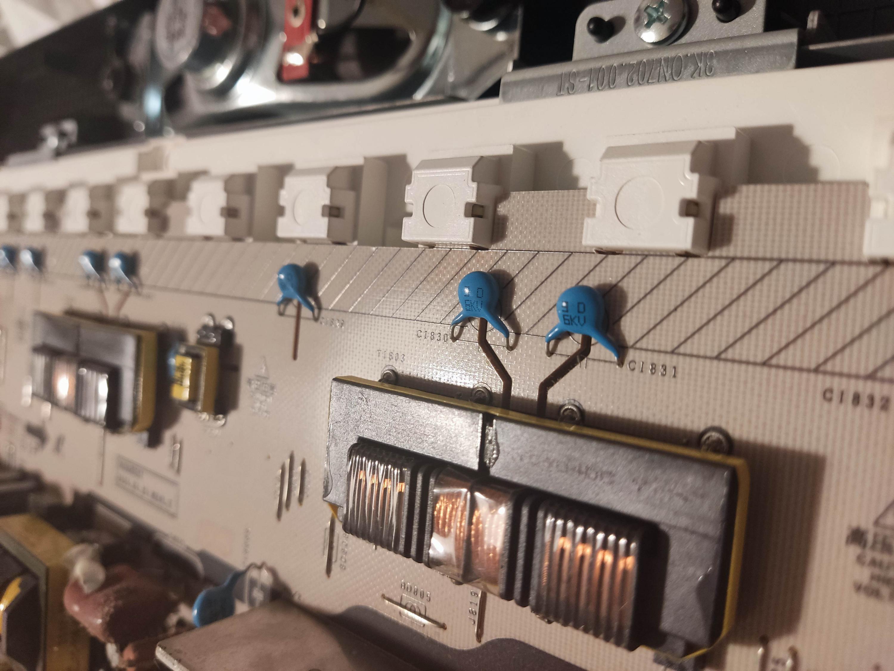

          The PS board is huge. The ps board itself has connectors shaped in the edge of the board to connect to the backlighting at one side (see pics)
          Im wondering now, is this TV LED or CFL?
          Anyway I unplugged the main-to-ps cable and the BL didn't turn on.
          So I put it back in and turned it on again and pulled the main cable immediatly out, and the on-off cycle happened too.
          Do you believe this TV is repairable?

            appears to be cffl, need to be very careful BIG DEADLY VOLTAGE in that socket area where they plug in when powered. Are you sure about that model number?

              I would start with the easier stuff, check the solder joints, check the diodes and resistors, check transistors for shorts, the caps are 14 years old could be one or more are bad. maybe hit the electrolytic caps first with a hairdryer see if it turns on or theres any change if only for a bit, start with the ones by the connector then the others, no joy hit the other ceramic caps with hairdryer.

                Yes if you check the 2nd picture you will see the plugs-to-BL while it was still on, but the board was correctly sitted into the BL plugs when I opened it, there was a bunch of screws holdnig it in place
                I will check those caps and Q's and see what I can get, thanks
