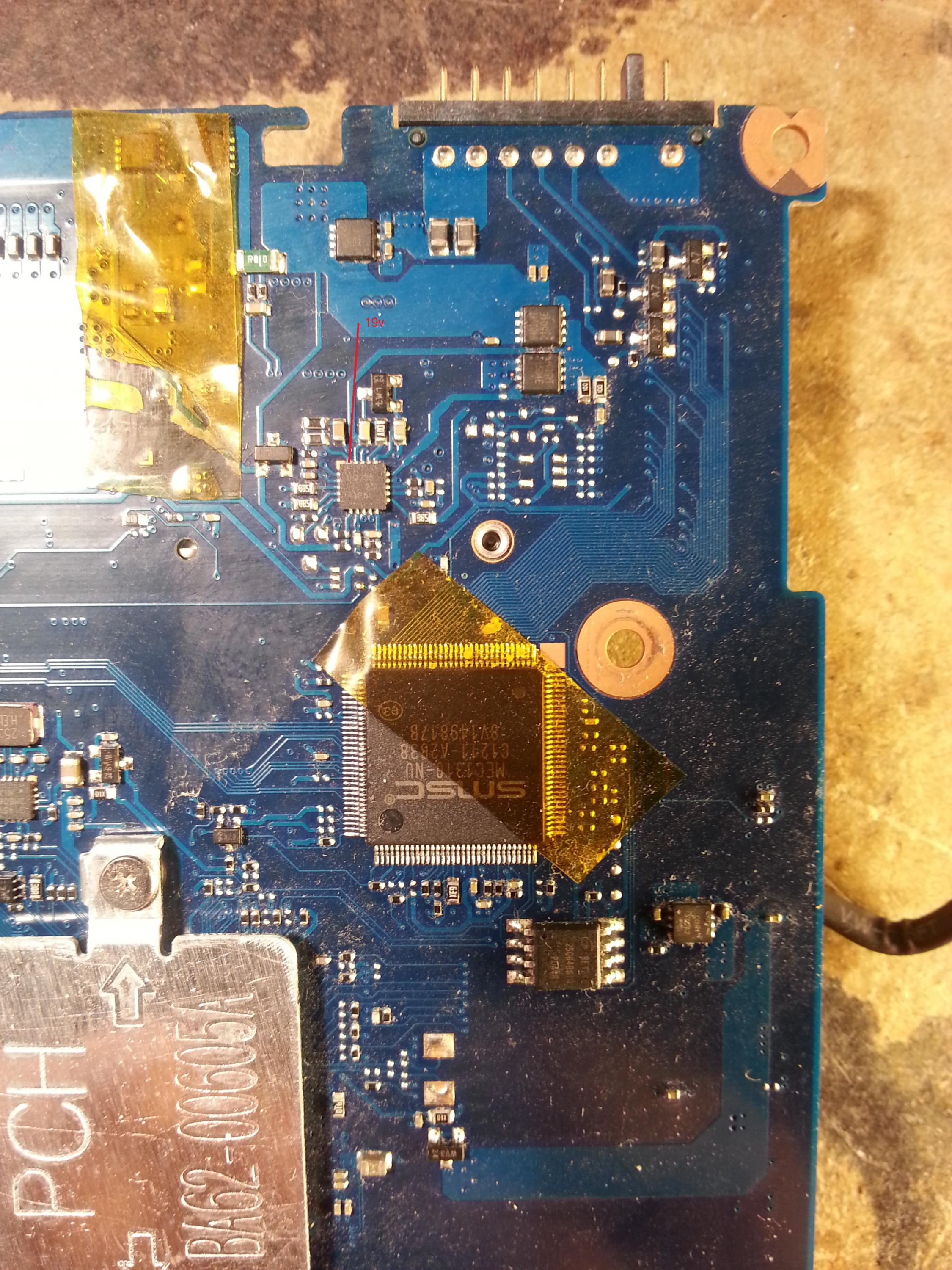

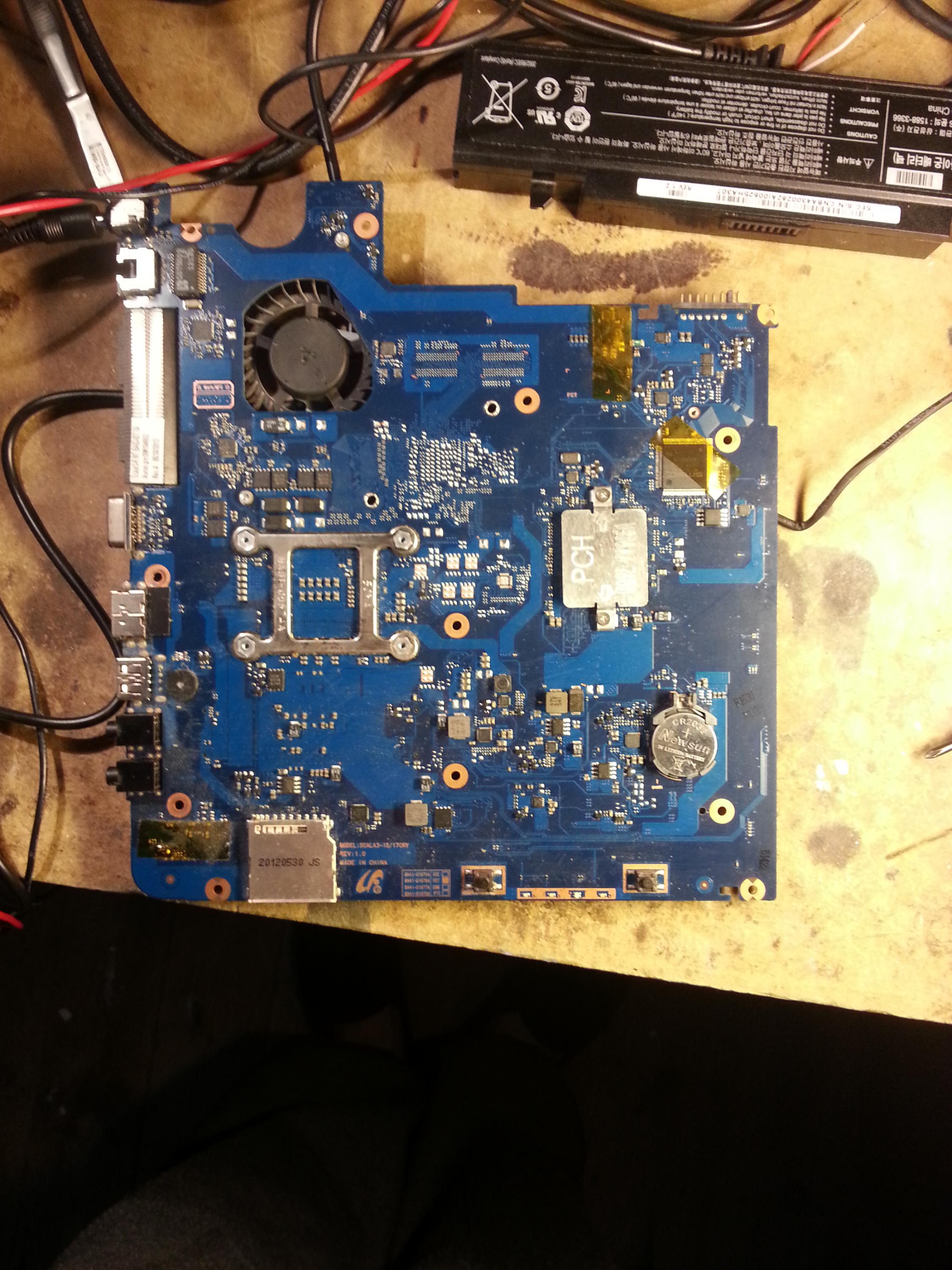

    Hello, i have been given a faulty Samsung NP300ESC laptop with a Scala3-15/17crv motherboard to look at. The customer said the old charger died so they bought a new one which was universal. Since then there have been powering on issues. I have measured the voltage on this and it's nearer 20v not the 19v it says. Either it's this or the previous charger have damaged something i think.
    There are no LEDs lit when i plug in my power supply and pressing the power button does nothing. However if i plug in a battery the laptop powers on fine.
    There is 19v on VCC of BQ735 up near the battery connector, but without a schematic i'm struggling a bit. Can anyone point in the location of where i need to be testing please ? Thanks

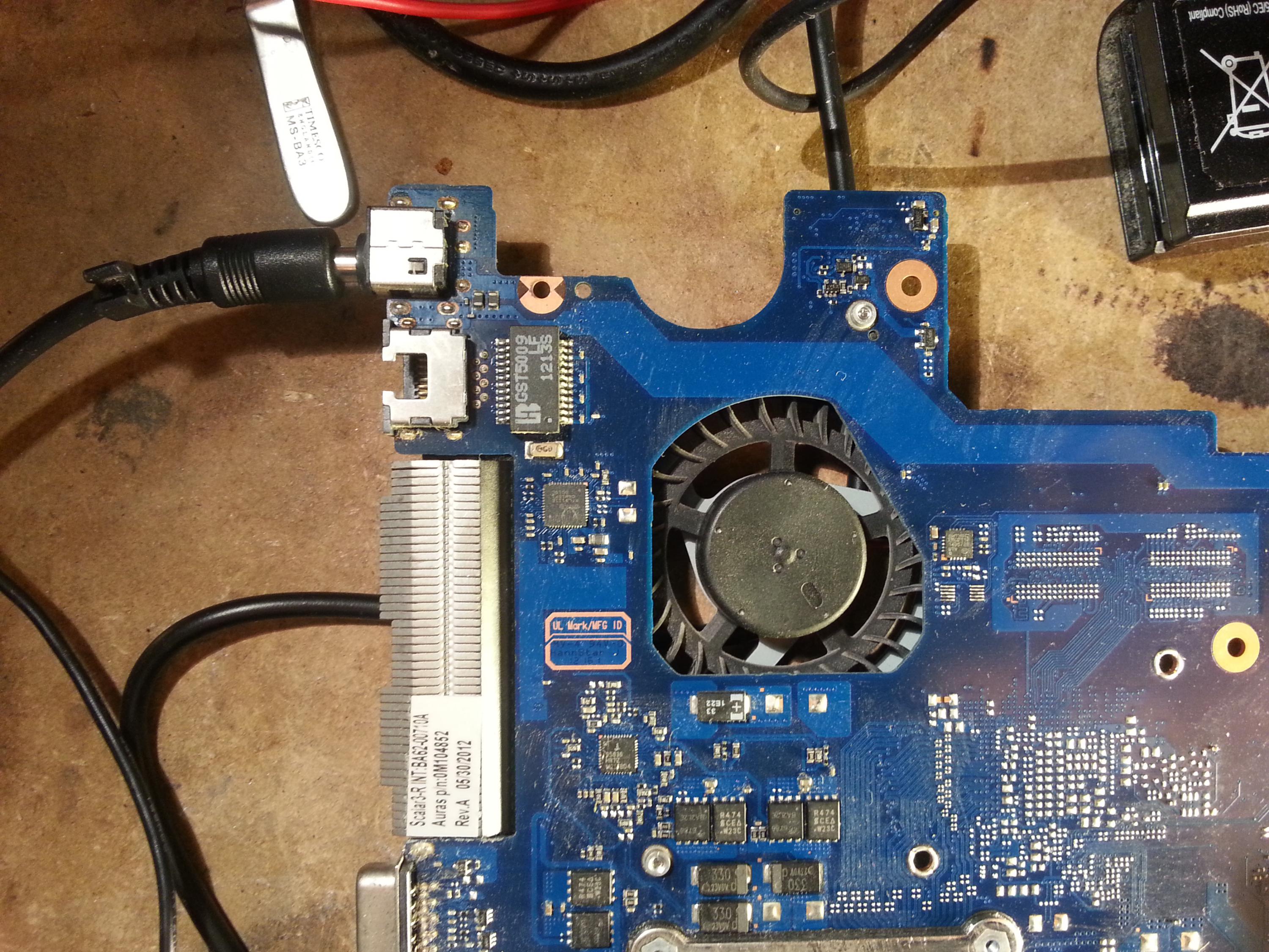

    first! like you need to be 100% sure that the DC jack its ok.
    90% of the Samsung i do they all bad there and even with cables!

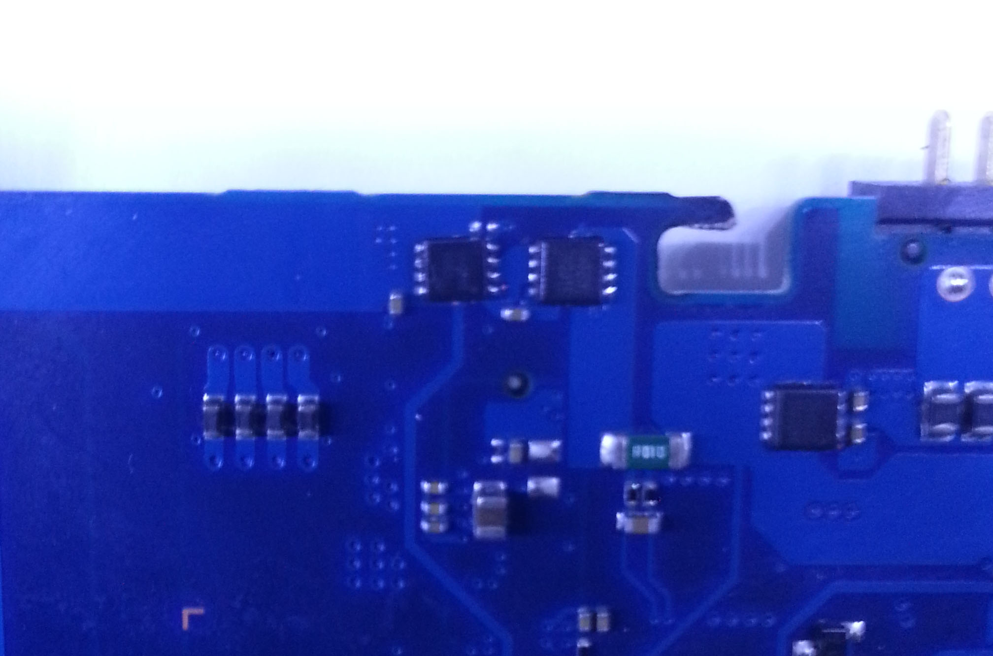

      Re: Samsung powers on with battery, no power with charger.
      See photo , check there, you have 2 i.c , one is shorted .
              Two fet or dual fet in between 5v and 3v power ic
              one of those gone wrong
                Thanks for your replies.
                I have checked the dc socket. I get power on the board from the centre pin, so i know that is fine.
                I checked under the tape as indicated by angel-boy and found the 2 ics.
                with markings 7200 on one and 9402ygt on the other.
                I found no shorts to ground or to its other pins and have measured the voltages.
                AON7200
                S-75-135mv constantly fluctuating
                G-50-126mv constantly fluctuating
                D-18.24v stable
                9402gyt
                S-60-130mv constantly fluctuating
                G-60-130mv constantly fluctuating
                D-1.03v stable.
                  I repaired Np350E
                  I found the second 9402 gyt is shorted to measure better to remove it from board , i ordered it on ebay replaced and the laptop works fine.
                        The parts arrived and i soldered into place. However during the soldering i managed to knock off and lose a small ceramic cap, just above the two ics.
                        Any idea on a value ? Thanks.
