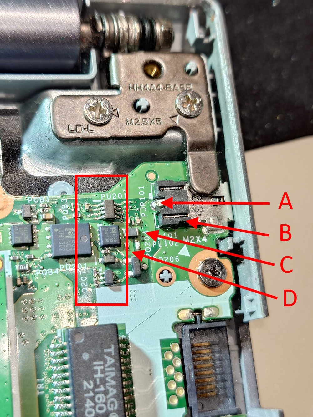

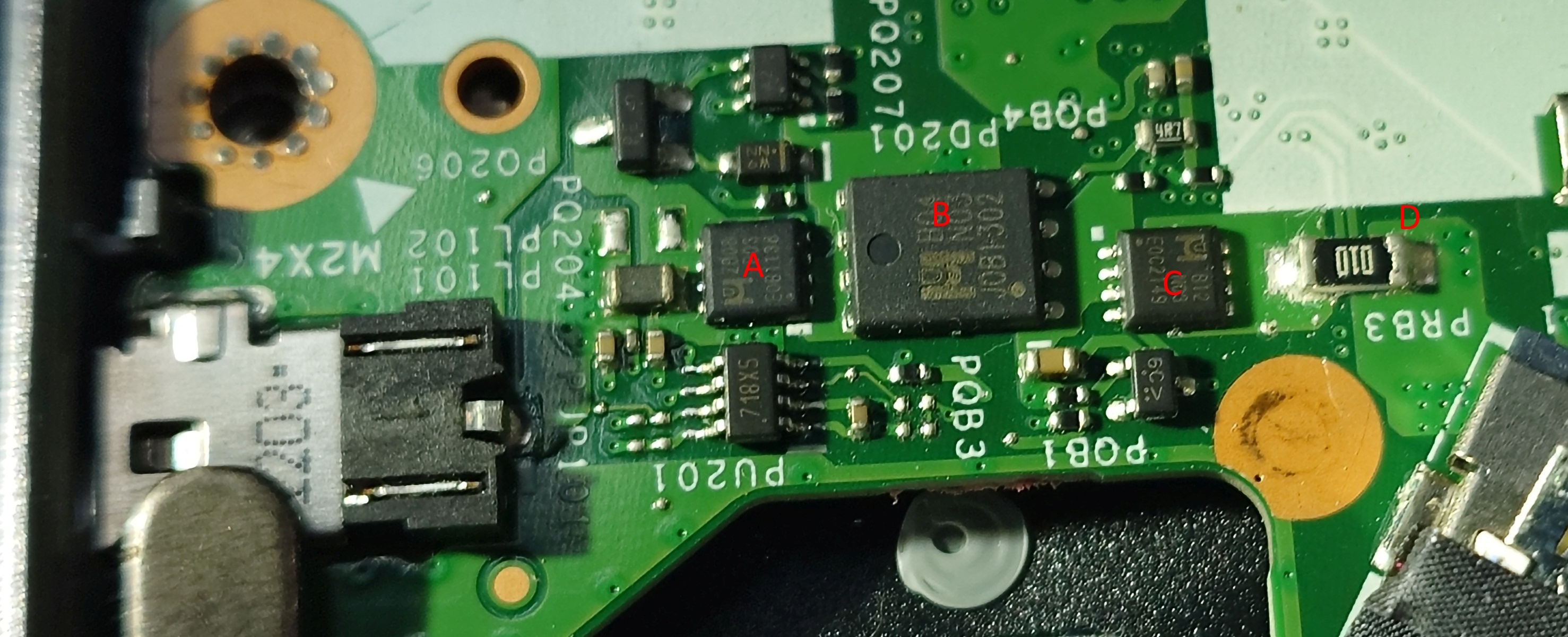

    Dear all, I am trying to troubleshoot an Acer Aspire 5 A514-55 that won't power on. I'll describe the symptoms and my findings so far, and I would like to seek guidance and suggestions on possible suspects in terms of cause/component failure. My initial thoughts are battery charger IC and/or ideal diode/MOSFET (that switches between incoming DC and battery power), but I could be totally wrong on this.
    1) Laptop was working fine on battery, then user realised battery was running low. Plugged in AC adapter but noticed it was not charging (LED on AC adapter plug did not light). Eventually shut down from low battery.
    2) Since then does not power up, whether on AC adapter or battery.
    3) Tried the following without success:-
    a) battery reset switch - held for 60s
    b) disconnect adapter, hold power button for 15s
    c) left charging overnight
    4) Findings so far (see image below):-
    a) AC adapter works fine - tested using multimeter.
    b) laptop DC jack connection to motherboard seems fine - measured 19.5V at points A, C, D. However, LED on AC adapter's DC plug does not light
    c) I read that some Acer models have a pin that has to be grounded (B) to indicate DC plug is fully inserted, otherwise battery won't charge. This was confirmed to be fine here (that is, B was grounded when DC plug was inserted).
    d) However, 0V in areas beyond (i.e. to the left of) the components in the red box
    e) Voltage at battery positive connector: varies when AC adapter is plugged in, so far 16.5V and 17.3V have been measured (too high?) at different times. Without AC adapter plugged in, 14.8V.
    f) Trying to power up the laptop by shorting the 1st 2 pins of the keyboard connector also does not work, which suggests not a power button issue
    Click image for larger version  Name:	DC jack area - annotated.jpg Views:	0 Size:	596.9 KB ID:	3522495

    https://www.badcaps.net/forum/troubl...arging-circuit

      Thank you piernov! That is a detailed and educational post, and I'm still digesting it. I'll also head over to the schematics forum to see if anyone has the schematics for this laptop model and try to apply the troubleshooting steps you'd set out in the post!

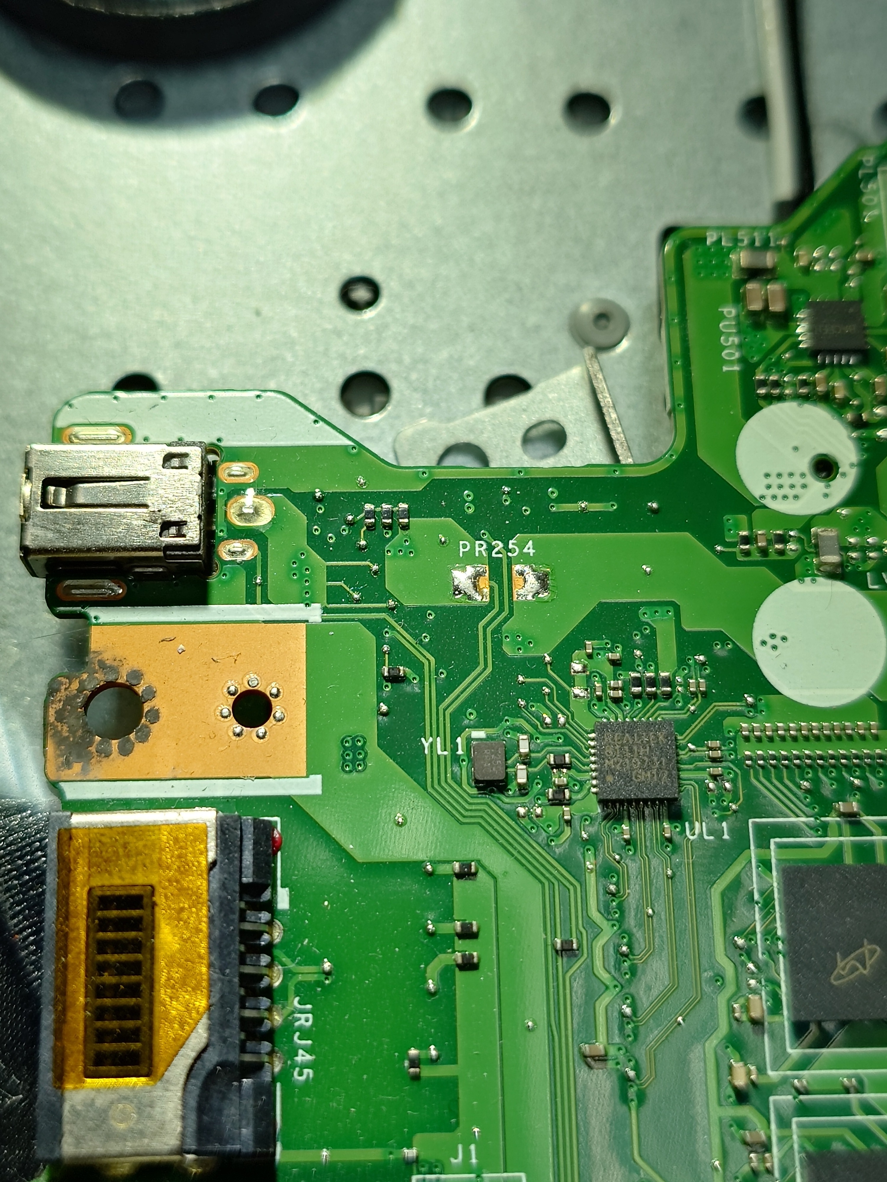

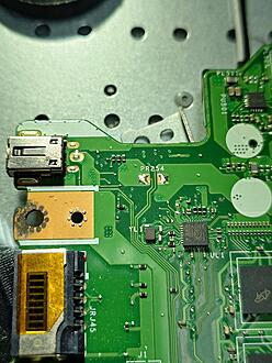

        So I removed the board and examined the underside. I found what looks like signs of a missing component. I could be wrong, but looking at the page linked to by piernov, could this component be the AC input current sense resistor? Judging by the "R" designation and large lands on the PCB.
Name:	missing resistor.jpg
        • mon2
          • Dec 2019
          • 13891
          Yes, you are on the right (pcb) track. Hunt around for the charger IC which will probably be the 'BQ' series. Share the pic of this IC. We can then review the datasheet or sample schematic to understand which pins are the ACN / ACP used for the adapter current sense pins.
          Once these details are known, without power to the board, measure the resistance from ACP pin on the charger IC to PR254 right side pad. There should be ~0 ohm resistance in this path. This will confirm that the missing resistor is indeed the current sense resistor.
          If available, you can also study the schematic for this logic board and confirm the value of PR254.

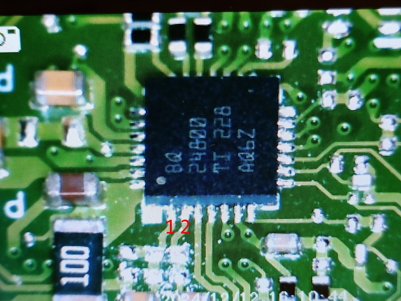

            I did find the battery charger/controller prviously, as I was preparing to go through the troubleshooting process in piernov's guide before I discovered this.
            It's a BQ24800. Product page is here https://www.ti.com/product/BQ24800, but for some reason they only have a brief datasheet without the usual pinout chart - full datasheet upon request. I've attached a copy of the brief sheet for convenient reference, while I continue hunting for the full datasheet.
            Edit: Ha! The datashet for the eval board for this controller was available, and in that datasheet was a schematic with a pinout. Attached!
            I wonder if TI uses the same pinout for all its BQ2x controllers.
            Edit: Seems like it, pins 1 and 2 are ACP / ACN just like the bq24781.
            Unfortunately I don't have the schematic for this board, although I've put up a request on the relevant board. In the meantime, a related model - Acer Aspire A514-52 (which schematic was available) - uses a 0.01R 0805 1/2W ±1% current sense resistor. Wondering if I could use the same value.
            Edit: From the BQ24800 EVM datasheet, the eval board uses a 0.01R resistor as well.

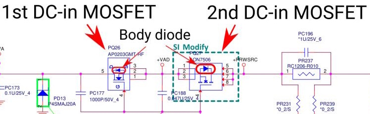

              Yes, some parts, like some techs that learn and disappear with the fixes, are in the witness protection program.
              However, we can learn what we want from the BQ24800 EVM schematics.
              See attached.

                      Sooo... I did a quick test for continuity from pins 1 and 2 of the BQ24800 (per attached photo in case I got it wrong) to either pad of the missing component. No continuity
                      I might be doing something wrong, will try again tomorrow. I'm quite sure there must be something across those pads.

                          hello try to measure the vcc pin 28 if you got a 18.5v-19.5v, next to check is the pin 6 acdet you should have 2.6v and not should not exceed to 3.15v.. next check the regn pin 16 it should be 6v, then check acok you should have 3.3v sometimes some laptops doesnt use acok
                          pin 28
                          pin 6
                          pin 16
                          pin 5

                              3) I think I've figured out the actual AC current sense resistor. Pads connect to the charger IC's pins 1 and 2, it matches the value (0.01R) and typical package footprint (0805), and the layout next to the adjacent MOSFETs resembles closely the typical layouts for the BQ24xxx (schematic from piernov's post)
Name:	DC-in MOSFET, AC sense resistor - annotated.jpg
ID:	3525704 Click image for larger version
Name:	DC-in MOSFET, AC sense resistor - schematic.jpg
                              I believe "B" = 1st DC-IN MOSFET, "C" = 2nd DC-IN MOSFET, "D" = AC sense resistor... but not sure what MOSFET "A" is.
                              Which means the missing PR254 is still a mystery.

                                Hi alfredposadas09, I've finally managed to get the measurements you asked me to check. I tested with AC and on battery, and the numbers are "AC / Battery":-
                                1) pin 28 (Vcc): 19.0V / 16.0V (Battery voltage also 16V)
                                2) pin 6 (ACDET): 2.63V / 12mV
                                3) pin 16 (BST_STAT): 0.6V (did you mean 6 or 0.6?) / 380mV
                                4) pin 5 (ACOK): 3.3V / 0V
                                As an aside, I measured 19.0V on both sides of the missing PR254... it's a 0805 SMD component, based on the size of the hole in the solder, and I'm wondering if I should try shunting it with a 0.01R AC current sense resistor and see if that works...

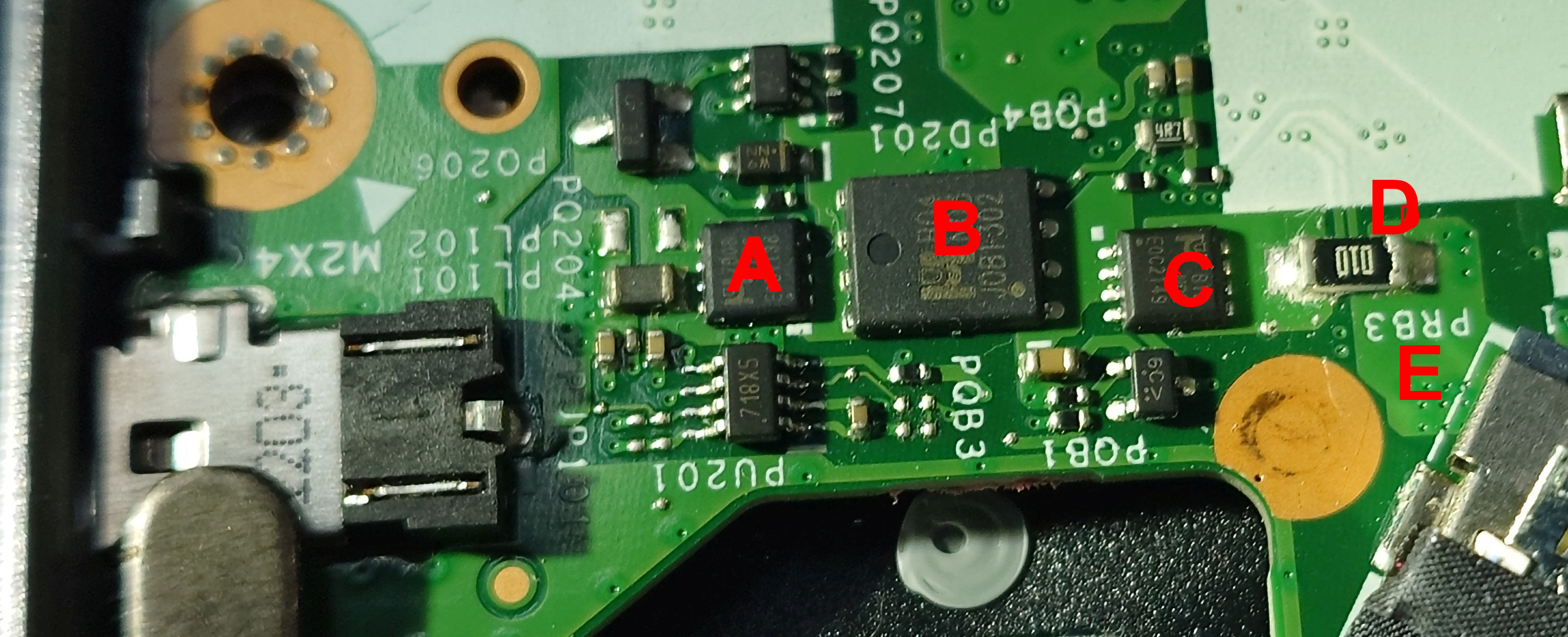

                                      On a whim I measured the resistance of (what I believe to be) the AC current sense resistor (see post #15, PRB3)​. To my surprise, it measured 1R (not 0.01R as I was expectng). Taking a closer look at the component it appears that it is indeed supposed to be a 1R resistor. In which case I wonder if it still could be the AC sense resistor?
                                      • DenK
                                        • Dec 2024
                                        • 24
                                        • Malaysia
                                        Originally posted by DenK
                                        No problem at all, happy to provide whatever info I can 😄
                                        1) pin 24 (REGN): 6V
                                        2) pin 25 (BTST): 5.7V
                                        (ok I misread your post, missed out pin 4 - will do that soonest!)
                                        Pin 4 (ACDRV): 25V
                                        Knowing now that ACDRV drives the DC-IN MOSFETS, I then measured the gate voltage of those FETS.
                                        Click image for larger version  Name:	DC-in MOSFET, AC sense resistor - annotated2.jpg Views:	0 Size:	1.45 MB ID:	3530854
                                        MOSFET A: 17.4V
                                        MOSFET B: 25V
                                        MOSFET C: 25V
                                        Which suggests that B and C are indeed the DC-in MOSFETS. Curiously, I was now able to detect 19V all the way up to point E - that is, past the AC current sense resistor! Previously there was no voltage passing through the MOSFETS 🤦
