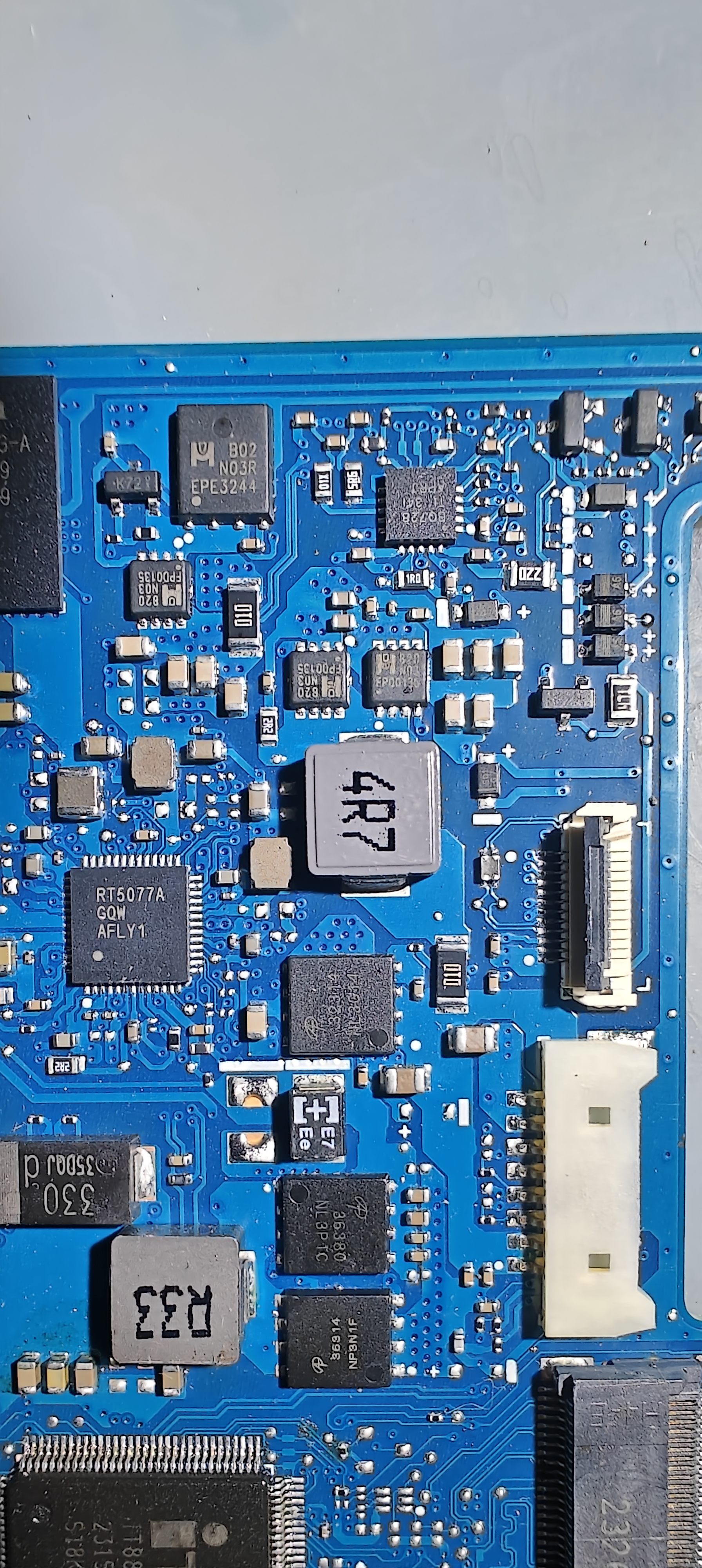

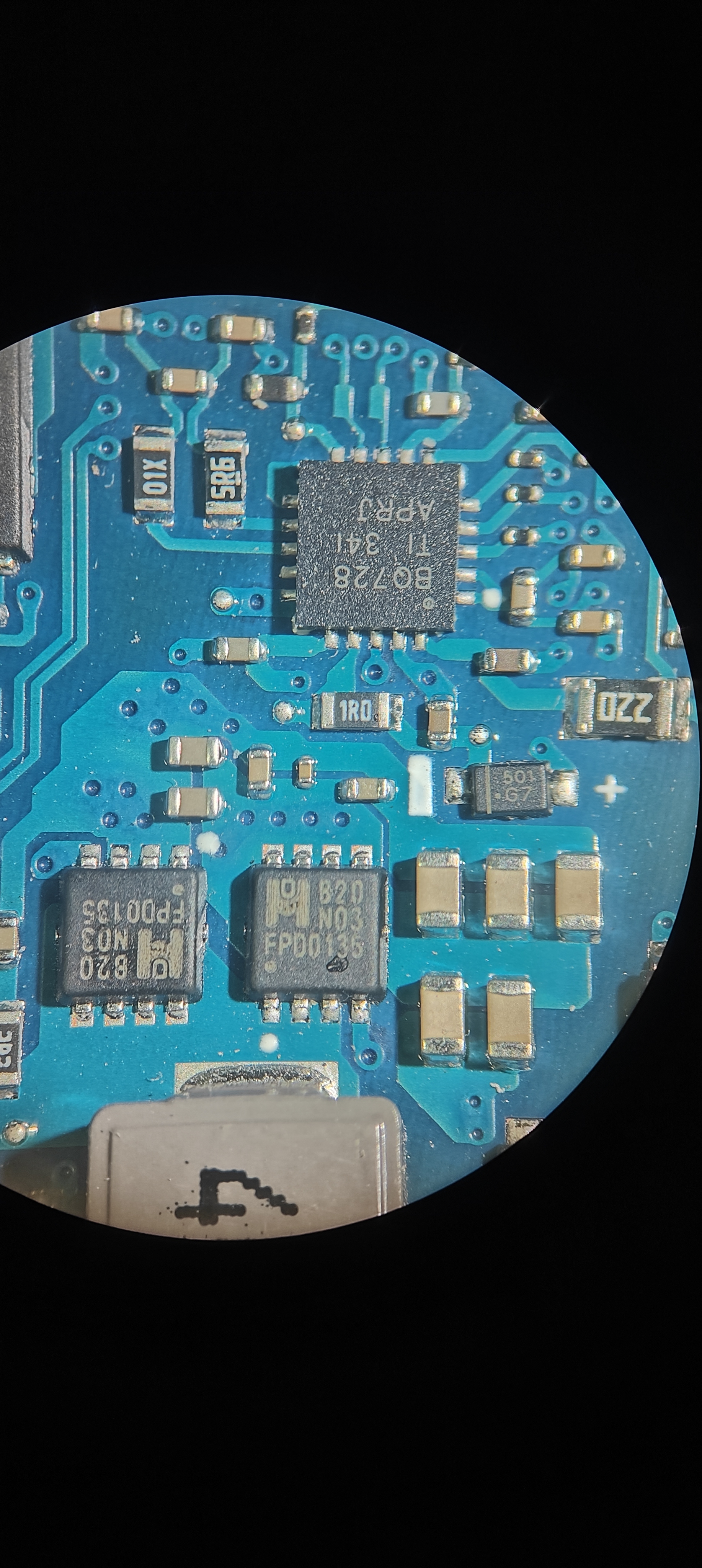

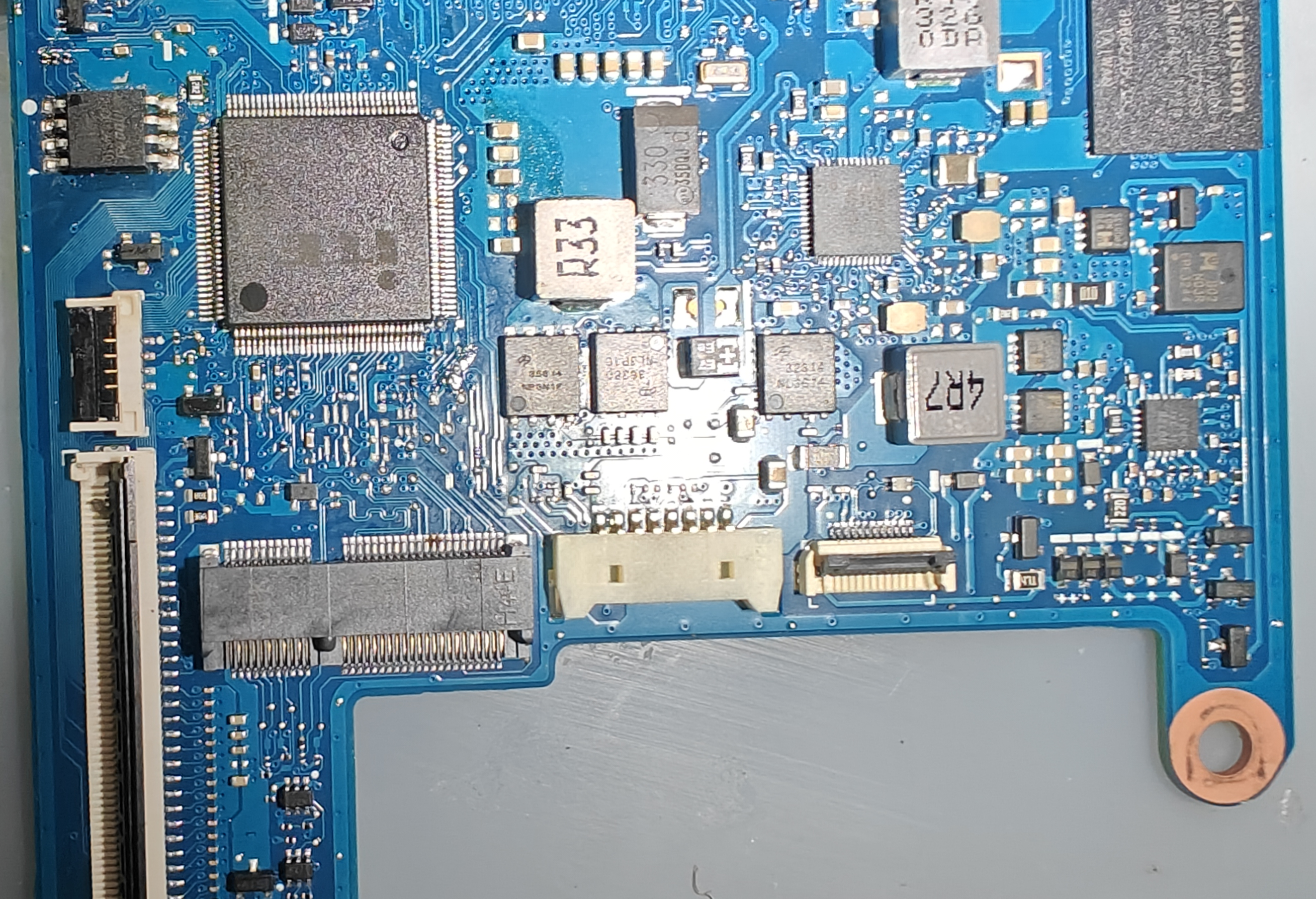

        Thanks for the reply, mon2!
        This board is smaller in size, so they are using components that I am not accustomed to working with. I think I know which mosfets you want me to take measurements of, but could you look at these pictures and just verify which ones you want me to measure so I don't measure the wrong ones and waste your time? Thanks.
        Also, the battery charger IC is BQ728

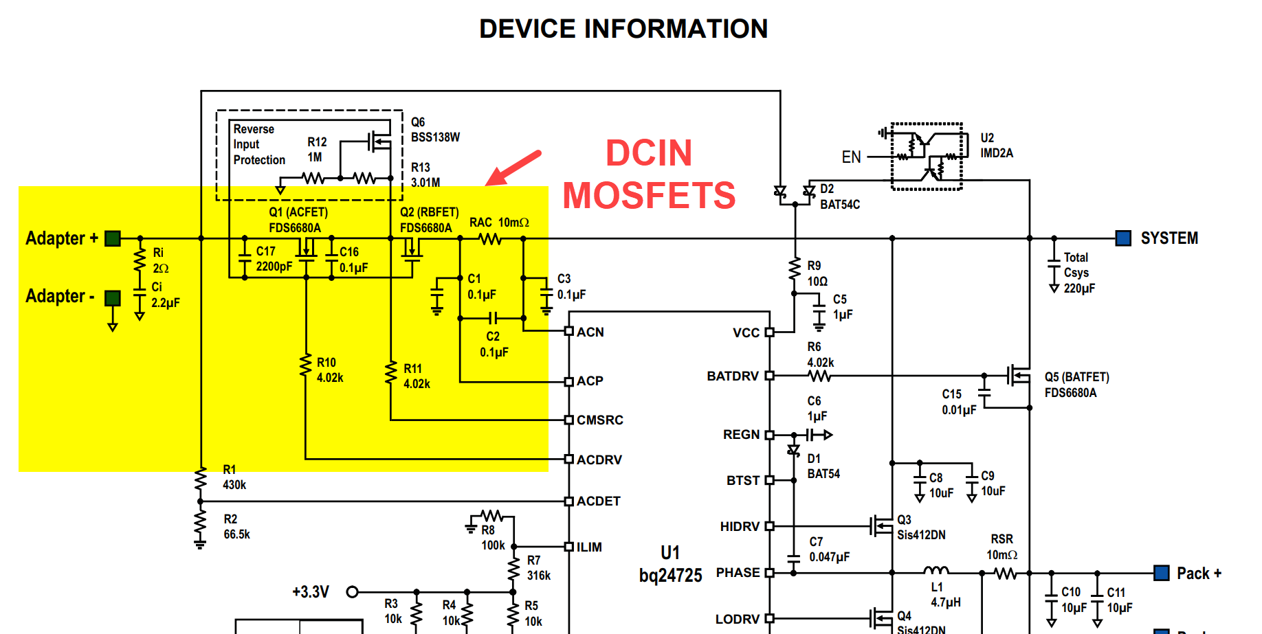

          You will certainly not like the new macbooks / ipads and their 0201 or smaller parts that are onboard!! Personally cringe when they come in for service.
          The BQ728 is in the witness protection program so not easy to locate datasheets for this device but BQ725 comes up on a valid match. We can study the BQ725 pinout to learn about your logic board.
          BQ24725 data sheet, product information and support | TI.com
          2-4Cell Li+ Battery SMBus Charge Controller with N-Channel Power MOSFET Selector datasheet (Rev. A) (ti.com)
          Locate the mosfets that should be nearby to this charger IC. The mosfets may be on the opposite (or bottom) side of this charger IC. We are after the 2 * DCin N-channel mosfets that will be mating the power adapter to the main power rail and the ACDRV pin # 4 will drive the GATE pin to enable the power path.
          When ACDRV is ~25 volts, the gate pins of the 2 * DCin mosfets will enable. Often there is a ~4k ohm resistor between the GATE pin # 4 of the mosfets and pin # 4 of this charger IC.
          Remove all power. Meter in resistance mode. One meter probe on pin # 4 of this charger IC. Other meter probe on any mosfet that is nearby -> pin # 4. Stop when you locate the mosfets (there will be 2 of them) with a ~4k ohm resistance.
          Once found -> share a close up picture of this region.

            I believe this is the region you are asking for?

              Nice and clear pix. Can you take a pic of the other side of the board under this same charger IC. The mosfets we are after are probably on that side. The ones in the posted pix are the battery charge mosfets since there is a linked power inductor.
              The reference design from TI offers guidance on is most likely onboard.

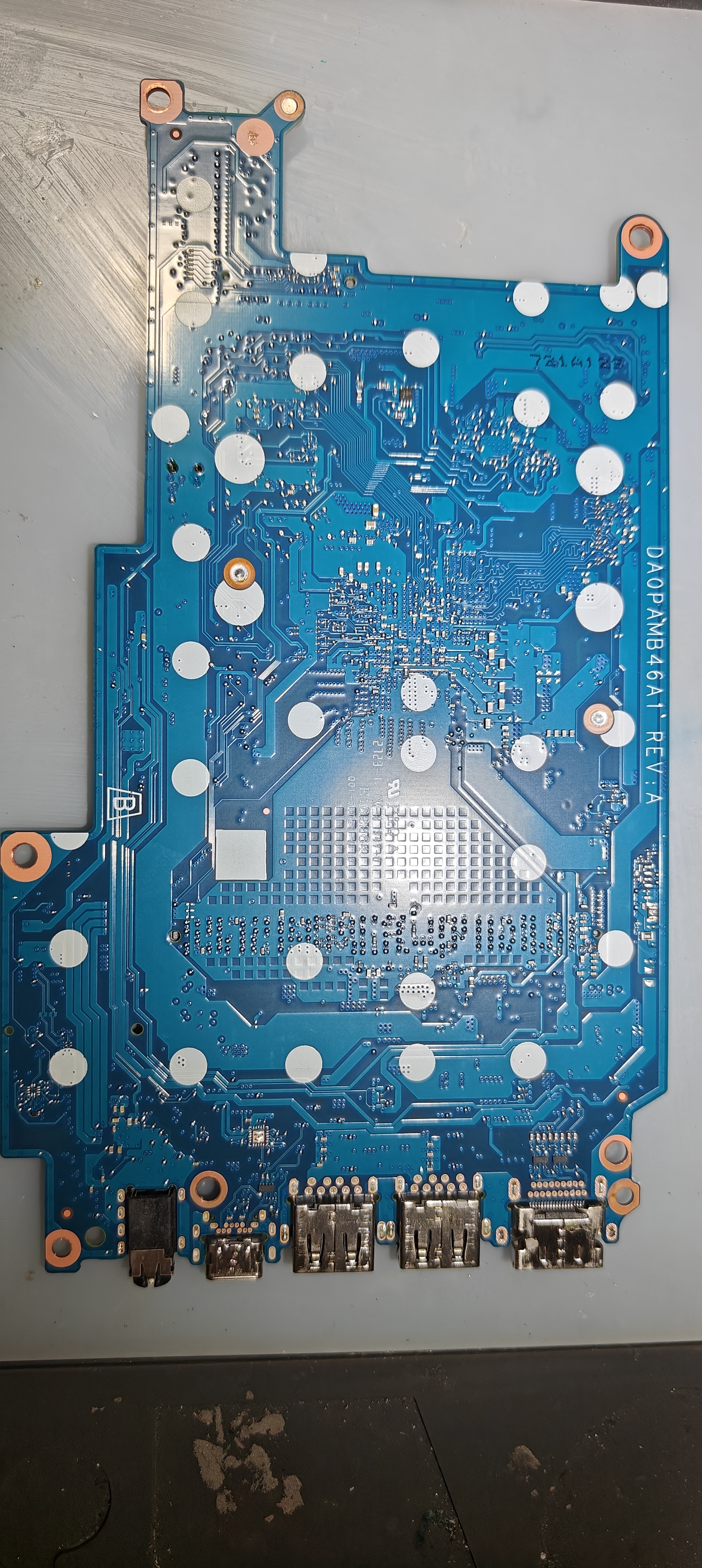

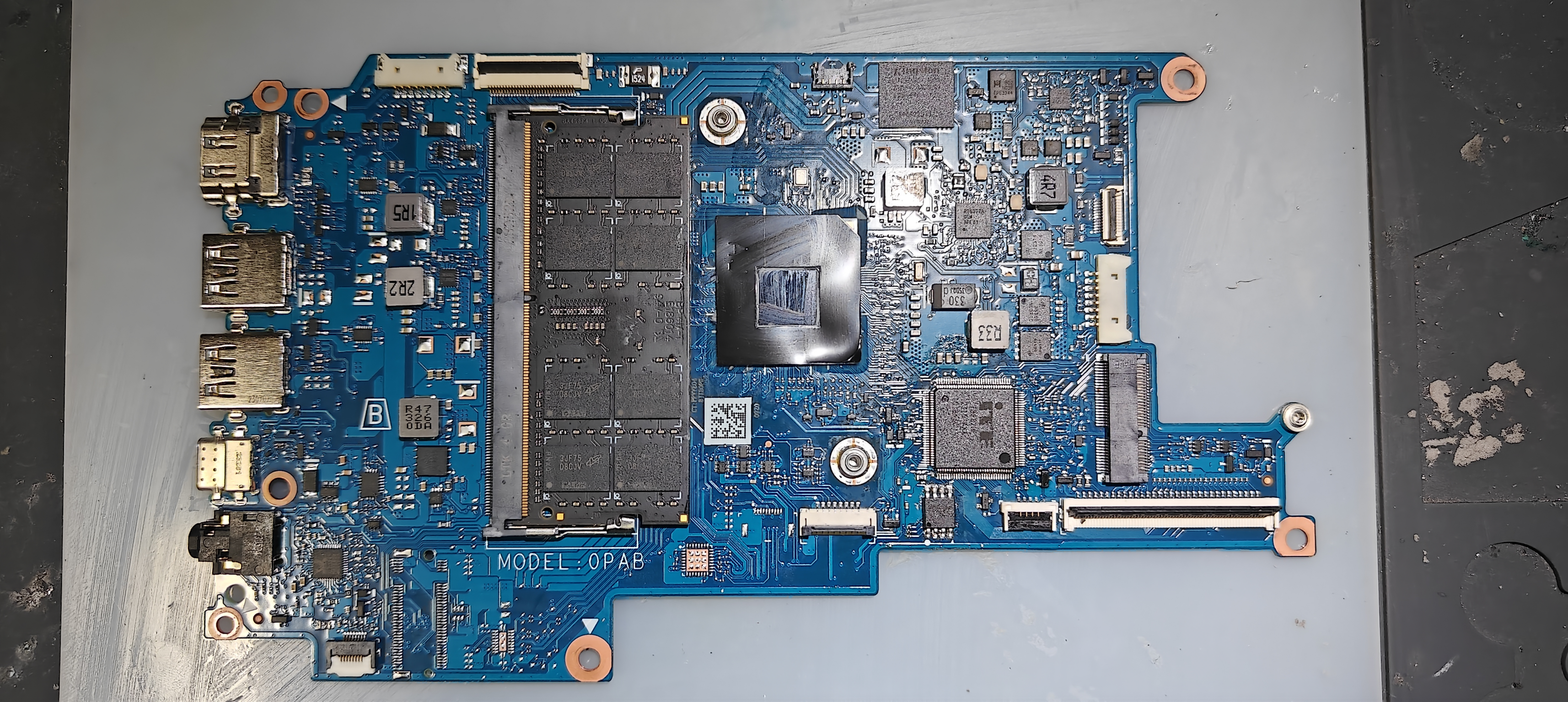

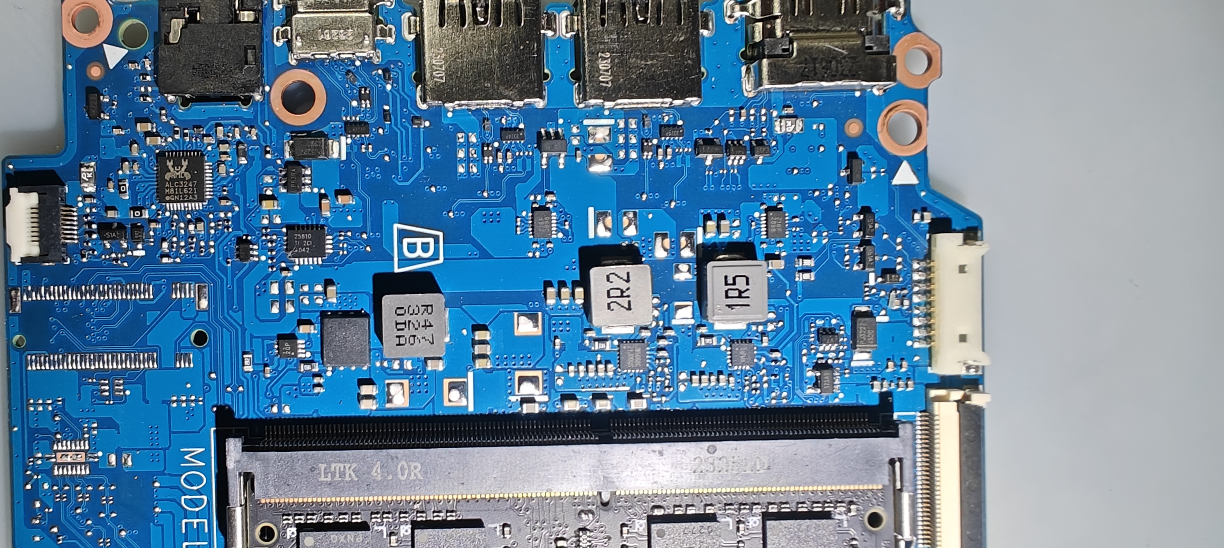

                Nothing underneath the board, just some caps and a few resistors and an IC or two, but here is a pic.
