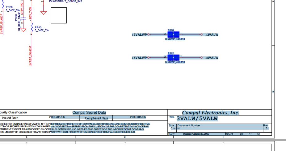

                      not help flash
                      pj10 3,3 V
                      pj12 5,1 V

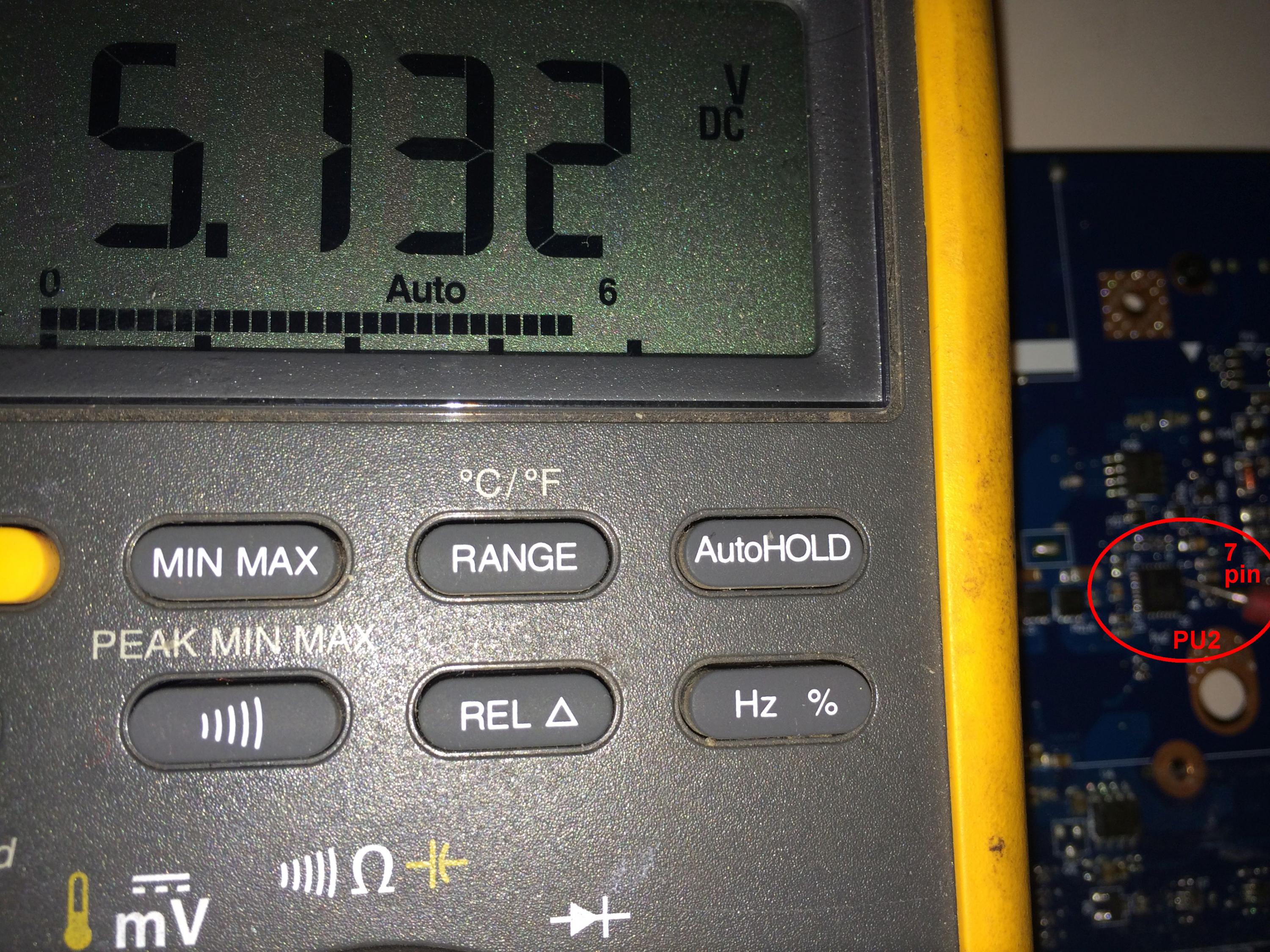

                        what do you get at pin 7 of PU2? You should get 5v there. if not, replace the chip.
                        • torla
                          • 76
                          Re: Lenovo G560 LA-5752p NO Power No Light
                          Thx for help pu2 is Ok.

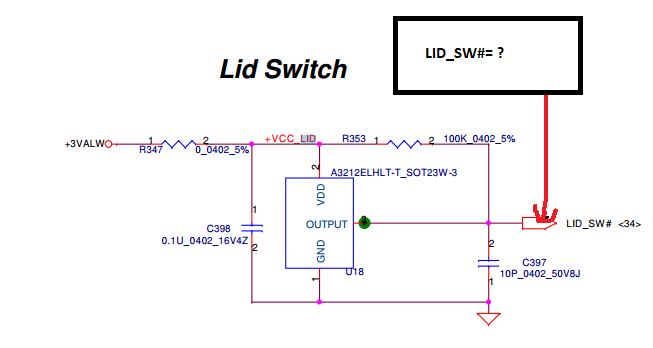

                              if LID_sw# is low laptop can not power on
                              check this:
