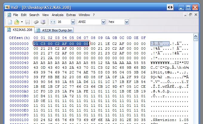

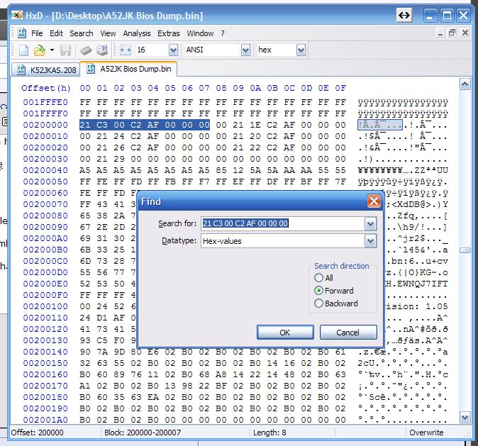

      Re: ASUS A52JK fan at 100% speed
      well there is no magic there.. all done manually with hex editor
      i was going to make some kind of mini tool, since ive taken some C++ courses but i do not have time right now (working two jobs)
      anyway, i do it like this
      first you make full dump of bios (in this case 4mb, file named "A52JK Bios Dump.bin")
      then download official update from Asus website (2mb named "K52JKAS.208")
      open 2mb file in hex editor
      and select first 4 or 8 bytes depending on version change (image 1)
      open dump file and do hex search for selected bytes in dump (image 2)
      select all bytes from first file (ctrl+a) and paste over found bytes but be sure that found bytes and pasted bytes match adresses (image 3)
      new saved file must be same size like dump file
      save new file and flash with programmer
      this is like a mini tut, made in educational purposes... i use this to fix asus bios, but similar method can be used for many other vendors. also thre are cases where this does not apply
        so let me get this.
        you just take the Online bios and compare it in hex editor with the original one from the notebook and if you see a line similar but corrupted you copy from the ONLINE and paste in to the original laptop bios?
        • ala_borbe
          aka Donald
          • 1625
          • Malta
          yes,
          keeping first part which contains data like ME region and LAN MAC address intact and specific for that unit only... there is somewhere data on fan speed, so that must remain intact.
          overwrite only main bios, which is obtain from web update, and also that is a part which get corrupted cos ezflash and bupdater only update that main part, does not touch nothing before it (i call it main cos there are data that actually initializes devices like cpu, chipset, vga, lan and then read that first part and set devices with data read from it)
