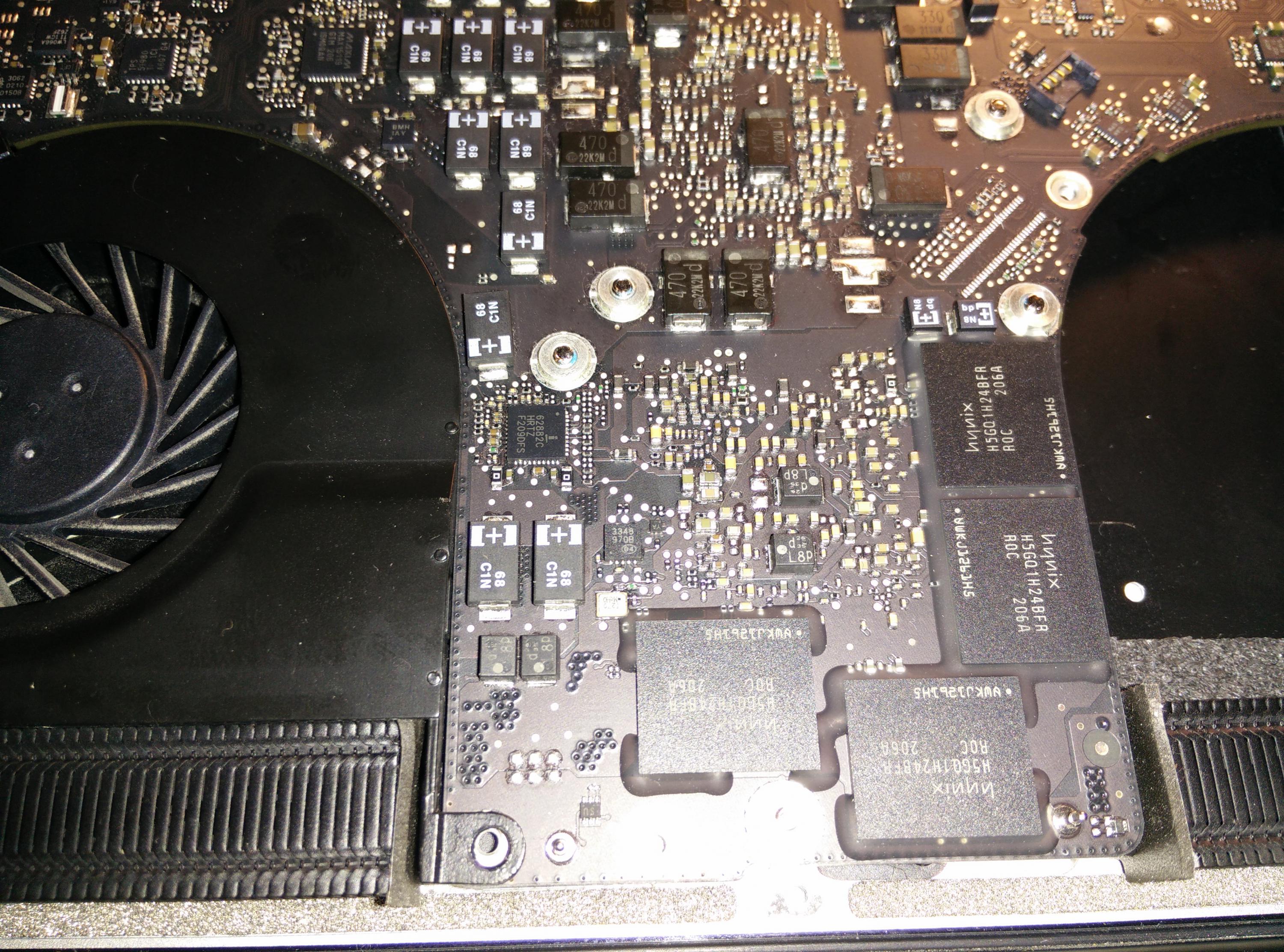

    I have an issue with MacBook Pro 15, mid-2012. For now, it is dead. It didn't get any liquid or fallings, just died in my arms.
    My problems started like that:
    When I connected charger then it didn't charge. No lights on Magsafe but remained working on battery.
    Then I checked my charger on another MBP and it worked. I tried other charger on my MBP and still no lights on Magsafe nor charging.
    Several minutes went by and MBP just died. Can't turn on and no activity.

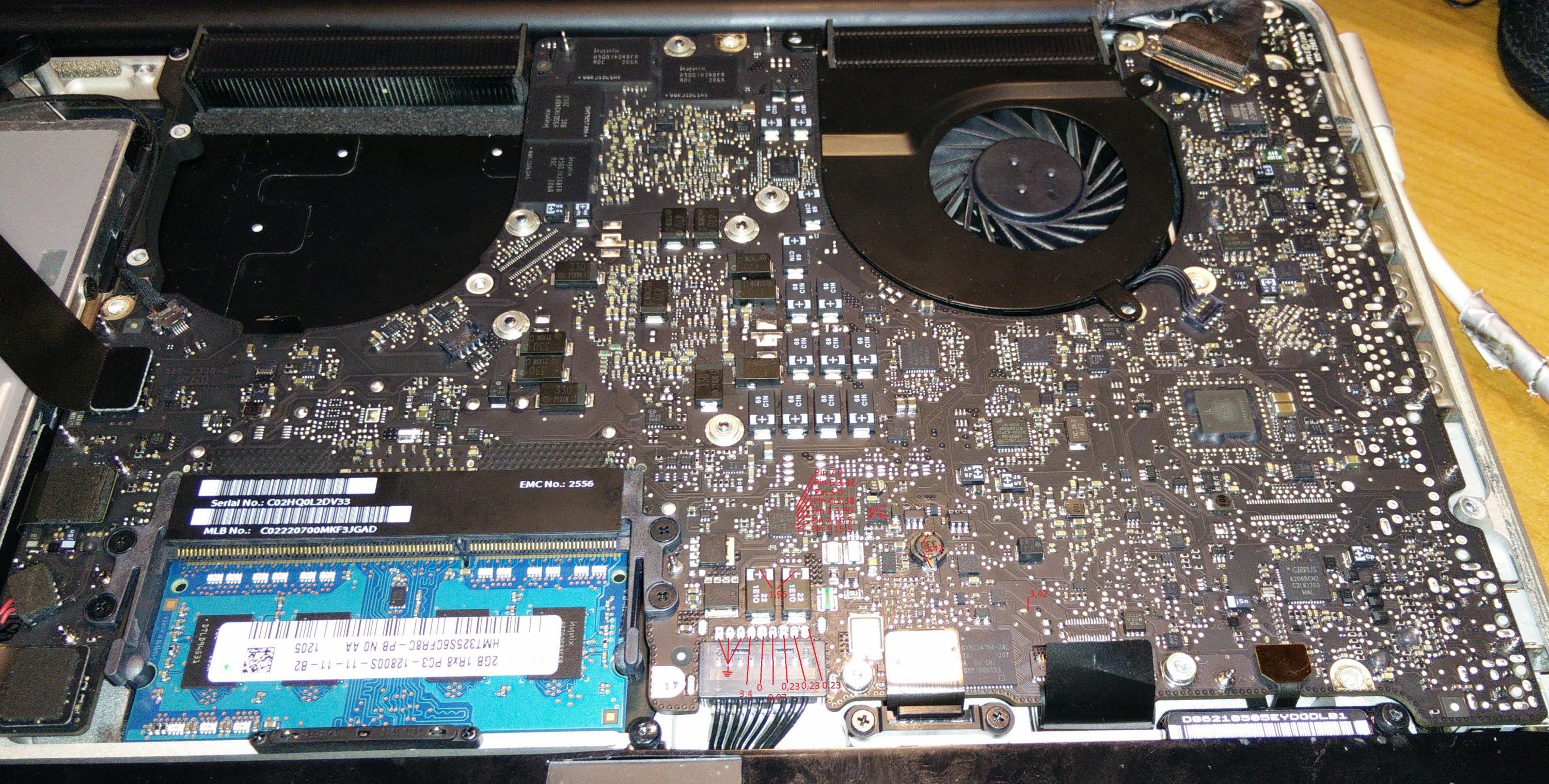

    I disassembled laptop and took out motherboard to start tracing the fault. I tried to turn it on from keyboard connector but no luck.
    I measured magsafe board while connected to motherboard and charger present. I get 0.9V from charger connectors and 0.3V from center pin. I tried to "brute force" charger to turn on by adding a 4k7 resistor to 1. and 2. pin on magsafe board. Then I hear weak "sine tone" from somewhere on motherboard and I get around 3V reading from magsafe pins 1 and 2 but still no lights on magsafe. Conclusion:
    1: something drains power drastically
    2: why computer doesn't let charger to turn on?
    I have read numerous topics on MBP 13 issues but I lack finding any clues on so new MBP...
    Does anyone have any ideas what to measure?
    I would appreciate if someone could give me datasheet for my MBP or schematics for magsafe onewire system and power distribution system.

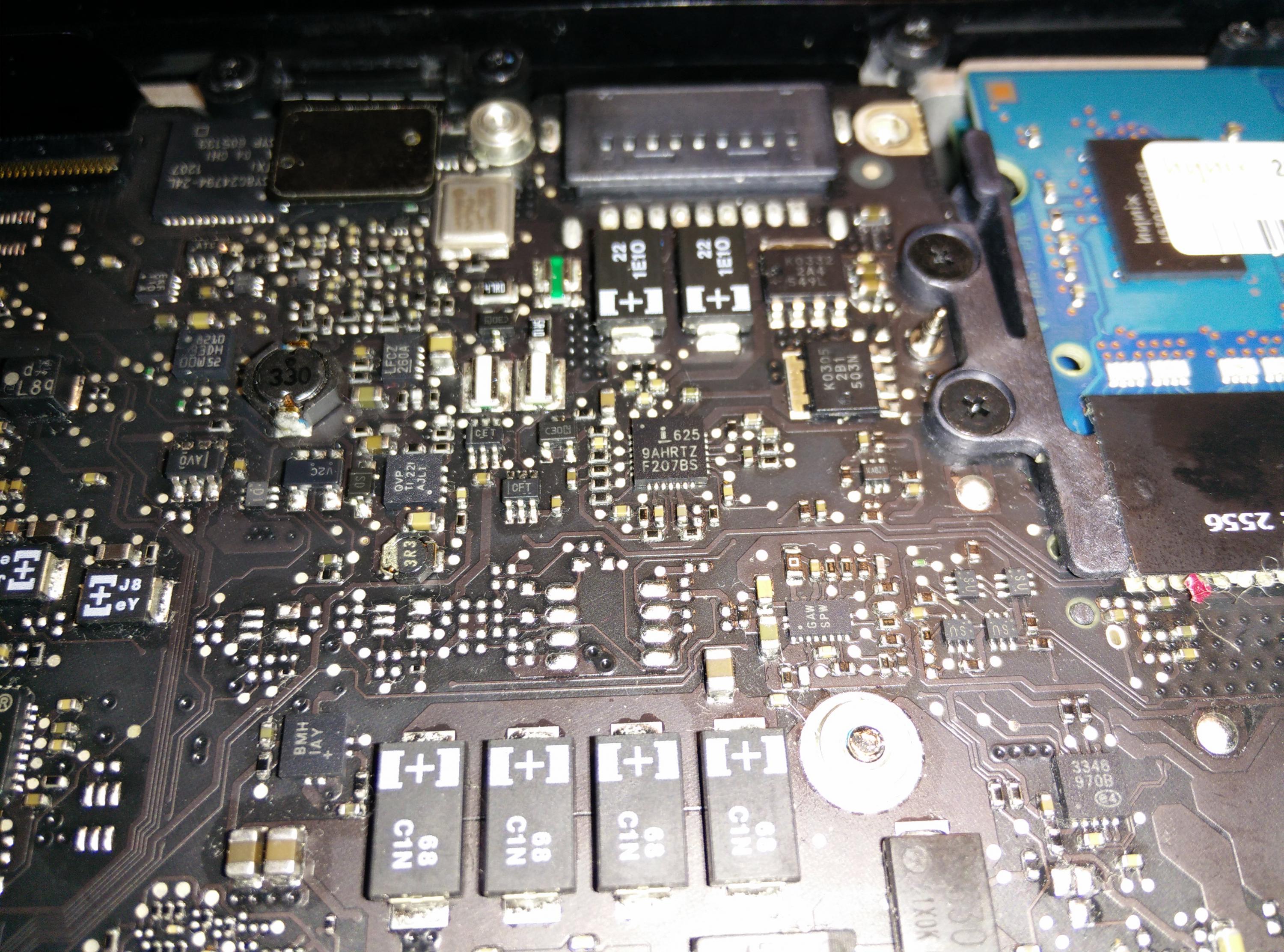

              It is hard to find that geohot ic. Please give me ideas, what it looks like, IC number? Do you mea G3hot IC?
              Edit: I found that IC 625.
              I measured with and without charger and battery present while computer turnd off.
              Fom pin 1 I got 9.48 to ground
              on pin 2 I got 9.87V to ground
              On pin 3 I got 2.4V to ground
              I think that chip has a problem

                        Re: MacBook Pro 15" 2012 dead
                        I am running out of any ideas. Now Macbook is not powering on again, magsafe green light is very dim (it does not matter if battery is present or not). I did some measurements but it is quite hard to think of anything without proper schematics. I have A1278 820-3115 schematics and from there I have done some conclusions.
                        I think I found that geohot ic but i got 0V reading on any of those pins.
                        Please help me and ask for more measurements on certain points on the picture.
