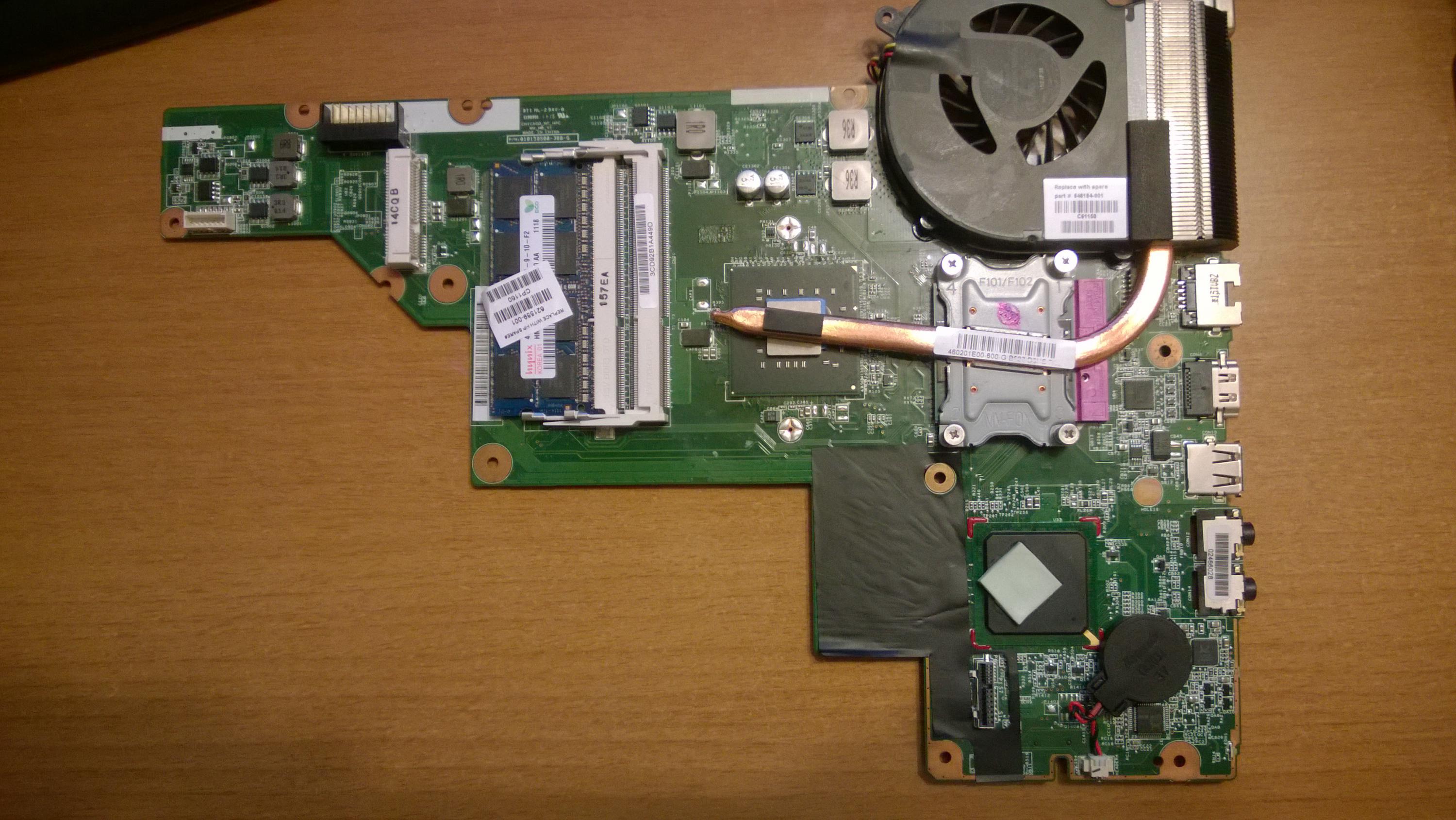

    hi, i got this laptop with no display.
    it has the chicago board core duo version with ddr3.
    i have changed the intel nortgbridge with integrated vga in it, and after put this new bga, pc boot telling me some cmos error found ( i forgot to connect the 3v battery for testing).
    i thought it was a cmos battery message error, so today i put almost all together and when i go for boot, it give me this message and then no more display come.
    i think it was some bios, but the only chip i can find is ui3 that is a winbond w25q16bv (16mbit chip).
    on the hp site there are 2x4mb and 1x 2mb inside the bios hp exe. tried with one 4mb version but no more Ec light.
    on other thread i found ec bios dump for the hp 630. flashed it to that ui3 and now light comes on, but if i press power botton pc start blinking and no display.
    where is located the bios chip ? really cant find it in that mainboard.
    is ui3 all in one ?
    any help would be great , as that notebook after rework started with these cmos error, but i was able to get display.

    yes! that`s it all in one!

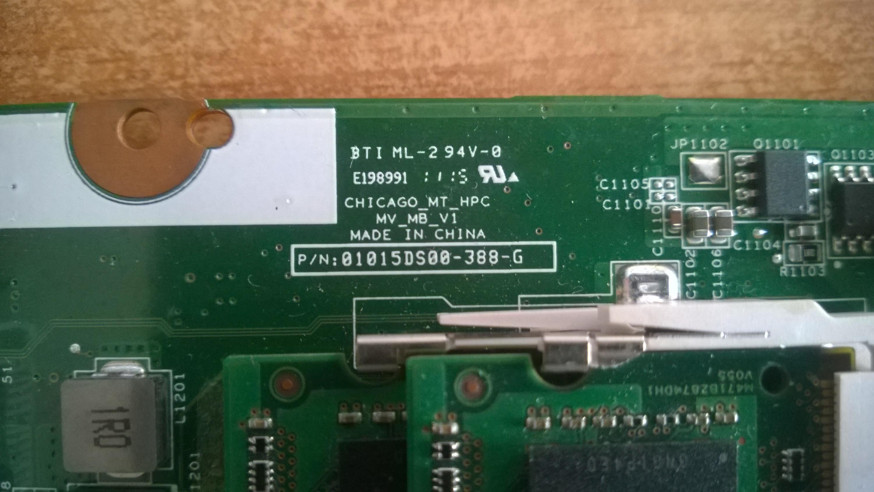

      would you be so kind to post motherboard code so that i can try to find correct bios
      also, always backup old bios, even if its not working :/

        tnx for reply. finally i found original bios in hp_tools hard disk partition, flashed it but i have the continuous blinking caps lock like chipset bga rework didnt go well.
        here is the board code.

          if you still have old dump of original bios load it to any hex editor and scroll at the end of file and you should see something like
          003FFF60 0C 3E 40 3E 84 3E C8 3E 0C 3F 00 00 00 00 00 00 >@>„>È> ?
          003FFF70 00 00 00 00 00 00 00 00 00 00 00 00 00 00 00 00
          003FFF80 80 00 00 19 00 00 00 00 00 00 00 00 00 00 00 00 €
          003FFF90 00 00 00 00 00 00 00 00 00 00 00 00 00 00 00 00
          003FFFA0 00 00 00 00 00 00 00 00 00 00 00 00 00 00 00 00
          003FFFB0 24 42 49 44 30 33 36 37 32 00 46 33 39 00 00 00 $BID03672 F39
          003FFFC0 00 00 00 00 00 00 00 00 00 00 00 00 00 00 00 00
          003FFFD0 BF 50 41 EB 1D 00 00 00 00 00 00 00 00 00 00 00 ¿PAë
          003FFFE0 00 00 00 00 00 00 00 00 C2 13 FA FF 00 00 00 00 Â úÿ
          003FFFF0 0F 09 E9 0B FA 00 00 00 00 00 00 00 00 10 FA FF é ú úÿ
          what you need is $BIDXXXXX that is board ID and afterwards is a version of bios
          i have prepared (decrypted and splitted) main bios and ec for all 3 versions of bios for 3 versions of matherboard put in this laptop
          hope it helps
          and you need to rebuild dmi data
          edit:
          by looking at your post again, you have w25q16bv (16mbit chip) = 2mb, so your board id should be BID03676 and eprom 2mb... flash that file first
          hope it works

            that was the bios inside my hard disk folder. 3676.

                    Looks like the NB is either bad or it hasn't soldered properly. I've stumbled upon that a couple times too. It runs after you rework it while the board is still warm, then after it cools down it no longer works. It's always BGA related.

                        today i put back the old reballed chipset and still the same... :|
                        continuous blinking caps lock. i think i have to check all voltage for chipset...

                          cant edit, but i cheked all chipset voltage and all were ok.
                          only thing i notice is that hdd doesnt spin when i power pc on. pc stay on but no hdd spinning.
                          plus there were 2 resistor down chipset tht moved a bit because of the thermocouple. put them back in place in the hope of a working laptop but still the same.
                          all voltage present at coils, but no hard disk spin and no post. only continuous blinking caps lock
