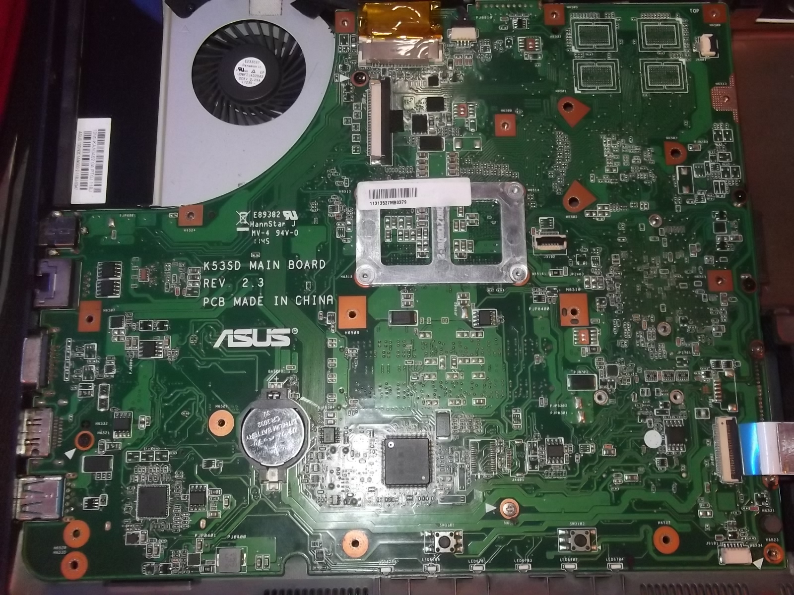

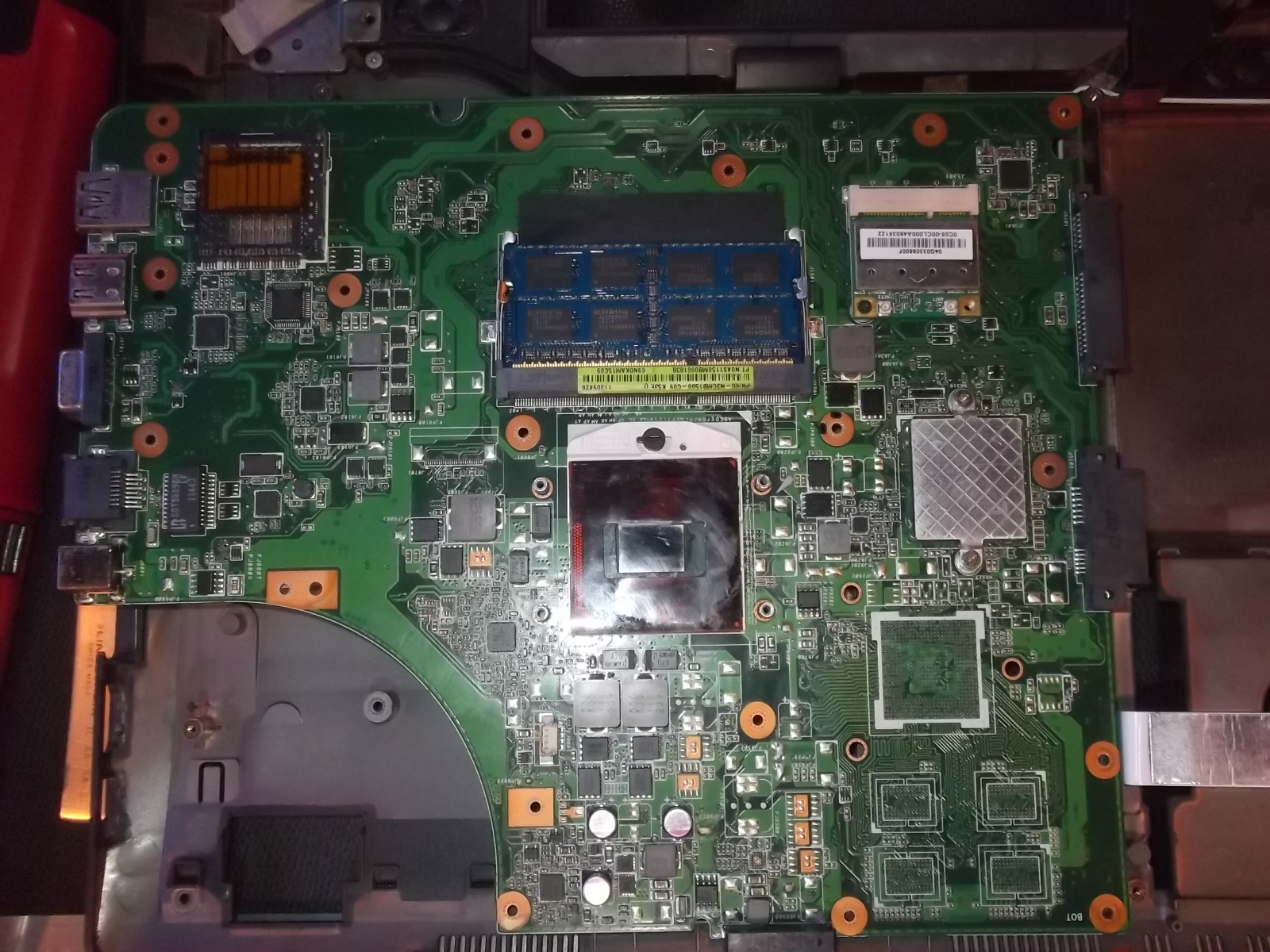

    hi guys, need your help....
    i got here asus x53e thats turn on for a couple of sec then off. sometimes its look like restarting over and over that you can notice the power on led on and off again and again. and good thing is its display for sometime for a munite then again off. its kind of weirdo... hope anybody could help.
    tnx
    heres what i did.
    i just clean mobo. replace thermal paste on cpu
    i did mild reflow on the gpu.

    look for voltages on all big coils.

      i got the 3.3 and 5v supply before it turn on.
      i can't get those voltage bcoz of it turn off quickly. but one time it takes a bit long stay on so i got those voltage it has 1.5v and 1.0 v some of them.

        u need to check all woltages on coils right after start. check for rising voltage. if no rising, than there must be short
        but i think u need to reflow od northbridge

          here i attached some picture. i did a reflow but it do the same. i been using it for 3days working fine but then it happen again this morning. its a bit crazy.

              reflow nb
                On the picture i still can see the wlan card still connected to the board, remove that and try to fire it up.
