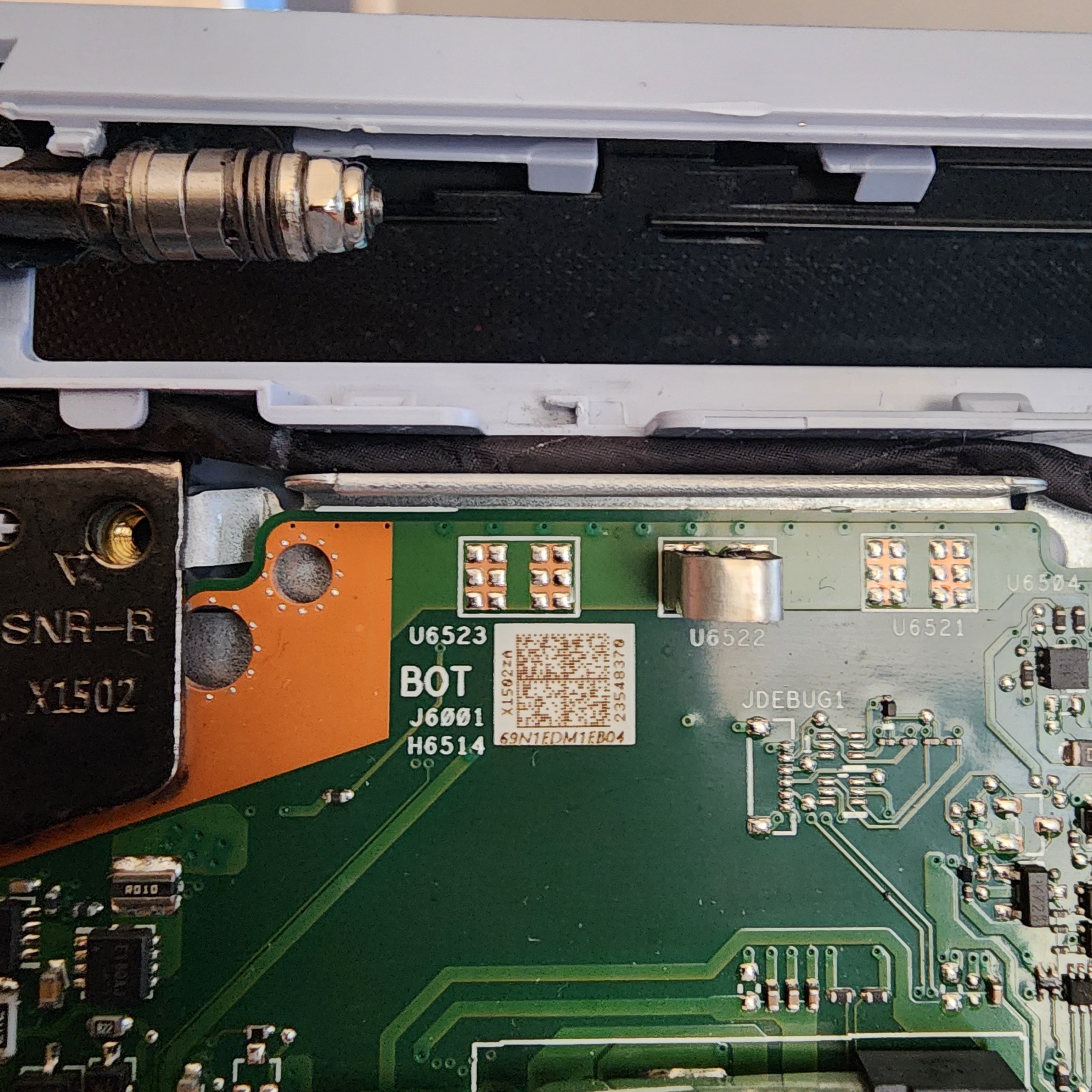

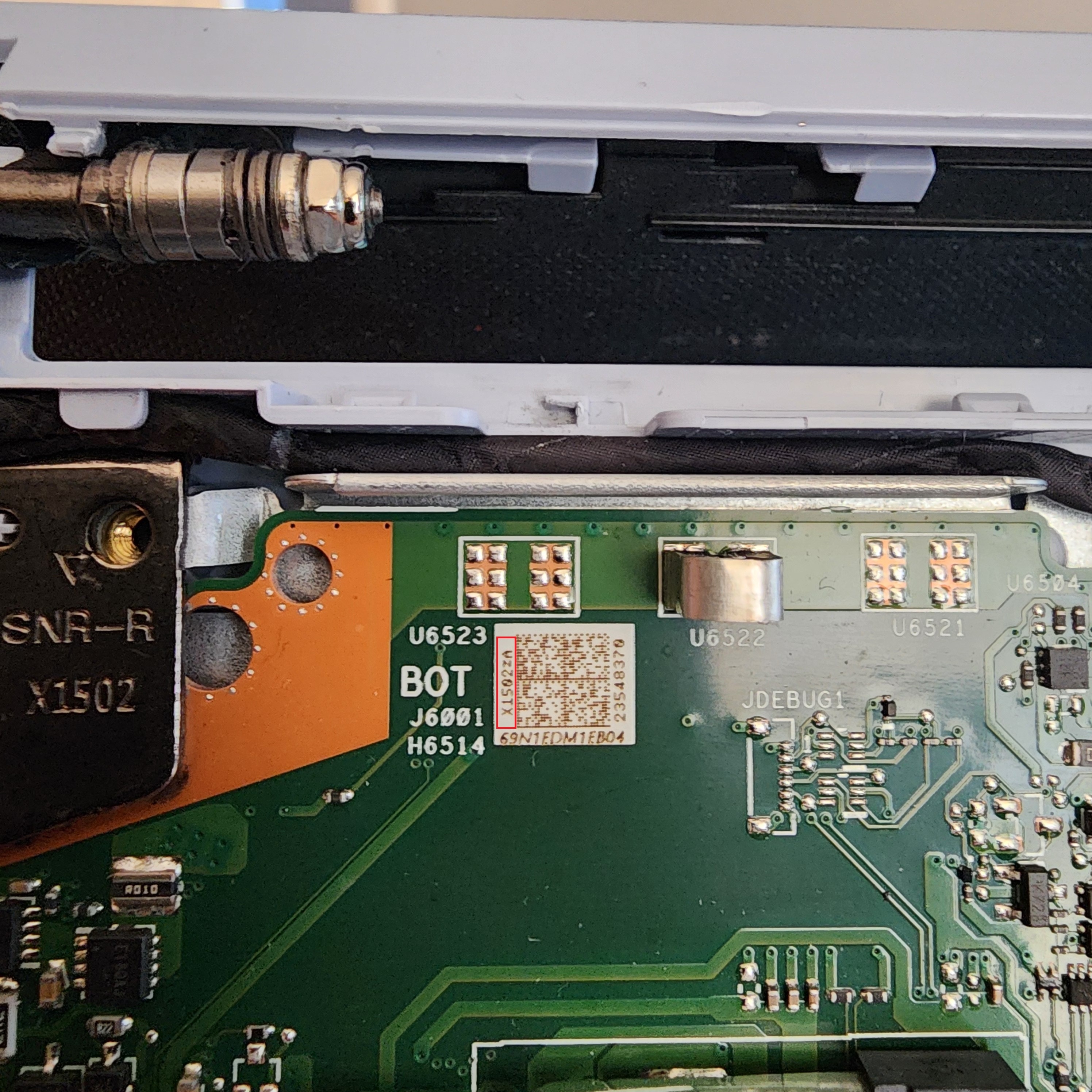

          Give me that bios or QR code image or ticker near ram slot so i can identify mianboar version
          • ZixuTech
            • Oct 2017
            • 90
            Only QR I have are these. Nothing on the other side of the board or under RAM
            Etched on the board - R416NBCV00EUDJMB,R416NBCV00EUDJMB,X1502ZA,60NB0VX0-MBH020,224,
            This one works well - I have flashed this BIOS for test purposes and it lights up the ASUS but blank SN. https://www.badcaps.net/forum/troubl...21#post3593121
            Does it need to show the SN of the device? Its out owf warranty anyway. Windows also says activcated with a digital license?

              I chose the right model
