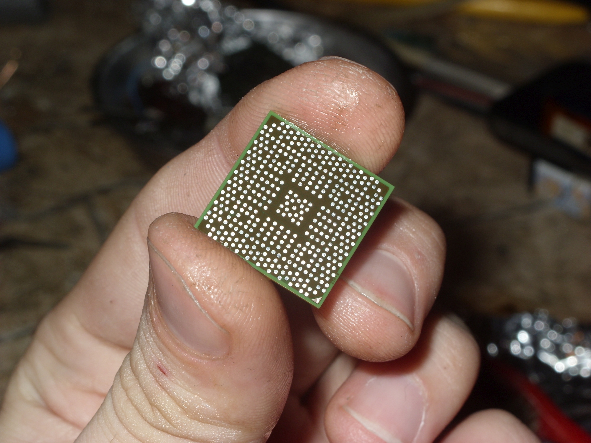

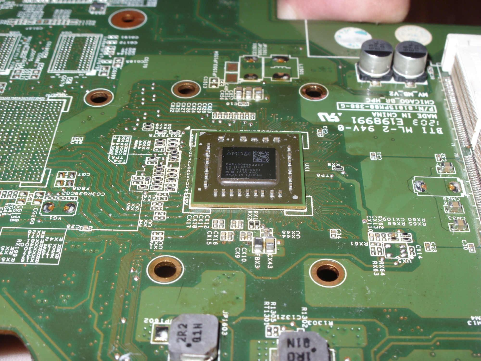

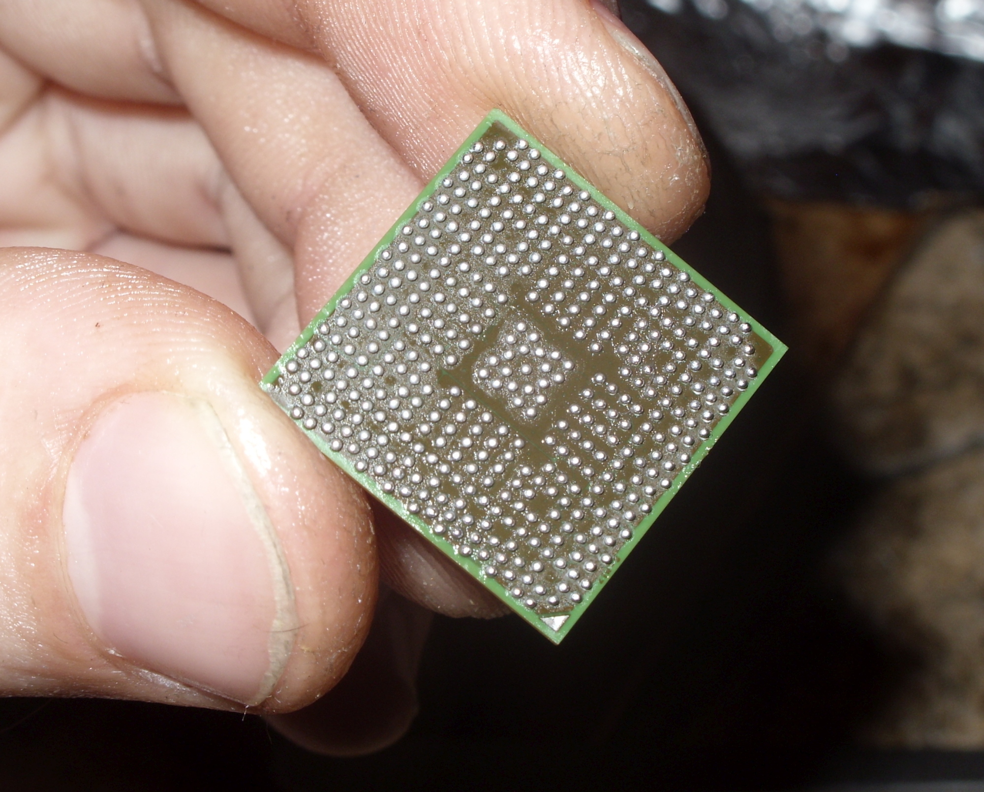

    Have this one in, and it already pissed me off to no avail. It's got a soldered-on APU, AMD E-450.

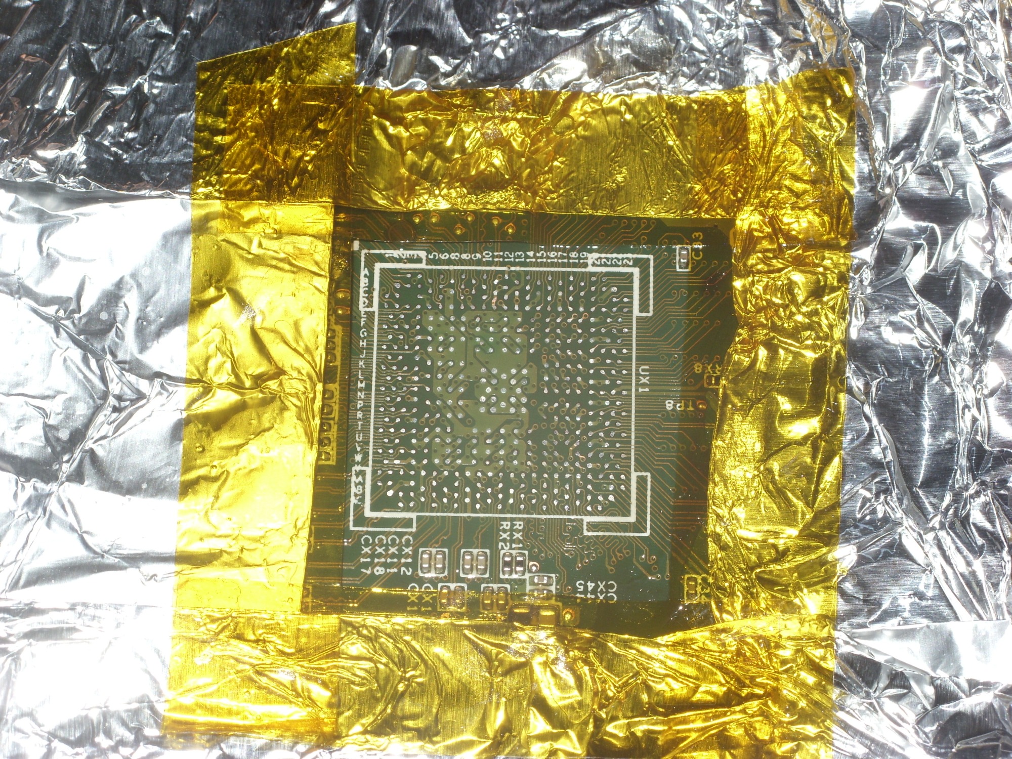

    When it came in it would just reboot by itself every 10-20 seconds. I reballed the APU - same behavior. I then reballed the only other chipset on the board - what AMD calls the "FCH". It worked and stayed on no problem.
    I assembled the notebook and stupor. It did not work anymore, caps lock blinked 1 time, then long pause, then blinked again, which 1 blink is "CPU error" according to HP, but it's never caused by the CPU in my experience. Got it to power on once more, then it just did this 1 blink and that's it, that's all it does now.
    Took the board apart again and reflowed both chipsets one more time. Absolutely no change. This is ridiculous...
    Board is "chicago_br_hpc mv_mb_v2". I could not find a schematic for it, if you have one, please share. Also a BIOS dump would be nice, as i only found it on a Chinese website.

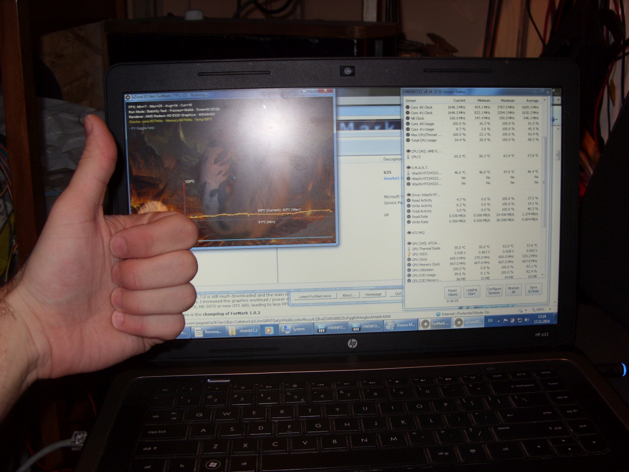

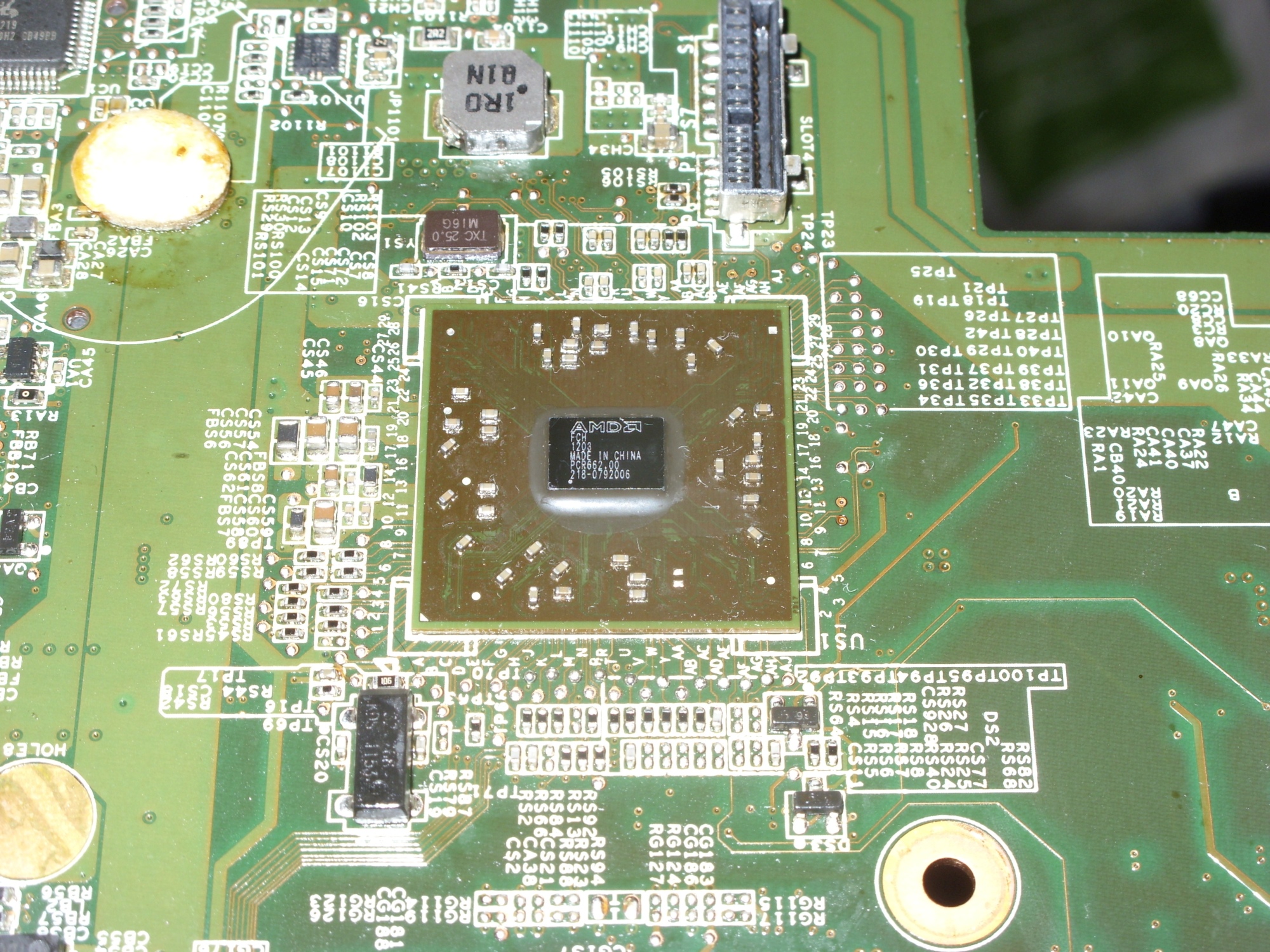

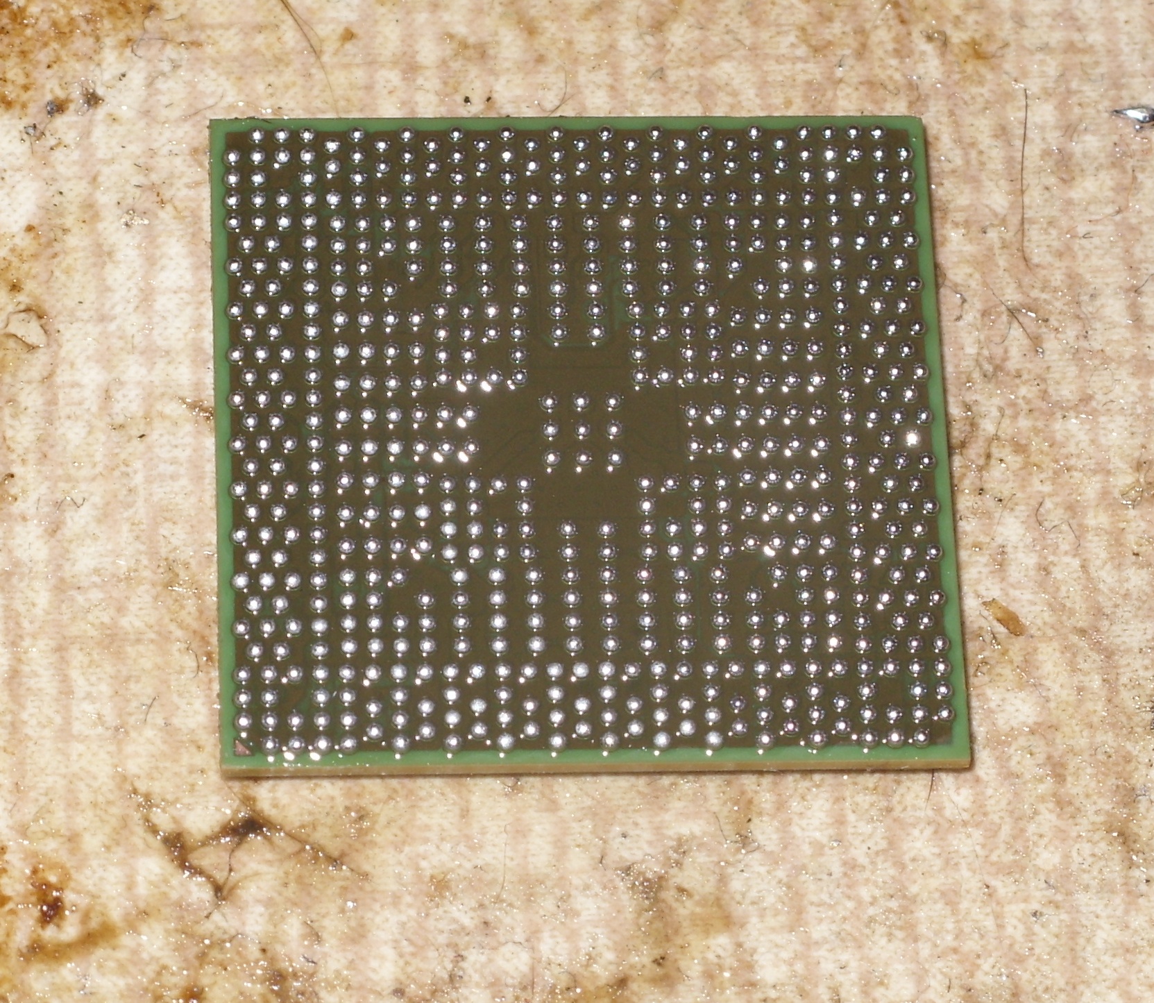

            The FCH chipset was out of stock locally, but i managed to source an identical board with liquid damage (coffee) for $14. Actually, i got the whole bottom case, palmrest in good shape, heatsink and fan, keyboard with 1 missing key, speakers, and battery along with it! No repairs had been attempted on this board however i found many shorts, so i did not try repairing it. I lifted the FCH chipset off this board, reballed it and soldered it on the first board (the one with 1 blink and no display).
            She's up and running now. The FCH replacement fixed it.
            I'm installing Windows on it atm, will be back with pics.

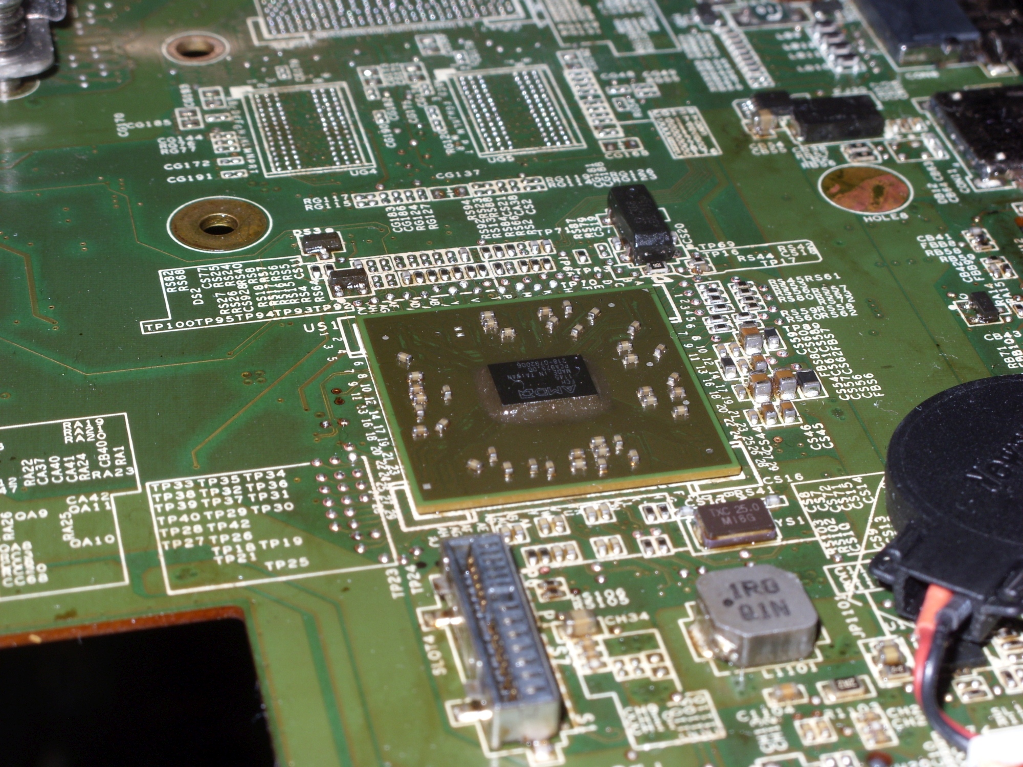

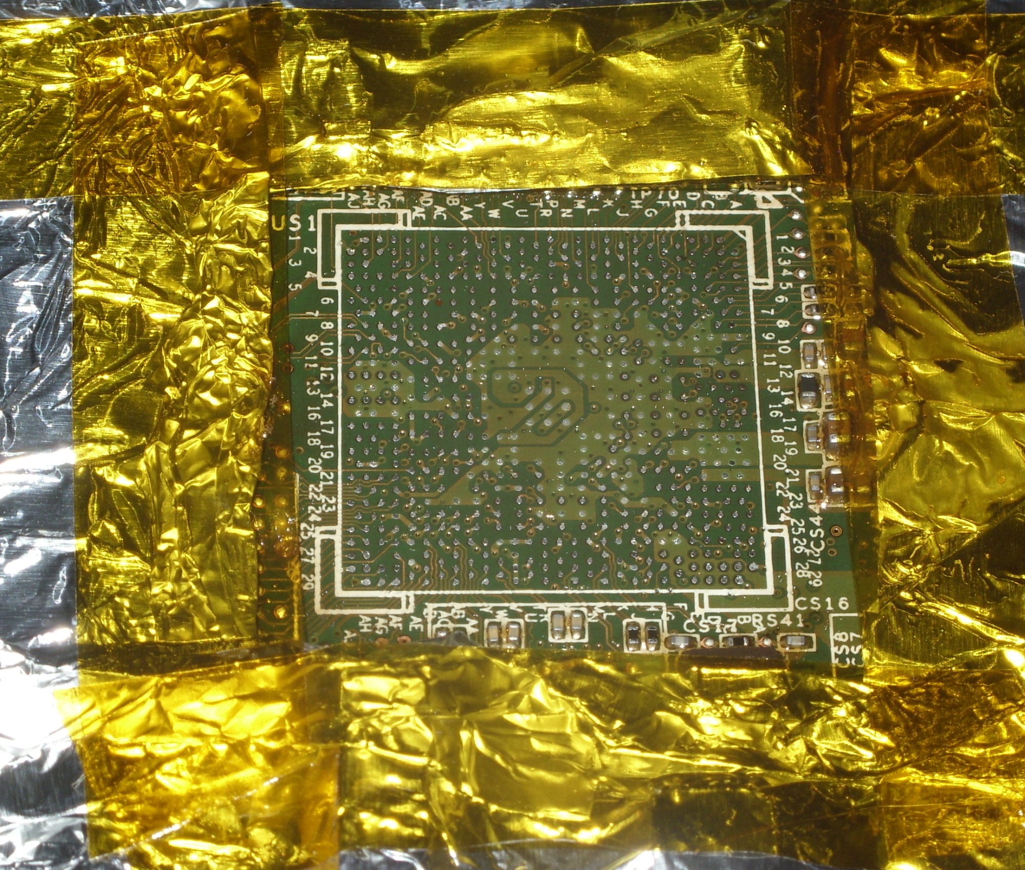

                  Pics or it didn't happen. The first pic with the FCH chipset is after reballing the original one, i couldn't be bothered to fill up the space with those pics too - since it didn't work. Notice the before-last pic, look closely and you will see a different datecode on the FCH, it's the one i pulled from this other board that i bought. And hey, what do you know, it works.

                      Thank you. Now that i look closely at that pic i pointed out above - that's nicely roasted coffee all around the FCH die. Yeah that coffee spill on the donor board was pretty serious. Couldn't be arsed cleaning it all off - the contact side is all that matters.
