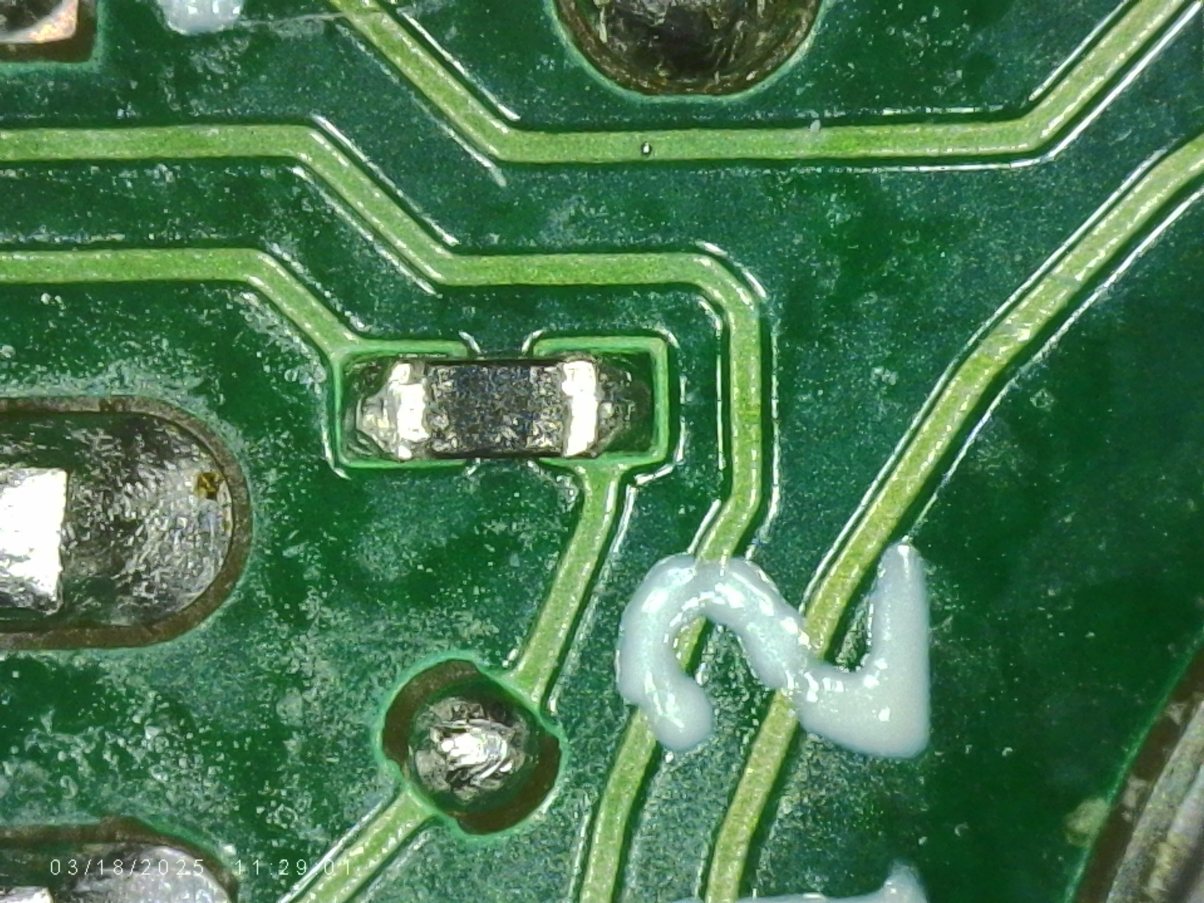

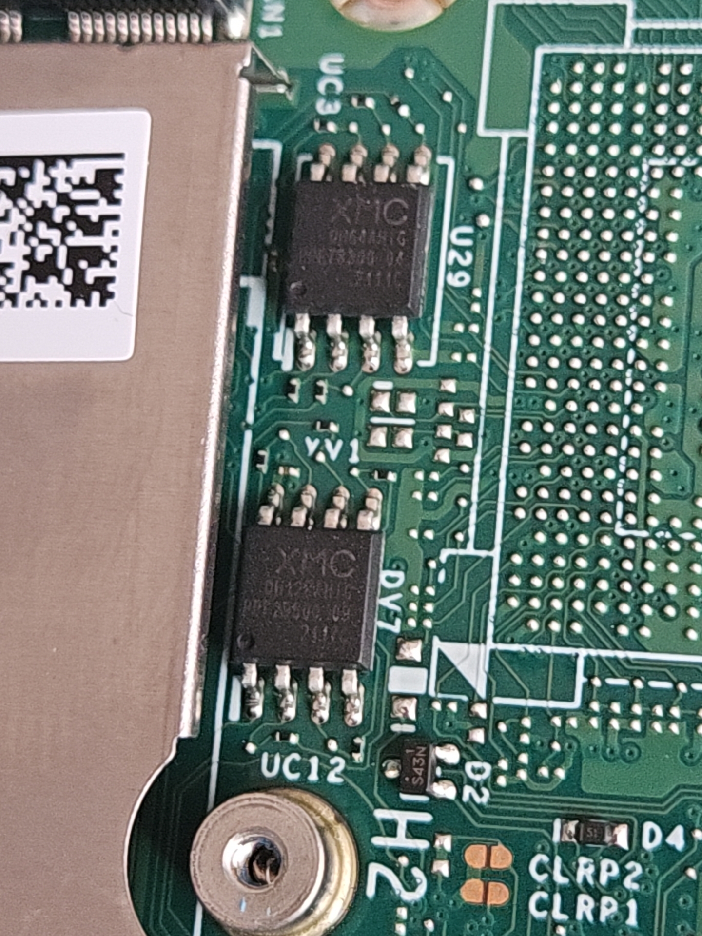

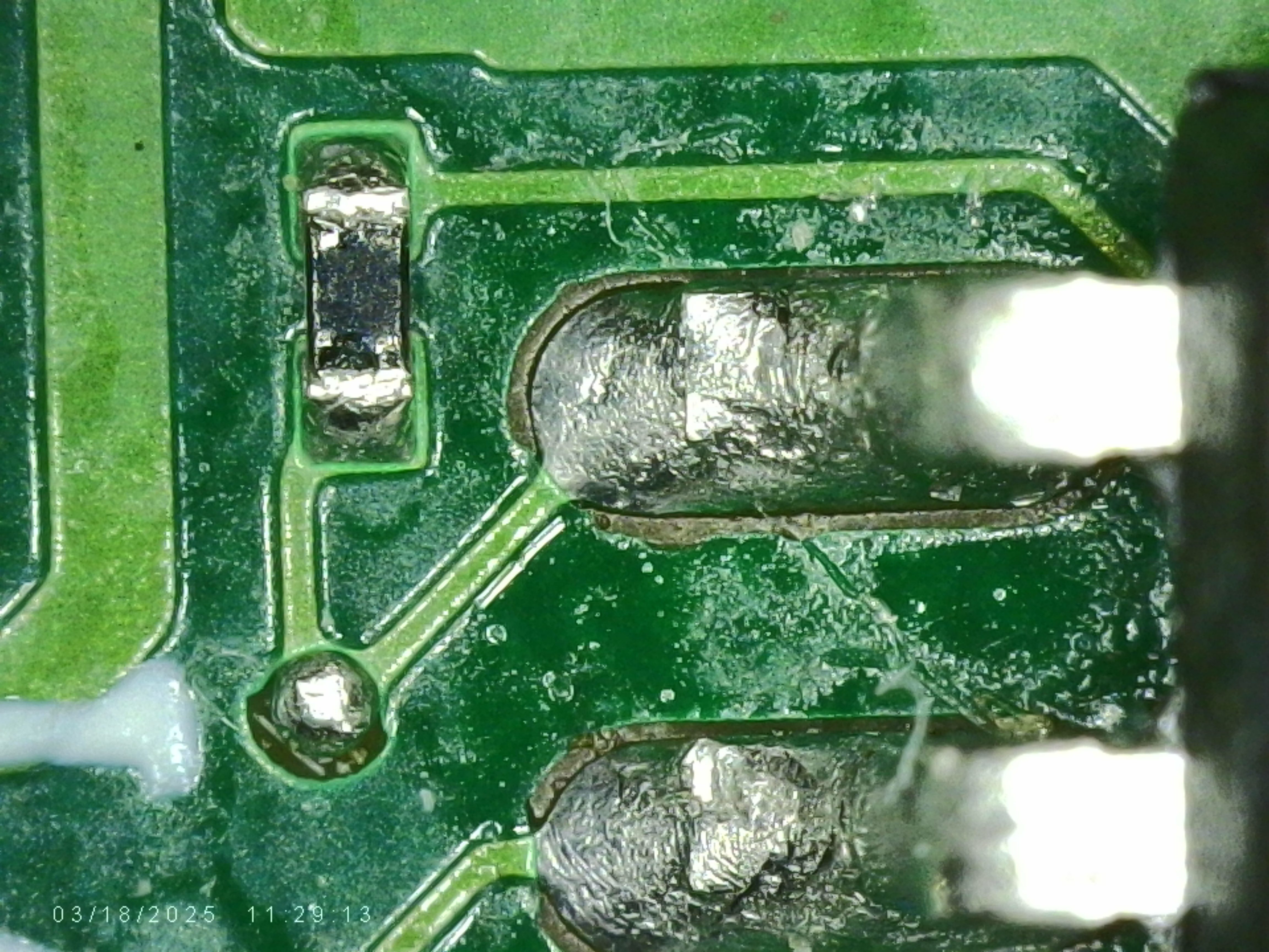

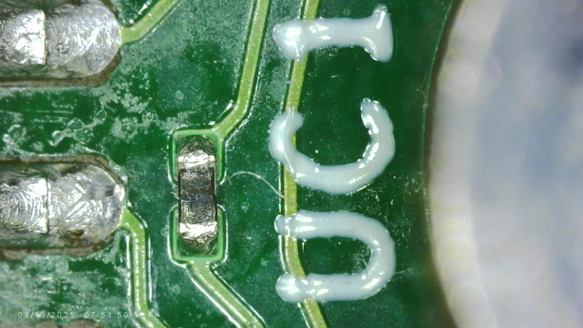

    Post a clear pic of the area of this rework. Suspecting that you are missing a connection of SMD resistor nearby.

      Don't have microphone sorry this is best I have.

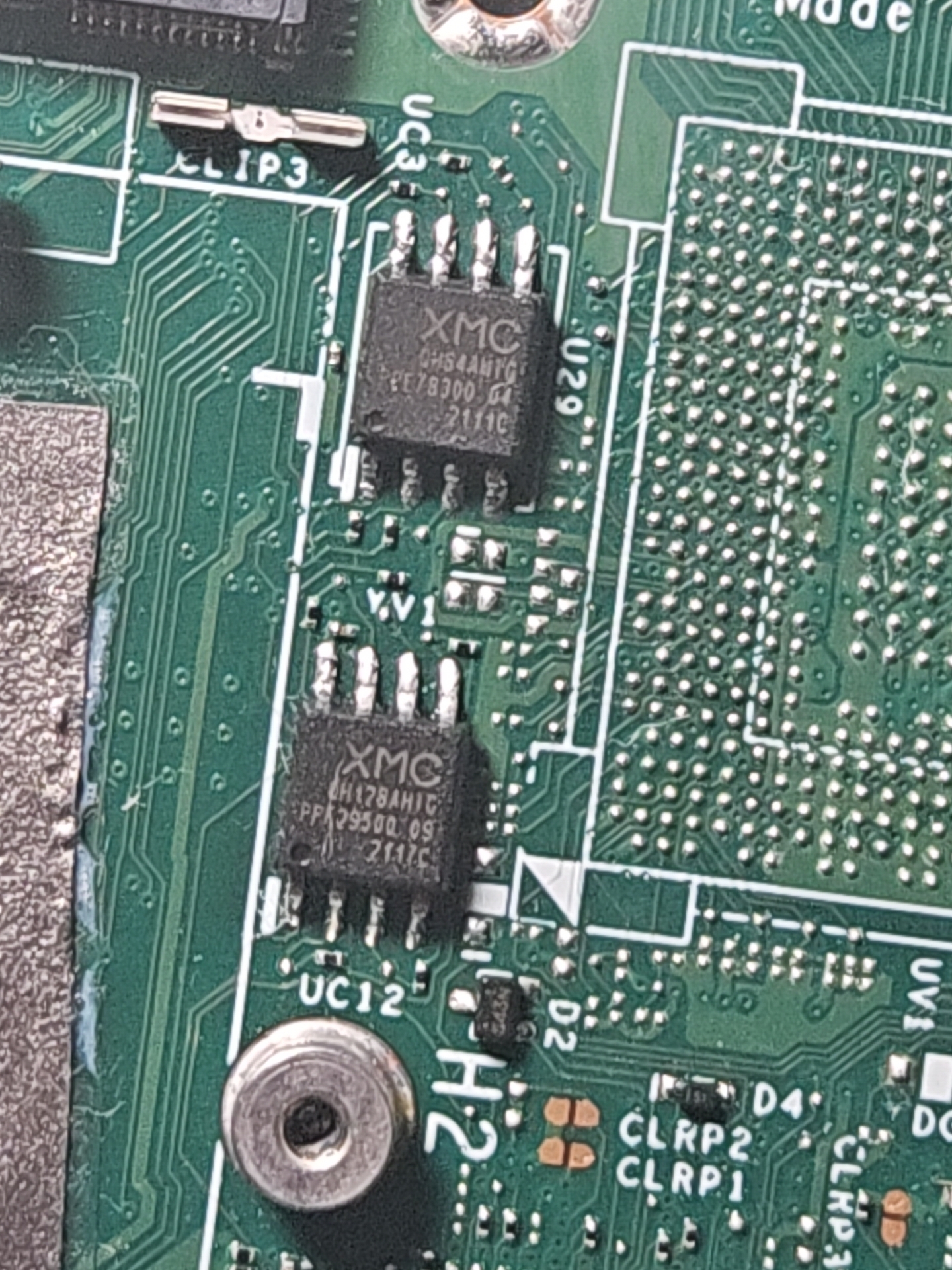

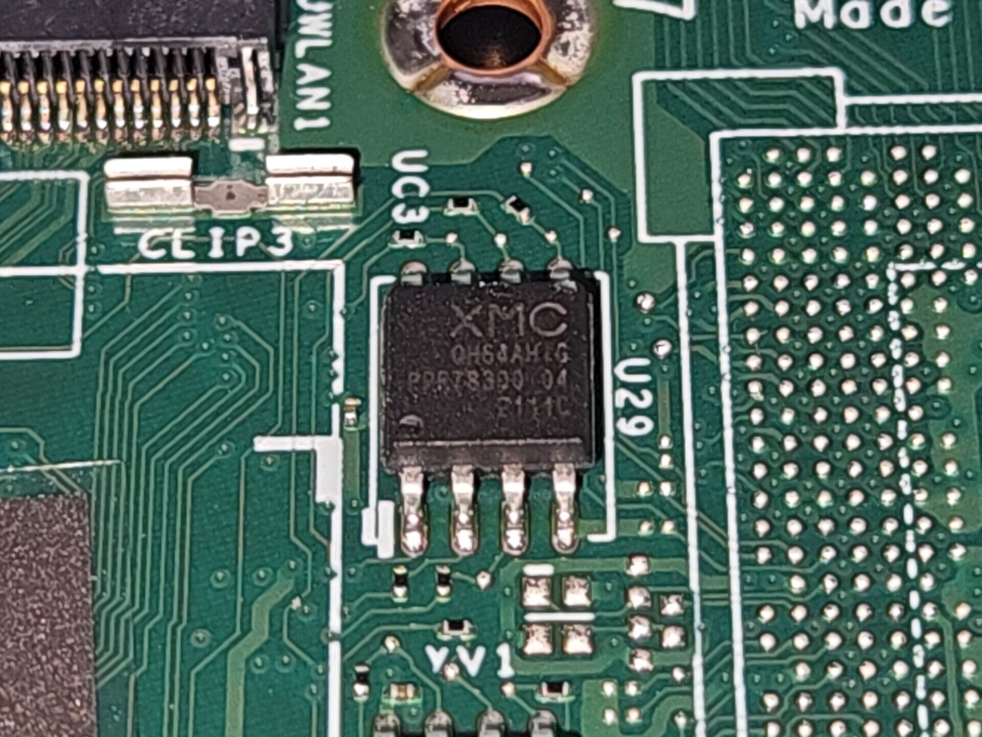

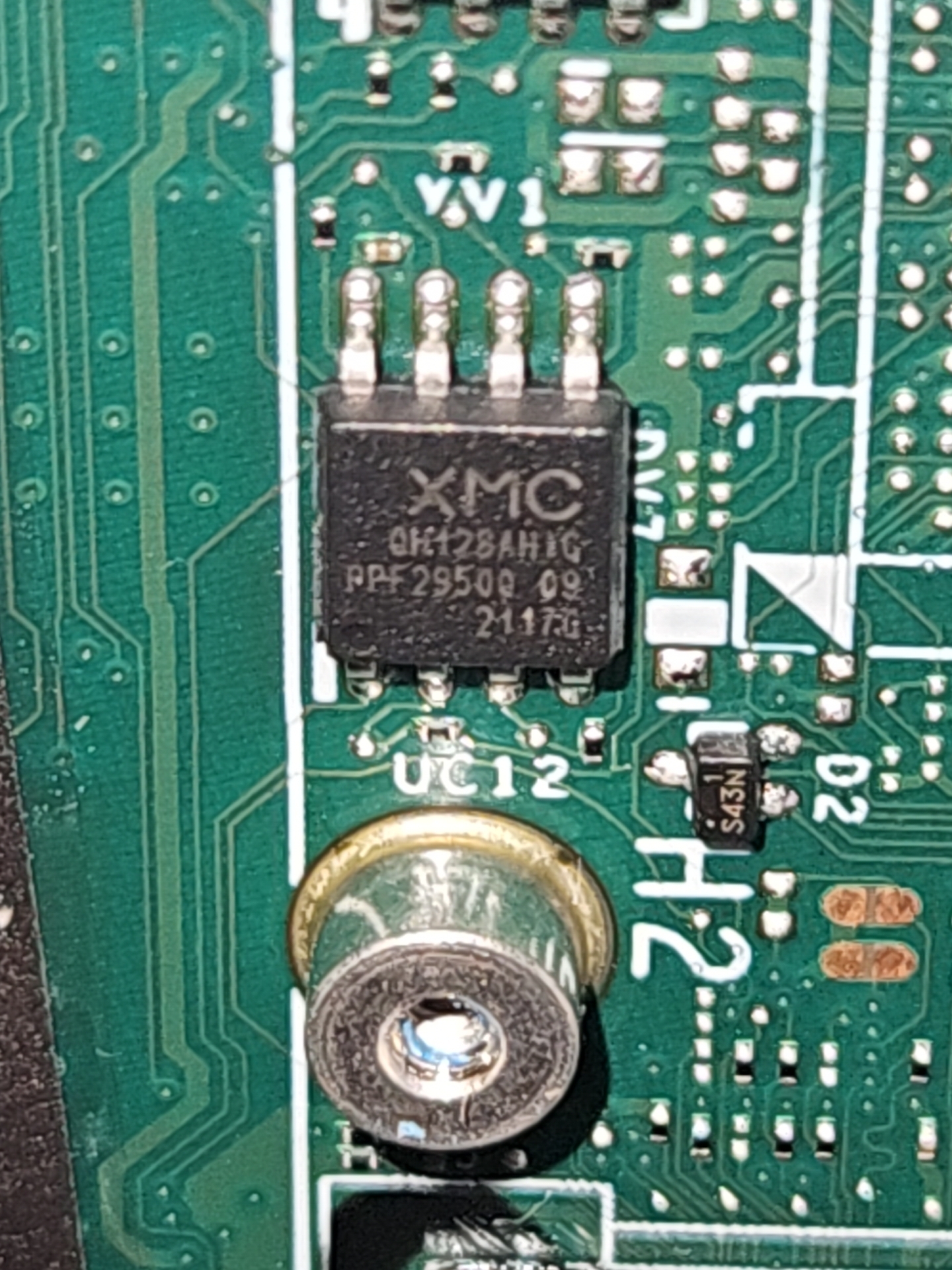

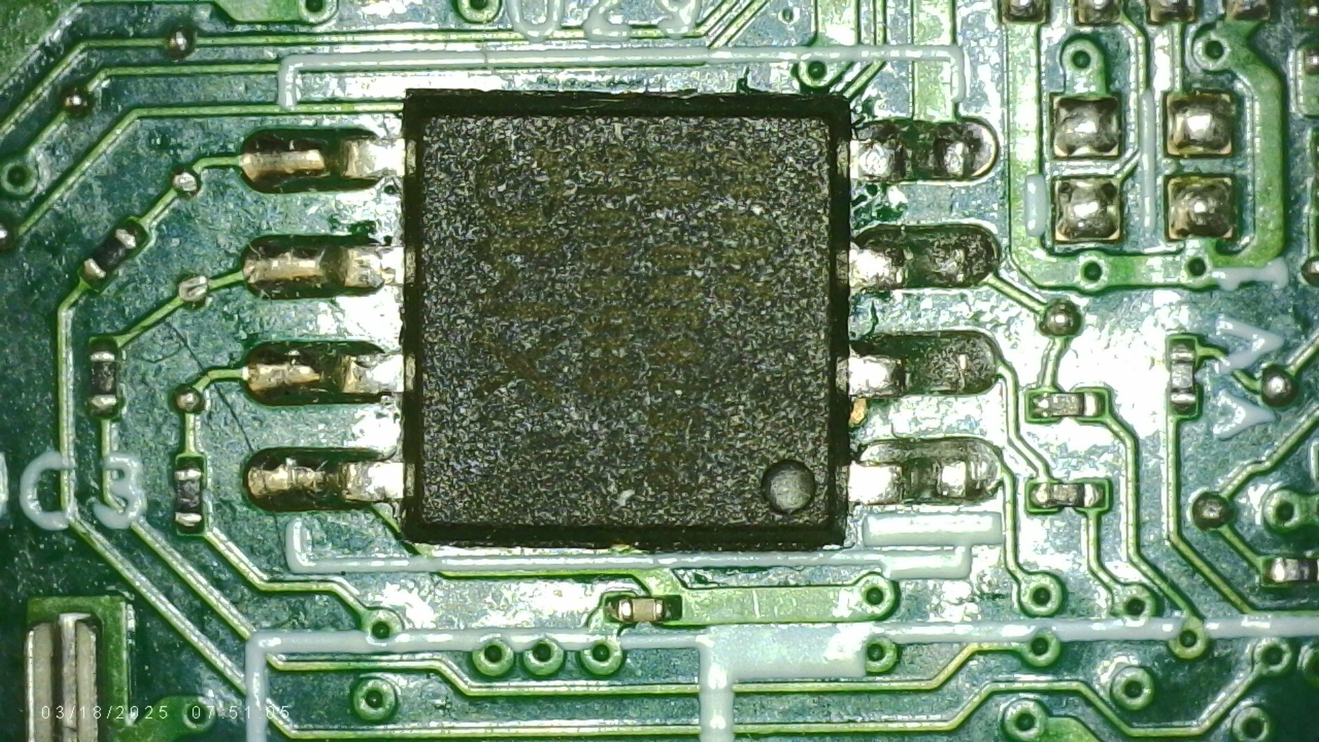

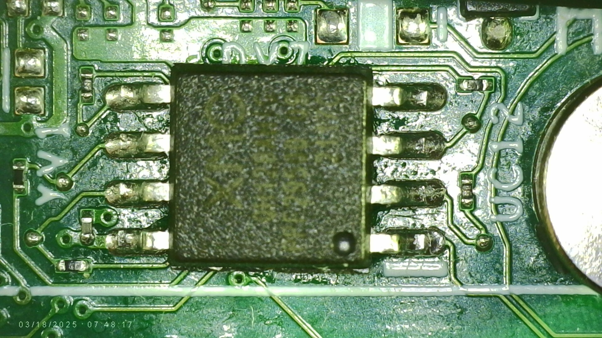

        Those are the images of this are before any soldering was done.

          When soldering with hot air, please note the following: when desoldering, the chip has a good thermally conductive connection to the mainboard. Chip and mainboard have almost the same temperature. You can easily recognize the melting point by the fact that the chip can be lifted off. There is only a small risk of damaging the chip.
          When soldering, on the other hand, the chip initially has no thermally conductive connection to the mainboard and the hot air primarily heats the chip and only secondarily the mainboard. When the mainboard has reached the melting temperature, the chip has a significantly higher temperature and the risk of damaging it is greater. It is therefore also advisable to use a bottom heat when soldering.

              Check that, unfortunately it looks ok... I have picture form before and after - the both looks the same.
              It looks like I've accidentally damaged something else on the board 😥
              When I connect charger the IC is getting hot (checked with thermal camera) not sure if anything else can be done.
              Maybe too much heat/time when soldering? Also you have to let the chip cool down before applying power
              For those chips I prefer to add leaded 63/37 solder to the pins when desoldering with hot air, and solder with the soldering iron

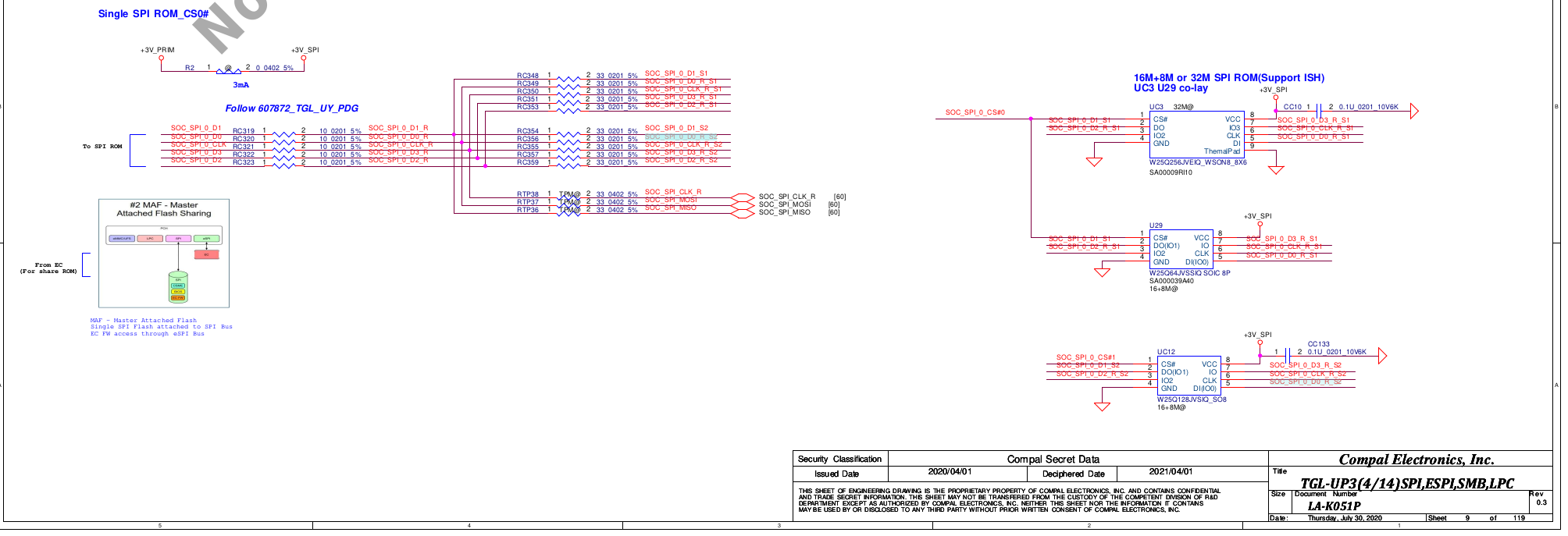

              You can use W25Q64JV and W25Q128JV as replacements, those are listed on the LA-K051P schematics
              https://www.badcaps.net/forum/troubl...view-schematic

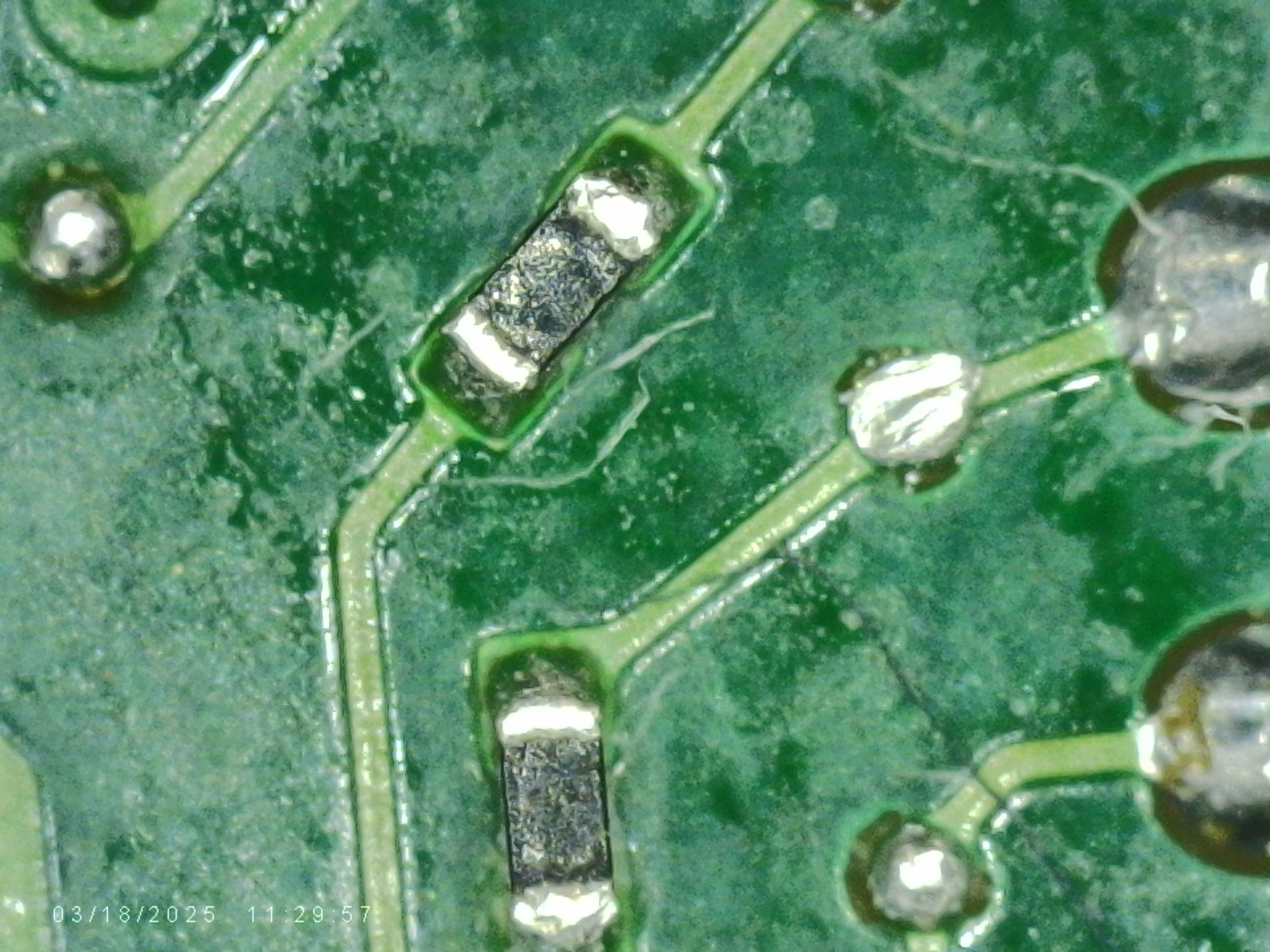

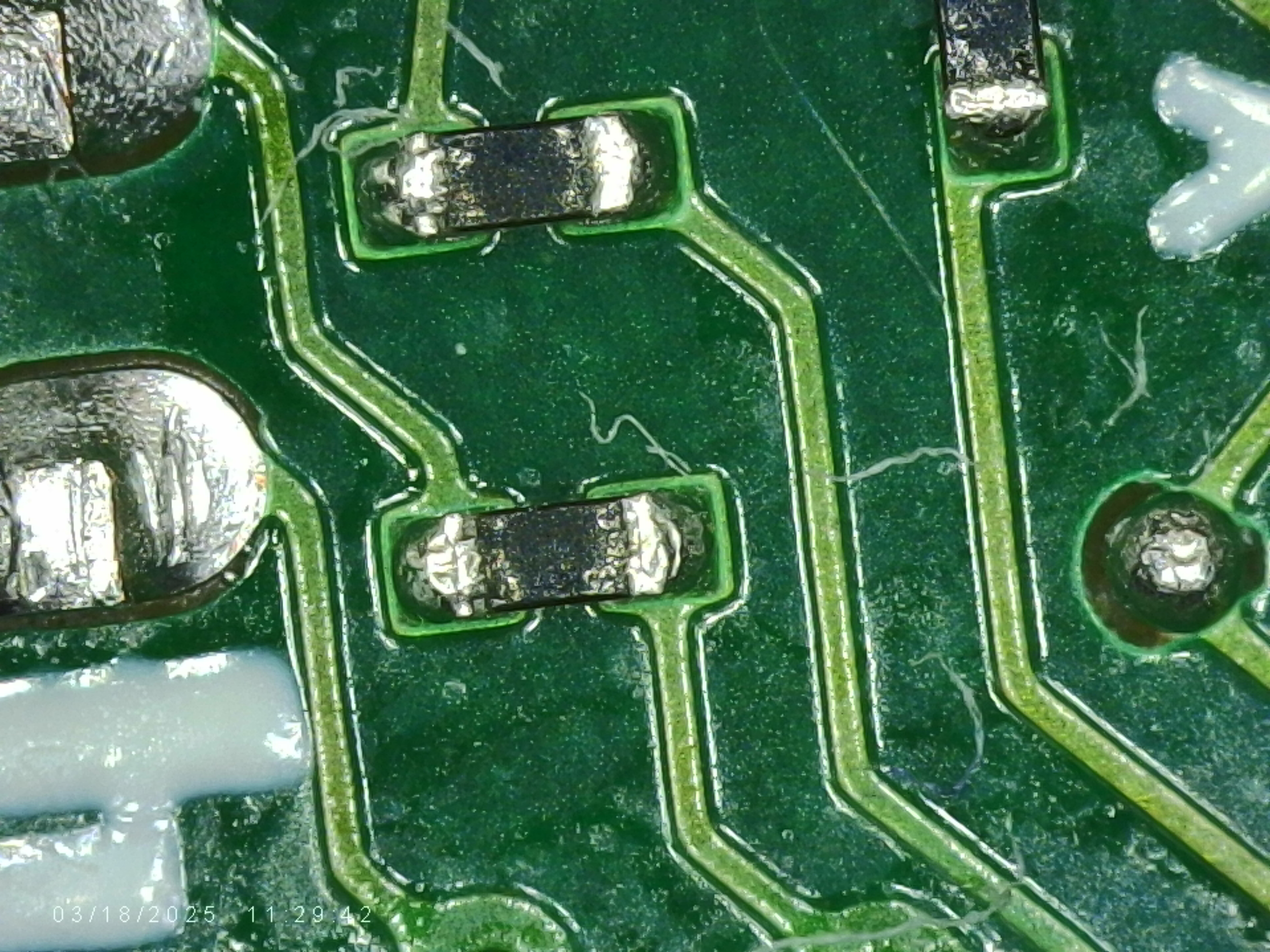

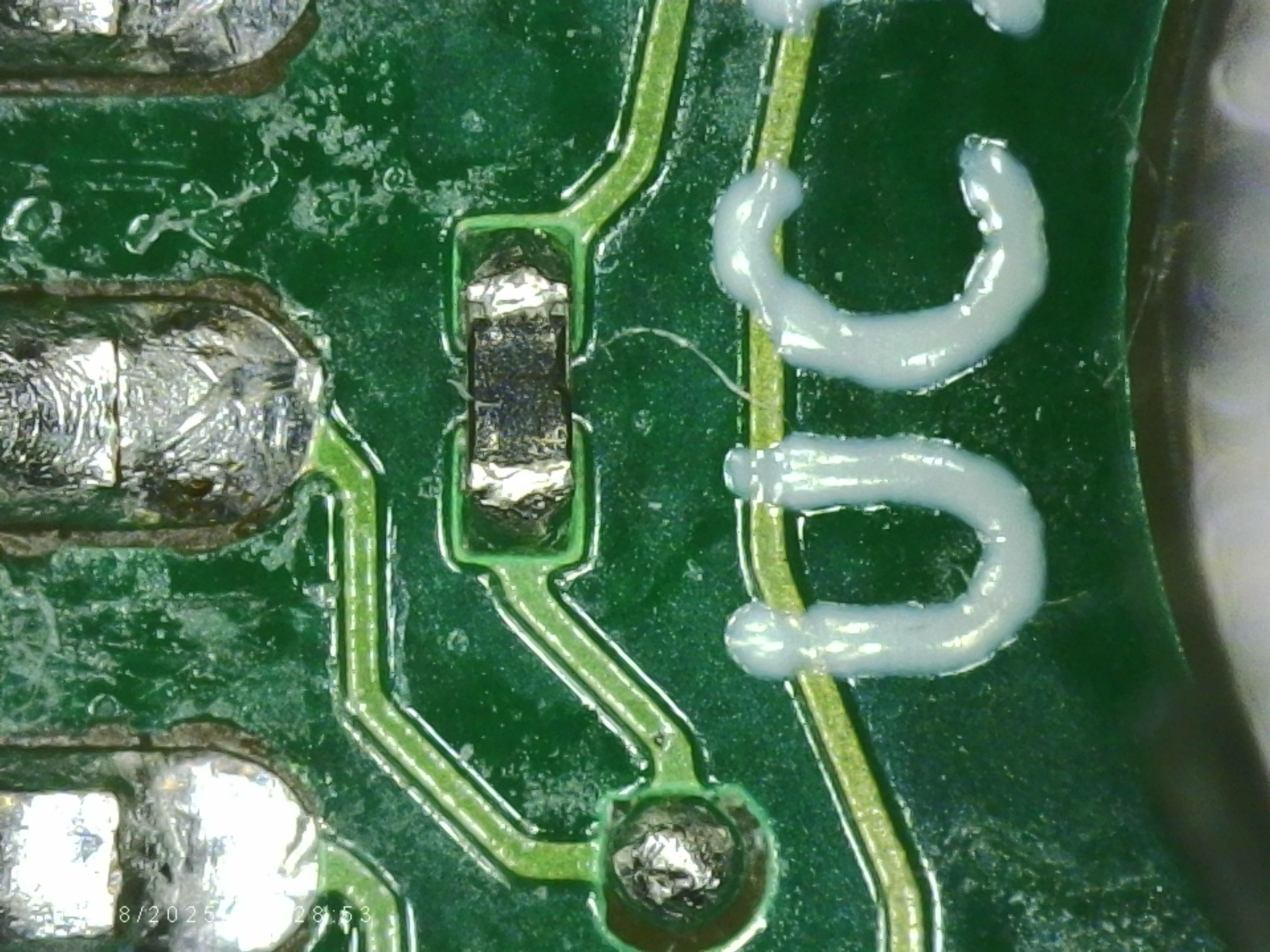

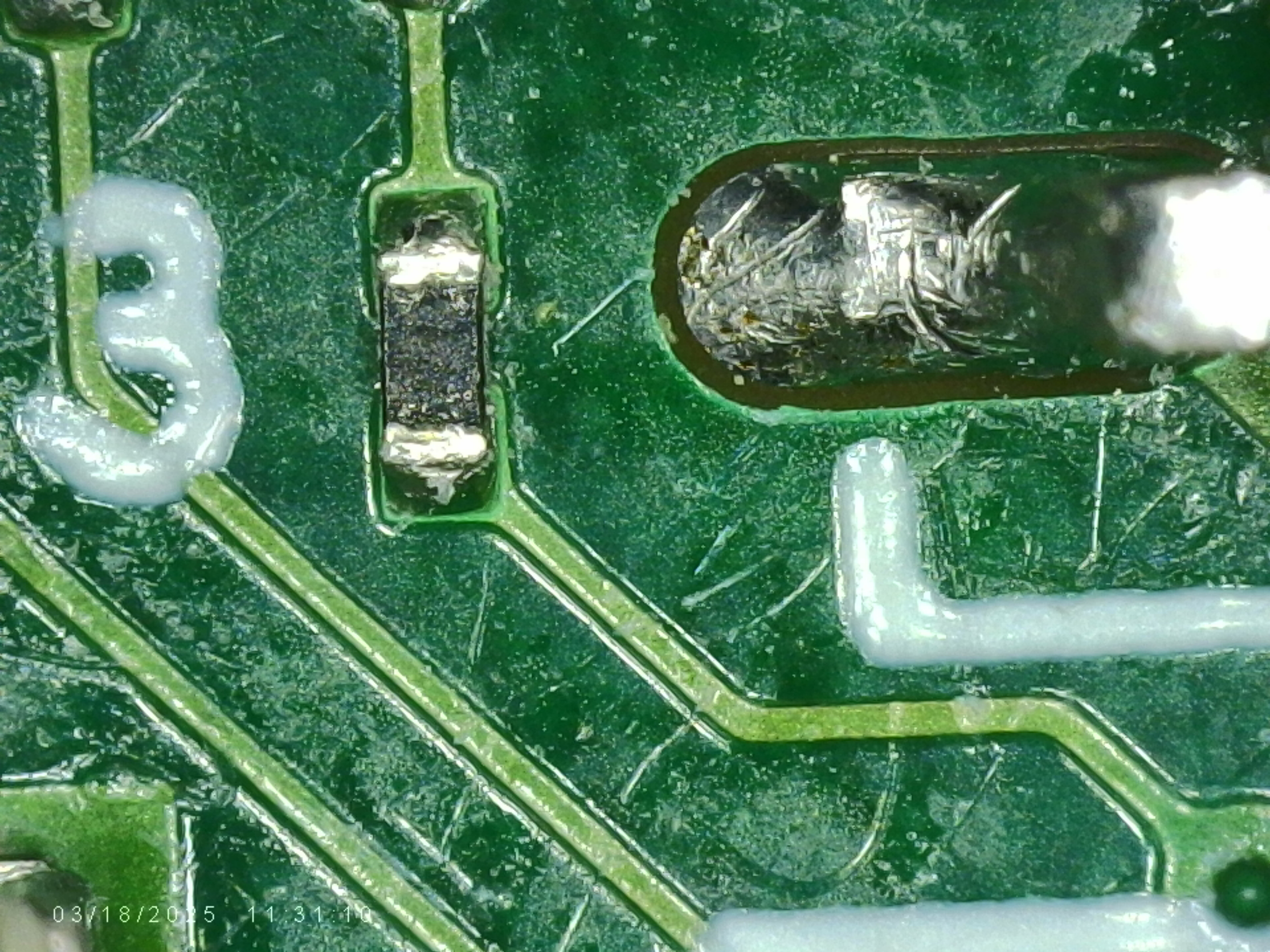

                  I have few better quality pictures, the component around doesn't look misplaced BUT they look like they might of seen better days (probably burnt) a specially the one by DO (pin 2) by one of the bios near "UC12" painted on the board, it almost look like its cracked in the middle.
                  How do I check if this can be a fault and If this is faulty how would I find what this should be replaced with?
                  Thank you in advance.

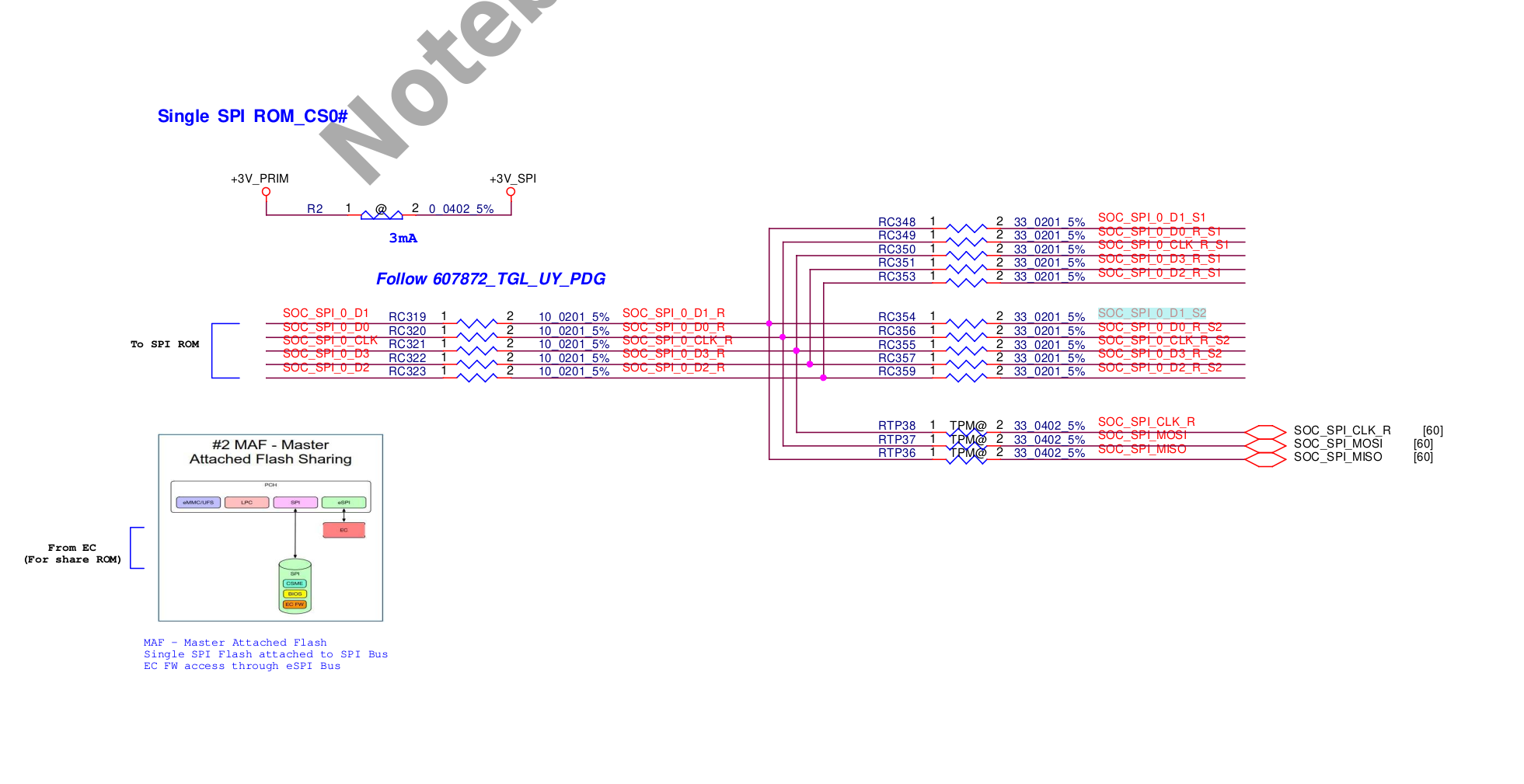

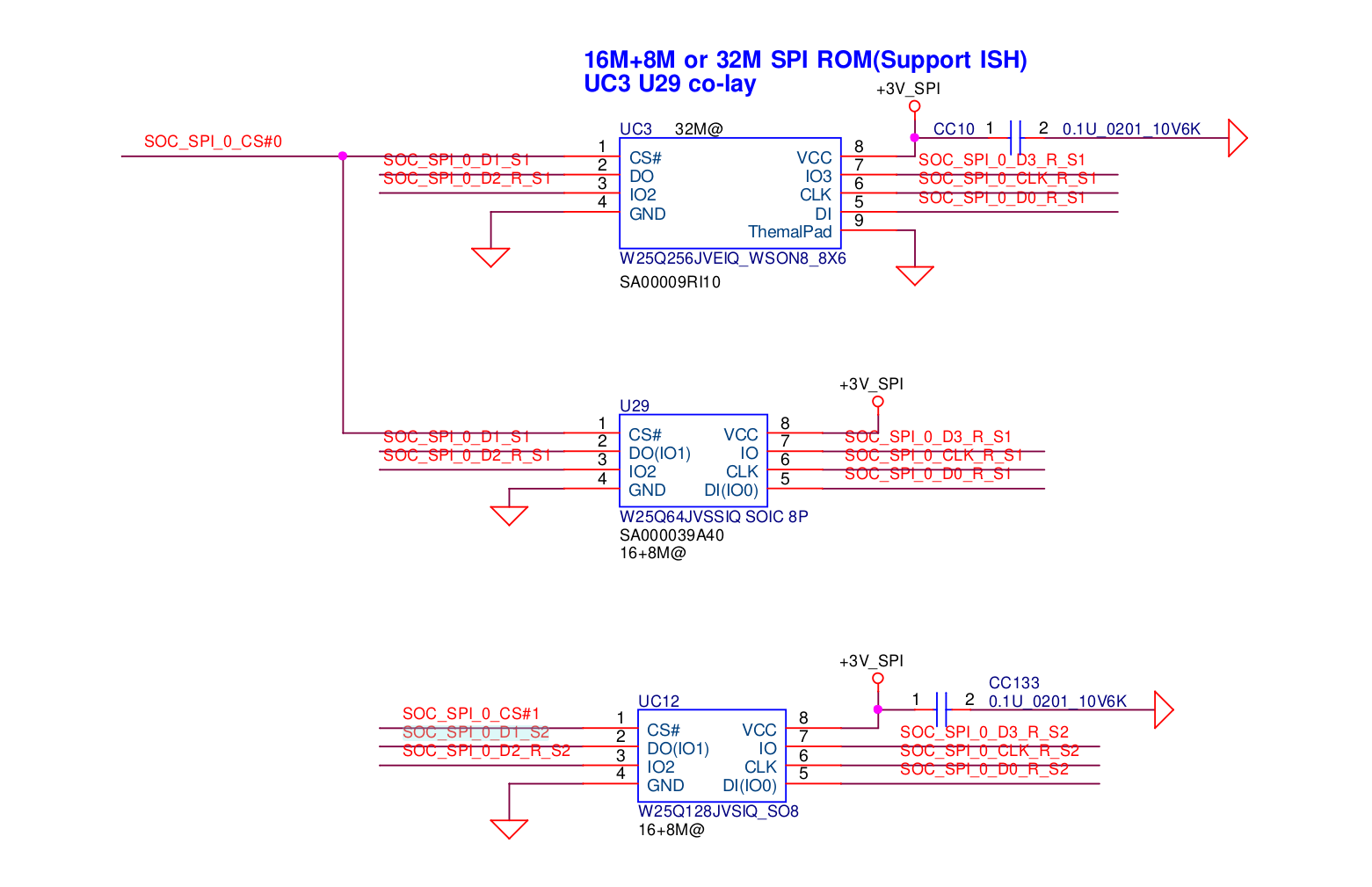

                    I've managed to get schematics for this motherboard and now I'll know what to replace those with if needed.
                    2x Bios schematics attached.

                      Measure those resistors, should be close to the values listed in the schematics (linked above)

                        Tested and sadly they all have values as expected... Iast chance is to program new bios chips when finally arrives and see if that will fix the problem....

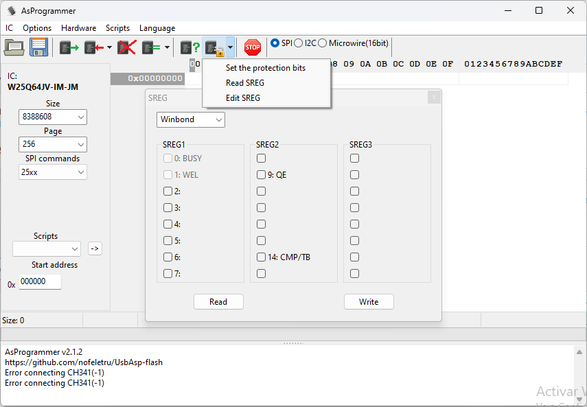

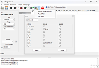

                                Try a clean BIOS, here: https://www.badcaps.net/forum/troubl...87#post3725787
                                Make sure you enable QE bit (bit 9 on Winbond, check datashet for other brand) when programming new chips, on AsProgrammer software click the arrow next to the chip with padlock button, Edit SREG
                                On that window press Read, check QE if unchecked, write
Name:	Captura de pantalla 2025-09-15 161655.png

                                  Thank you, I was actually using Linux and IMSProg software for reading and writing roms. I'll give window and asProgrammer with that option you mentioned above.
                                  I'll let you know but I'm loosing my hopes 😞

                                    Last update here on this. After flashing clean BIOS on new chips with suggested setting in AsProgrammer but laptop still dead.
                                    Thank you everyone for all help and support a specially m1ch43lzm !
                                    Lesson learnt.
