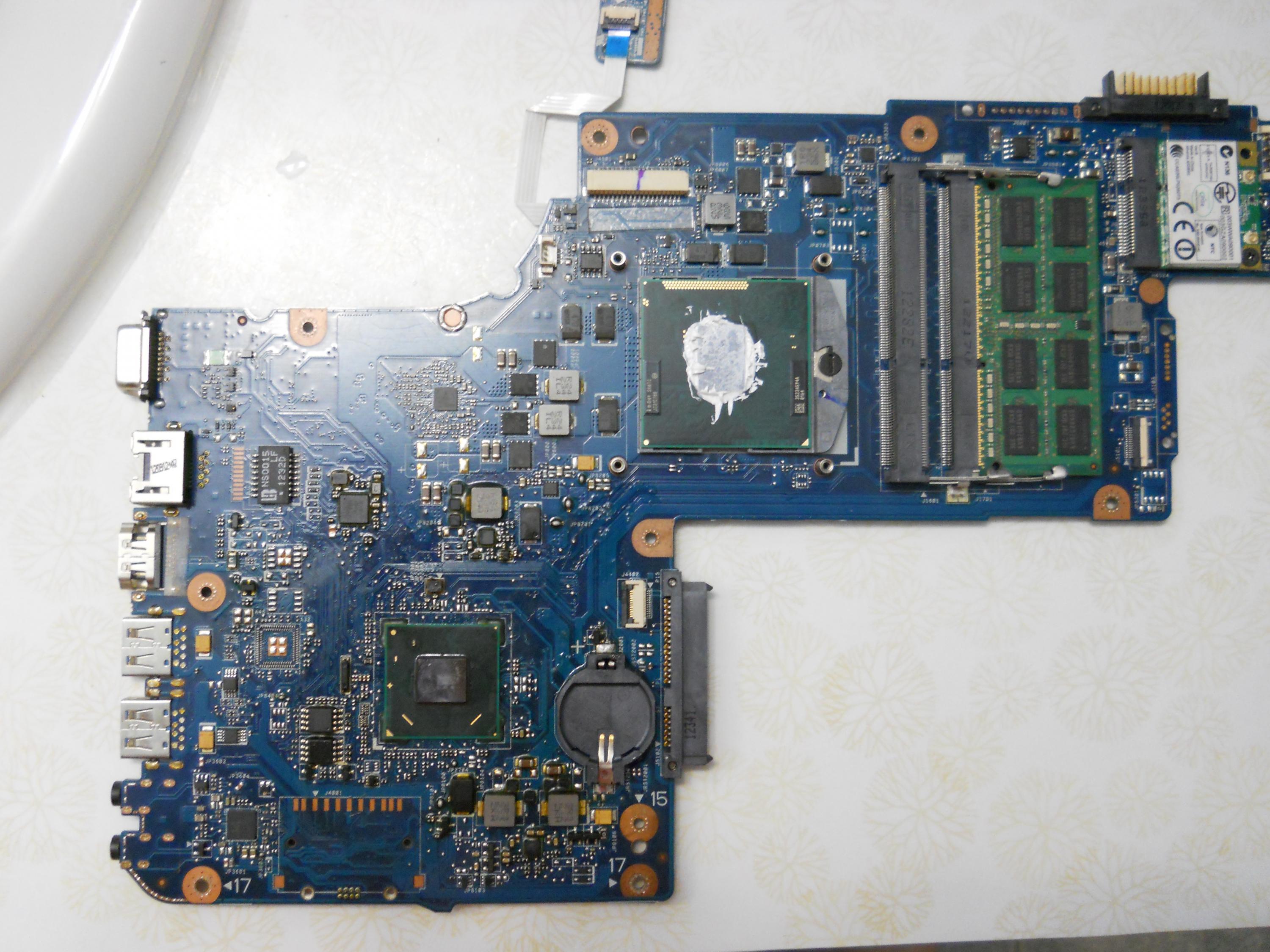

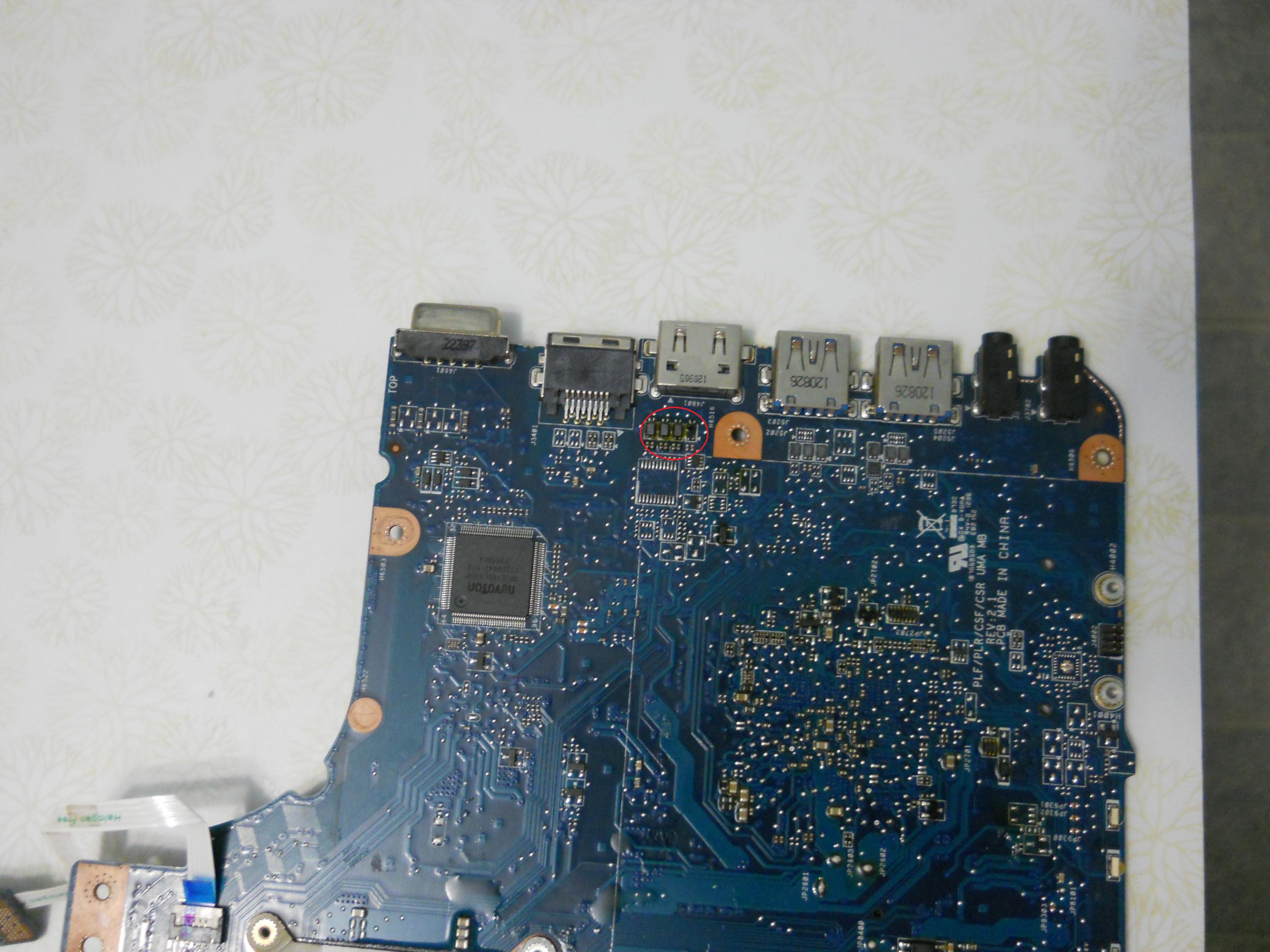

    Hello, I am currently fixing a laptop that was bashed against a wall repeatedly. I fairly sure I have the laptop working now, but I noticed it was missing a component.
    The missing component is is near the HDMI port. There are 3 still there. I have yet to actually test the HDMI port. Anyone know what this is or how I can find a replacement?
    I have a fairly good junk pile I can salvage from.
    Thank you
    Laptop info;
    Toshiba Satellite L870
    Model: PSKFLC-00N007
    Pictures are on google drive, main one ends in -c
    https://drive.google.com/folderview?...Vk&usp=sharing
  • doread
    • Jan 2014
    • 6
    • US
    Re: Missing Component
    Update;
    HDMI port did not work. I pulled a component from another older toshiba laptop and it is working now. (same place, in front of HDMI port)
    My best guess is that it is a SMD Inductor since I can see copper wire. The component I replaced it with does look a little different.
    Should it be OK? I am giving it to a relative, so I can service it later down the road if something happens.
    Thank you!

        well inductures are read on Henrys , and usually its good to use the correct values , but if you can order the right part , order it , if don't well warn your client about risks and leave him choose the option

          Sorry, I can't seem to post attachments. What are the risks of using the wrong values?
          edit; managed to get 2 attachments uploaded.
          I will put the laptop together and stress test it today. See if it keeps working after hours of HDMI use. I will also use my spare TV to be safe.

            yes indeed make some test , dont forget that inductor , induce corrent . so chek also if the component itself get to much hot . and stress well the port .

              I tested the port and no issues, it worked great for hours. My new issue is that the second/top ram slot doesn't seem to work.
              I thought it was working before I started the work. I will take it apart again later and see if there is anything obvious.

                chek with one ram stick , try in both sockets and see if both work , could be bad ram , or maybe bad mem controler

                  I tried all combinations, only the bottom dimm works. I put a 8GB stick in the working slot and it has been working so far.
                  Assuming it continues working, I am not going to bother trying to fix it.
