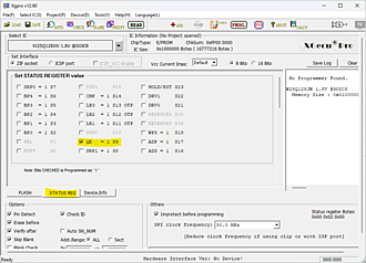

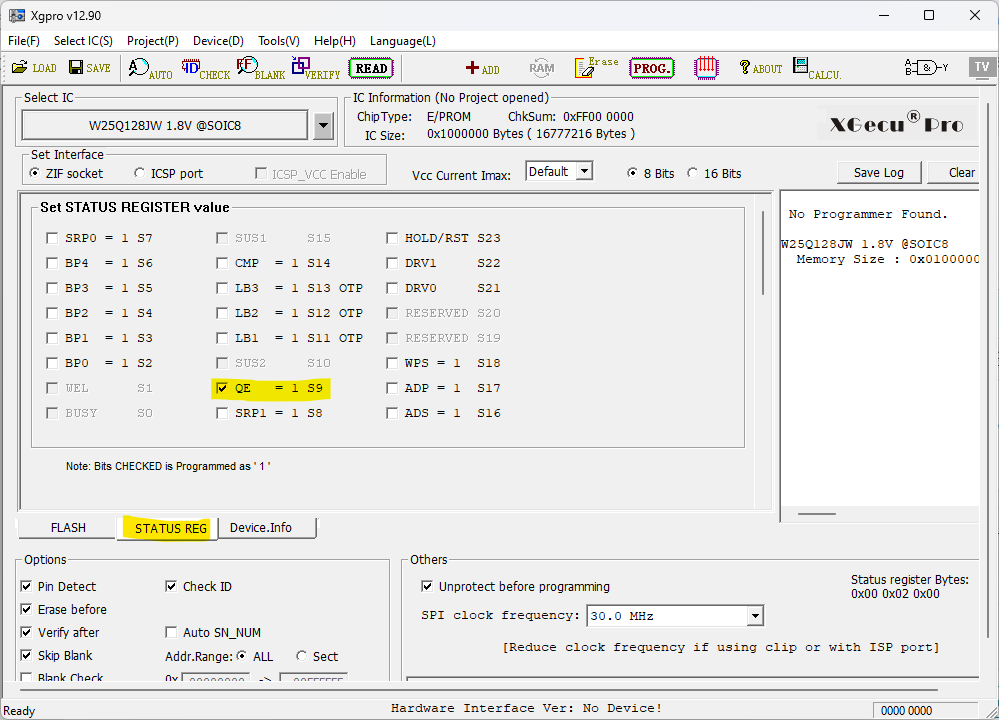

                  QE bit should be set as the following:
                  Click image for larger version  Name:	w25q128jw.png Views:	0 Size:	64.0 KB ID:	3709147
                  Also lower the SPI clock frequency to 8MHz if using clip
