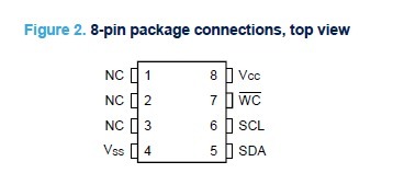

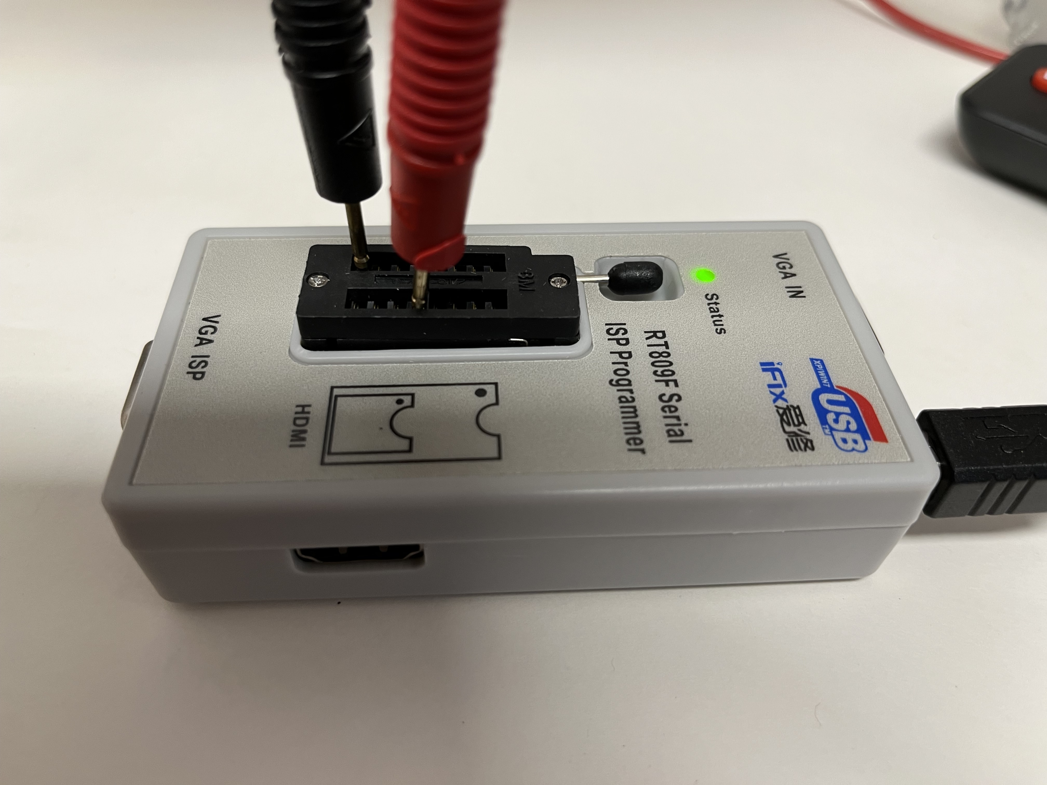

    If I measure voltage between pin 4 (GND) and 8 (VCC), I measure 0V. Obviously operation cannot work without voltage.
    Any tips what I am doing wrong ?

    Which eeproms are not being detected properly? Which part #?
    It is possible that the s/w or hardware logic is checking for a nominal current draw from a seated memory device else will power down. The meter leads are not imposing a suitable load so the Vcc remains off. Perhaps quickly pulsed on and then off and the meter is unable to sample this rapid ON/OFF cycling.

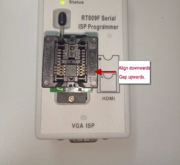

            this is an image from the RT809F manual. My setup is identical Click image for larger version
Name:	ScreenHunter_87 May. 15 12.56.jpg
            • mcplslg123
              • Jun 2015
              • 7262
              • india
              The ZIF socket comes in 2 sizes 150mil/200mil.
              150mil is the size for 24xx/25xx series eeproms.
              • kevin_allein
                • Dec 2023
                • 45
                The leads make contact and I cannot measure any VCC voltage. I don't understand your comment

                  Likely VCC gets enabled only when reading/writing, try sticking wires on the socket, attached to your multimeter leads
                  If your meter has auto range, switch it to manual range (10-20v), then try to read the chip, you should see the voltage appear only when reading the chip
                  If you have an old desktop PC motherboard laying around with a DIP8 25xx flash, try it, that's to rule out if your ZIF socket, or programmer is defective
