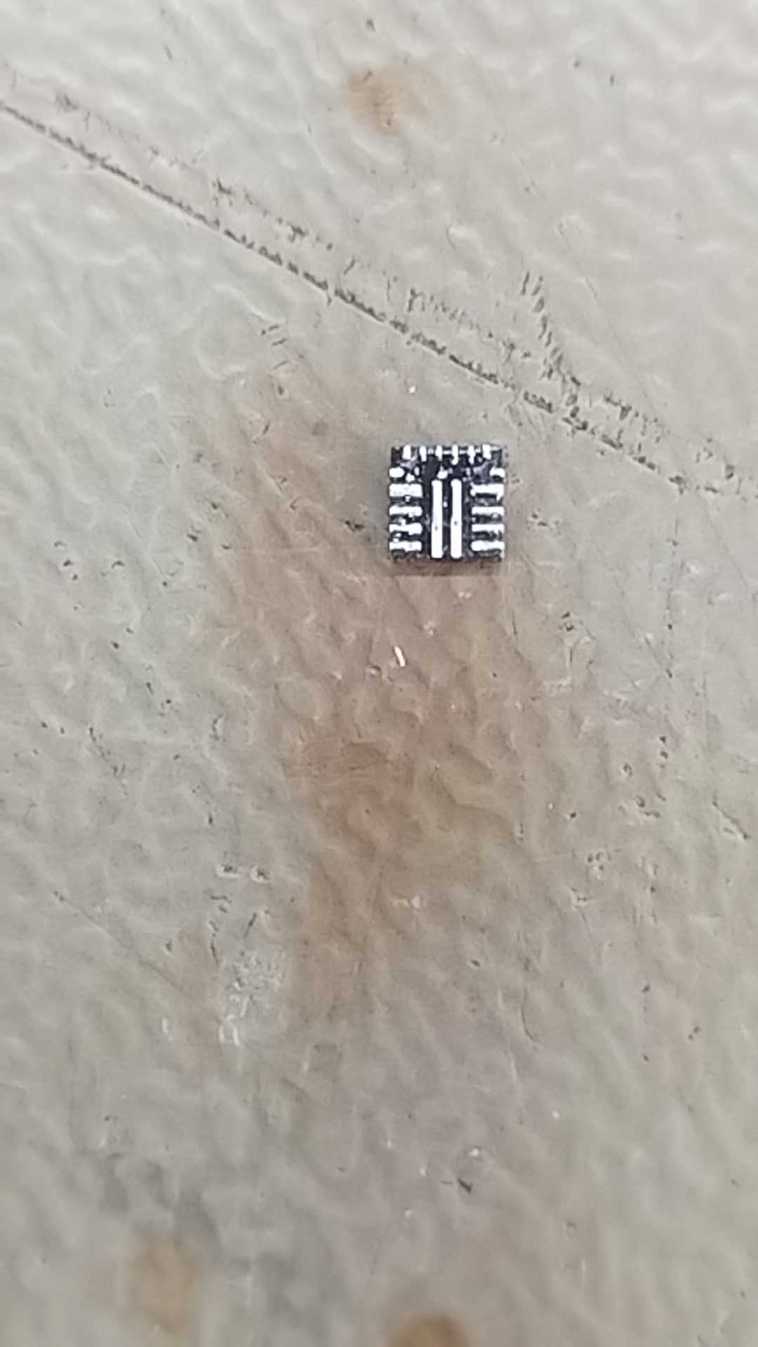

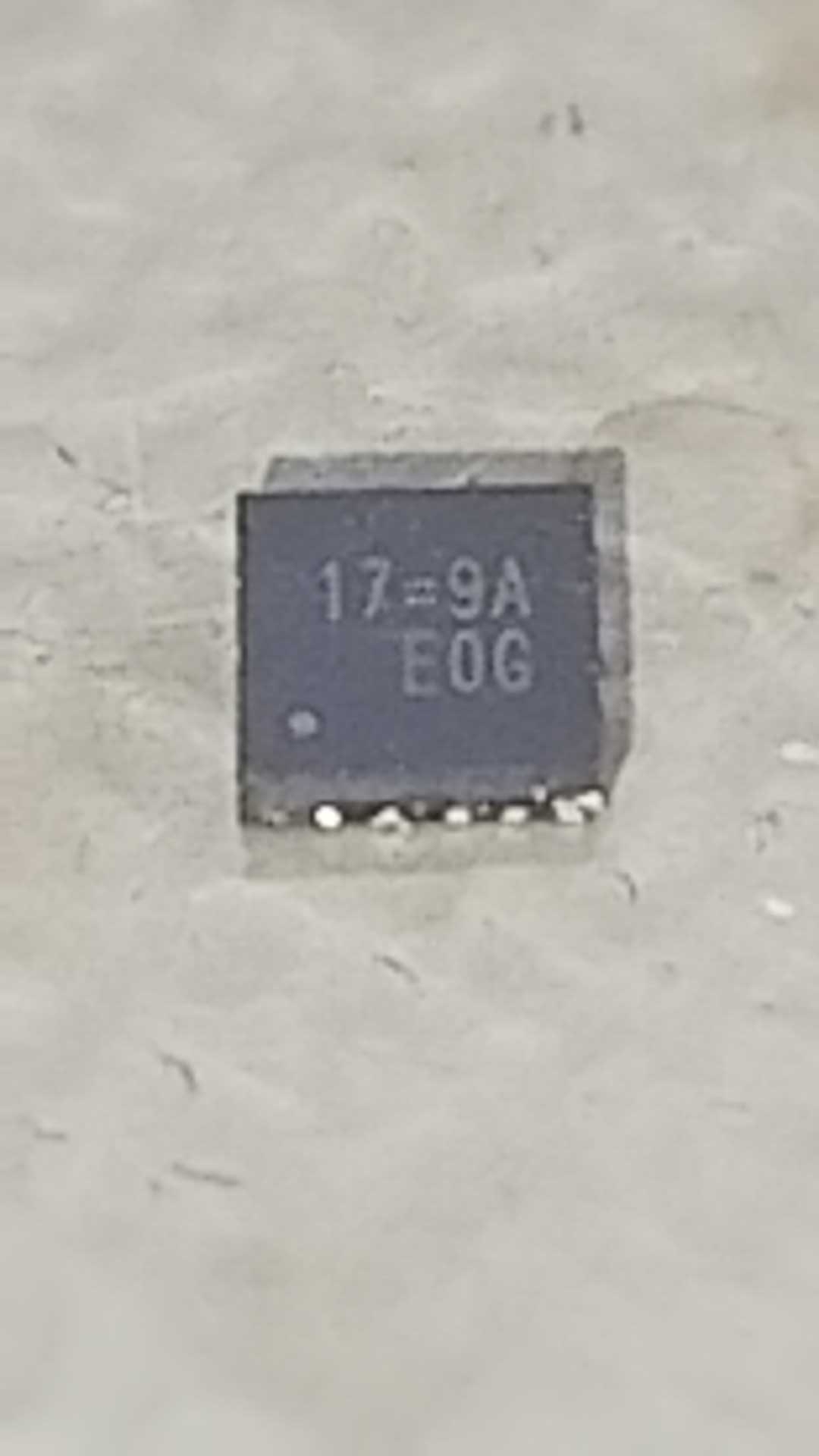

                            I have a chip with marking 17=9A
                            What could it be?
                            thanks!
                            • mon2
                              • Dec 2019
                              • 14677
                              #94
                              Post a clear pic of the part.
                              • chick0n
                                • Mar 2017
                                • 22
                                #95
                                here
                                • mon2
                                  • Dec 2019
                                  • 14677
                                  #96
                                  Which motherboard contains this part?
                                  May be similar to the following:
                                  RTQ2823A/B
                                  • m1ch43lzm
                                    • Mar 2019
                                    • 948
                                    • Peru
                                    #97
                                    RTQ2822AGQVF
                                    17=**
                                    Datasheet attached
                                    mon2 you were very close....

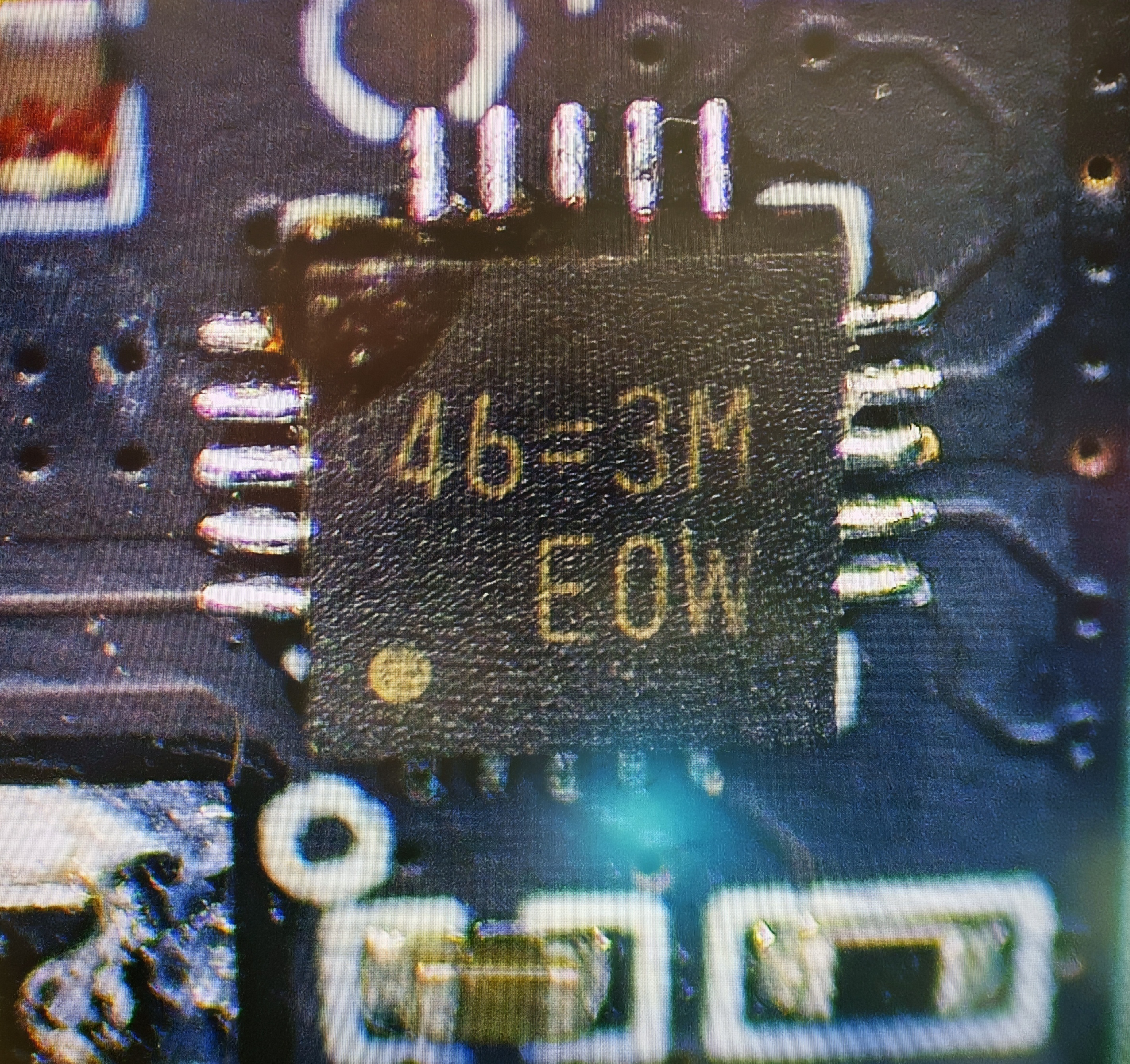

                                          #100
                                          I can't find this Richtek code in any code list. It's printed with "46=".
                                          Thank you very much.
