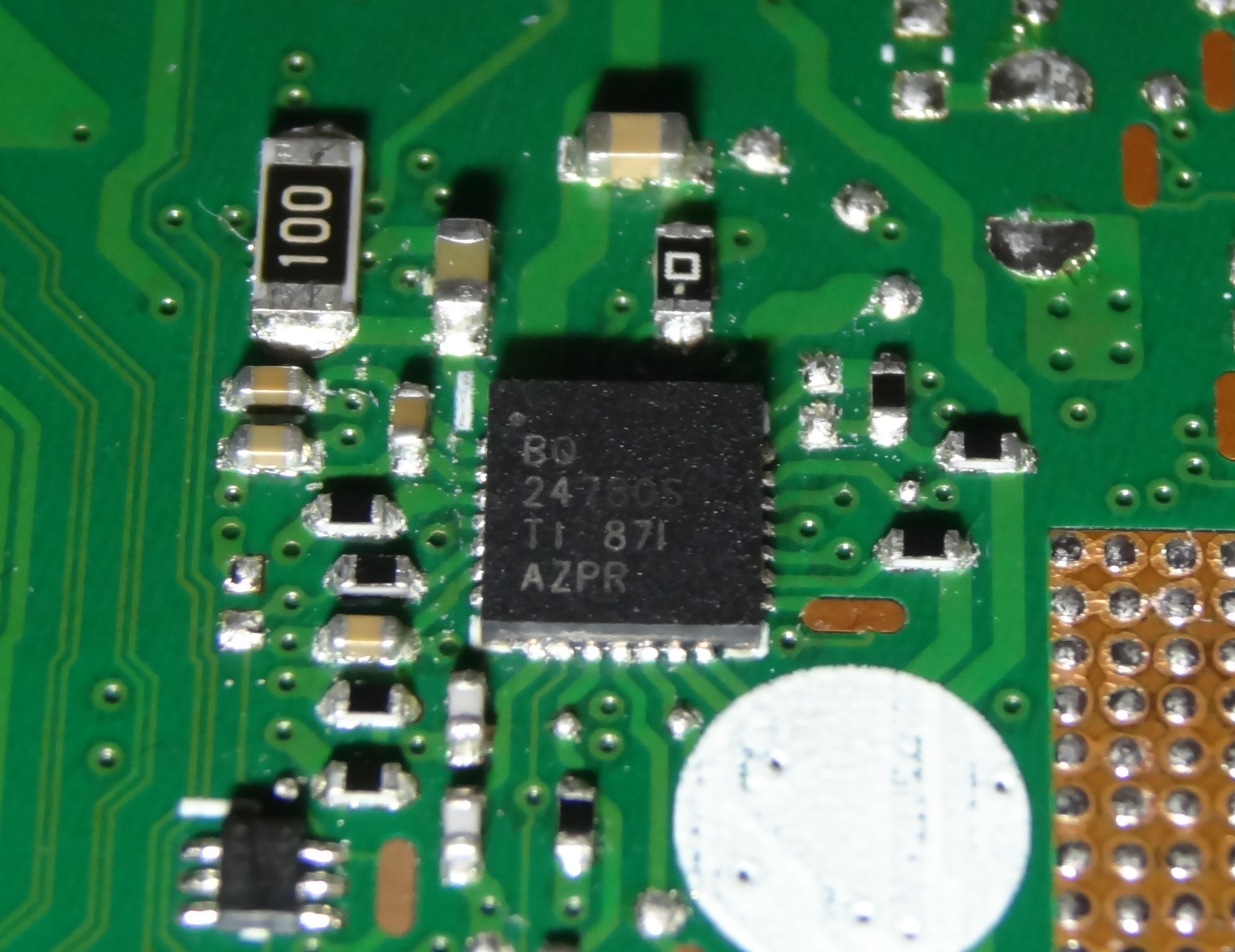

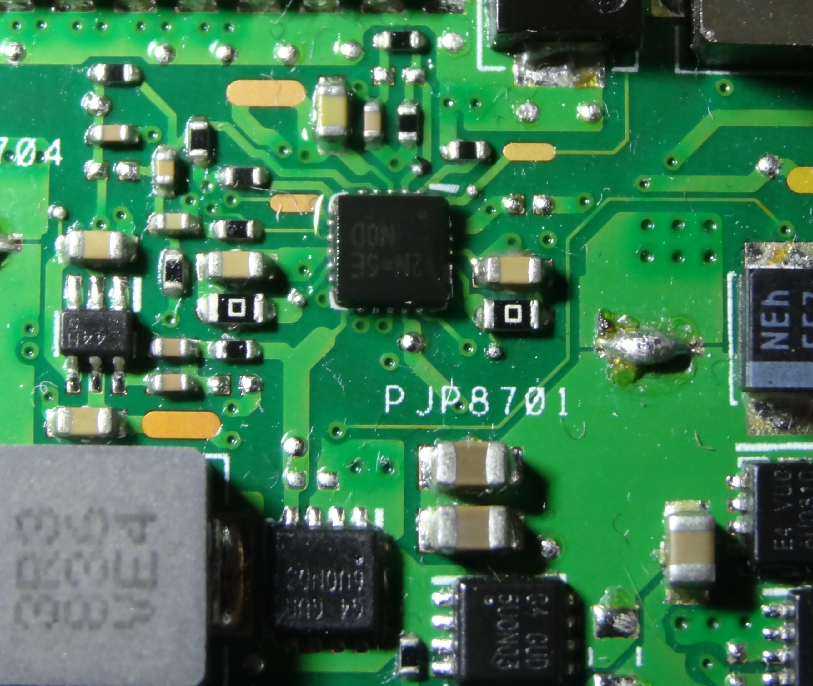

    What about 66=5F, 65=5G and 5E=5E?
  • mon2
    • Dec 2019
    • 14631
    Re: Asus x541na ic 2N=4H replacement

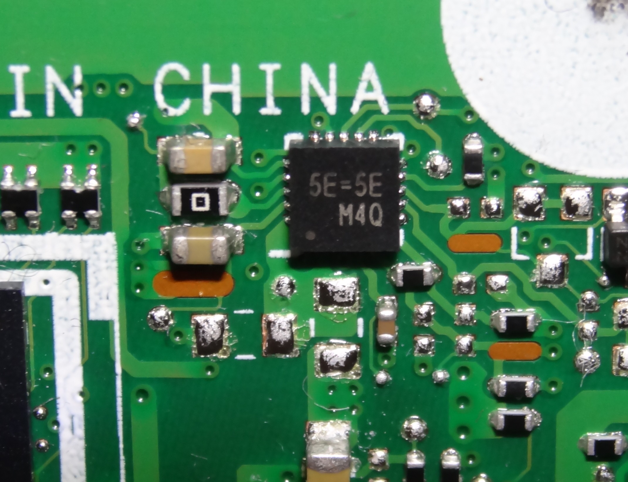

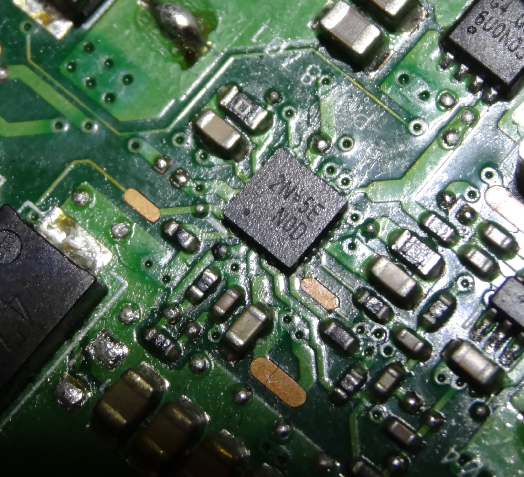

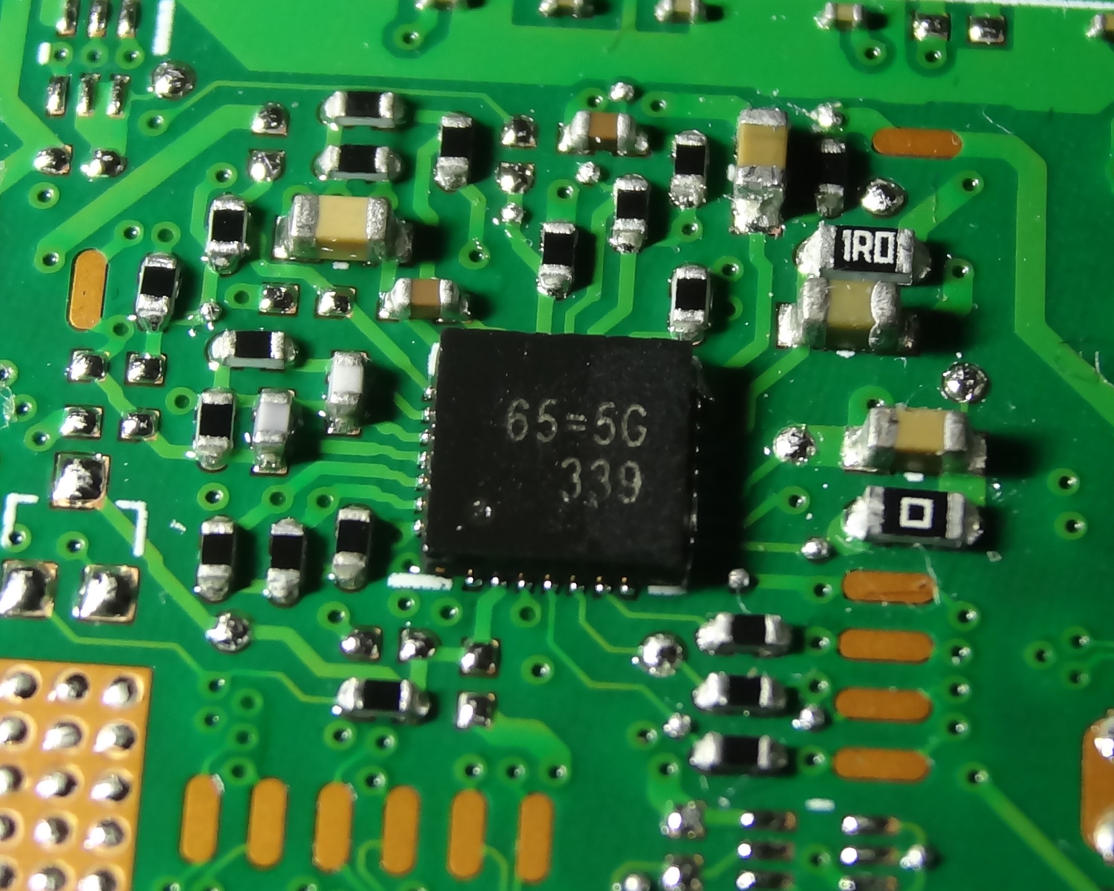

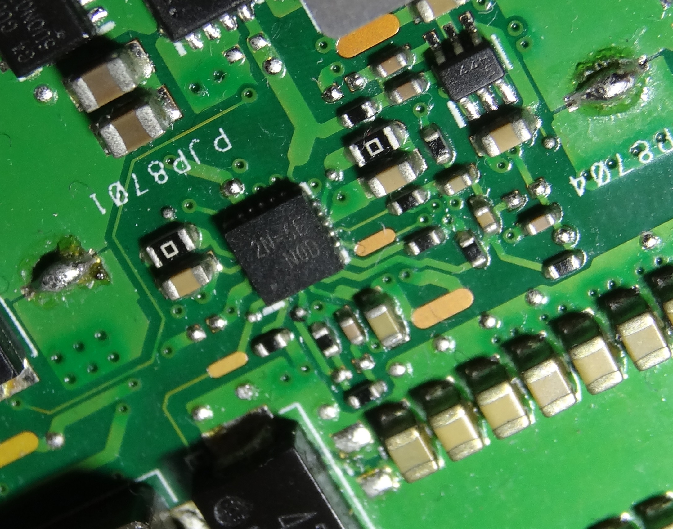

    @madan1, post zoomed up clear pics of each component for a review of the package(s).
    Where is each component being used ? Brand name? Post as much detail as possible.

      Asus e402ma laptop, all similar package as the above one, all part of the power supply ( look like switching ICs ). Let me know if you need better photos.

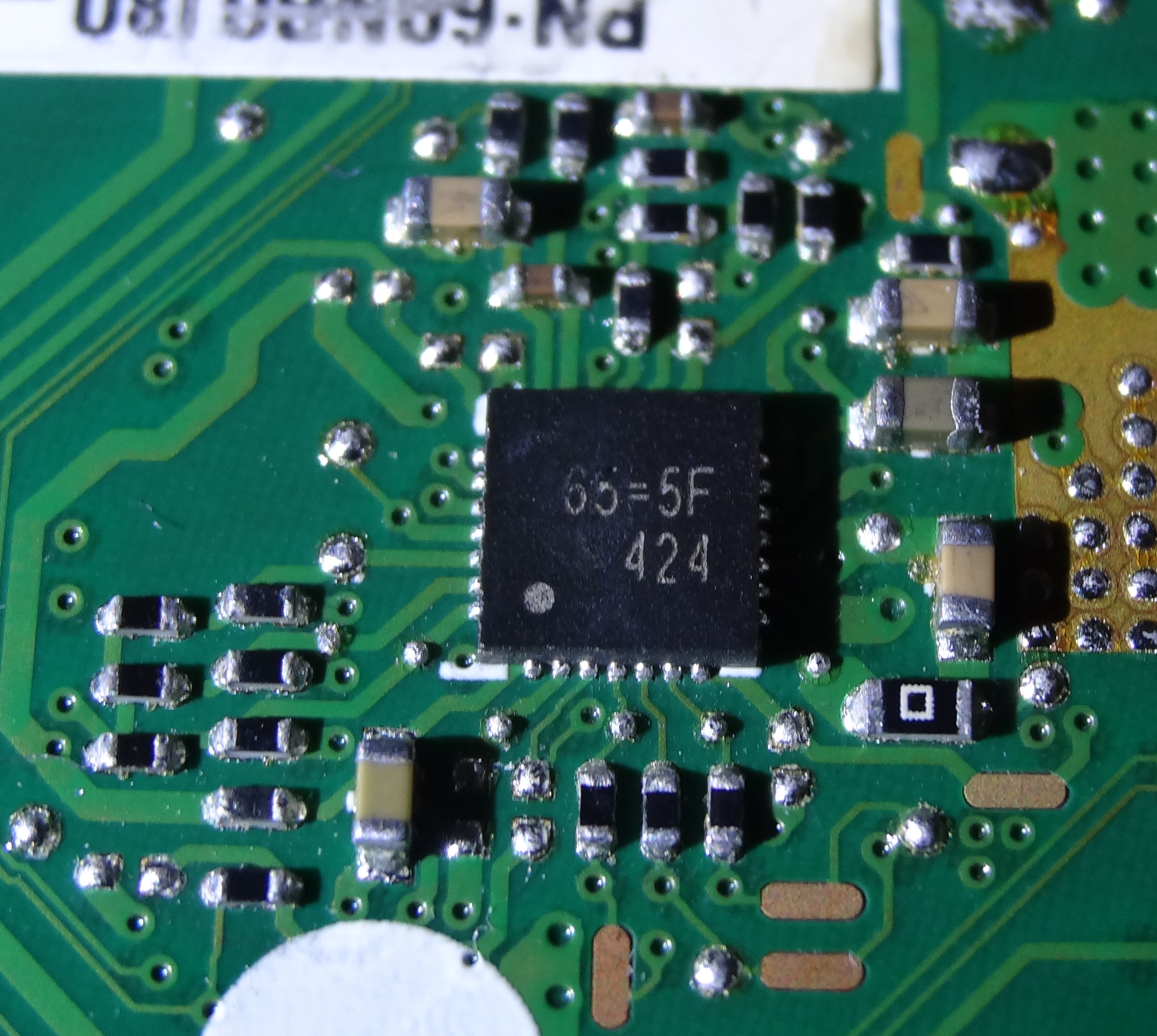

        66=5f - could this be possibly 6S=5f ? Pour some alcohol over the markings and try to review under bright light at an angle to confirm.
        6S=xx is Richtek RT6576DGQW. Datasheet is attached. Confirm if a valid match with the # of pins on your original device.
        This part is available here:
        https://www.aliexpress.com/wholesale...xt=RT6576DGQW+
        5E=xx is Richtek RT8248AGQW. Datasheet is attached. Confirm if a valid match with the # of pins on your original device.
        https://www.aliexpress.com/wholesale...chText=RT8248A

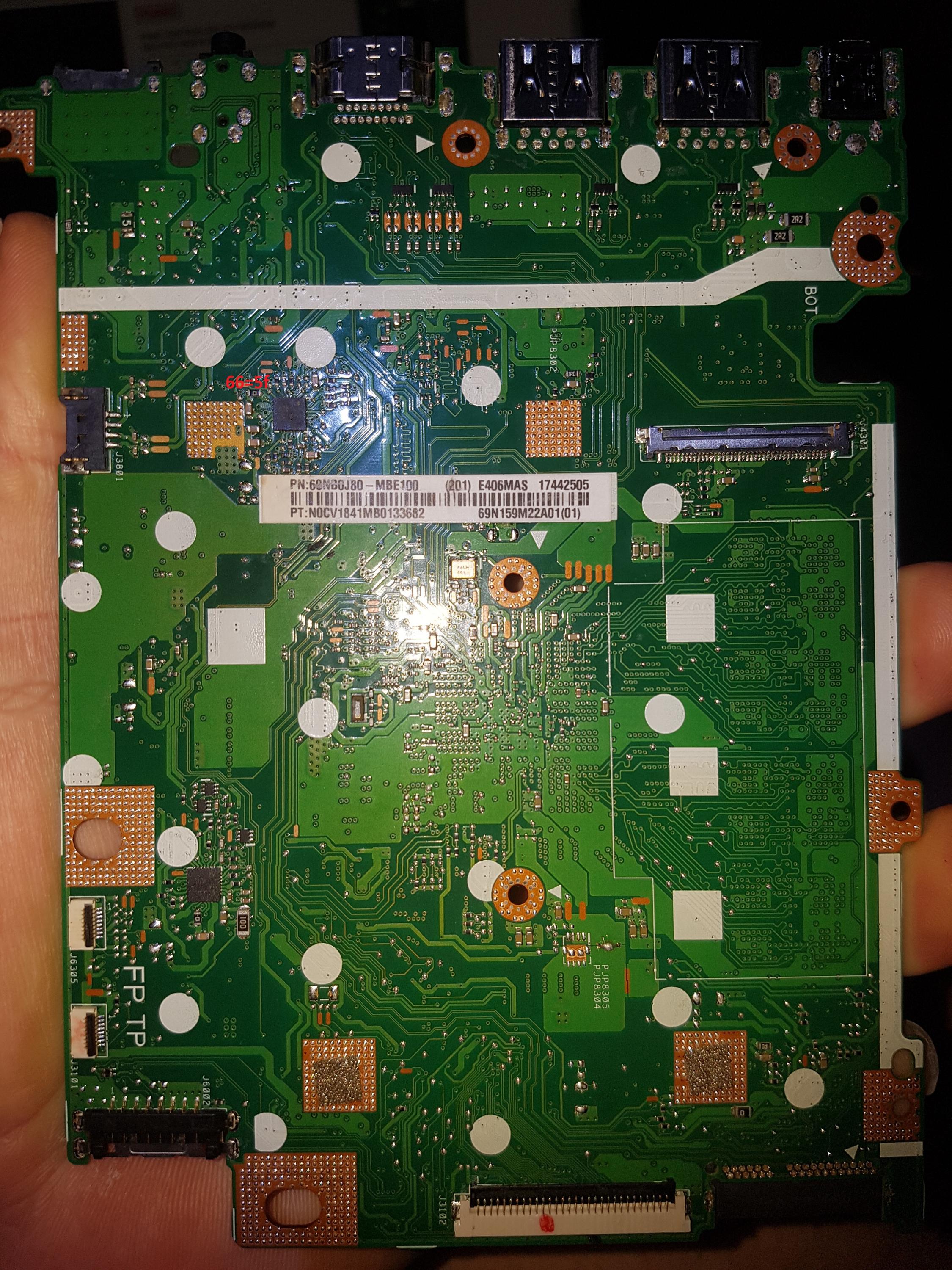

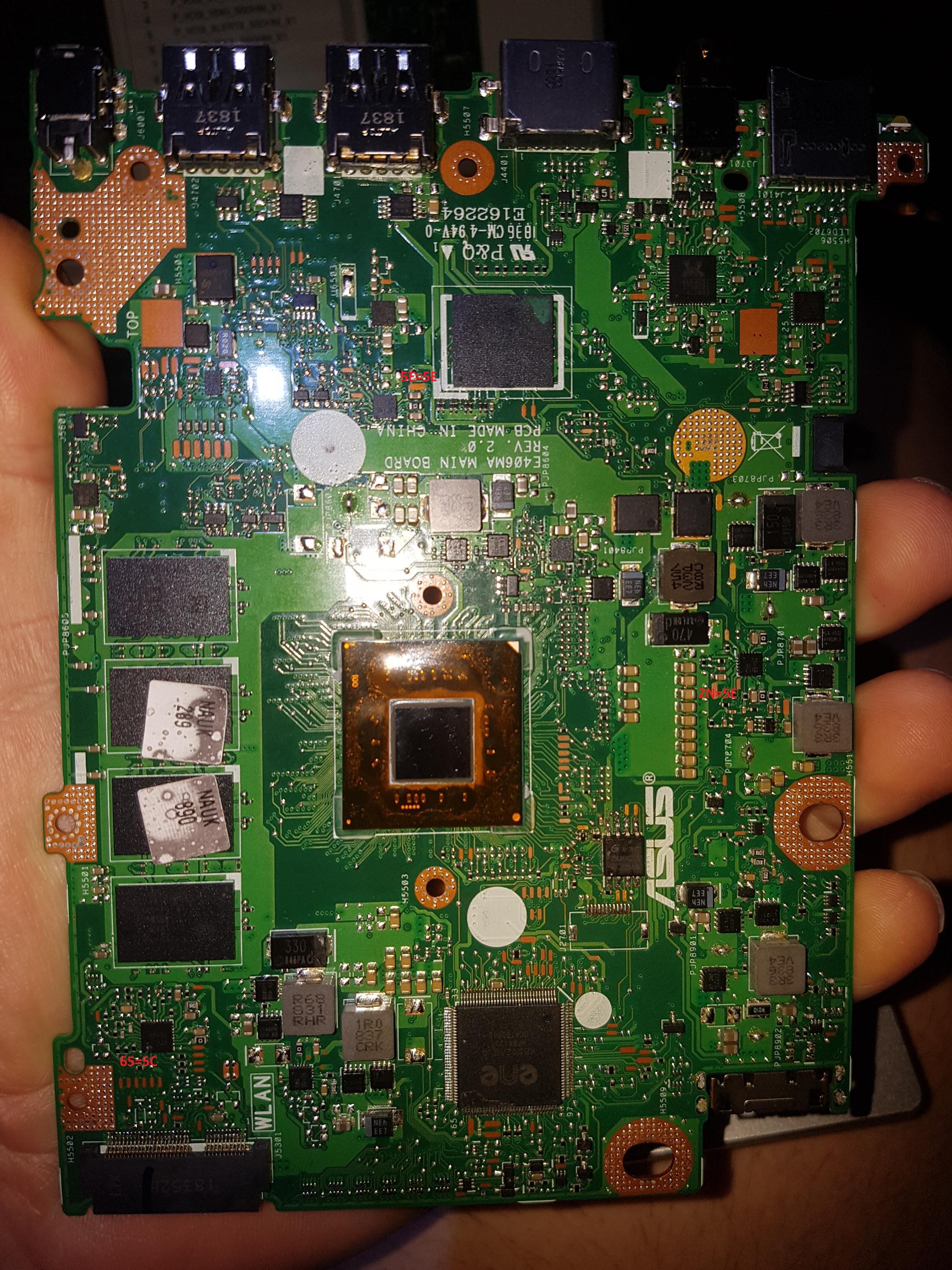

          The motherboard shown in the pictures is an E406MA
            Sir, you are totally correct. I hope I haven't wasted people's time by this typo..
            Thank you for the reply! Really appreciate it.

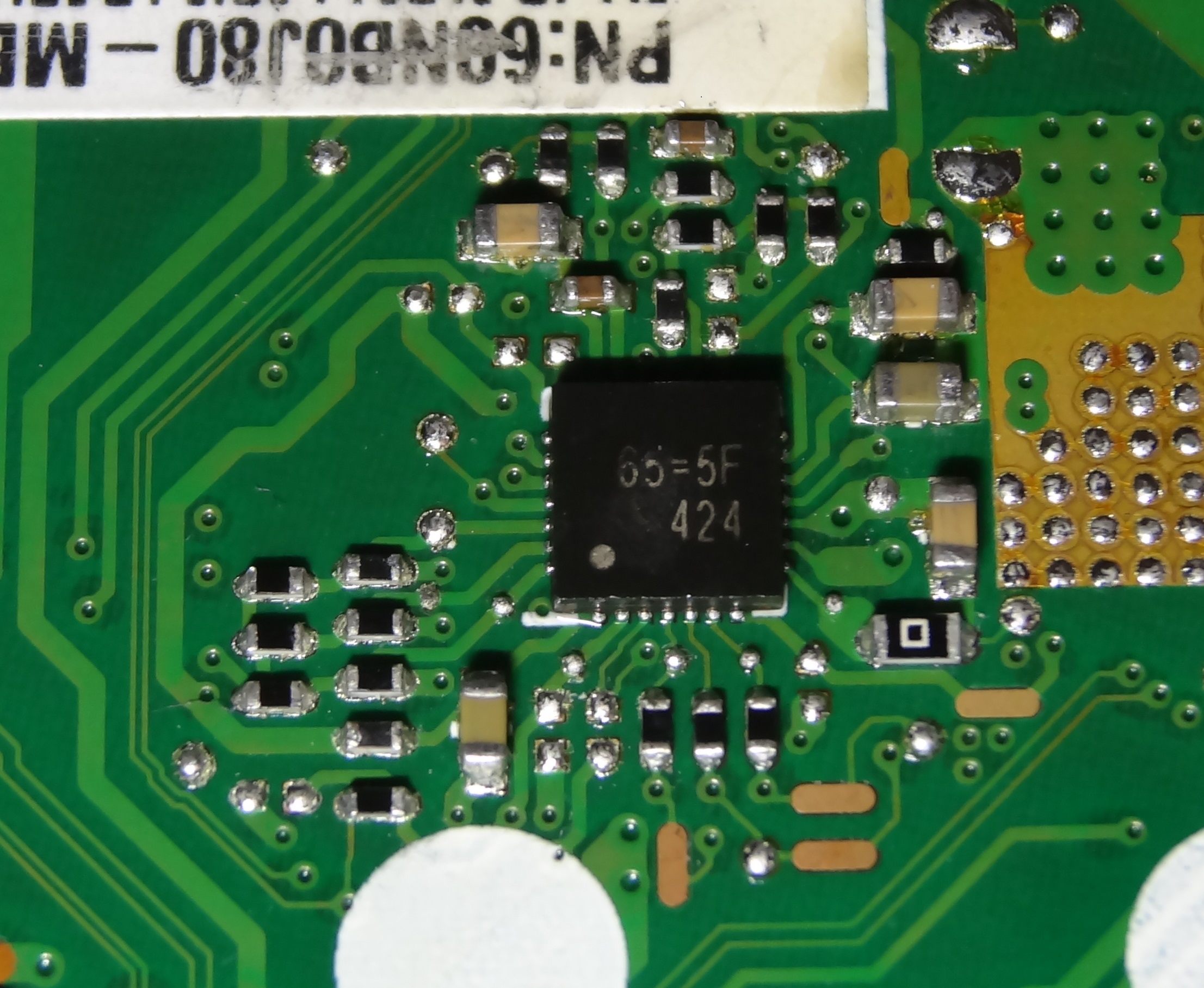

            Just made some hi-res photos.. oh well, looks like the camera has better eyesight than me.. used to be the opposite
            Probably the IC I'm most interested is the 65=5F, this one should be changed for sure. In other model ( for which I was able to find boardview ) asus is using ATK1602GQW in it's place.. if this helps.

                Ok. Updates...
                1) 65=YM is a private part for the logic board customer.
                Richtek will not share anymore details but was the reply from their office.
                2) after more searching, found a stocking agent in Shenzhen.
                10pcs =60 usd
                Shenzhen Hong Ming Electronics
                They have stock.
                Ask them for other Richtek parts as well. Be sure to update this thread with your progress. This is a very solid supplier whom we have used for past repairs.

                  Thanks, I sent them a message, but if they are not willing to sell smaller amounts, then the board goes to the scrap bin.
                  A working board for this laptop can be obtained from aliexpress for roughly the same price.

                    If the ATK1602GQW is pin to pin compatible those are much cheaper .

                        Yes, the seller offered 5pcs, but I went with buying another physically damaged e406ma board for 12GBP/17USD. I guess, if I was willing to wait more, I could have scored even a cheaper one.
