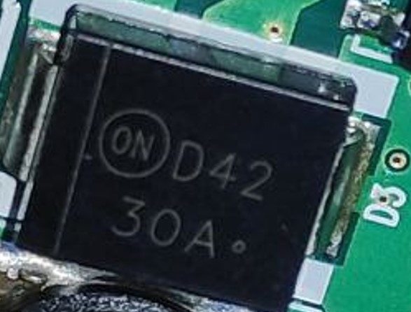

    Marking code 30A??
    hi~
    pcb marking D = diode
    marking code 30A
    Is there an exact datasheet?
    I want to know the exact product name

    From which logic board? Brand? Model? Do you have a schematic?
    It is from ON SEMICONDUCTOR. Looks like a SMB Schotkky diode with a 30A rating but need more details from your side.

      It could be a On semiconductor 1.5SMC30AT3

        Re: Marking code 30A??
        Very nice hunting R_J. Thanks.
        Agree on the p/n.
        The original ONSEMI is no longer available but see the replacements at the bottom of this page for valid crosses:
