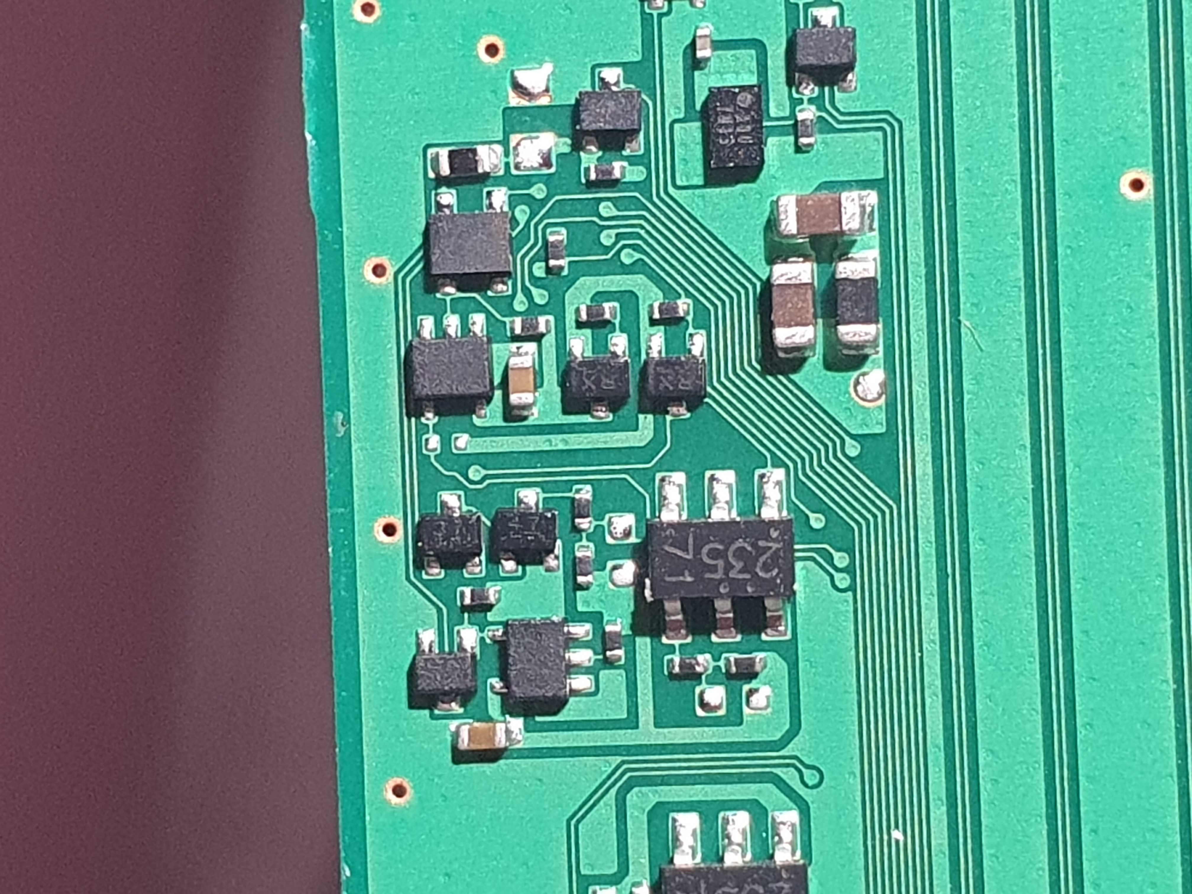

What is this component ? smd double diode like, marking code : RX
  • corrize
    • Apr 2021
    • 272
    • France

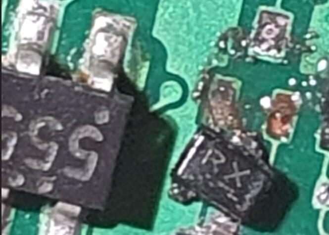

    Hello, do you know what it is this component marked RX please ? I can't find it. Probably it is a part of serie, because I saw another marked RW.

    Several possibilities here:
    http://markingcodes.com/search/c/rx
    We would get a better idea if you showed us a photo of the surrounding components.

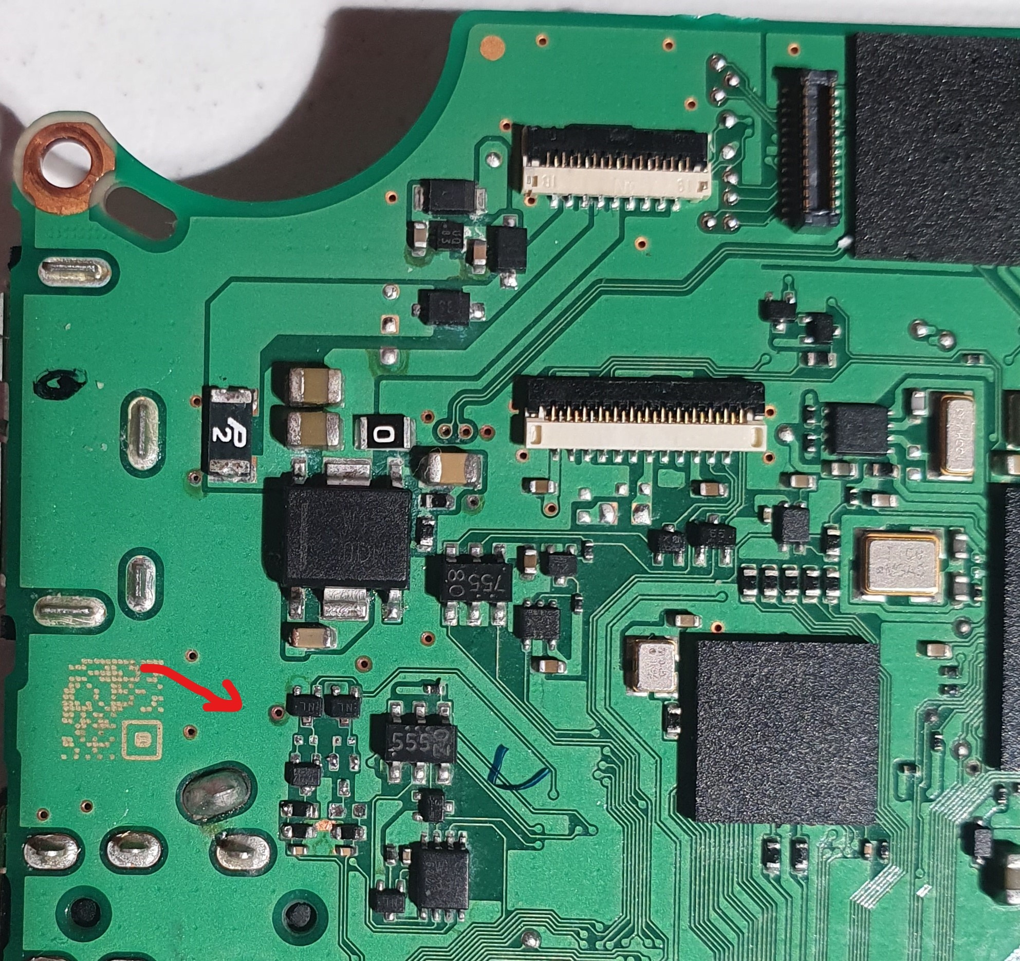

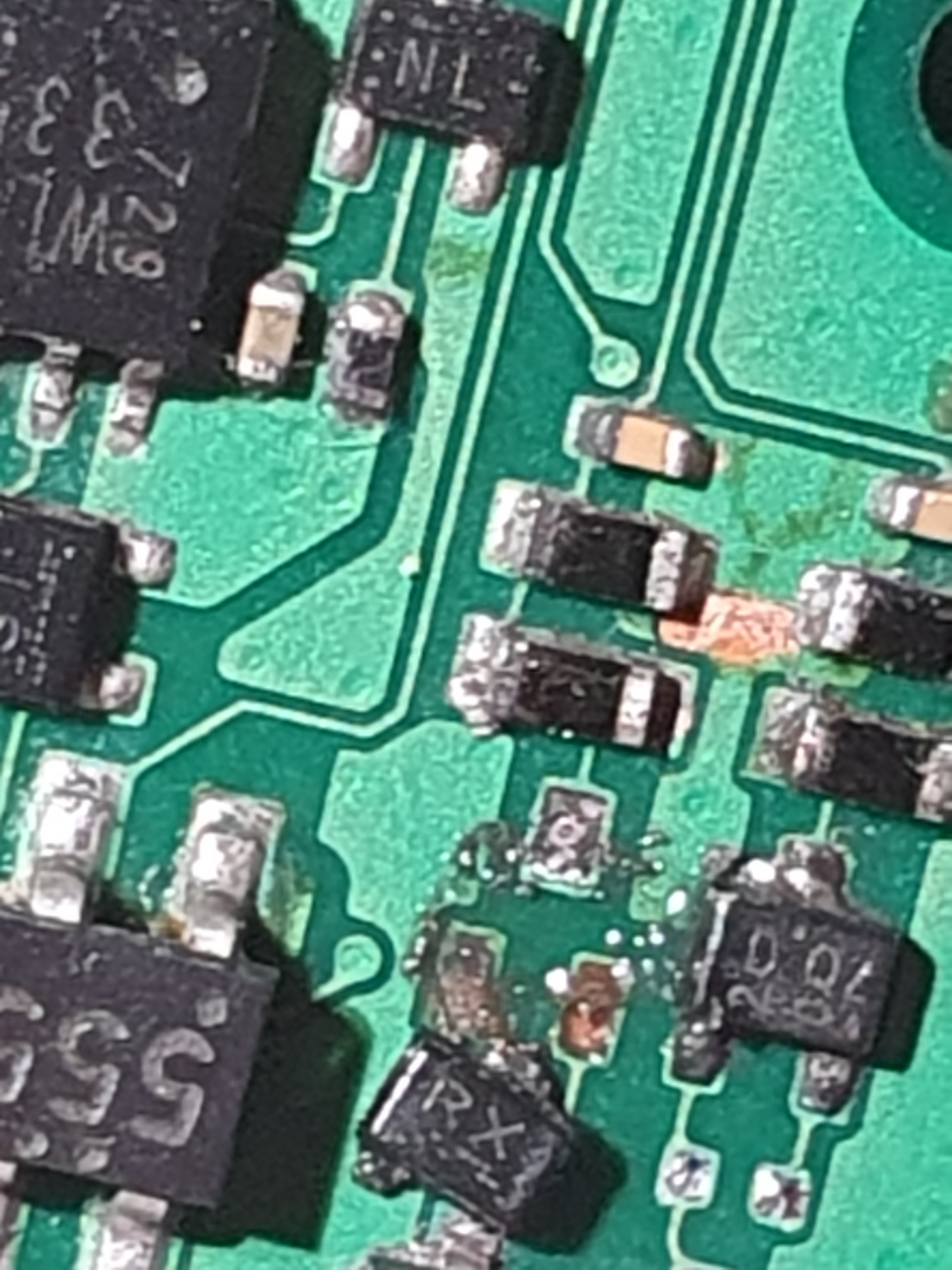

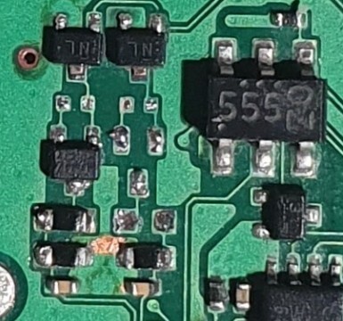

      Thanks for reply. See the area around. In the largest picture, the RX component is missing, you can see 3 pads only. There is a parallele configuration, so the component beside could have the same function (It is a camera DLSR board).
      I saw the list of "RX", and I noticed thic component could be a LM4050, maybe ? only because it is a common component, and because in the board that could be a power controleur-regulator, and because that could be in comparison configuration, but.... I guess, it is a general idea, nothing precise ?

          Are pins 2 and 3 of RX and DQ internally connected? If so, then they are probably diodes (zeners?) or voltage references of some kind.

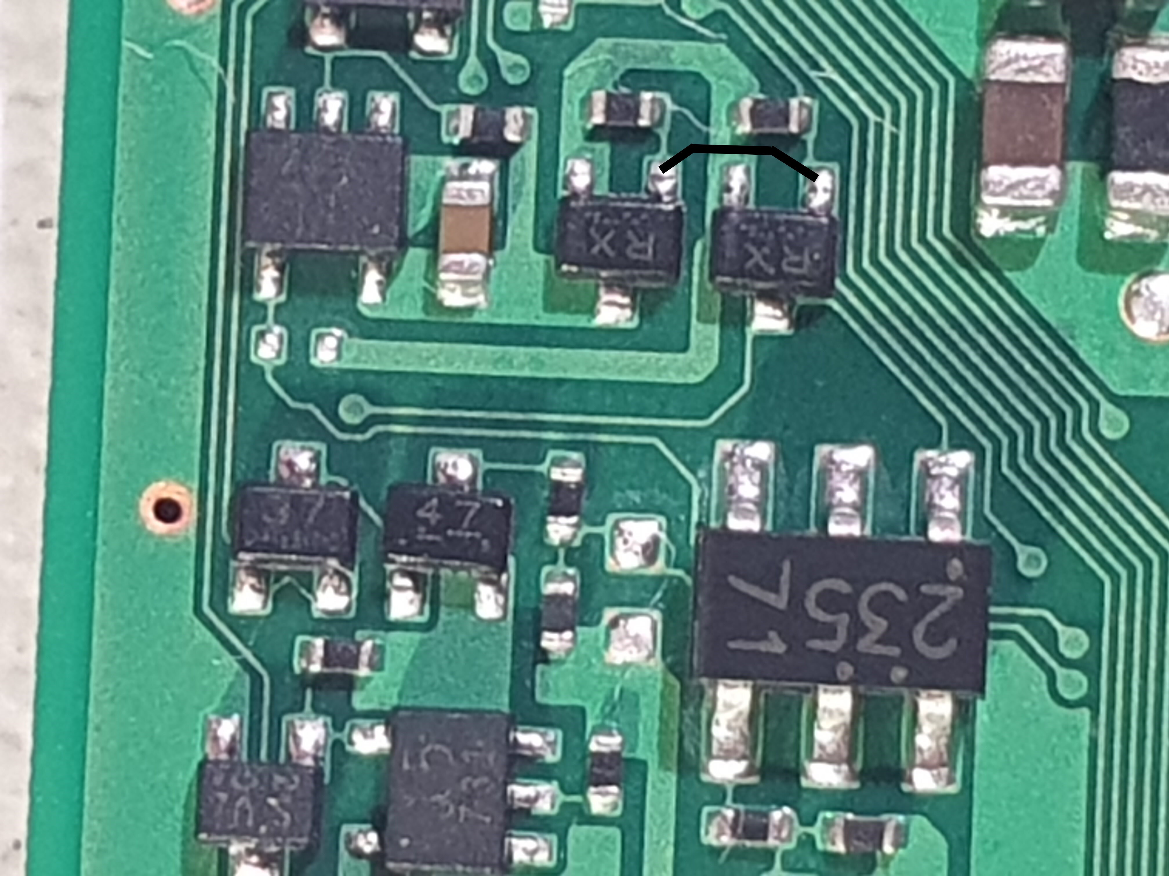

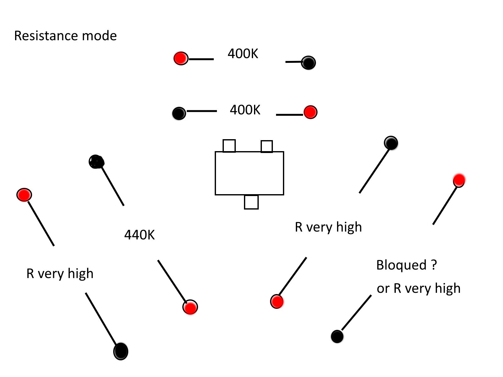

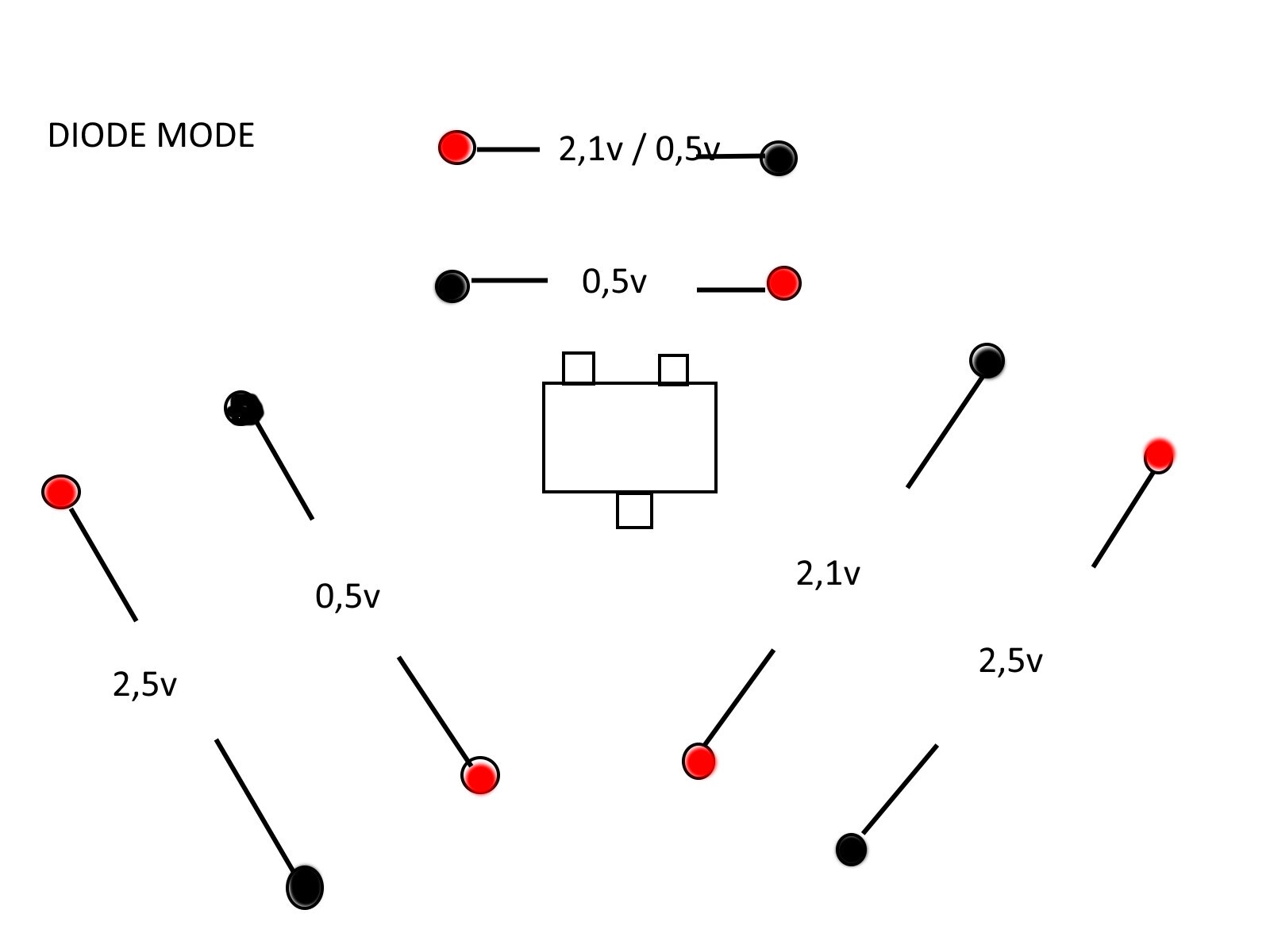

                Thanks for reply, the original RX is lost, but I found 2 other « RX » side by side on the board (see pictures)
                I measured in circuit, in diode mode and resistance mode (see schematics) but the result is not obvious for me ? I guess it is not a zener, and not a diodes, maybe not a transistor because I cant see clearly a « diode ».
                I noticed no pin is ground, and I noticed the 2 pins at same sides are linked to same pin to other (see picture).
                The board is dead, so the components can be defectives.
                If necessary, I can desolder one and measure out of board ?

                  The RX components look like a P-channel MOSFET ???
                  Did you desolder the gate resistors in your earlier photos?

                      One of the photos shows two G-S junctions in parallel. Two B-E junctions in parallel wouldn't make sense.
                      How about RZM001P02T2L?
                      https://www.mouser.com/ds/2/348/rzm001p02-515260.pdf (datasheet)
                      https://www.aliexpress.com/w/wholesa...001P02T2L.html (photos)
                      If the device is made in Japan, a Rohm MOSFET would make sense.

                          Mosfet is a good idea. That explain all the measurements « open ».

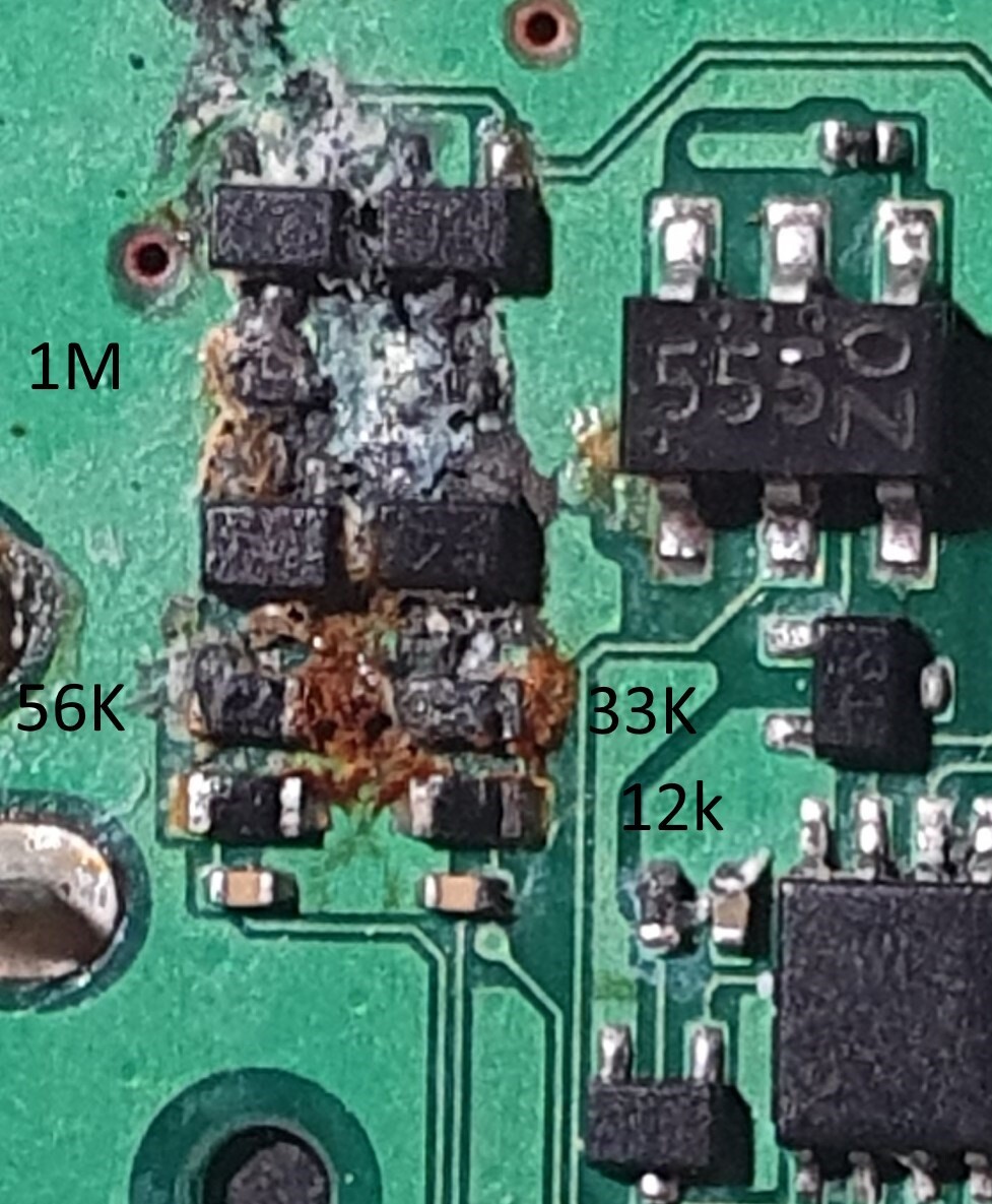

                          In the previous photo, RX component and 2 resistors indeed are missing because destroyed by rust (see photo before cleaning, the resistor on top has same value the one beside : 1MOhms).
                          You found it. RZM001P02T2L match 100% indeed. Probably I would never found it, thanks. I will order it and replace.
