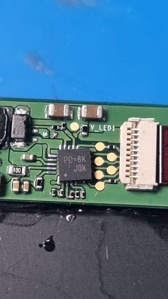

            #65

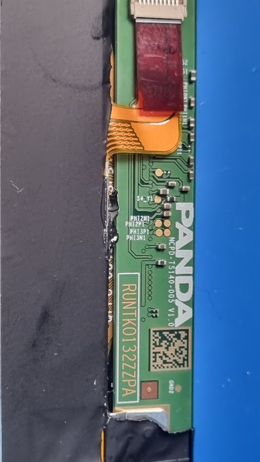

            Re: Richtek marking code
            Hi, i need help with this one please
            I didn`t find the code in any list
            PD=6k
            Is on the board of a lcd used for backlight
            • R_J
              • Jun 2012
              • 9607
              #66
              Looks like it is a Richtek RT8532A
              • nickstyle
                • Aug 2022
                • 42
                • United Kingdom
                #67
                Thank you and best regards :0

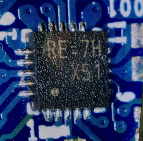

                      #70
                      Re: Richtek marking code (I think..?)
                      Hi, i need help with this one please ,I didn`t find the code in any lists
                      RE=7H X51
                      Is on the board of a Lenovo laptop (hitting 125c), thanks.
                      Click image for larger version  Name:	RE=7H X51 (Small).jpg Views:	0 Size:	78.4 KB ID:	3267108
                      • mon2
                        • Dec 2019
                        • 14677
                        #71
                        Which Lenovo? Share more details.
                        • zlr8r
                          • Feb 2023
                          • 102
                          #72
                          RE=7H X51
                          ahhh! found it searching here for only "RE=" , an RT6585C
                          is on a Lenovo Yoga 7 15ITL5

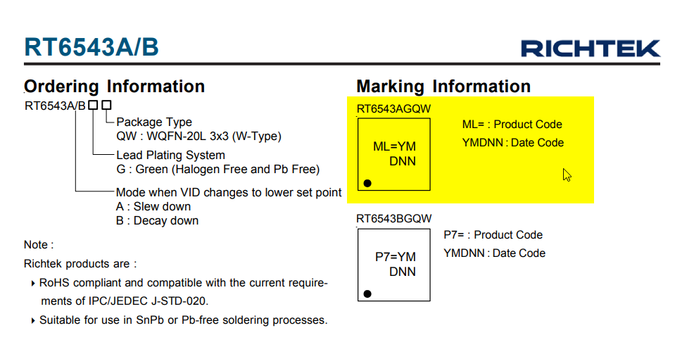

                            hi guys, any idea with this "ML=7L A8S" ? Wanna purchase this chip but can't find it at ebay and aliexpress. Asus x513ea rev2.0
                            Click image for larger version  Name:	image.png Views:	0 Size:	181.0 KB ID:	3297988
                            • mon2
                              • Dec 2019
                              • 14677
                              #74
                              RT6543AGQW
                              High Efficiency Single Synchronous Buck PWM Controller for INTEL VCCIN AUX ICL ,and TGL (richtek.com)
                              • DonEvenKnowMe
                                • May 2024
                                • 9
                                • Malaysia
                                #75
                                my silly question, i only found 7B , 7M and 7E , is it the same/compatible ?
                                • mon2
                                  • Dec 2019
                                  • 14677
                                  #76
                                  Yes, as long as you have 'ML=' in the markings, the rest are 'do not care' markings. The 'ML=' defines the part # and the rest are only manufacturing date codes.

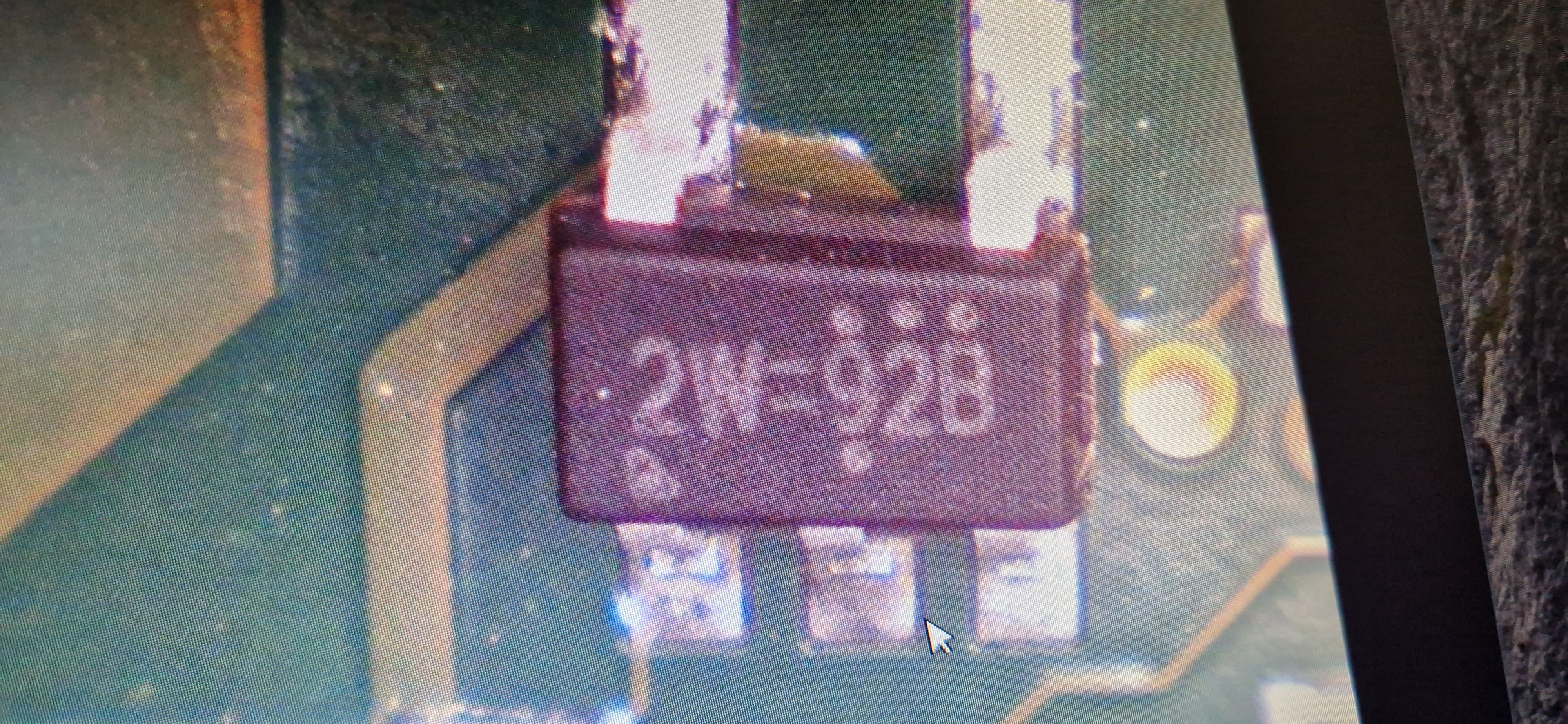

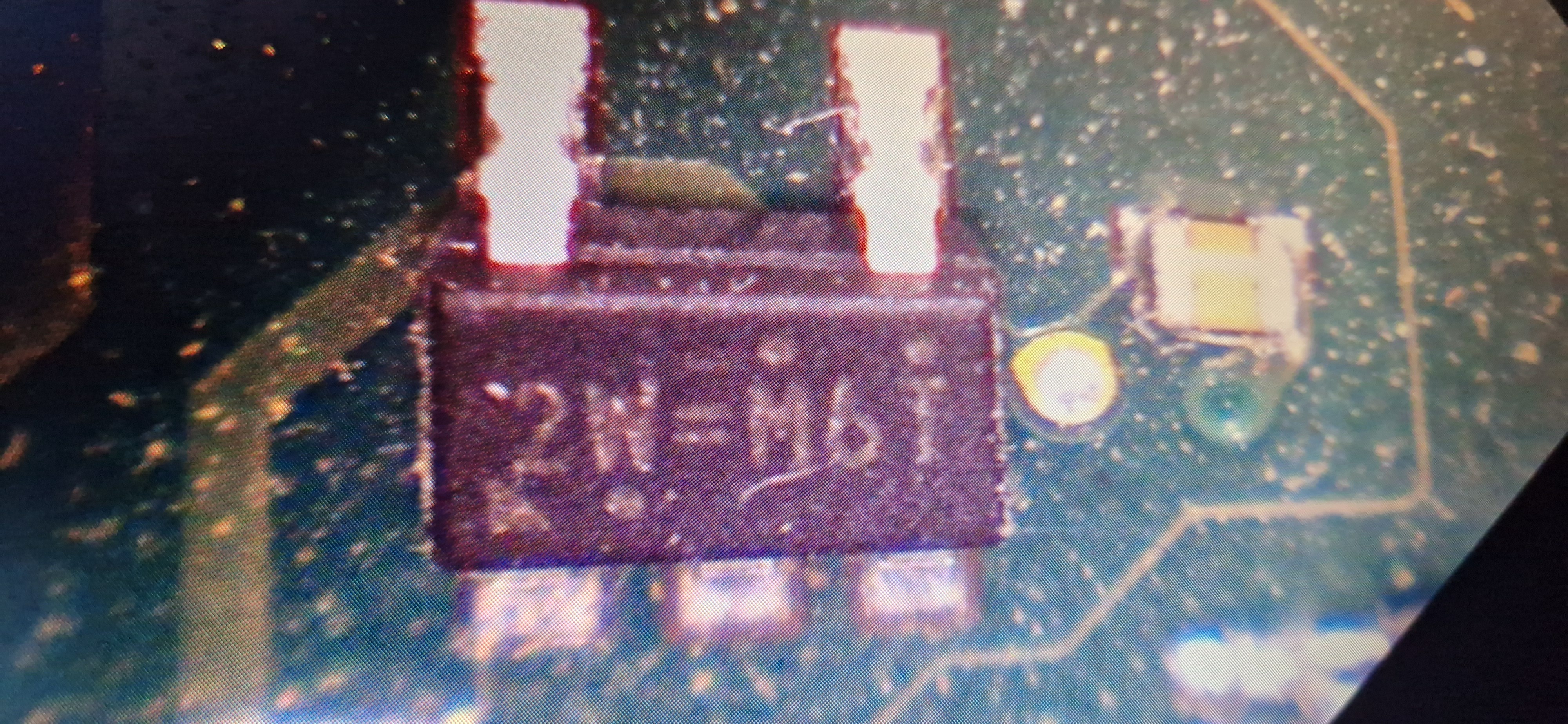

                                      #78
                                      What is this IC?
                                      2W=M6T or 2W=92B
                                      Maybe RichTek, based on list 2W- -> it is RT9182DPES with 6 pin
                                      and... RICHTEK RT6212AHRGJ6F 2W=
                                      https://www.richtek.com/assets/produ...S6212AB-08.pdf
                                      But same 6pin so that is not good...
                                      It has just 5 pin so 2W= what is this?
                                      Click image for larger version  Name:	2W=M6T.jpg Views:	0 Size:	2.33 MB ID:	3320101
                                      Click image for larger version  Name:	2W=92B.jpg Views:	0 Size:	2.60 MB ID:	3320102
                                      • angel35
                                        • May 2020
                                        • 18
                                        • Hungary

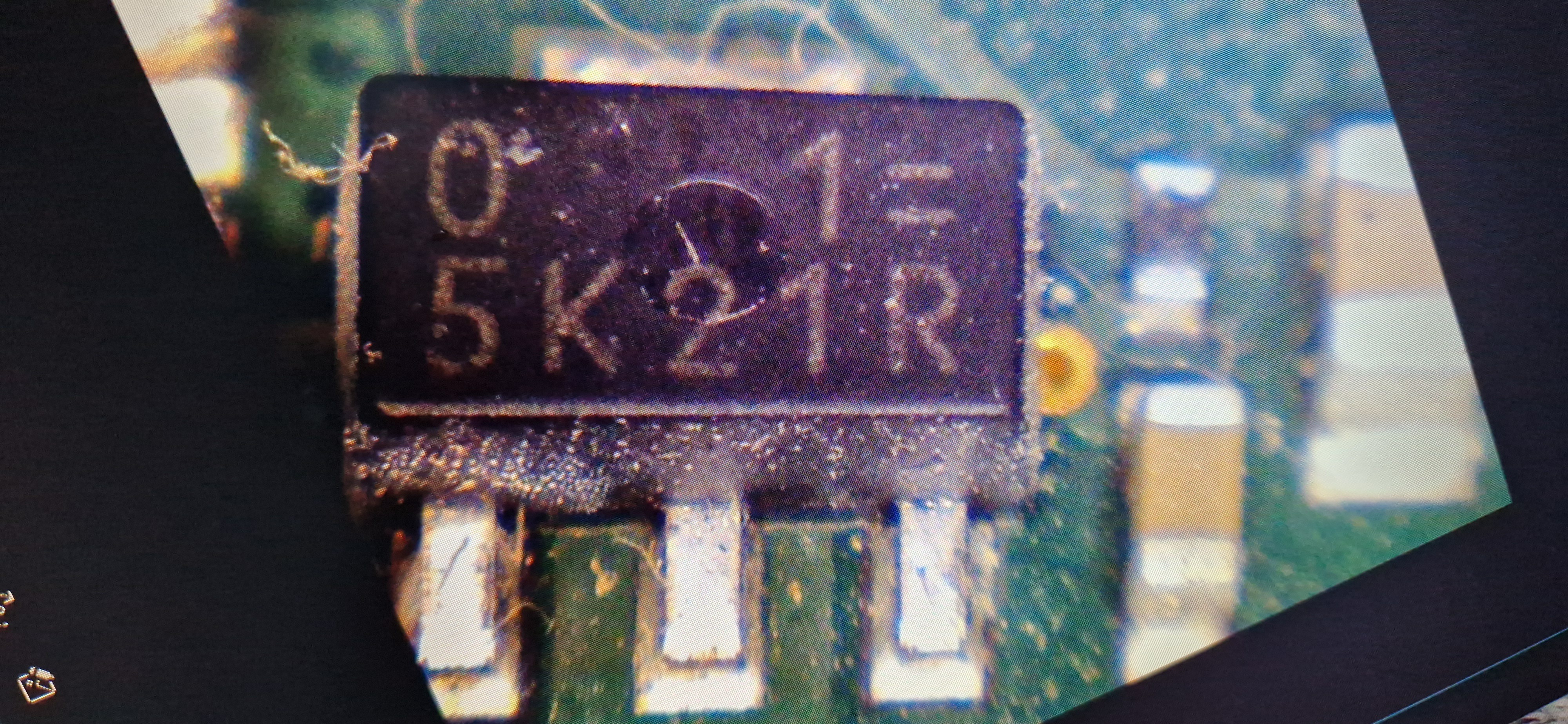

                                        #79

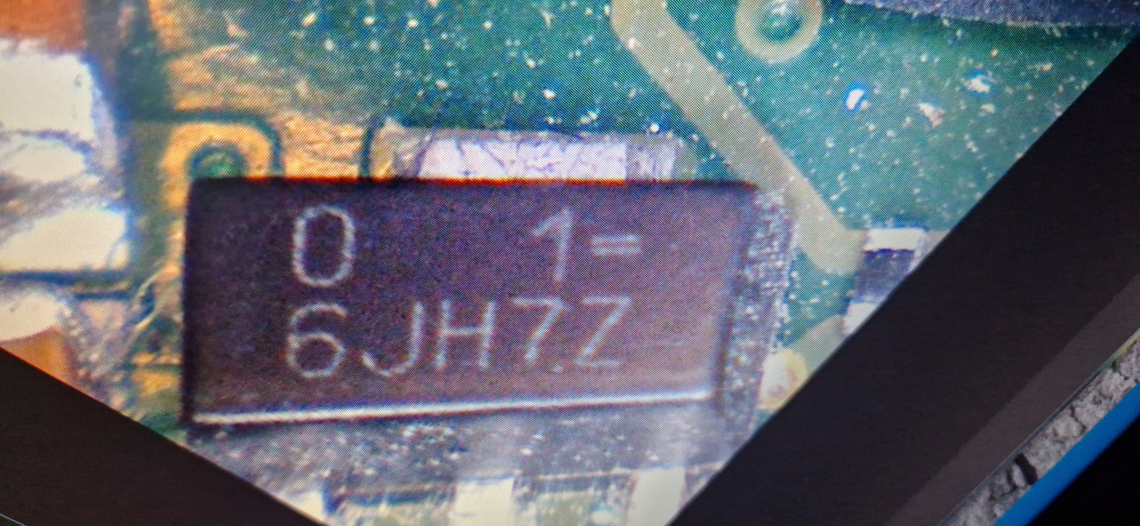

                                        An another:
                                        What is this IC?
                                        Maybe RichTek, or not, but absolutly not found same like on internet... ~26-27V in and 3,3V out So maybe an LDO or same like...
                                        Marking: 0 1=
                                        3 pin Maybe TO-89 package
Name:	0 1= 6.jpg
