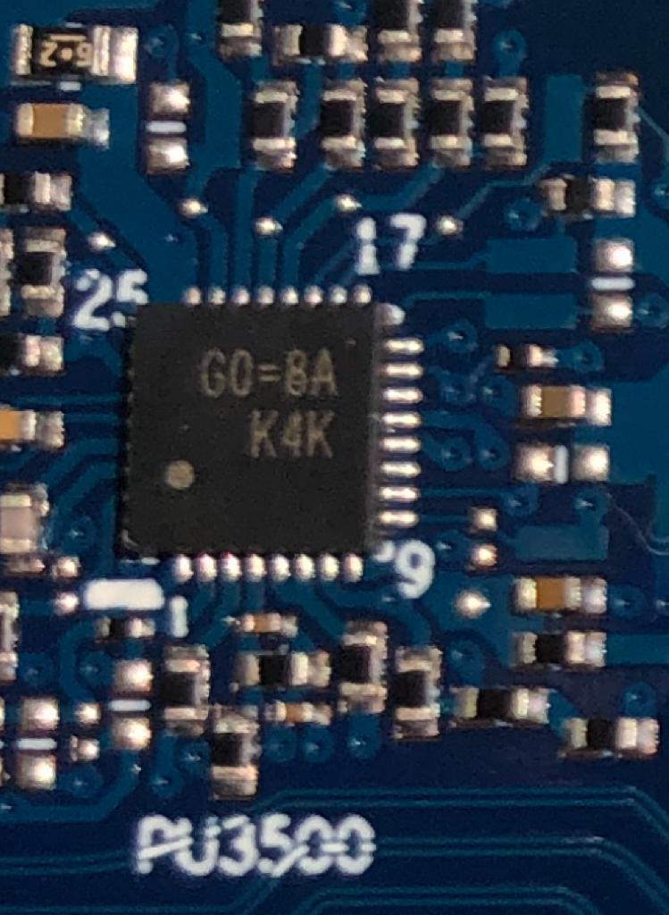

      Hi friends, cant find this one...
      G0=
      If someone can help me, thanks in advance

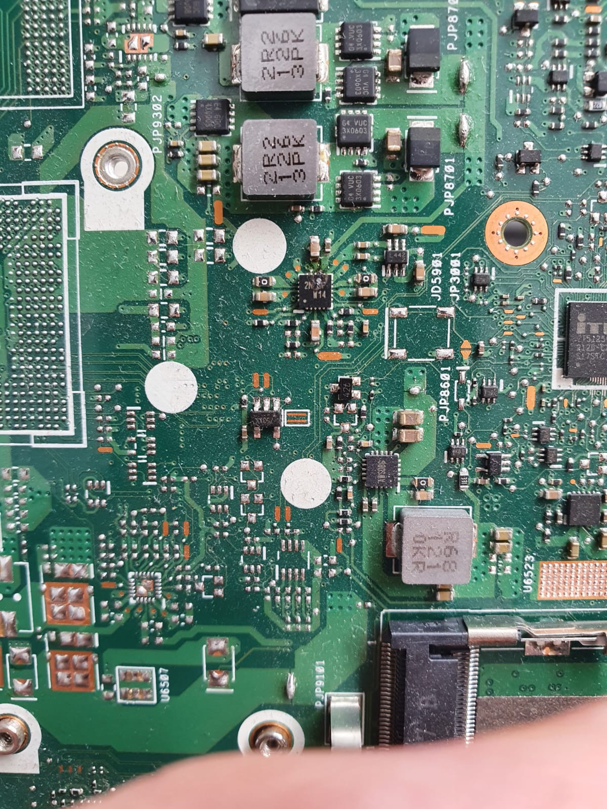

        Re: Richtek marking code
        On which logic board is this component soldered ? Post the full markings of the logic board and computer system so we can try to locate the device.
        • Argento7
          • Jan 2010
          • 27
          #44
          Lenovo Ideapad 3-15ITL05
          Board HS45A/HS55A
          Rev 1.0
          NM-D461
            Hello, is anyone active here? I desperately need your help. Sorry my english. the code is as follows: 4E=5k
            20k From already very grateful
            • R_J
              • Jun 2012
              • 9607
              #46
              No one is here. Richtek RT8813D

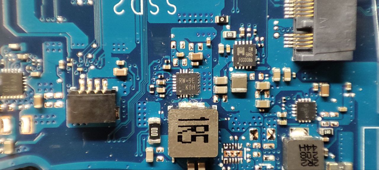

                              any one can help with htis one please
                              RW=9E
                              I think is the 3.3v or 5v regulator circut
                              • mon2
                                • Dec 2019
                                • 14677
                                #55
                                Post a pic of the top and bottom side of this part.
                                • serginio
                                  • May 2018
                                  • 16
                                  • UKR
                                  #56
                                  RW=
                                  • mon2
                                    • Dec 2019
                                    • 14677
                                    #57
                                    From which board / mfr / model is this IC used ?
                                    • piernov
                                      • Jan 2016
                                      • 4439
                                      • France
                                      #58
                                      Rt6338bgquf
                                      • serginio
                                        • May 2018
                                        • 16
                                        • UKR
                                        #59
                                        Originally posted by piernov
                                        Rt6338bgquf
                                        Thank you!
