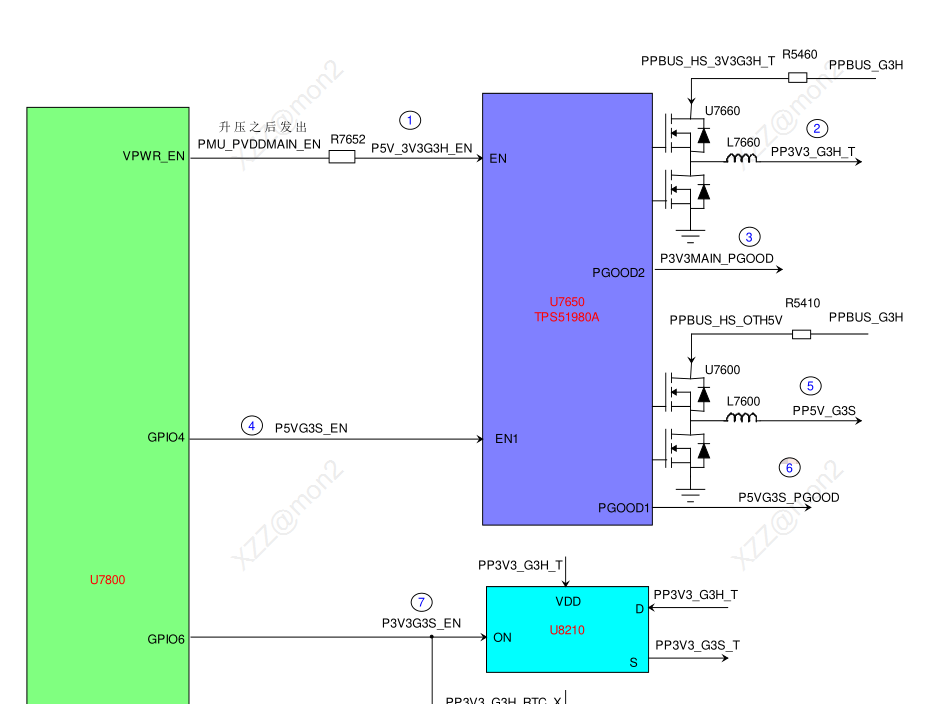

    Is this measurements ok?
    • mon2
      • Dec 2019
      • 14666
      What is the voltage to ground of SSD_PMU_RESET_L? If at 0v, continue to measure the following points of interest:
      (in order of the power up sequence chart - report any that are at 0v; continue otherwise to check each)
      P5V_3V3G3H_EN
      PP3V3_G3H_T
      P3V3MAIN_PGOOD
      P5VG3S_EN
      PP5V_G3S
      P5VG3S_PGOOD
      P1V8G3S_EN
      P3V3G3S_EN

        SSD_PMU_RESET_L​ - 1,8V
        • martyjelen
          • Mar 2023
          • 127
          • Czech republic
          P5V_3V3G3H_EN -0V
          PP3V3_G3H_T -3,3V
          P3V3MAIN_PGOOD - 0V
          P5VG3S_EN - 0V
          PP5V_G3S - 3,3V
          P5VG3S_PGOOD - 0V
          P1V8G3S_EN - 0V
          P3V3G3S_EN​ - 0V
          • mon2
            • Dec 2019
            • 14666
            Some of these measurements do not look correct. If you have a power rail then the _EN signals must be '1'. If you have the measured power rails then the _PGOOD should be '1'.
            Review the following to double-check each:

            • martyjelen
              • Mar 2023
              • 127
              • Czech republic
              Hello, sorry for delay.
              PMU_PVDDMAIN_EN - 0V
              P5V_3V3G3H_EN - 0V
              P5VG3S_EN - 0V
              P3V3MAIN_PGOOD - 0V
              P5VG3S_PGOOD - 0V

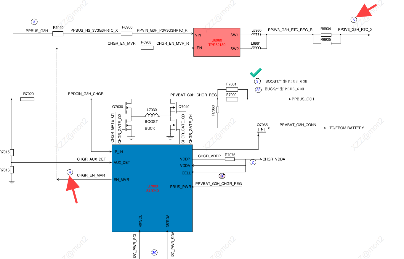

                • mon2
                  • Dec 2019
                  • 14666
                  P5V_3V3G3H_EN -0V
                  Confirm the voltage to ground on each side of R7652.
                  Remove all power and confirm the resistance across R7652 which should be ~3k3 ohms.​
                  • martyjelen
                    • Mar 2023
                    • 127
                    • Czech republic
                    #29
                    0V on each side of R7652.
                    Resistance is about 3,2kΩ​

                            #33
                            Confirm the voltage to ground on:
                            R6968 ; CHGR_EN_MVR_R / CHGR_EN_MVR
                            R6934 / R6935 ; PP3V3_G3H_RTC_REG_R / PP3V3_G3H_RTC_X
                            • martyjelen
                              • Mar 2023
                              • 127
                              • Czech republic
                              #34
                              R6968 - 5.1V on both sides.
                              R6934 / R6935 - 3.3V on both sides.

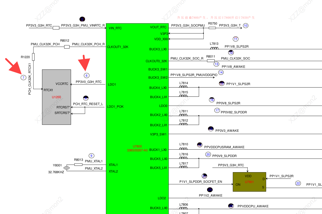

                              • mon2
                                • Dec 2019
                                • 14666
                                #35
                                Good. Onto steps 6 & 7.
                                • martyjelen
                                  • Mar 2023
                                  • 127
                                  • Czech republic
                                  #36
                                  PP3V0_G3H_RTC - 3V
                                  PCH_CLK32K_RTCX1 - 0.5V
                                  • martyjelen
                                    • Mar 2023
                                    • 127
                                    • Czech republic
                                    #37
                                    Should I continue with next measurements?

                                      • martyjelen
                                        • Mar 2023
                                        • 127
                                        • Czech republic
                                        #39
                                        Step 8 - PCH_RTC_RESET_L - 3V
                                        Step 9 - PMU_XTAL1 - 0V / PMU_XTAL2 - 0.6V
                                        Step10 - PP3V3_G3H_T - 3.3V
                                        Step 11 - PP1V8_SLPS2R - 1.8V
                                        Step 12 - PMU_CLK32K_SOC - 0.8V
                                        Step 13 - PP1V8_AWAKE - 1.8V
                                        Step 14 - PP1V8_SLPS2R_PMUVDDGPIO - 1.8V
                                        Step 15 - PP1V1_SLPS2R - 1.1V
                                        Step 16 - PP0V8_SLPS2R - 0.8V
                                        Step 17 - PP0V82_SLPDDR - 0.8V
                                        Step 18 - PP3V3 _AWAKE - 3.3V
                                        Step 19 - PPVDDCPUSRAM_AWAKE - 0.8V
                                        Step 20 - PP0V9_SLPDDR - 0.9V
                                        Step 21 - P1V1_SLPDDR_SOCFET_EN - 1.8V! (is it OK?)
                                        • mon2
                                          • Dec 2019
                                          • 14666
                                          #40
                                          Step21 - this is the enable pin for the loadswitch @ U7901. The enable voltage can be different than the operating voltage of the switch.
                                          Confirm the voltage to ground on U7901, pins #3 and #5. Are they stable @ 1v1 for each? Then this is ok.
