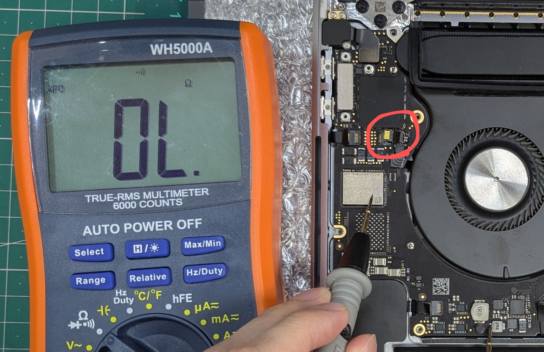

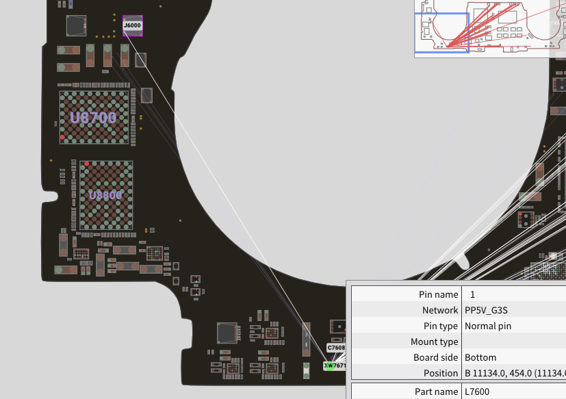

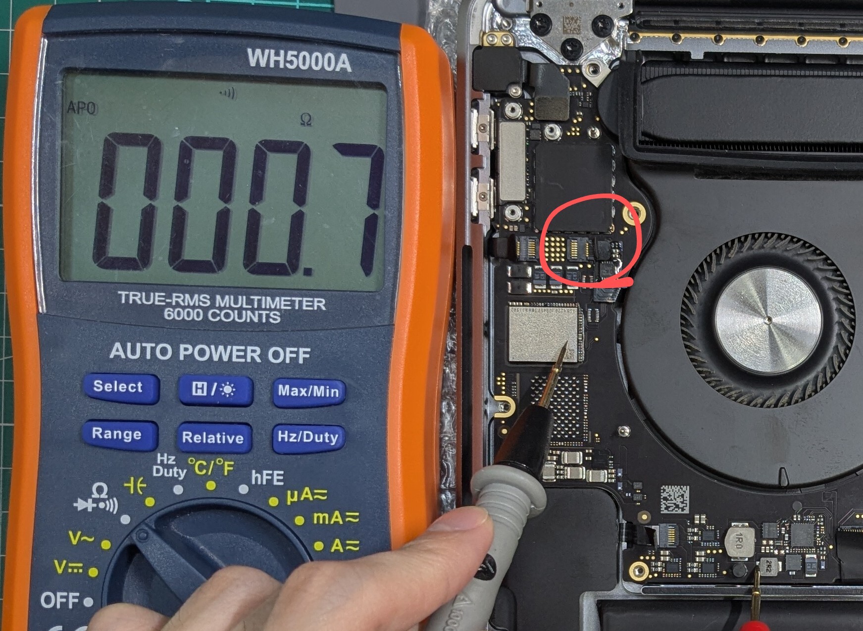

    It booted up!
    The cause was one of the fans.
    I found a short circuit on the PP5V_G3S.
    So I removed the motherboard to look for the faulty part. Then the short circuit was gone.
    The short circuit only happened when I connected one of the fans.
    I pressed the power button with it disconnected, and it booted up.
    Thanks for the advice, mon2 and reformatt!

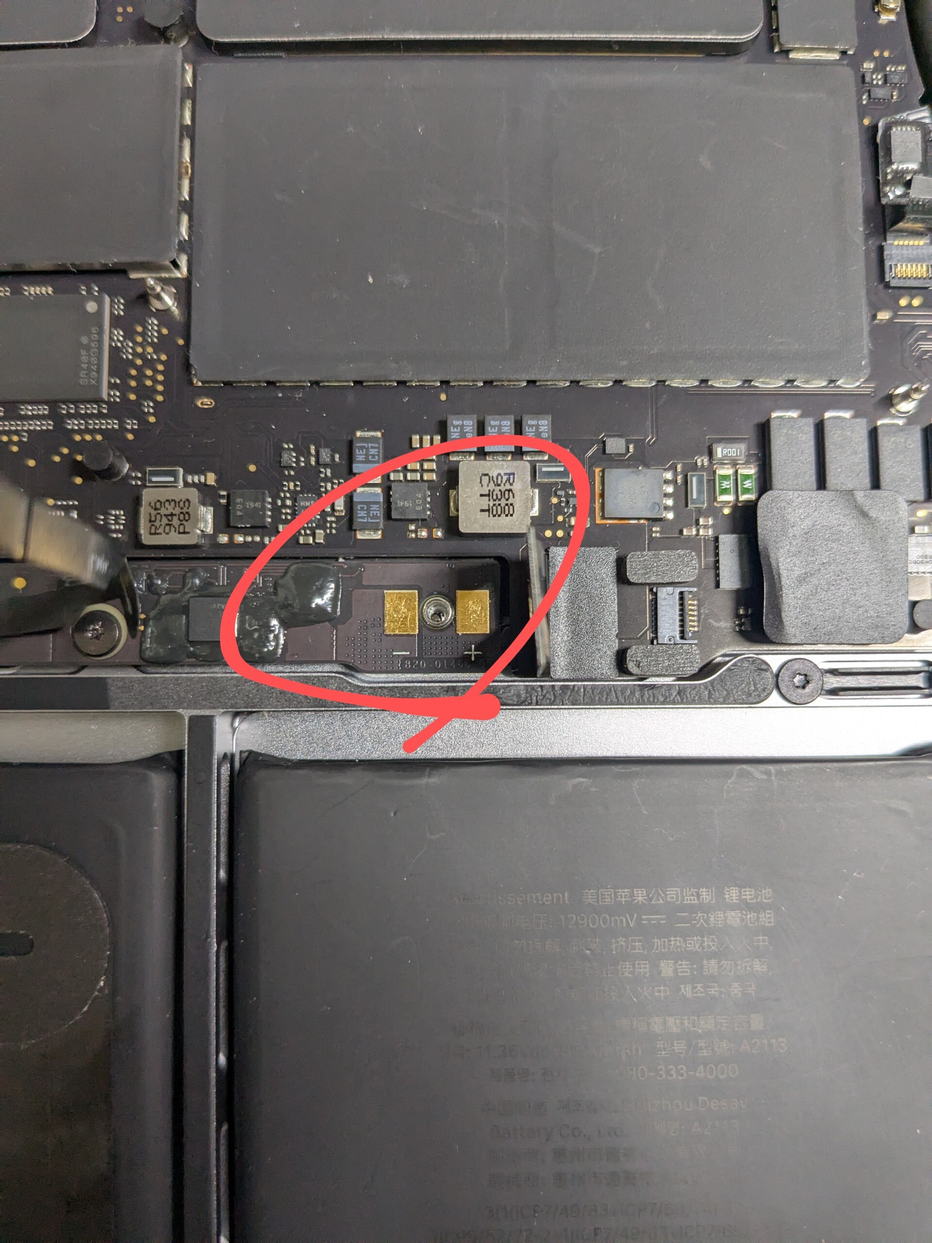

        The voltage of PPBUS_G3H is 12V.
        The charger used was Apple's genuine 61W charger.
        I tried measuring the battery voltage from the marked part in the image, and the value was 7.6mV.
        (I may have measured it incorrectly.)

          You must use a 96w or higher rated power adapter for this unit. A 100w unit with a 100w rated cable is even better. This adapter will then power the board and charge the battery. The battery is required with a charge to boot the board.
          connect the battery like normal and test again with a 100w (at least 96w) power adapter.
          Be sure the battery flex cable to right side of the large battery contacts is also connected else the motherboard will not be able to communicate with the battery. This is the smbus battery interface.
