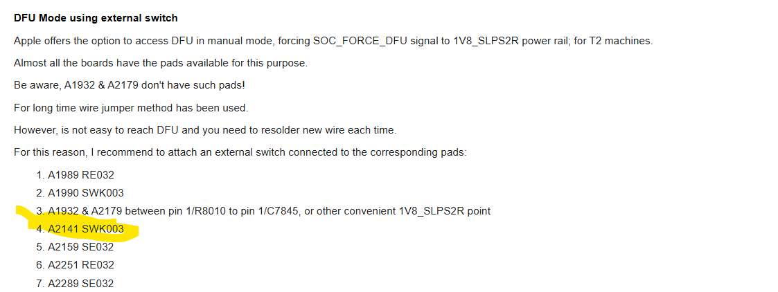

                                    #57
                                    Yes. Attempt a DFU on this unit. You may have corrupt T2 firmware.
                                    reference:
                                    https://www.badcaps.net/forum/troubl...g3s_en-missing
                                    • martyjelen
                                      • Mar 2023
                                      • 127
                                      • Czech republic
                                      #58
                                      Mabook is not in DFU. Is this method working for A2141 ?
                                      "Press the power button for about half a second, then also press and hold Left Control + Left Option + Right Shift for 10 seconds, then release all keys except power and hold power until the Target Mac shows up in Apple Configurator on the Host Mac"
                                      • mon2
                                        • Dec 2019
                                        • 13847
                                        #59
                                        Try the switch method:
                                        SWK003
                                        reference:
                                        https://logi.wiki/index.php/DFU_Mode_Restore_(Macs)
                                        • martyjelen
                                          • Mar 2023
                                          • 127
                                          • Czech republic
                                          #60
                                          I tried it. It doesn¨t detect in DFU. I tried both left ports.
