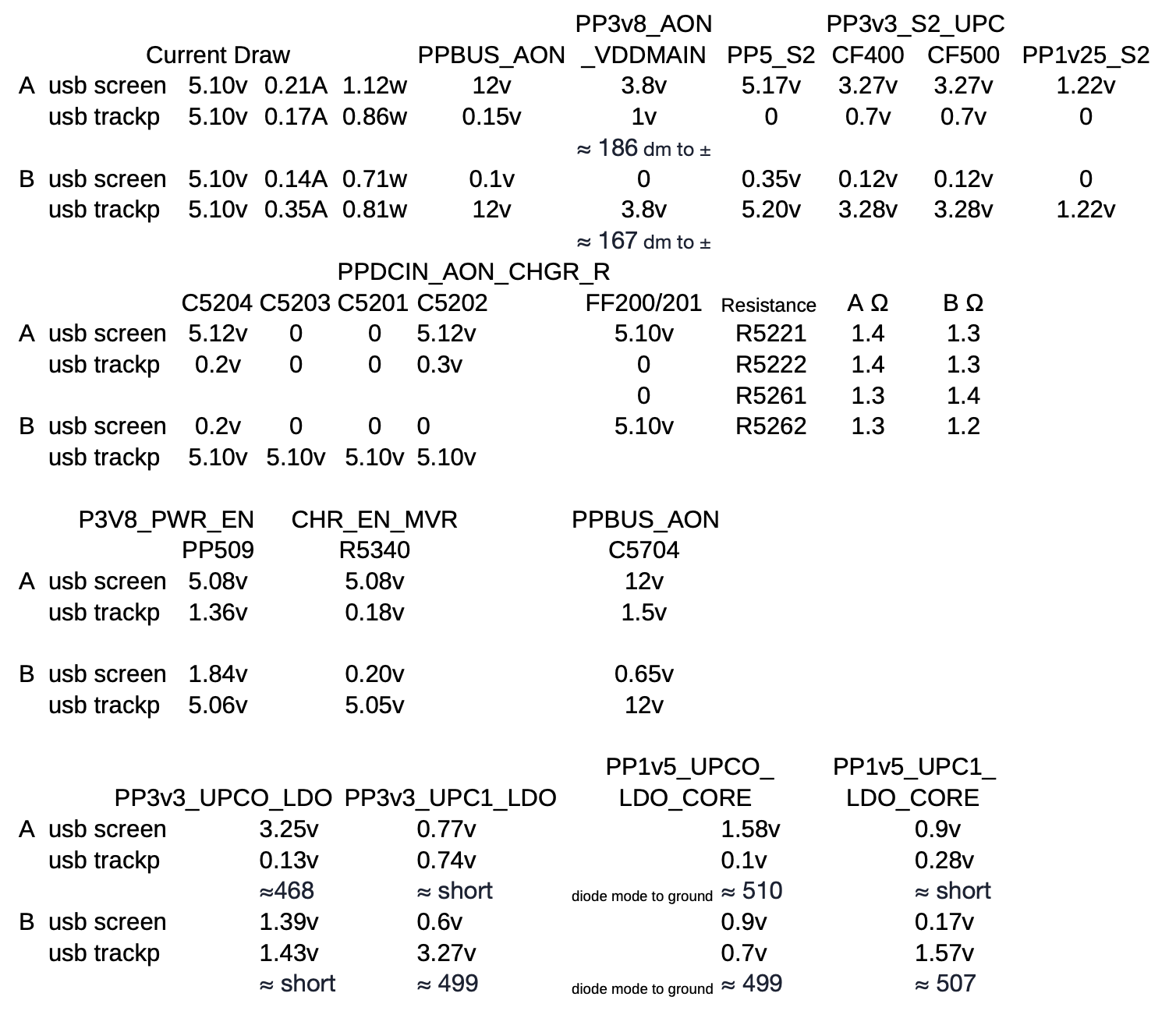

2 x MacBook Air A2337 820-02016 both working but no usb, no charging, shorts CD3217. 5.10v 0.2A draw.

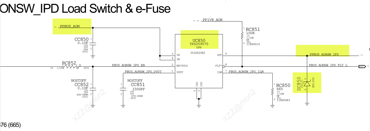

On your Unit A - remove all power; measure the resistance to ground of PPBUS_AONSW_IPD. This is the power rail (after the load switch / e-Fuse @ UC850) that powers the trackpad. If this resistance is low, then disconnect the trackpad and test the resistance again. It is possible that UC850 is defective from some transient linked to the trackpad and this is forcing the upstream power rail PPBUS_AON to sink.
PPBUS_AONSW_IPD = 4.62Ω at LT400 (1). Could not find spot on DC850 to put pin.
All 3 logic-boards are out out of the case, only USB ports connected.Comment

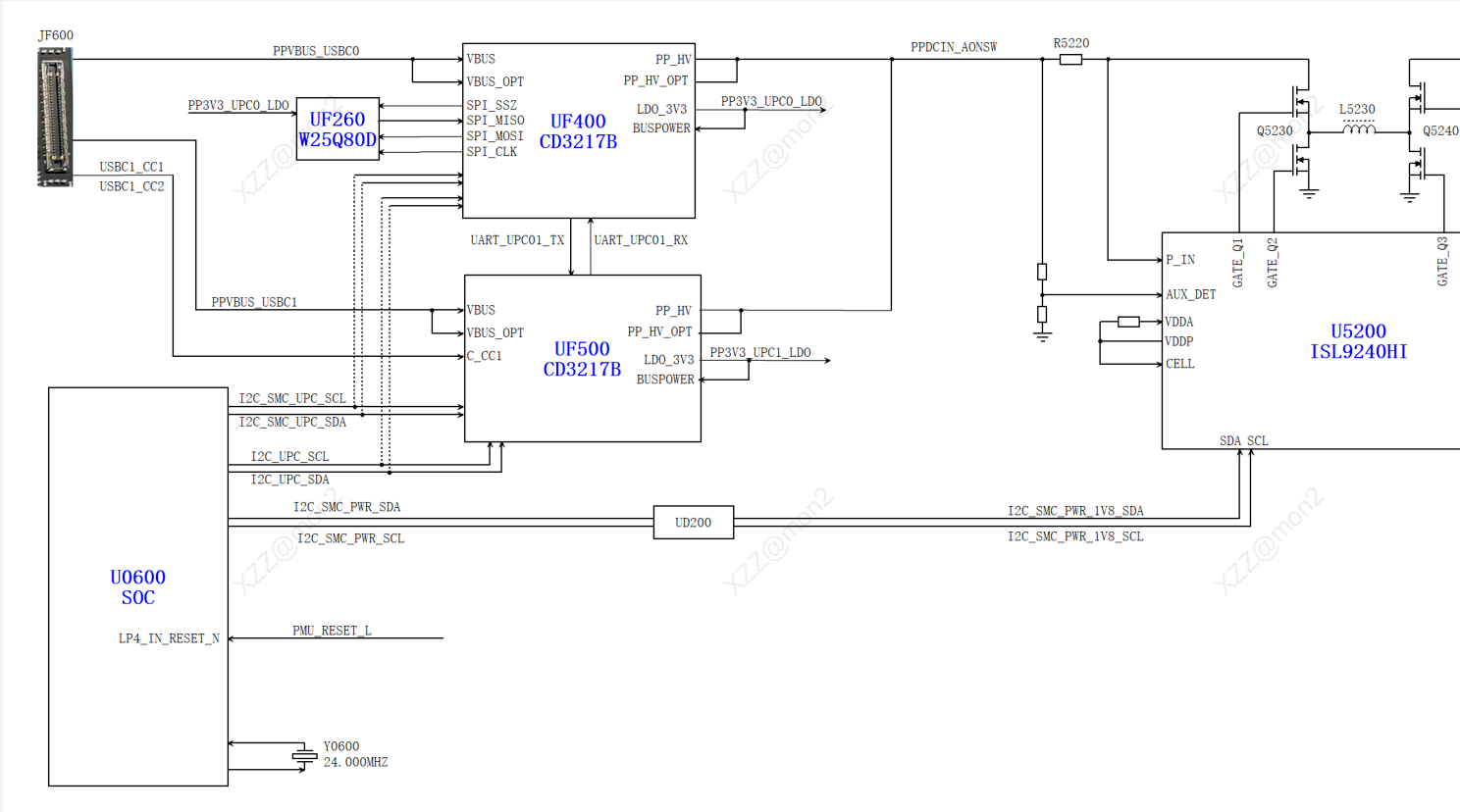

Hey! As the title says. i don't know if this is the right place to ask but i need to get trusted USB C Controllers (CD3217-CD3215) For macs and dont know where to get them. i dont know if you guys know where is a good place to get it.
The thing is that i have a Macbook air A2337 M1 and i dont have a donnor board to get the CD3217. So i try the CD3217 from a A2141 Board and at first, whitout his eprom it does not convert 5v to 20v. then i put the original CD3217 eprom from the A2141 and then the macbook A2337 conver the 5v to 20v but still not turning on. i guess that the CD3217 is...09-06-2024, 12:06 PM -

I'm working on a MacBook Pro A2442 (14", 2021) that's not powering on. On two out of three USB-C ports, I get 5V and the current briefly ramps up to around 0.210A before dropping to 0.036A. On the third port (JF600), I only get 0.0045A and it stays there.
Initially, I suspected a faulty CD3217 on that port, especially since I noticed signs of previous liquid damage near the JF600 USB connector. I replaced the CD3217 with an UF400 (from an A2442 donor board from the same location). According to the supplier, this should be a compatible version, but the behavior... -
