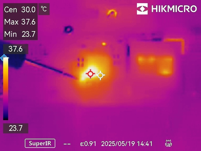

A number of parts are linked to this power rail including the cap cluster @ L7813. Would you have an adjustable power supply? Dial it up to 1V and as high current as supported by the power supply and use it to inject @ L7813 (with no power to the board). The shorted part should heat up and be visible.
