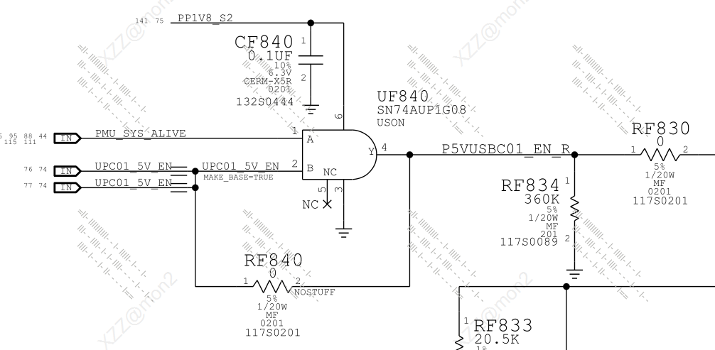

    P5VUSBC01_EN_R​ yes this one NO VOLTAGE PRESENT on this area.
    CF840 = 1.8Volts Present

      UF840 is a dual input AND gate.
      Output of this dual input AND gate = 1 ONLY if BOTH inputs are logic '1'. Output will be a logic '0' = 0v otherwise.
      Test the inputs to this dual input and gate. Measure their voltage to ground.

        #43
        OMG. I think I just fixed it with this... HOLD On. I replaced UF840 and that brought voltage and the meter is reading differently now. The amps jumped up a little.
        I am now getting 0.26volts at P5VUSBC01_EN_R
        UPDATE: jumped to soon. I am getting .26vols at that area now but still getting 20volts 0.00 amps. I think we are making progress.

          #44
          No, this has to be a logic '1' but note that the Vcc rail for UF840 is 1v8 so the voltage at the output = P5VUSBC01_EN_R​ should be ~1v8 or close to this if it is working correctly. If the voltage is lower, then confirm the 2 x input pins to this AND gate.

            #45
            I see. Then I am not getting 1.8Volts on UPC01_5V_EN. No voltage present at RF840 either Suspecting that the USBC chips could be faulty?

              #46
              Perhaps. Review each of the LDO rails on UF500 (CD3217) but mate the power adapter onto the physical port that uses this PD controller. Each LDO rail must be present on this CD3217.

                #47
                LDO Present on CF508 (3.3v)
                LDO Present on CG505 (1.5v)

                  #48
                  LDO Present on CF505 (1.5v)
                  What is the voltage of USBC1_3V3LDO_EN?

                    #49
                    USBC1_3V3LDO_EN - Not Present. 0 volts

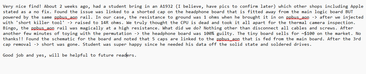

                                #55
                                Very nice find! About 2 weeks ago, had a student bring in an A1932 (I believe, have pics to confirm later) which other shops including Apple stated as a no fix. Found the issue was linked to a shorted cap on the headphone board that is fitted away from the main logic board BUT powered by the same ppbus_aon rail. In our case, the resistance to ground was 1 ohms when he brought it in on ppbus_aon -> after we injected with 'short killer tool' -> raised to 14R ohms. We truly thought the CPU is dead and took it all apart for the thermal camera inspection. Bingo, the ppbus_aon rail was magically at a high resistance. What did we do? Nothing other than disconnect all cables and screws. After another few minutes of toying with the permutation -> the headphone board was 100% guilty. The tiny board sells for ~$100 on the market. No thanks!! Found the schematic for the board and noted that 5 caps are linked to the ppbus_aon that is fed from the main board. After the 3rd cap removal -> short was gone. Student was super happy since he needed his data off the solid state and soldered drives.
                                Good job and yes, will be helpful to future readers.

                                    #58
                                    So I discovered some new knowledge or maybe its not new who knows. These computers seem to boot when the USB C chip is somewhat faulty, even if the resistors are good, replacing a faulty CD3217B12 chip will result in the voltage to jump back up to 20Volts and proper amps for charging the battery. I noticed this with each board yet all of them had the same issue, some had different chips to pinpoint. But most of them all resulted in a CD3217B12 chip being swapped out from a donor. I solved two boards and both had faulty CD3217B12 chips. I. had to source a donor board since I know that the 14" those chips need to come from the correct side just like A2251 boards. One board had a faulty CD3217B12 chip but was still registering so the computer turned on, With this knowledge I was able to solved the second one, I am waiting on another donor for the third. The other board had heavy liquid damage near the HDMI port which hit the CD3217B12 chip. Replacing these more than likely solves the charging issue even though it turns on with a battery....
                                    Update: my assumption was correct. CD3217B12 chips are the culprit in this type of issue. ONE thing I did notice and I want to give knowledge about is when all CD3217B12 is working you would get 5volts but what I discovered is if you plug up the meter and test PPBUS_AON you will get 12volts on most chips, but one board in particular would give you a different reading if you plug it into different ports. Example: USB C port UF500 would result in 12volts on PPBUS_AON but had 5 volts as usual, plugged up the meter to UF400 same result, Plugged up the meter to UG400 5 volts per usual HOWEVER, PPBUS_AON would result in voltage reading under 10 volts. I was suspicious so I replaced it and voila the board turned on and started getting amps again, plugged up battery and then the battery finally charged.
                                    Hopefully this helps someone in the future.
