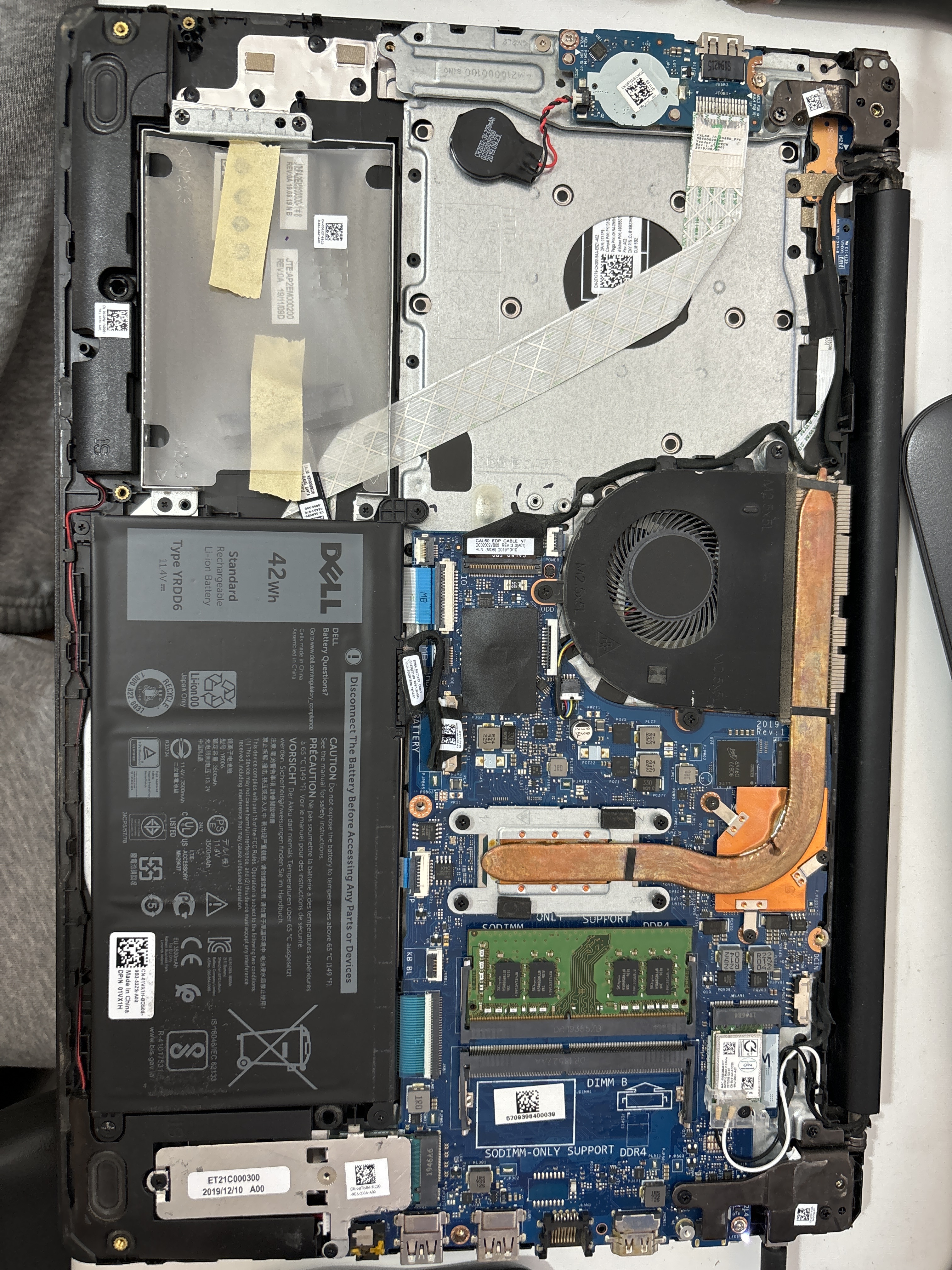

    Got this in today,
    no signs of life.
    found a broken charging port- after replacing it, the laptop turns on and charges the battery.

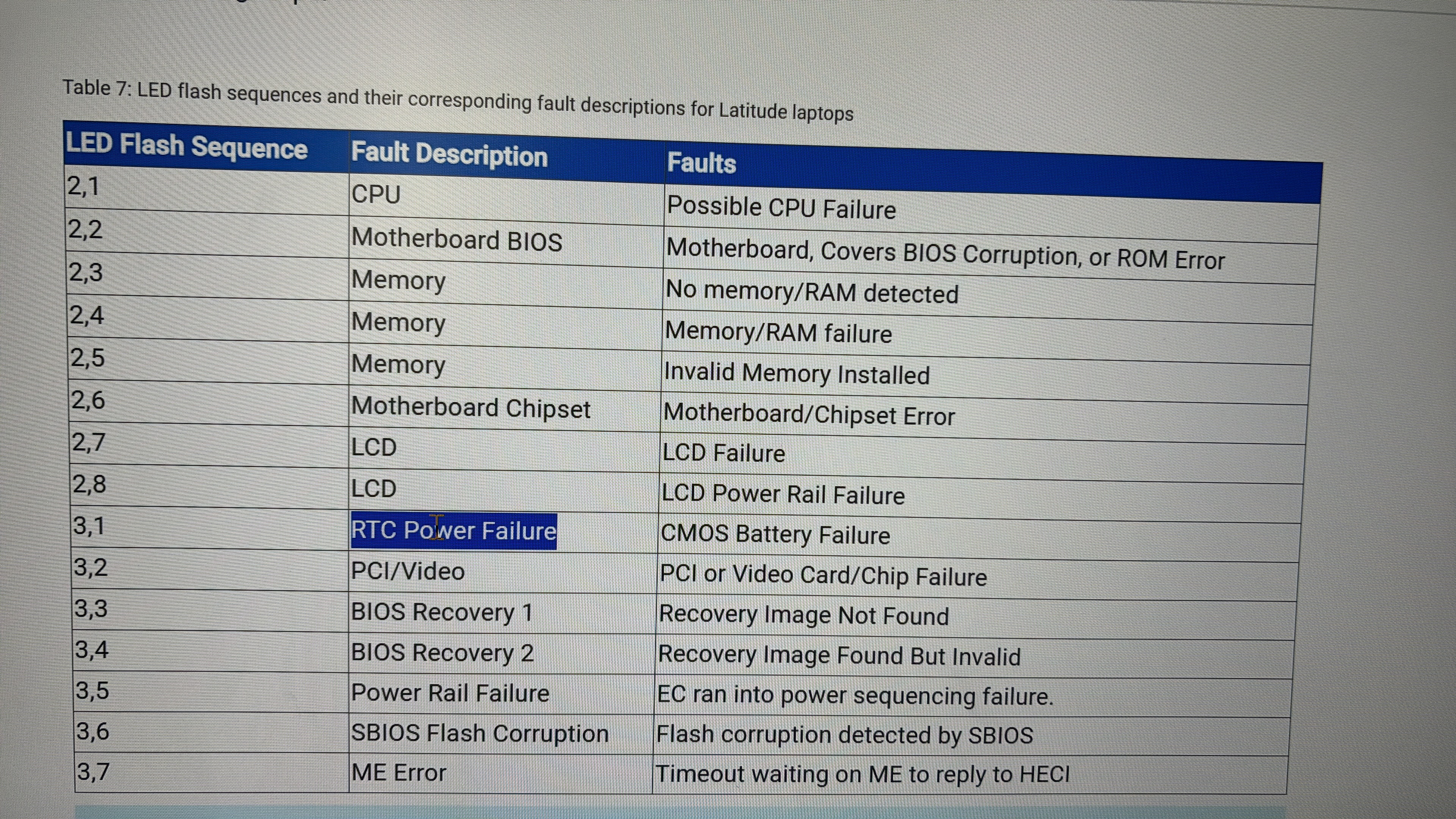

    Trying to turn it on, laptop powers up, capslock is on and not responding, no image on the screen. Indicator led is flashing with 3 amber 1 white.
    CPU and GPU are very hot, so laptop has all the required voltages.
    Cmos battery is okay ~2.9v which supposed to be okay.
    Could it be a bios problem?
  • s_henya
    • Jan 2011
    • 483
    • Israel
    After long charging while being off laptop agreed to post normally. Maybe battery was very drained.
