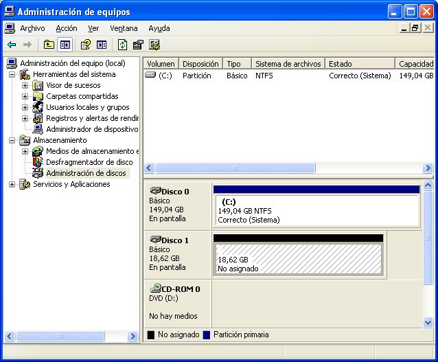

              Connect them to a windows machine and post the screen shot when looking at the drive from administrative tools > computer management.

                                • Joseph67
                                  • Feb 2011
                                  • 37
                                  Re: 40Gb HDD has only 20Gb space
                                  Please see attached the screenshot. As you see the drive is not yet formatted.
