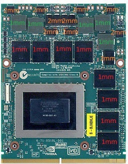

    Is 98C vram temp are safe? Less demanding games goes 80ish.

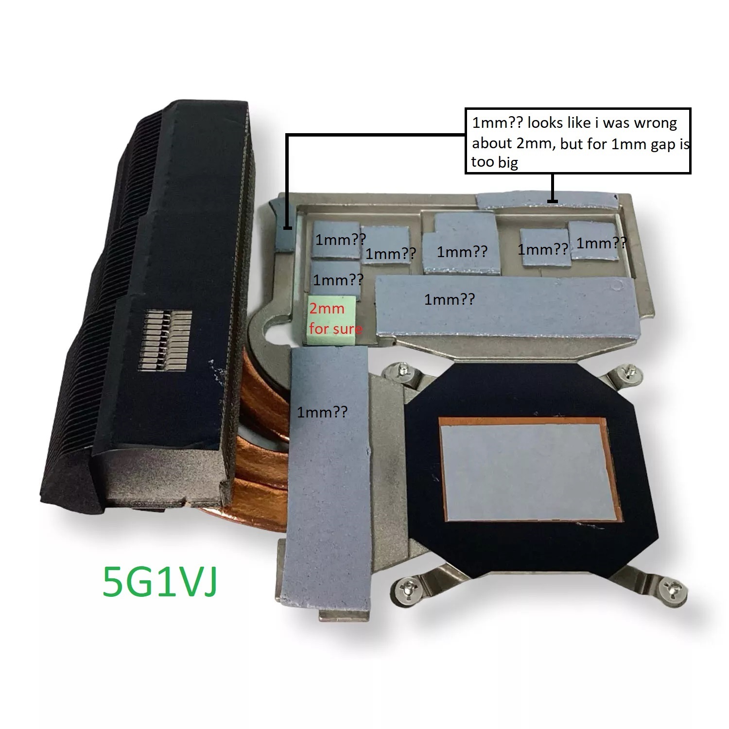

    Funny thing, there were old non stock thermal pads very botched, so i replaced them. After, temperatures remained the same, but performance (fps) improved significantly. With both thermal pad application GPU core temp was similar.
    furmark goes about 104C, amperage keeps rising so do temps.

    i had a gtx 675m in my alienware mx17x r4, but gpu temp never exceeded 75°. dunno what vram temp it got, but for gpu core, 104° means pads are not the right size ? what app are u using ? gpu-z ?
    on what system it's installed?

      core temperature is about 71C during games. Trying to figure out if my VRAM temperatures are good. I use HWINFO to monitor GPU. 104C is VRAM

        5G1VJ dell alienware
        found stock heatsink, but i never dealt with thermal pads so its hard to determine thickness of thermal pads in the photo, only original pad left is that green square which is 2mm. And i have no reference for 0.5mm thermal pads to compare.
